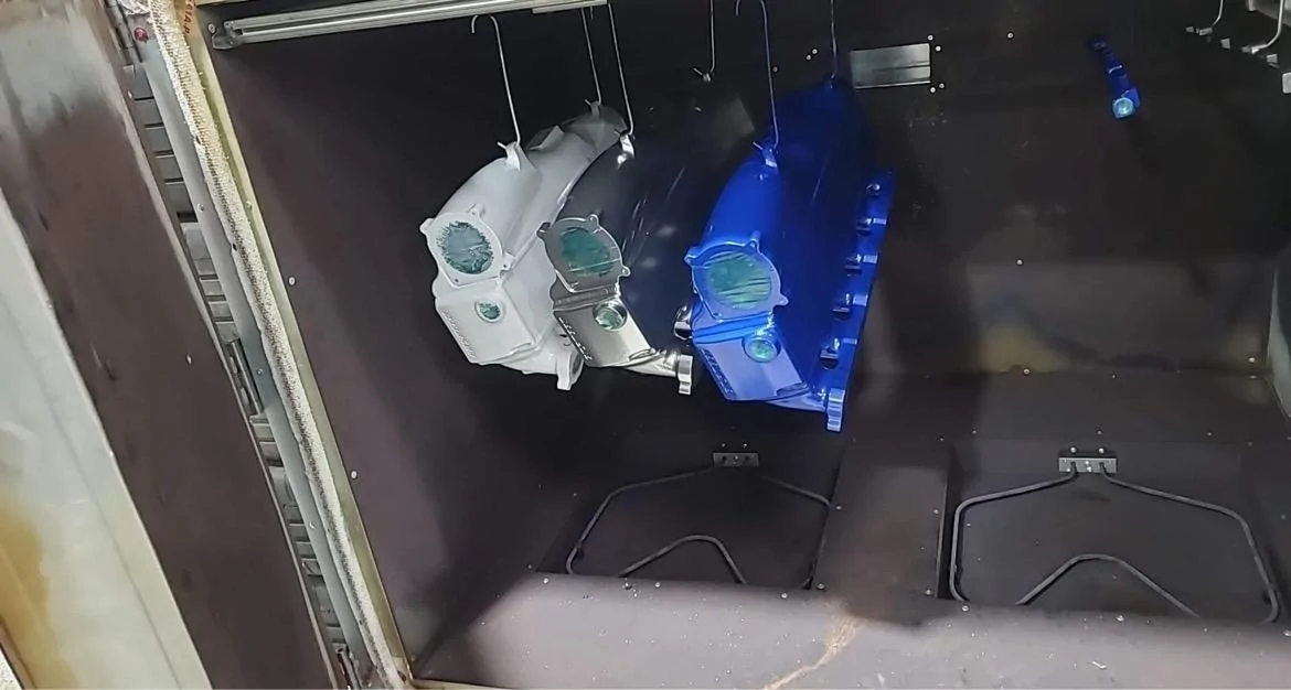

I ordered mine in blue as well a few months ago. Shipping today. I got mine from @Jesse DaBears.
