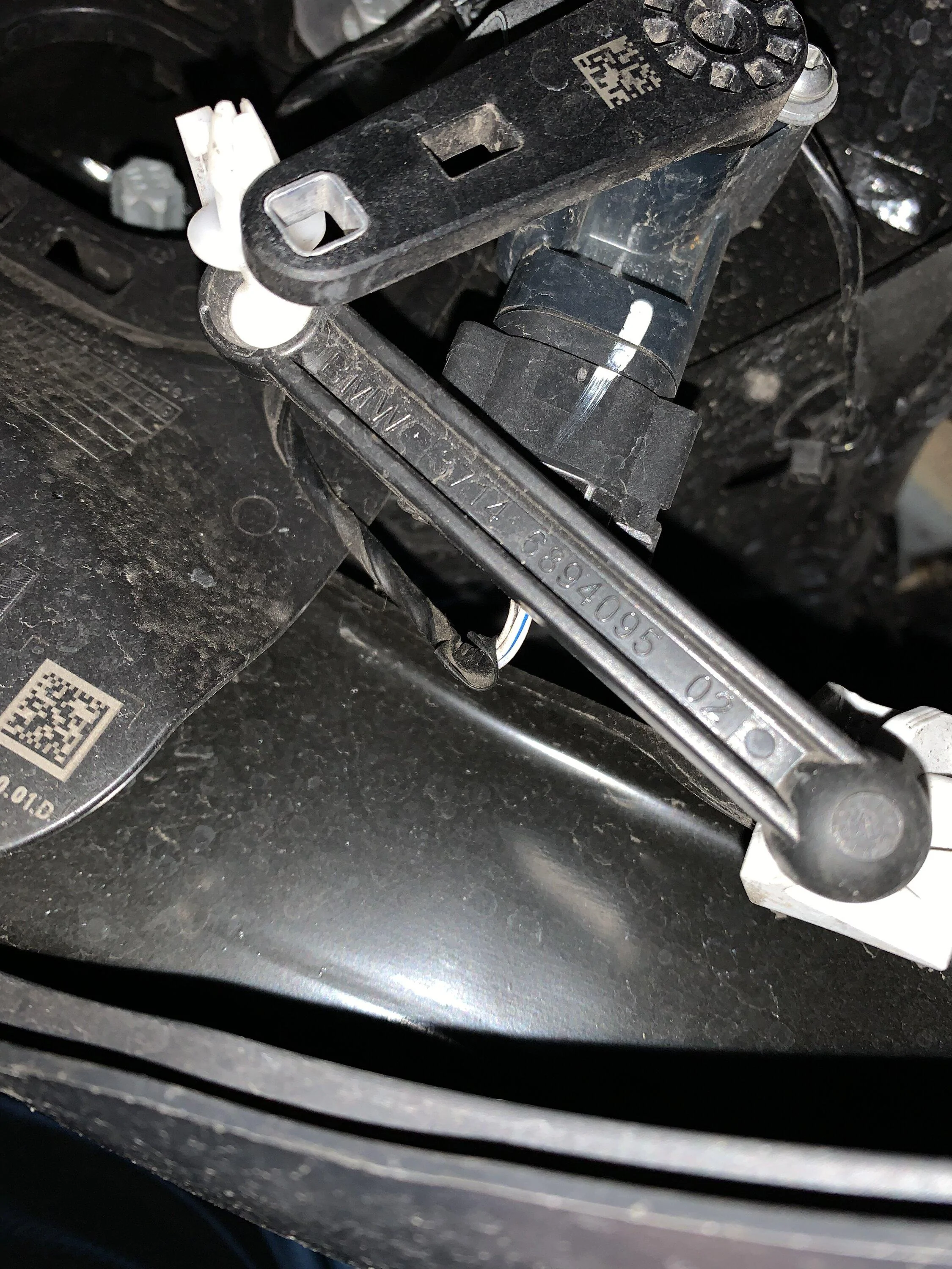

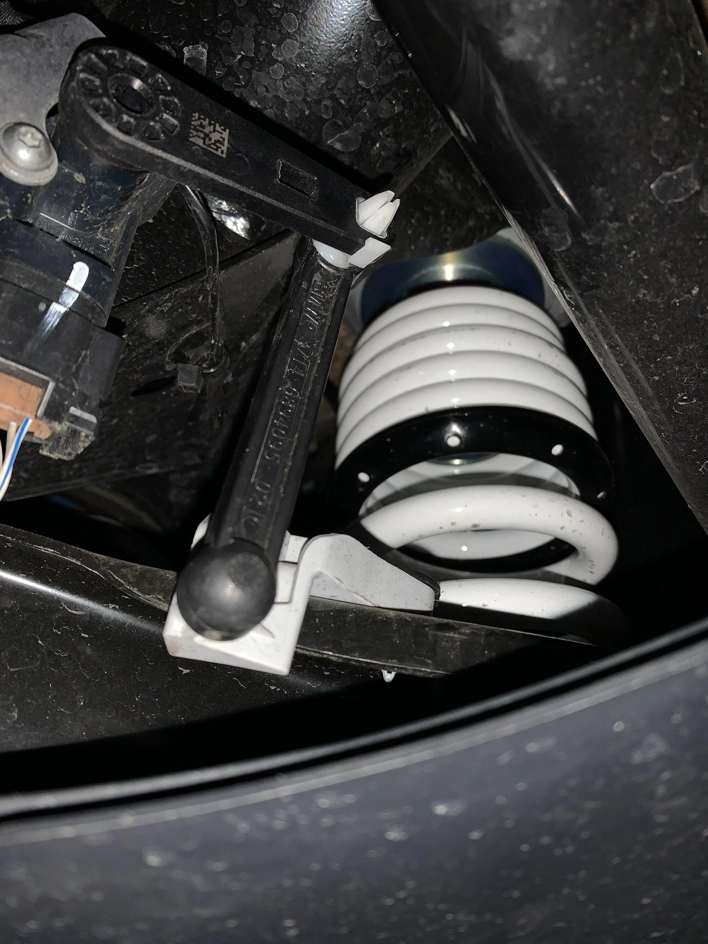

Hey Everyone,
Just got my HKS springs installed today. Rear height was perfect but front height was kinda high. Figured we had to let the springs settle first before making some adjustments.
Codes started popping up on the way home tho. (See image)
any thoughts?

When the collars / Oem perch got removed everything got fixed as well. No more issues. Caused by the ride height.

I’m having the same issue on my Supra. What could it be? I installed all the oem sensors back on already. Still this popped up? ?‍♂
I found the Solution!!! Damn BMW cars and their sensors lol!!! A friend of mines told me that it had to be the rear sensor. And sure it was. I’m just glad that my piece just got loose ? because of it was broken I would’ve order a new one from “Visconti Tuning”. I drove my Supra around the block and the code error was gone ?.
