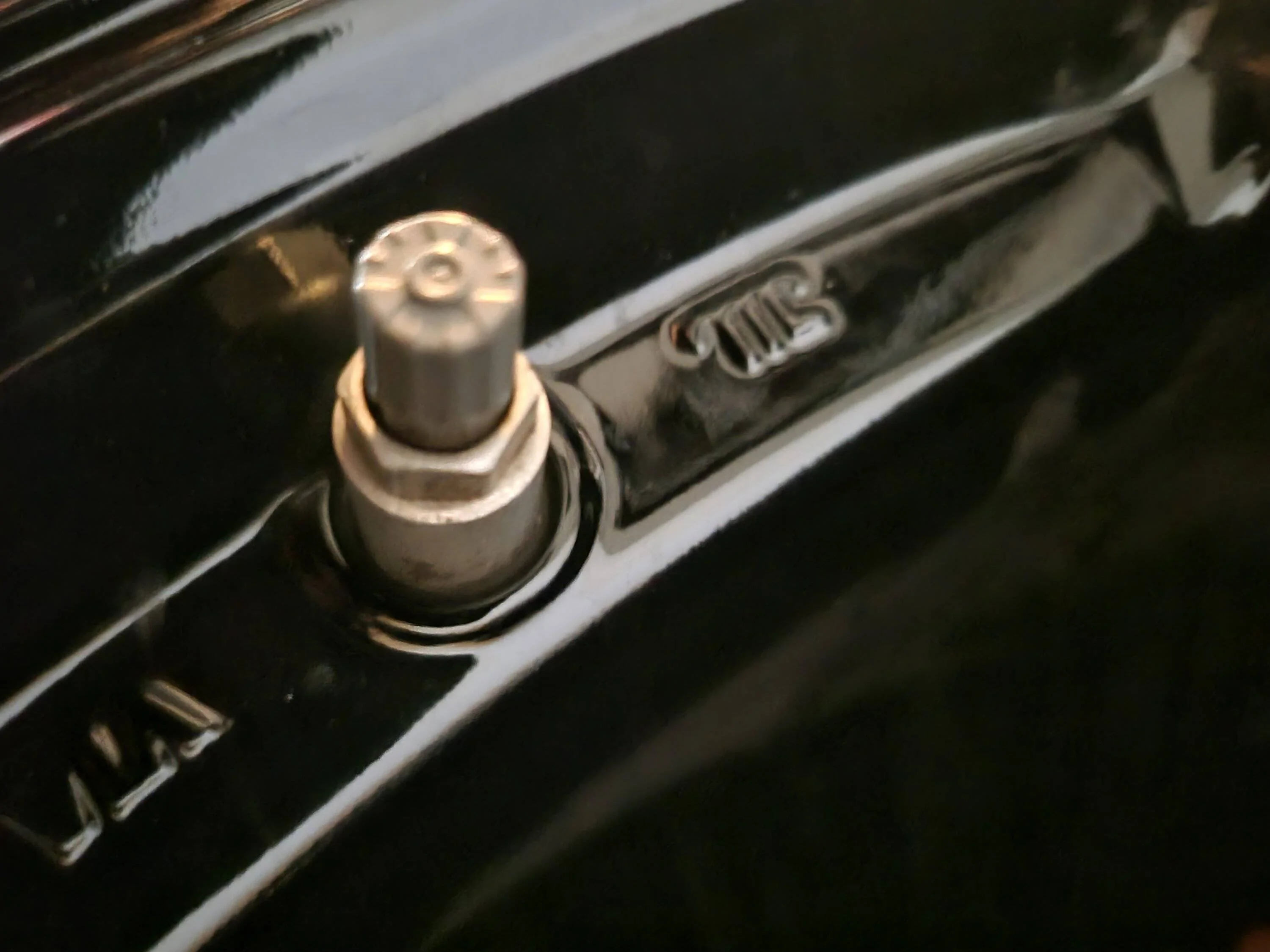

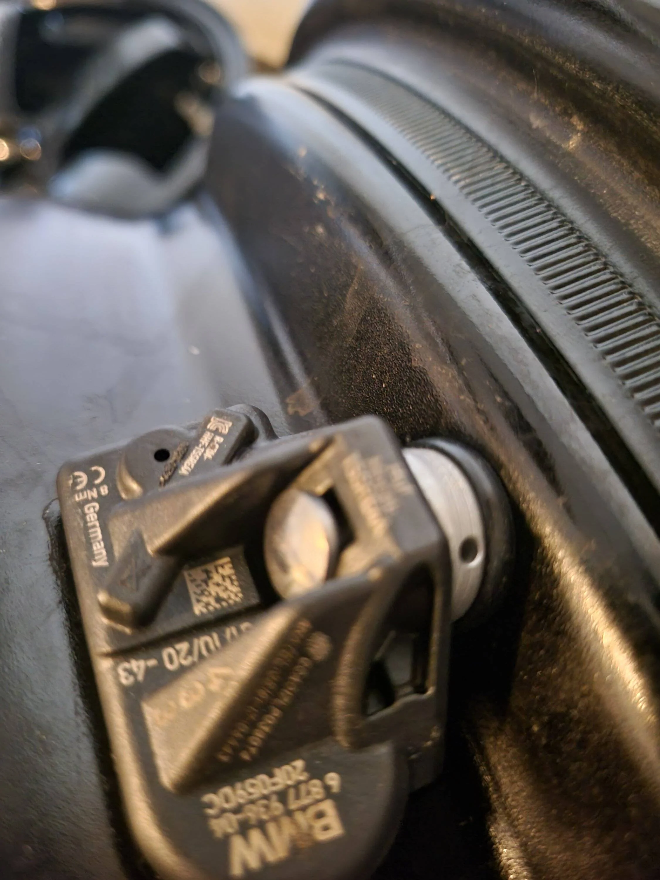

Feel free to trash me all you want. I'm mechanically ignorant. I want to sell my aftermarket wheels that the tire shop transferred the stock TPMS over to. To remove the TPMS, do I just use a socket to remove the whole stem, or do I pry the end of this off? I'm confused and, like I said, a dummy. Thanks. Pictures for reference:

See the hex below the valve stem? It screws apart. The tpms clamshell clamps the wheel hole. Just unscrew it with a deep well and it comes right off.
Figured as much; just wanted clarification before I did anything. Thank you!
