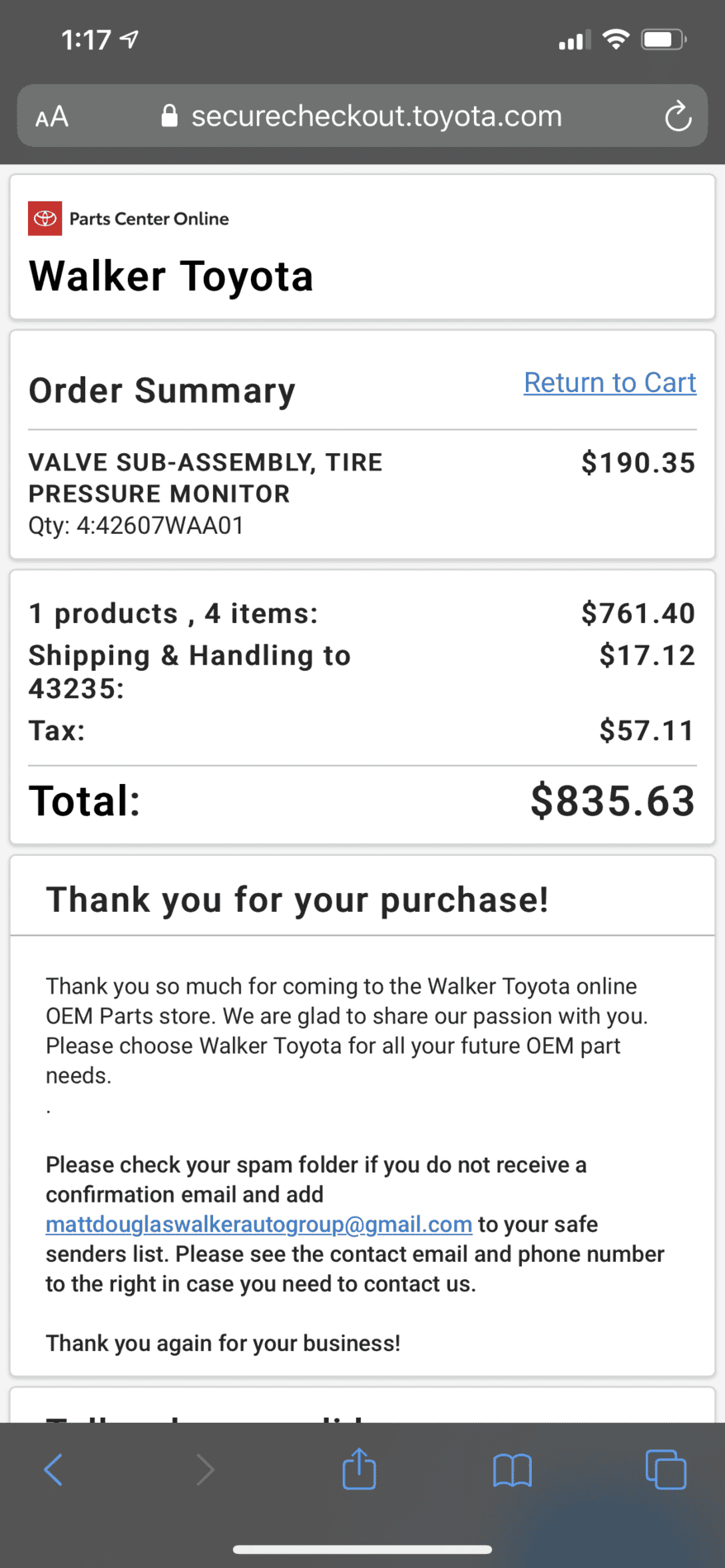

I bought 4 new oem TPMS sensors (750 bucks ouch) in order to run them in my new volk TE37 wheels.
upon mounting them and attempting to reset the TPMS, I get the prompt to drive around but nothing ever registers - it just keeps trying to read and stays at 0%.
my question is this: is there any procedure to register brand new oem TPMS sensors on the vehicle apart from the idrive rear procedure?
the Toyota part number I used are these:
42607WAA01
if anyone can help I would owe them big time! This is driving me crazy lol
