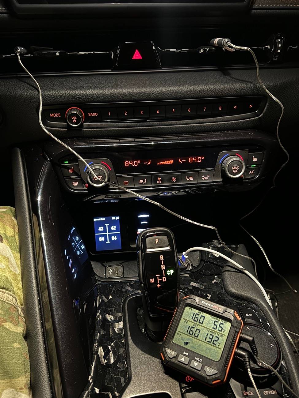

I’ve had the issue for 2 years now. I guess I should try the bimmercode option. I suggest to get some probs to see the real temps. I have 55 on drivers and 132 in passenger.

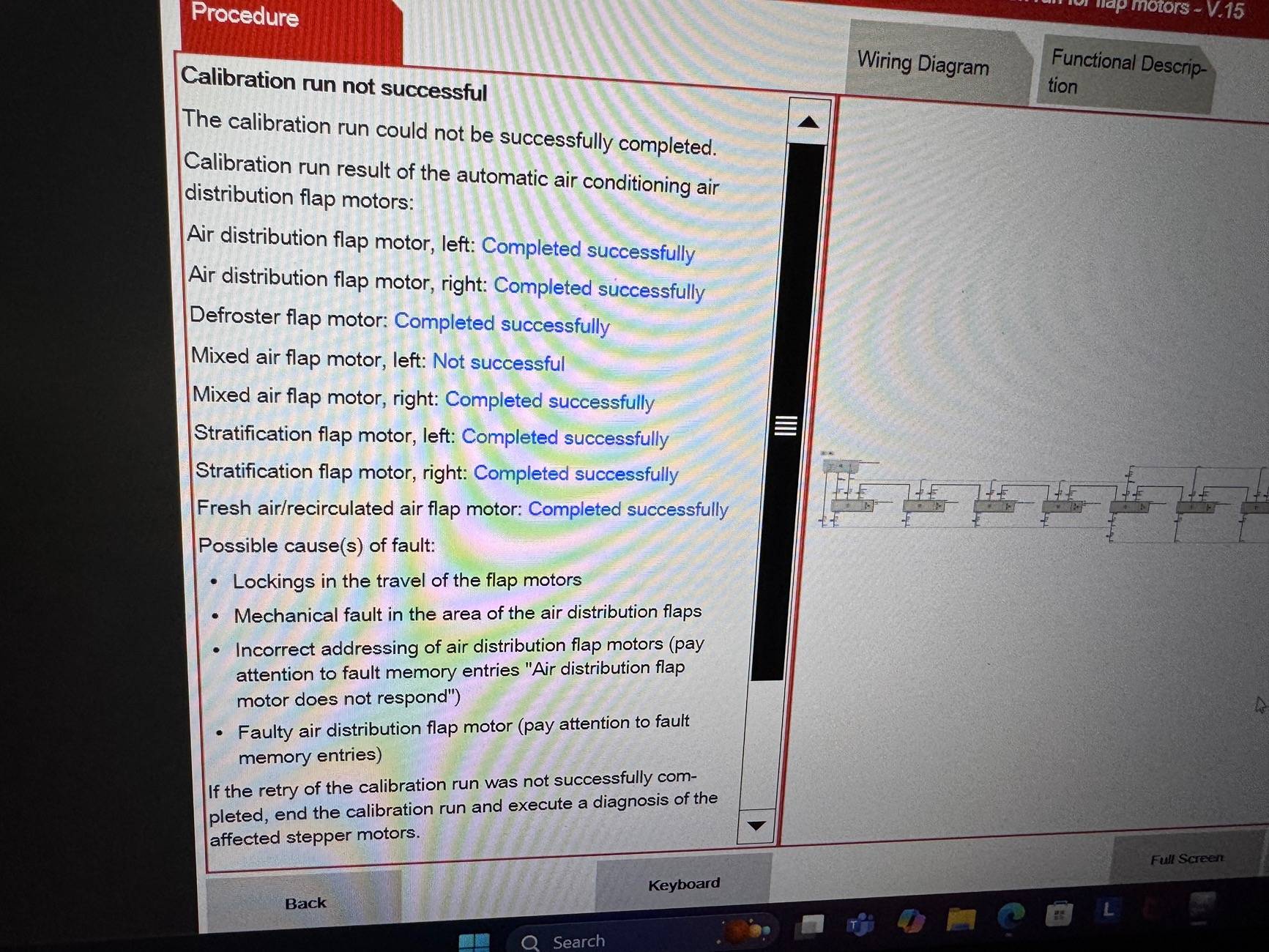

Finally had a chance to run ISTA on it. We got issues…. Acted up on me again today. Going to try the test again when it’s warmer out to see if that has anything to do with it. Probably run the heater for a bit too to make sure everything is nice is warm.

Newish owner of a 2020 with the same issue. I did some internet research and as others have mentioned, it is a more common issue with late 2010s BMW models that share the heater unit and actuator system. Not clear if a full replacement includes a long-term fix (if it’s just the same part that broke the first time). Mechanical breaks have only a solution that involves removing the entire dash and then using a stronger 3D part. Lame.

They're telling me it's a defective temperature door solenoid and they're waiting on the OK from the extended warranty company(Fidelity) to ok the repair.
My engineering degree Son tells me they may need to remove the entire dash to replace the solenoid.
Oh boy.....
