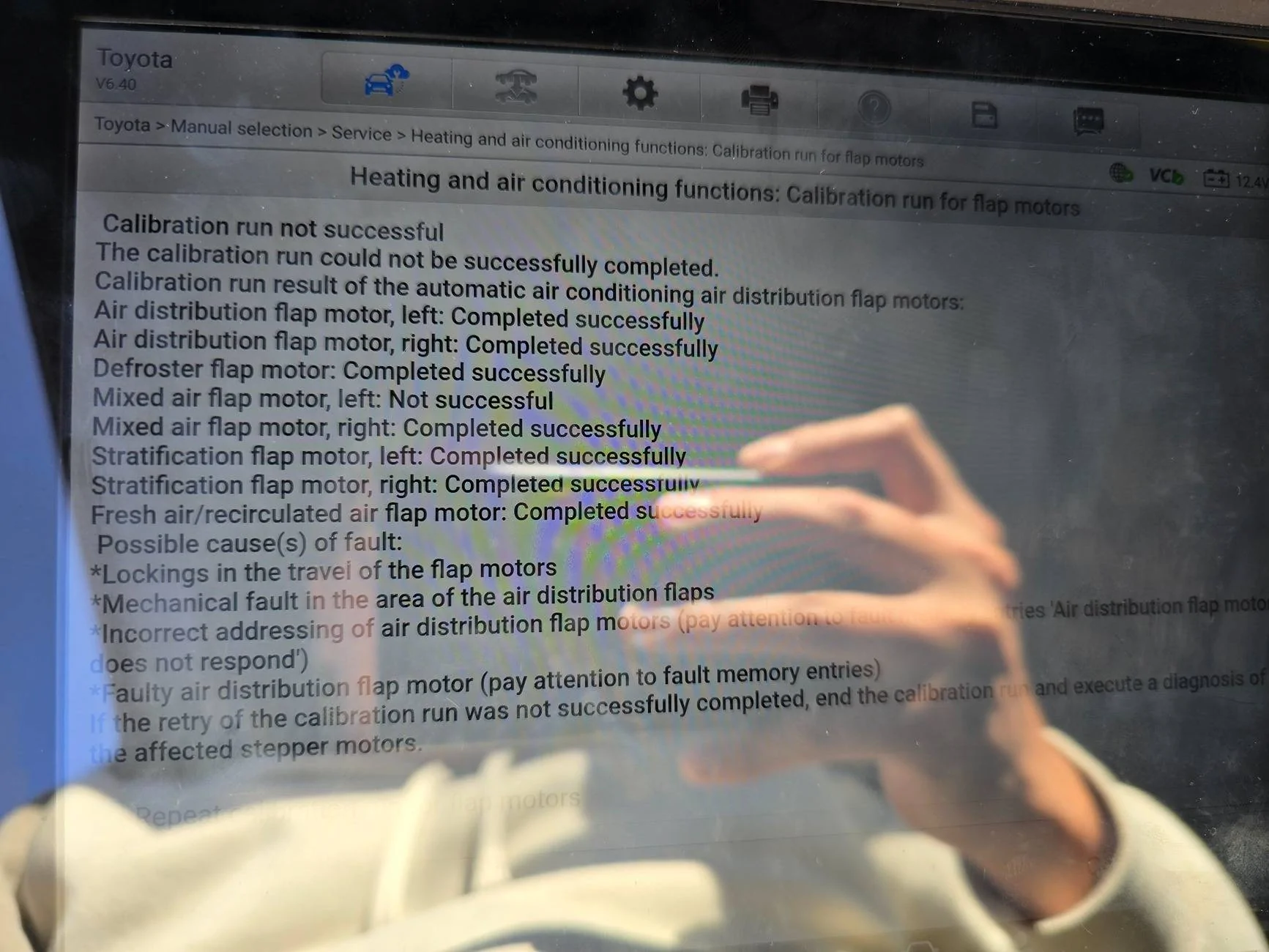

Asked them to do an air calibration test, they supposedly did one and said everything is functioning properly. Left and immediately had no head up to 83 and would only work at 84. I want to either get in contact with Toyota HQ or go to another dealer.

There's another semi-active thread about this same issue. What stinks is that this has been a fairly known problem with the BMW units for several years. If it isn't solved via calibration (e.g., Bimmercode reset), then it's a mechanical issue - literally breaks in the cheap plastic parts that actuate the flaps - and the whole dash is removed just to replace.
I posted elsewhere and still believe this should escalate to a recall by Toyota. When the ice cold air comes out the dash, it also comes out the defroster. Useless and a safety hazard. You can submit a report to NHTSA on-line.
