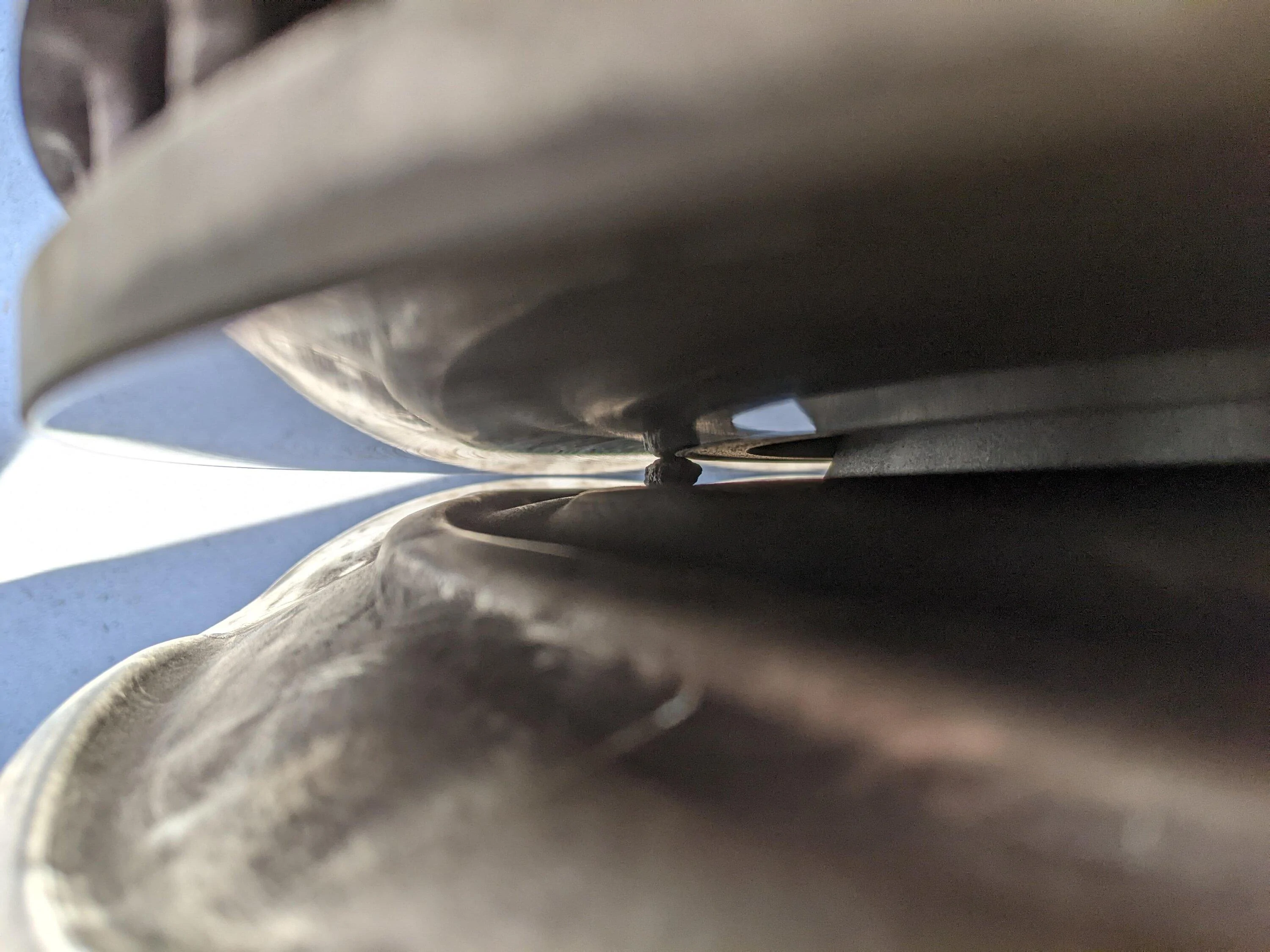

Appreciate the thread! Just happened to me and I was really pissed/bummed that something was seriously wrong but feeling better now. Hopefully I can remove it myself, otherwise will probably have it towed to be safe.

if it's not a big one, just tapping is likely to knock it loose. Otherwise pushing on the shield a little (after letting it cool) with your hands should clear it.

I tried pushing/pulling on the shield slightly with no luck. Then tried just reversing a little quicker and also turning the steering wheel back and forth and problem solved! My neighbors probably thought I was drunk or crazy doing this in my driveway at midnight . Thx guys!

These almost always work out on their own with little or no damage (worst case might be a groove on the rotor that will eventually go away). Going in reverse is a good trick.

This is very common and will continue to happen. Just buy a low profile jack and ratchet set up.
Pull the wheel off and look with a flashlight behind the rotor and dust plate.
take a flat head screw driver and tap the rock/pebble out with the flat head while applying pressure to the dust plate to make space.
shouldn't take more then 15 min.

^^^ Except when your far away from home.
Than “turn and burn” it will burn its way out within 10-15 min on the highway.

I also have this problem a lot, maybe 10-15 times now. I thought my brakes were locked when it first happened. I found the trick is to accelerate to 60mph then it'll clunk as the rock falls out. Some other forums also said reversing fast also works but I didn't for me. Should only take you about 3.8 sec or less to do it ;)

Got one on the way to my buddies house. First time it has only taken me one bang on each side with a screwdriver to get it out. Thankfully it was easy and didn’t have to take the wheel off cause it sounded awful

this is a common BMW thing ... ( i had this on my m3/m4/i8 many times ) just use a stick to bend out dustshield and stone will fall out ... sometime driving in reverse for 20 feet shifts it.

I joined the club today. In my case, I took the wheel off to get the rock out.
And again today, and again sounded like the worst sound I've ever heard from a car. Fortunately, this time the interloper ditched on a right turn.
I imagine for street use I could just delete the heat shield and avoid the periodic embarrassment.
Does anyone know why the heat shield needs to be exactly a pebble's breadth from the rotor? Why can't the gap be a few millimetres more?

I bent my shields out from the rotor a bit a couple years back and haven't had an issue since. There is a local track where I would basically have it happen every time I went there, as there is gravel parking which gets strewn all over the place, and it hasn't happened since.

I'm sure the heat shield name makes sense if you're tracking and have glowing rotors and are trying to prevent something nearby from overheating (though, not sure what, as it'd be the fluid in the caliper and the pads which are getting toasty anyways). I've always called them dust shields, which seems closer to their function of keeping other crap away from the rotors which I'd have to guess is the actual intent. Crap including rocks - which is why it's kind of ironic if they end up trapping those rocks. It'd seem there's no reason not to have them spaced a little far back - even an extra inch away they'd still do the job of keeping crap away from the rotors.
