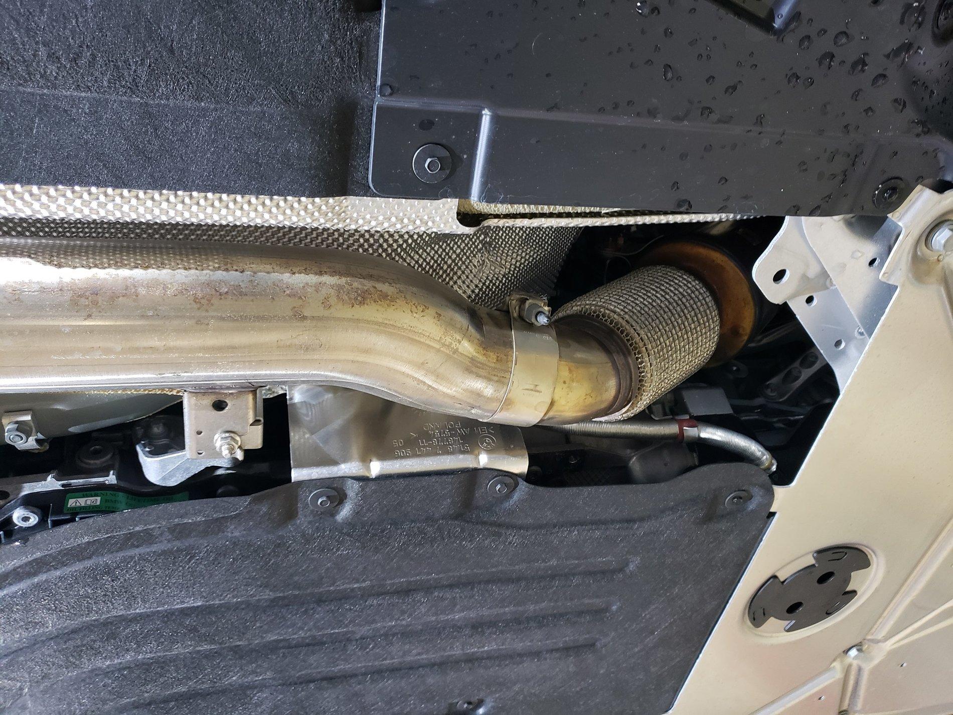

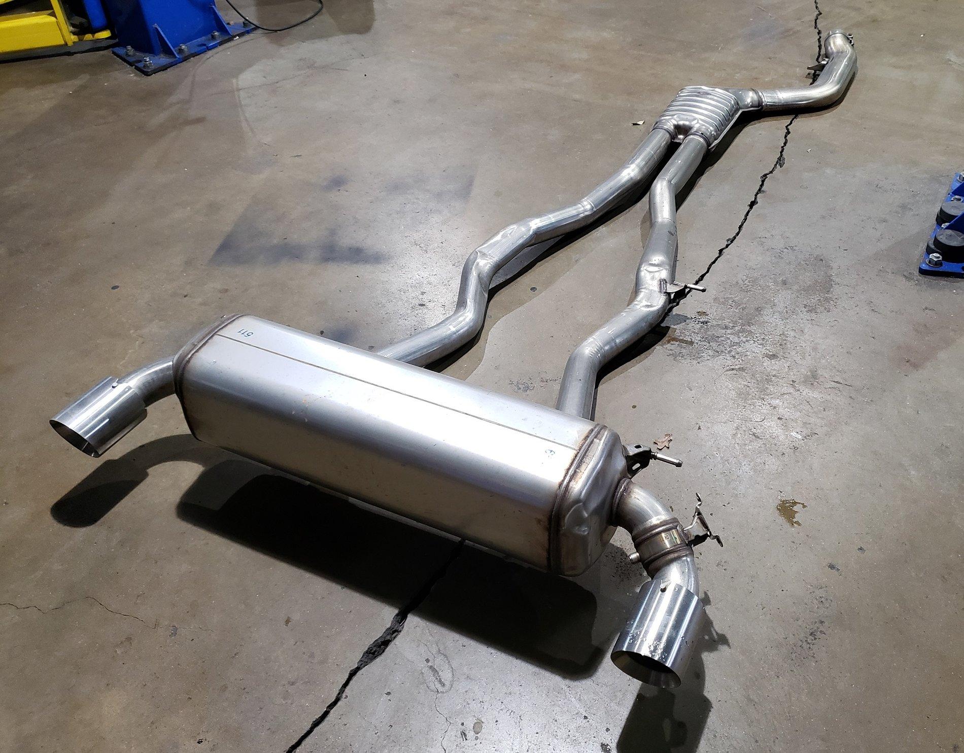

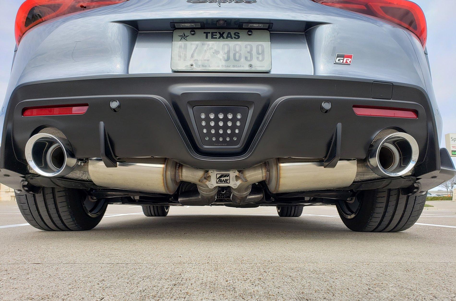

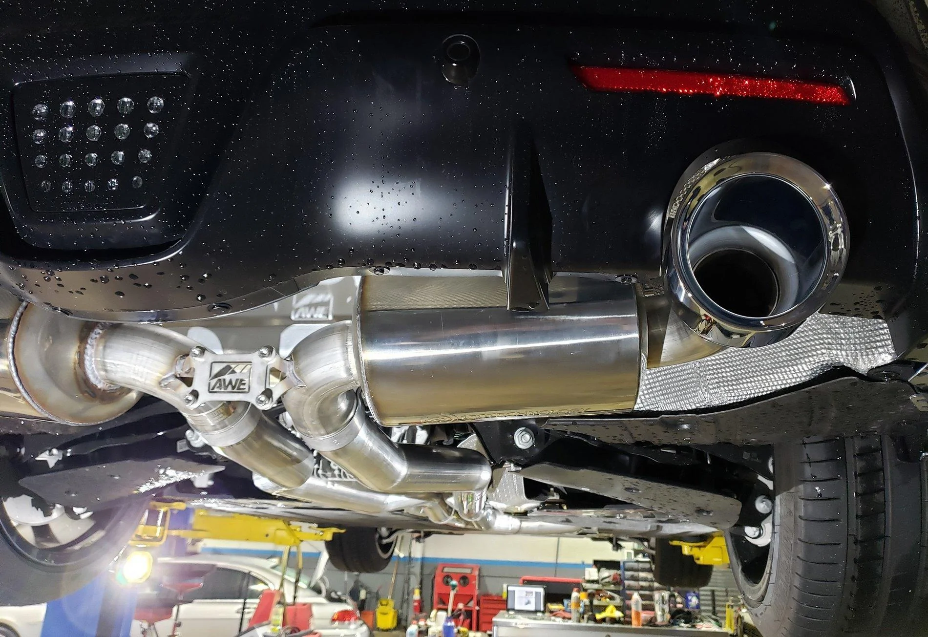

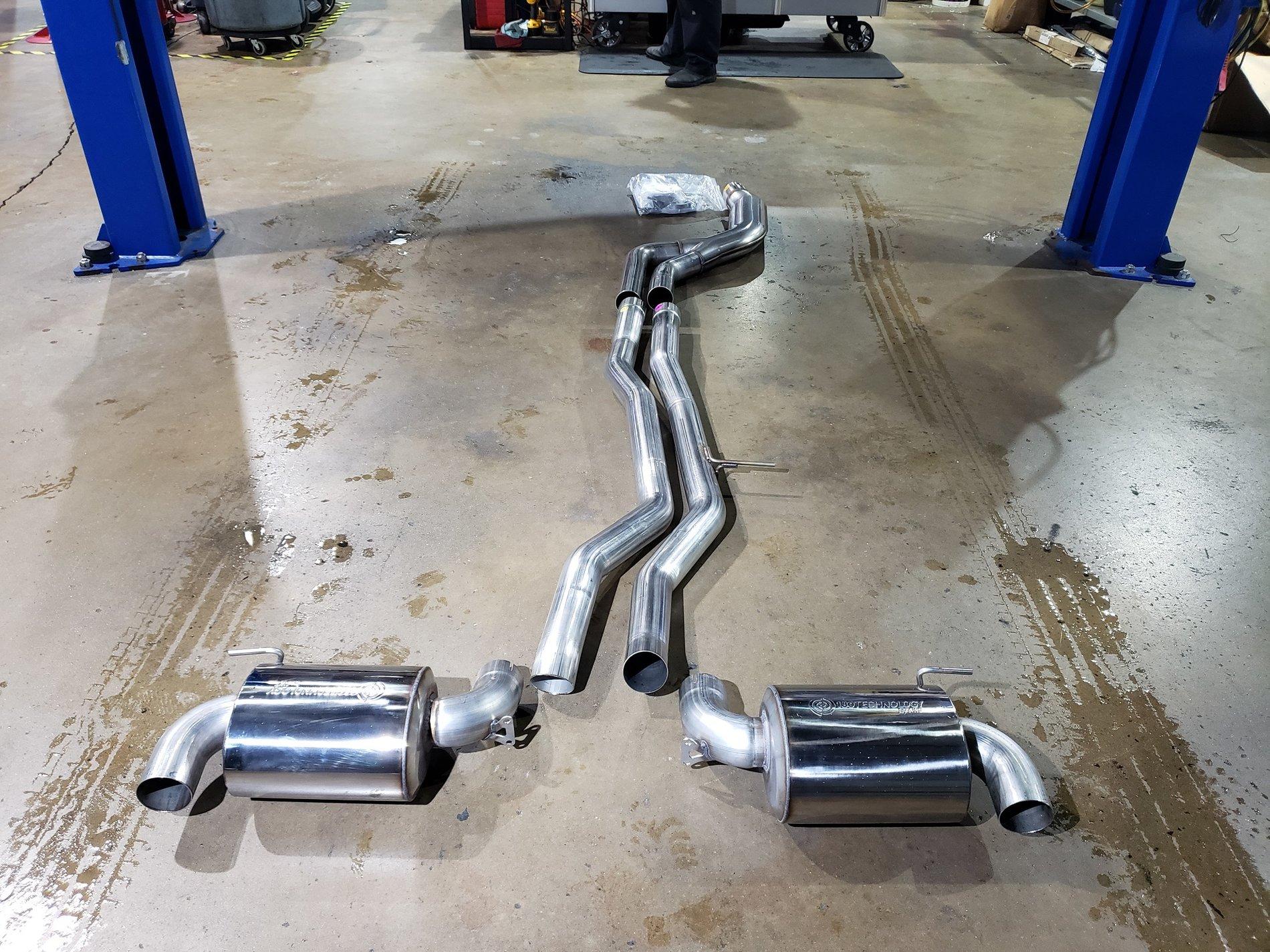

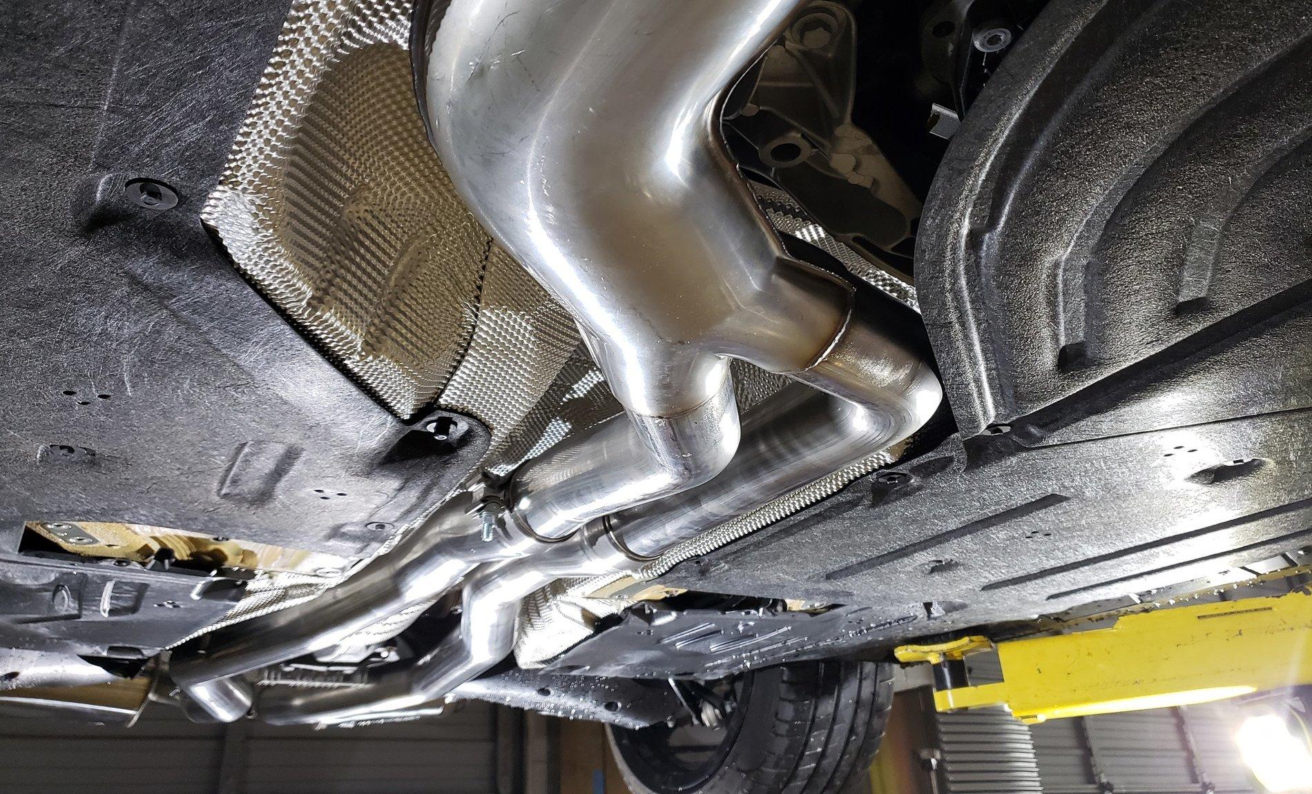

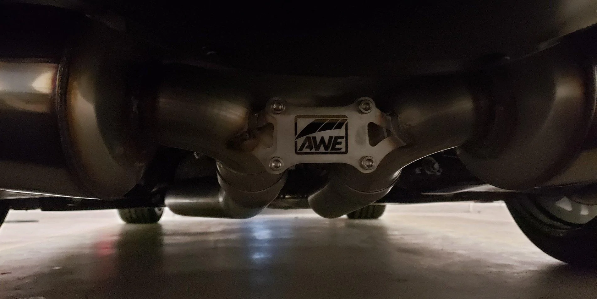

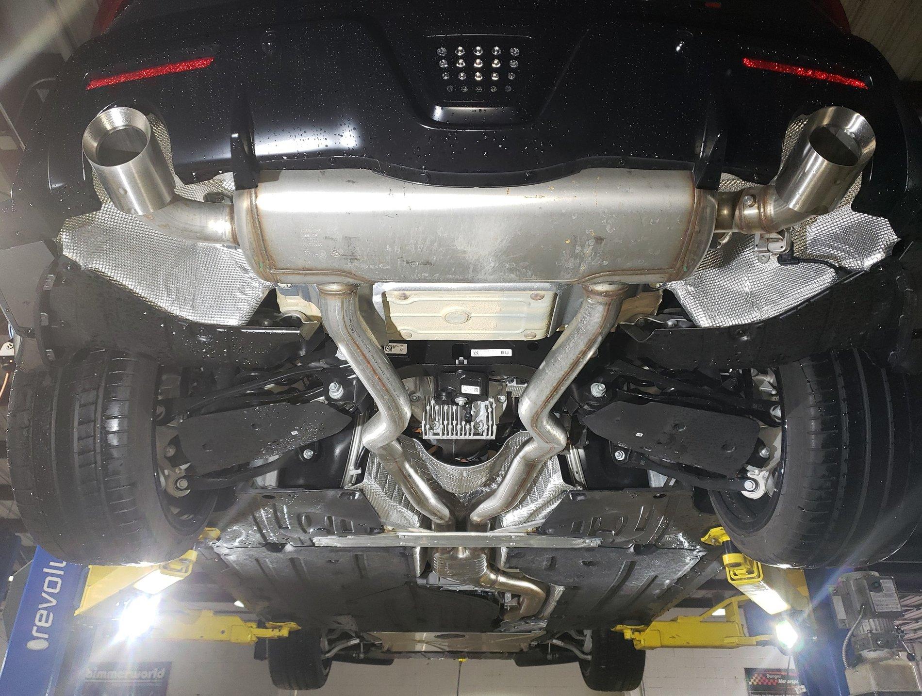

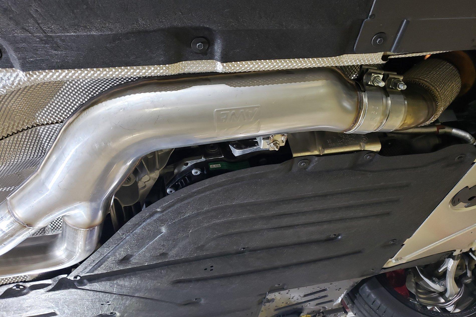

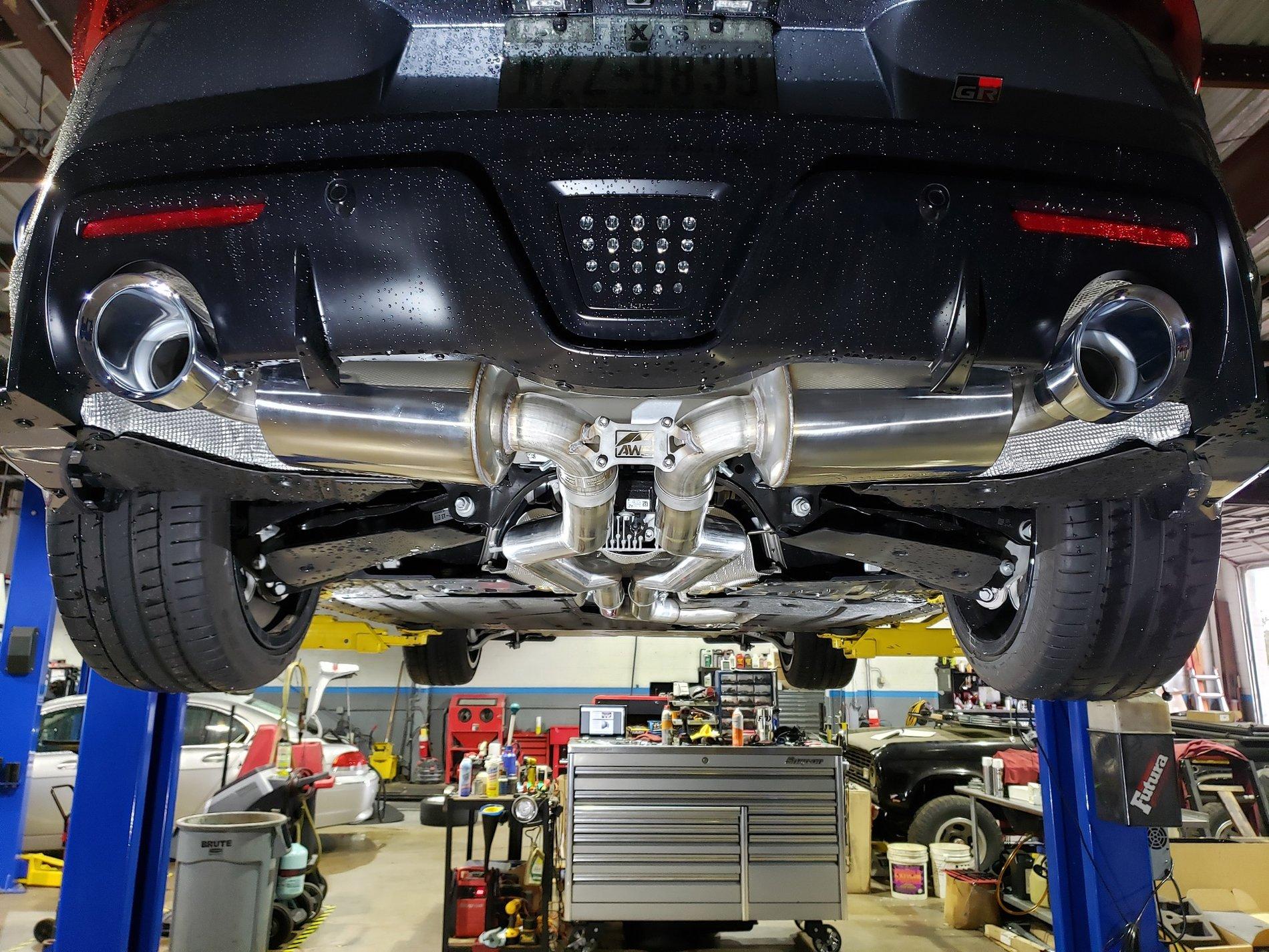

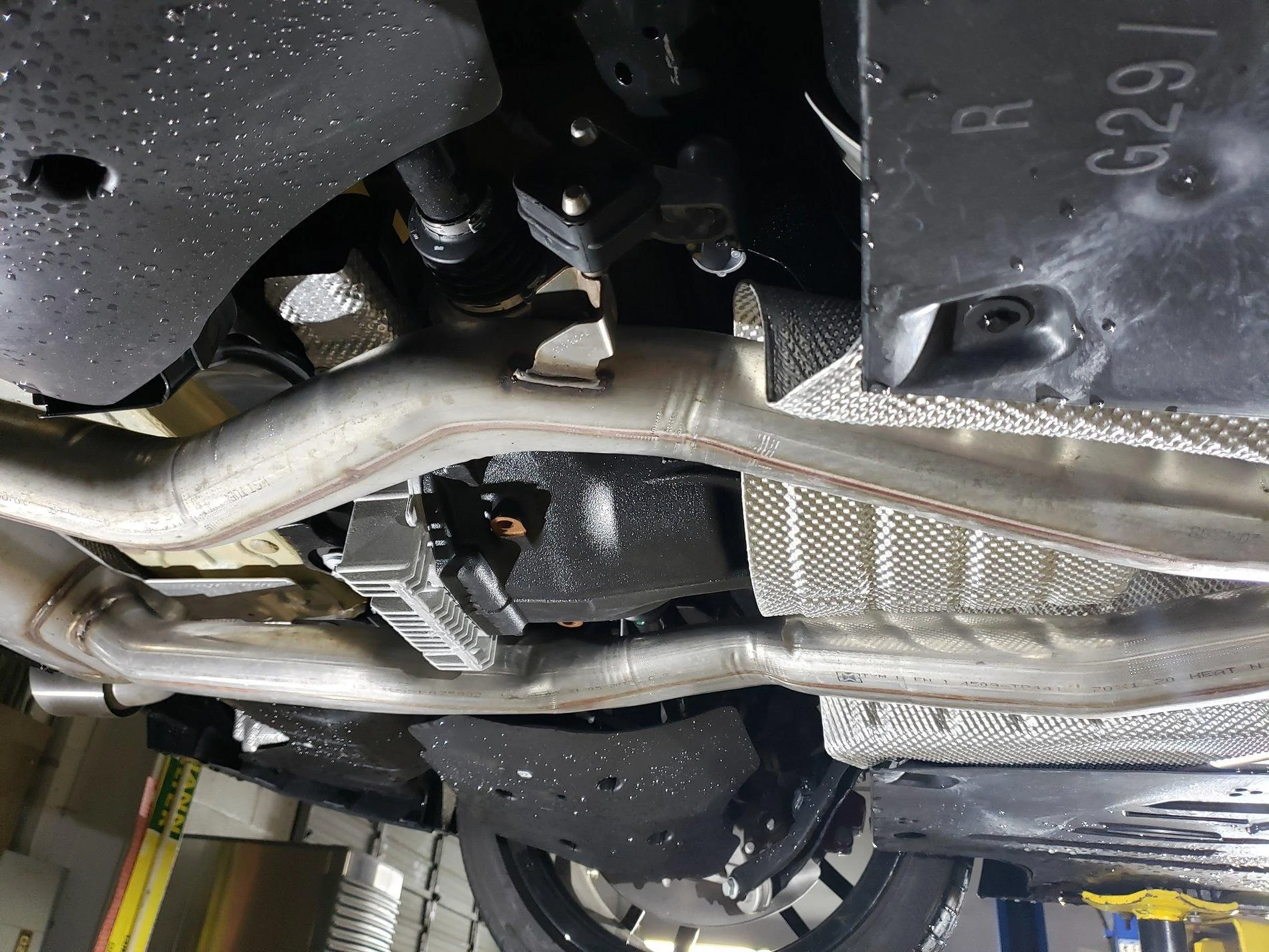

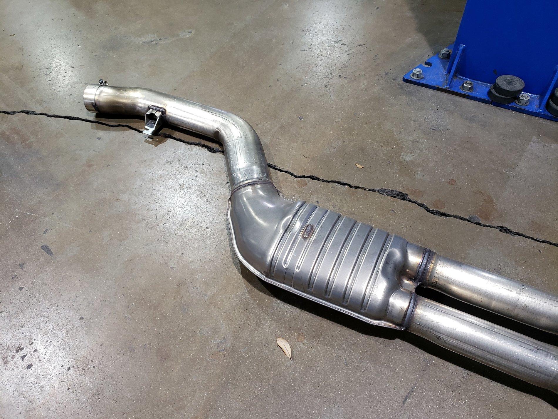

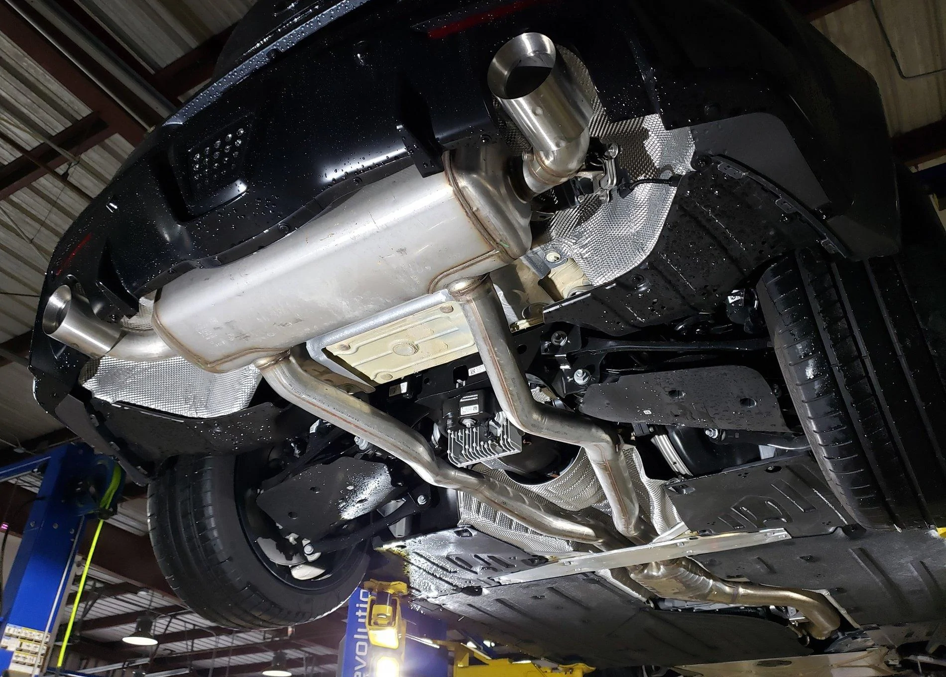

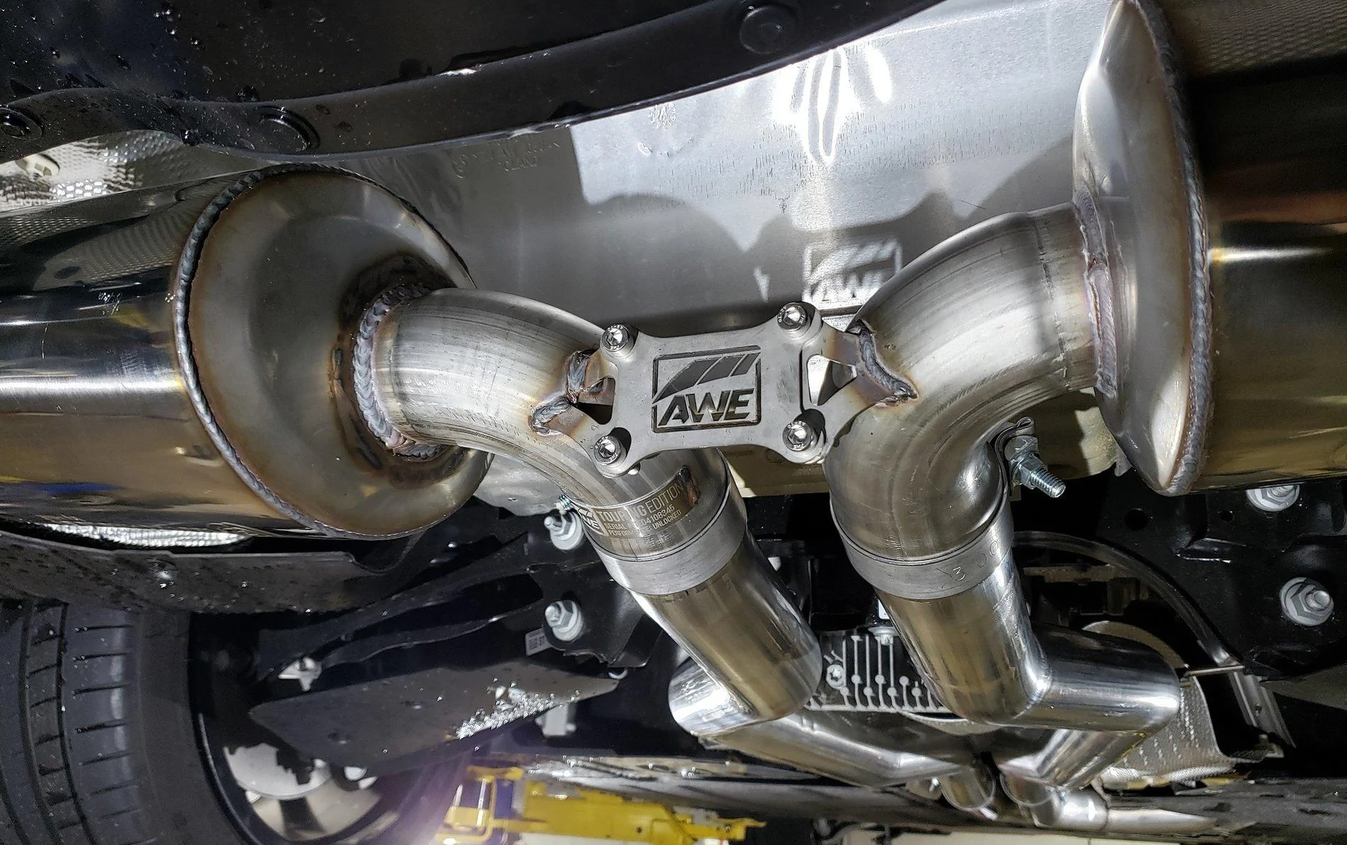

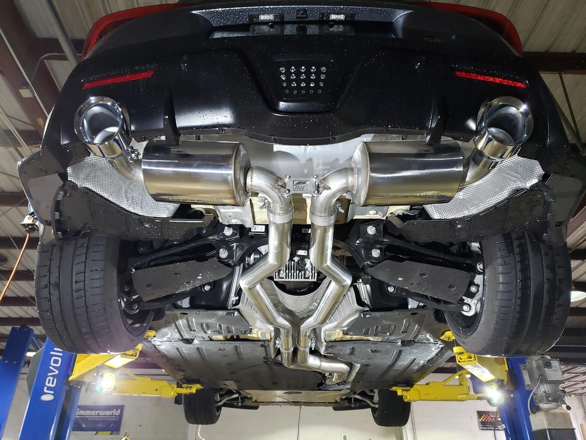

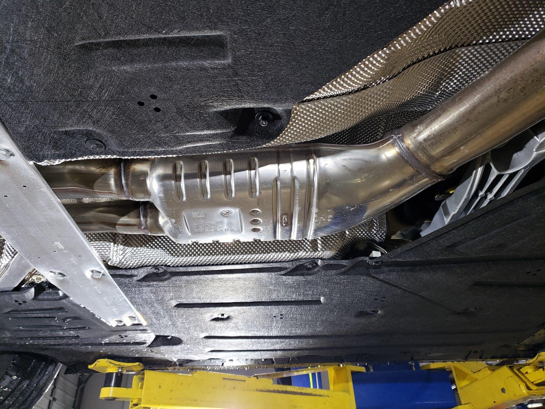

And here are some pictures of the AWE exhaust during installation.

Sorry for the response to a really old thread but I have a question. I just installed my non resonated exhaust. Did the section that comes off the down pipe to the mid pipe (the part that starts as one pipe then splits) did it sit a couple inches lower than the bottom of the car? Mine does, it isn’t as flush as the stock exhaust was and it makes me a little nervous since I’m also installing lower springs lol. Thanks for the help.
Dannyvandelft
Danny
Jan 15, 2019
3,154
4,601
44133
Ordered A91 edition Supra
You didn't install it correctly. You can twist the pipe up so it sits flush. Install the whole thing loosely, then from front to back twist everything up into the tunnel and tighten.

Yeah I think I need to adjust it again. It’s just such a pita lol. Especially doing it on your back.
Another question, did you have some condensation leak from the joints (behind the clamps) while running as I do? AWE said it’s normal but not sure. I know everything is tight and torqued.
I have condensation drip from 1 of my joint (Borla system)...
I'm guessing it's normal?
