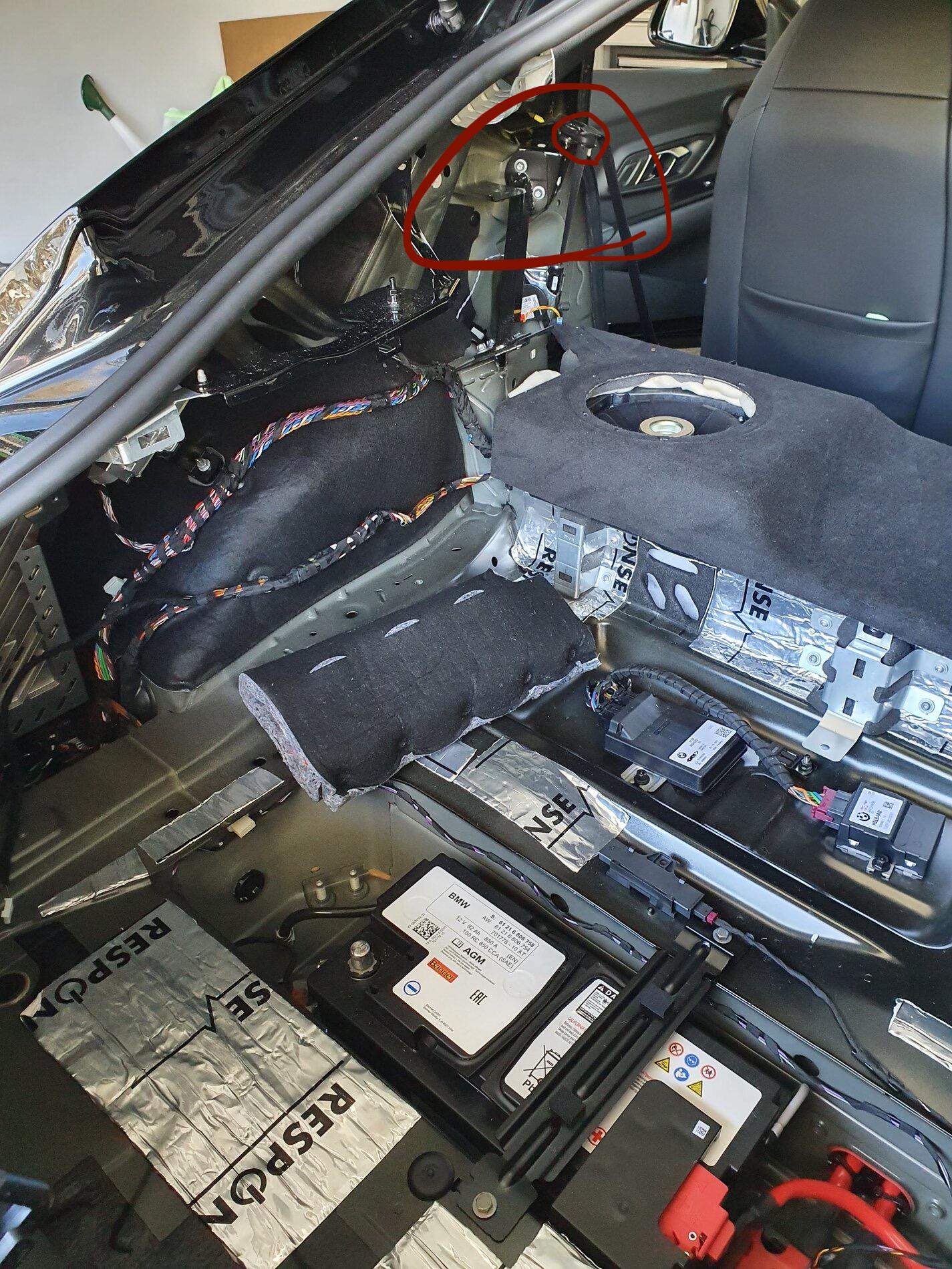

Yes, both sides were rattling over bumps pull the panels off felt tape in areas.
The curves panel comes off first and it's just held with clips then you can pull the top panel above belt also held with clips. It's a bit of trial and error before you eliminate the rattles and squeeks. It's worth doing and hard to break anything.
You may break some clips so. The panel above the belt clips back into place without clips and rattles less without the clips so I actually ended up leaving the clips out.
There is a b pillar piece of plastic that can also creak. It connects to the top plastic piece via a metal clip. The metal clip is the culprit..I ripped it out. Buy plenty of thin foam tape to pad areas where there is plastic on plastic.
I can drive in any surface and bump any angle with zero rattles.
I still have a creaky dashboard but can't seem to find anyone who can tell me how to remove that panel.

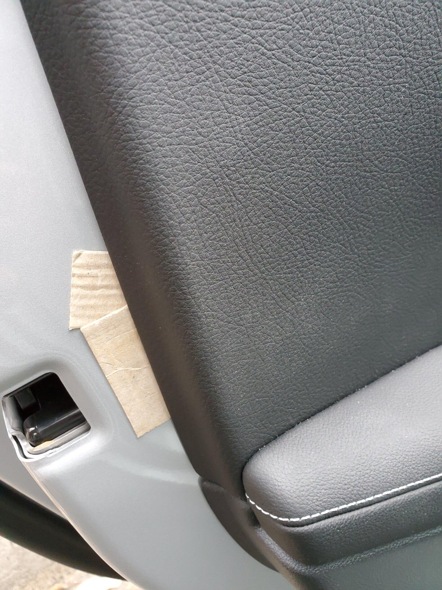

Hey guys,
I may have a very easy rattle fix for the driver and passenger door rattle/buzz when driving.
Fixed it on the driver side, and last weekend it was perfect (long drive suburbia and highway test).
Will do the passenger door rattle fix and test and post solution shortly. (after this weekend)
This rattle has been on these doors since new. It is single handily the most annoying rattle buzz I've ever heard in a new car. It is particularly bad when travelling on coarse road surface and above 20mph. I have isolated where it comes from after much testing.
Finally your ears can relax and enjoy the quiet cabin.
Stay tuned.
:thumbsup:
EDIT:
Ok
Fix is simply to place some cardboard slice near the door locks between plastic and frame.
Good luck all. It may not look great but it does the job. :thumbsup:
