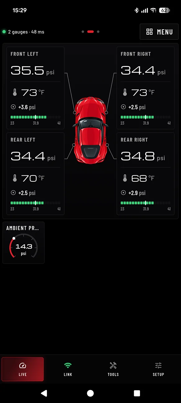

The TPMS gauge is now fully working! Had some issues with incorrect temperature readings in Celsius, but that's all sorted out now
The values are read directly from the DSC module. Updates are fairly slow, around every 10–15 seconds from what I've seen, I need to log this more to be certain, but that's still fine for street use and for the tyre pressure/temperature history log I'm working on
I also noticed that the pressure readings have better resolution than what's shown in iDrive, at least when using bar. For example, iDrive rounds 2.15 bar up to 2.2, while my app displays the actual reading of 2.15 bar
