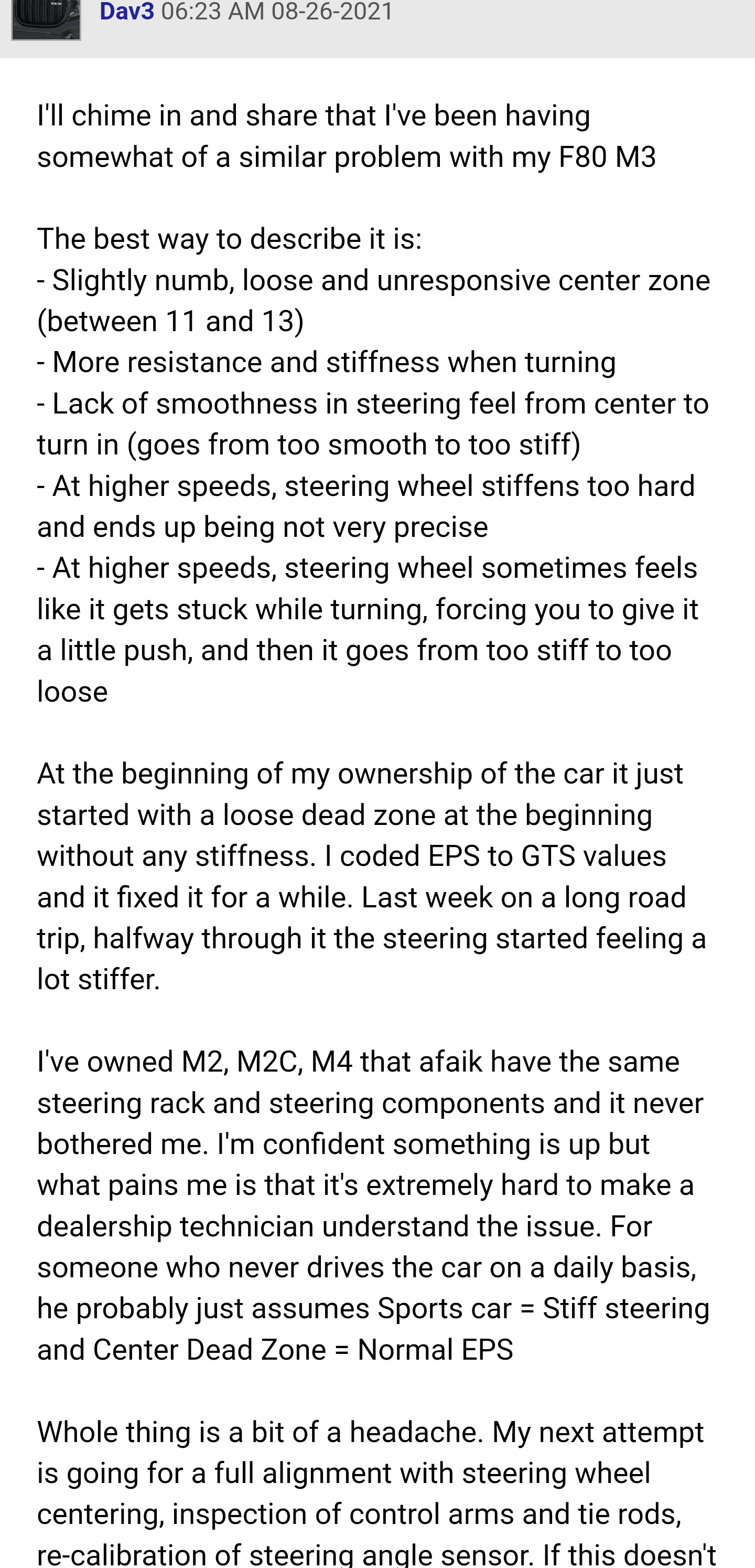

So, my car (2022 Supra) has the same issue. I can’t recall if it started before or after I lowered it on the MSS kit, but the steering at dead center feels “notchy” like it’s skipping or something. It’s hard to explain but there is definitely a steering related issue. I’ve noticed other weird issues like it goes from heavy to light randomly. Can we figure out and commonalities between these cars, if anything at all? Mine is freely aligned, and lowered. That’s it as far as suspension related changes.

There are posts on the BMW forums of this same issue...some have had it fixed by replacing the upper steering column mechanism. Others have taken it to the dealership only to have it diagnosed as a faulty rack...replaced and still have the issue.
