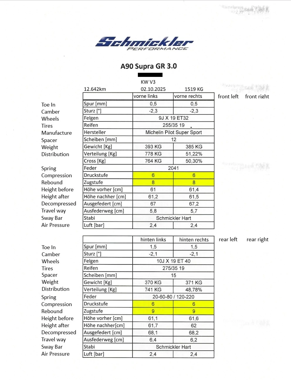

Maybe this helps:
A few days ago, I had stiffer sway bars installed at the front and rear, and the suspension alignment was adjusted as well. When I picked up the car, I immediately noticed that the steering wheel was turned slightly to the left, and I had the same feeling others described — as if the car was driving like a van, with a dead zone in the steering.
During my first drive, the stability control kept kicking in constantly at speeds over 120 km/h. I went straight back to the workshop, and the technician mentioned that they had also noticed the steering wheel was slightly off to the left. He told me that the steering wheel would usually recalibrate itself automatically after a few kilometers.
The car went on the lift several times; they checked and re-centered everything and did multiple test drives. In the end, they had to reinstall the software and reprogram the steering wheel calibration — after that, everything was fine. The whole process took almost two hours until both the shop owner and I were satisfied, the steering wheel was perfectly centered, and the dead zone was gone. They also found it strange that a software reset was necessary in the first place.
Now the car drives really great with the stiffer sway bars — it shows how important proper alignment and a centered steering wheel are. When I first picked it up, the car was almost undriveable. I was honestly scared going over 130 km/h, as the stability control kept intervening for 5–10 seconds at a time and the car felt extremely unstable. Apparently, because the steering wheel was pointing to the left, the system thought I was cornering or sliding sideways, which caused all those unnecessary corrections.
Now that everything is properly set up, the car inspires a huge amount of confidence and feels incredibly stable — from completely undriveable to a car you can just throw into corners.

your car probably needed a proper alignemnt from the beginning. a problem with all the supra that came from the factory
also it sounded like the shop did the alignment without centering the steering wheel... and no the wheel WON'T recalibrate since a non-centered wheel is a mechanical problem (a line the shop used just an excuse)
The alignment on my car had already been done earlier at another workshop when I installed a KW V3 suspension, and yes — the stock suspension settings were terrible. I drove about 10,000 km with that setup before having the sway bars installed.
Yeah, I also found the whole situation a bit strange, since the shop has a pretty big name at the Nürburgring. They’ve won several Trophy Cup races and are known for setting up Schirmer BMWs, including their electronic systems and . They fit their own sway bars (The sway bars are actually made by Eibach to their own specifications) on a large number of Z4s here in Germany, so the installation should have been a routine job for them. I’m not sure if one of the mechanics was already mentally on vacation (the appointment was on a Thursday and Friday was a public holiday), but it definitely wasn’t just about the alignment or the steering wheel position. Otherwise, they wouldn’t have put the car on the lift four times. As I mentioned, i n the end, they had to hook it up to the laptop, reflash the software, and recalibrate everything.
But hey, what do I know. I’m just glad the car now drives exactly the way I wanted it to in the first place.
Edit: I added the alignment Chart. My specifications were that I wanted the KW suspension to be a bit softer again and a setup intended for street use, not for the racetrack.

Literally the only thing that centers the steering wheel are the tie rod lengths. Mechanical. No software updates will change a single damn thing.
Kobold
Patrick
Feb 7, 2024
36
Germany
2024 Supra MT Legend
Yes, you are correct. The steering wheel is mechanically centered by the tie rods, since the Supra / Z4 G29 doesn’t use steer-by-wire.
In my case, it was probably a combination of both:
Mechanically: the tie rods were adjusted unevenly.
Electronically: the steering angle sensor needed to be recalibrated so the system recognizes the new zero position.
At least they finished my car even though the shop had already closed, and they apologized to me several times.
