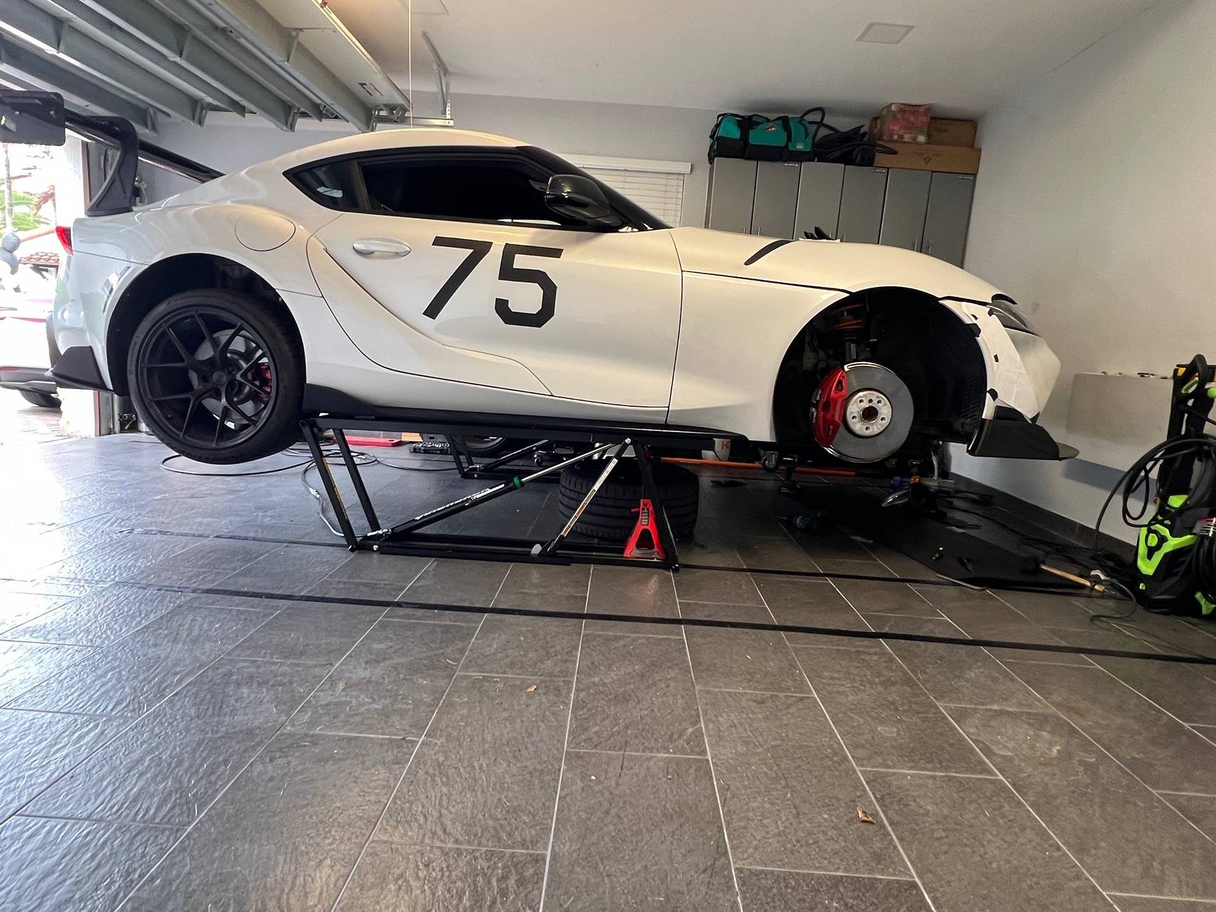

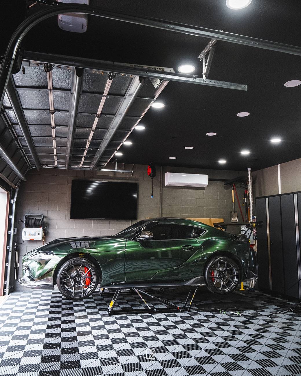

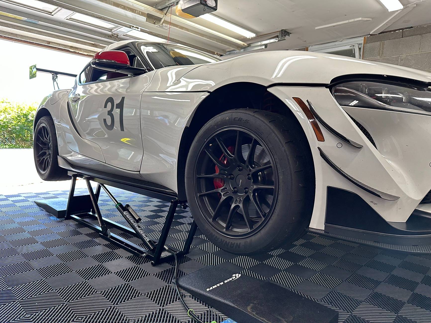

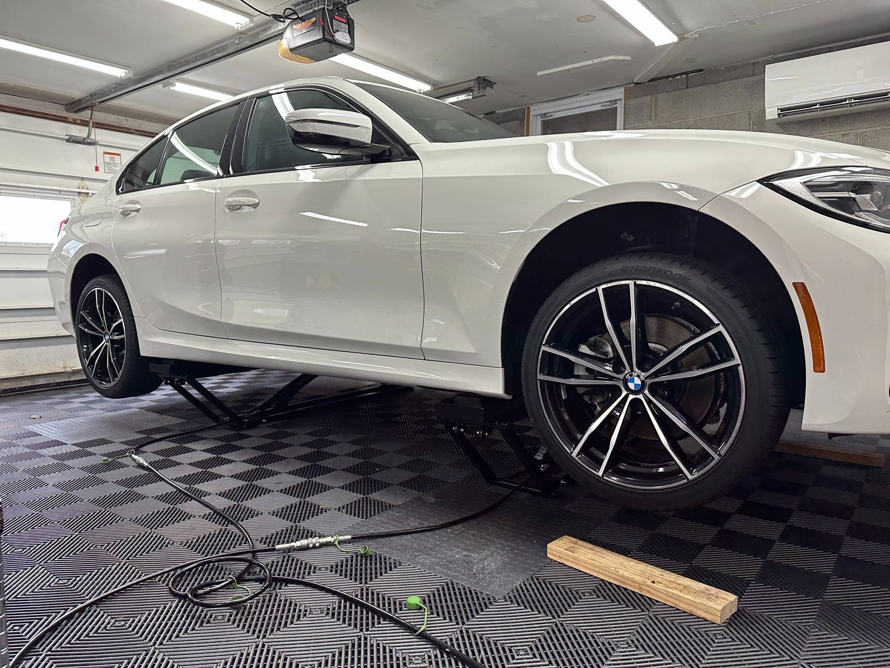

Third/fourthing quick jacks though. The biggest downside with them is, as razorlab pointed out, all models don't work with all cars.

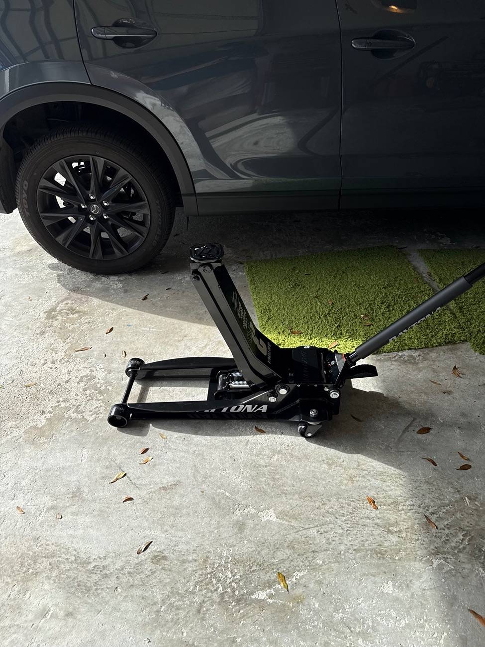

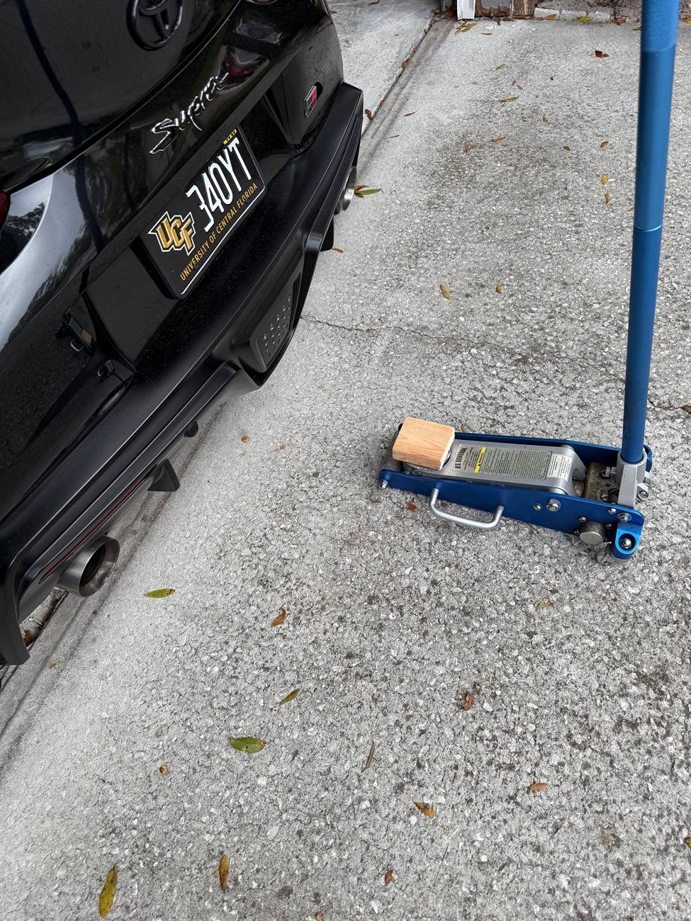

I love the idea of QuickJacks but tbh they are more than what I think I need. Had I invested in a set a few years ago I certainly would have gotten my money's worth, but I'm only getting older, and my desire to spend time on my back under the car is waning.
I can handle this exhaust/downpipe install... just needed to get the car up a bit higher. I think I'm good now.
I’m with you. Quickjacks are the ideal solution but unless you’re under the car every weekend it’s overkill.

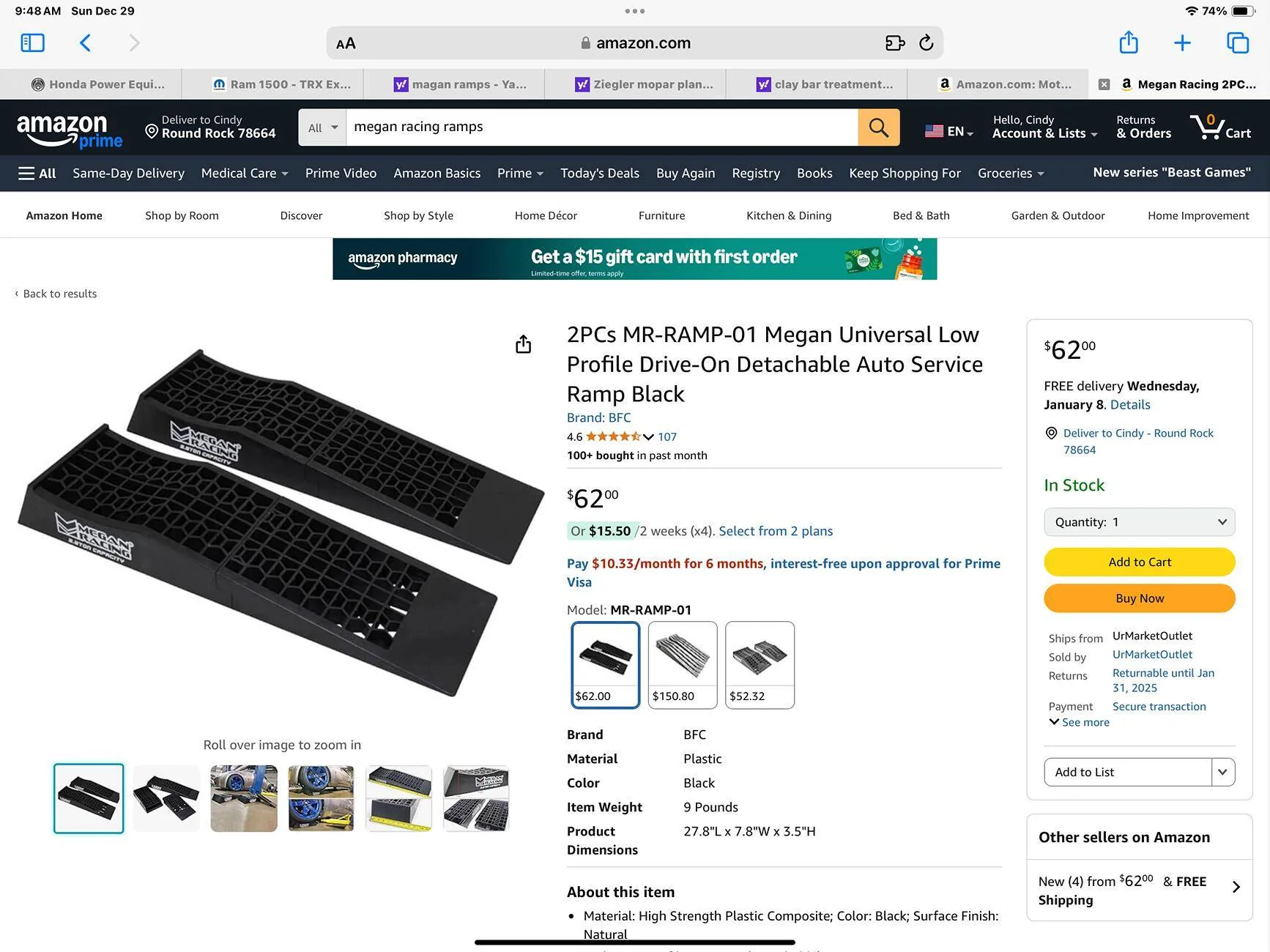

IMO, some flat stopper ramps combined with a long low profile jack and stands is the cheapest solution. You can keep the ramps in the same spots on garage floor all the time and not worry if you leave it parked for a while.
