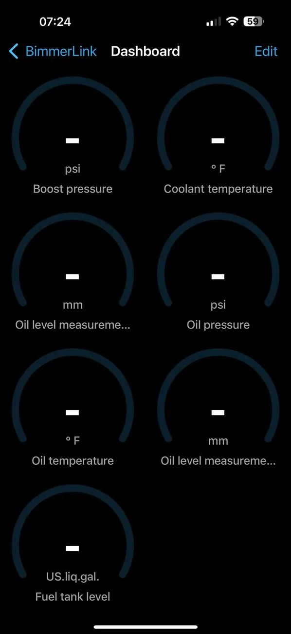

it's linked to pressure being too high, not necessarily oil being too hot.
with the new oil pump, it will do a better job of controlling oil pressure so you won't experience the high pressure scenario that puts the measurement system outside of it's tolerance. that's why it fails at 16%. oil pressure gets to high, so it kicks out an error but doesn't actually throw a code.
@kern417 — I’m unable to get any oil read out in BimmerLink at any time. From your research and videos on this, could this be reflective of an oil sensor issue separate from the pump? Appreciate any thoughts you have on this.
do you mean oil level reading, or oil pressure reading?

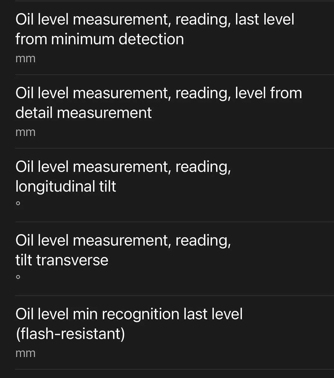

Oil level measurement has never worked in BimmerLink. Which oil measurement setting are you using? Thanks much.
