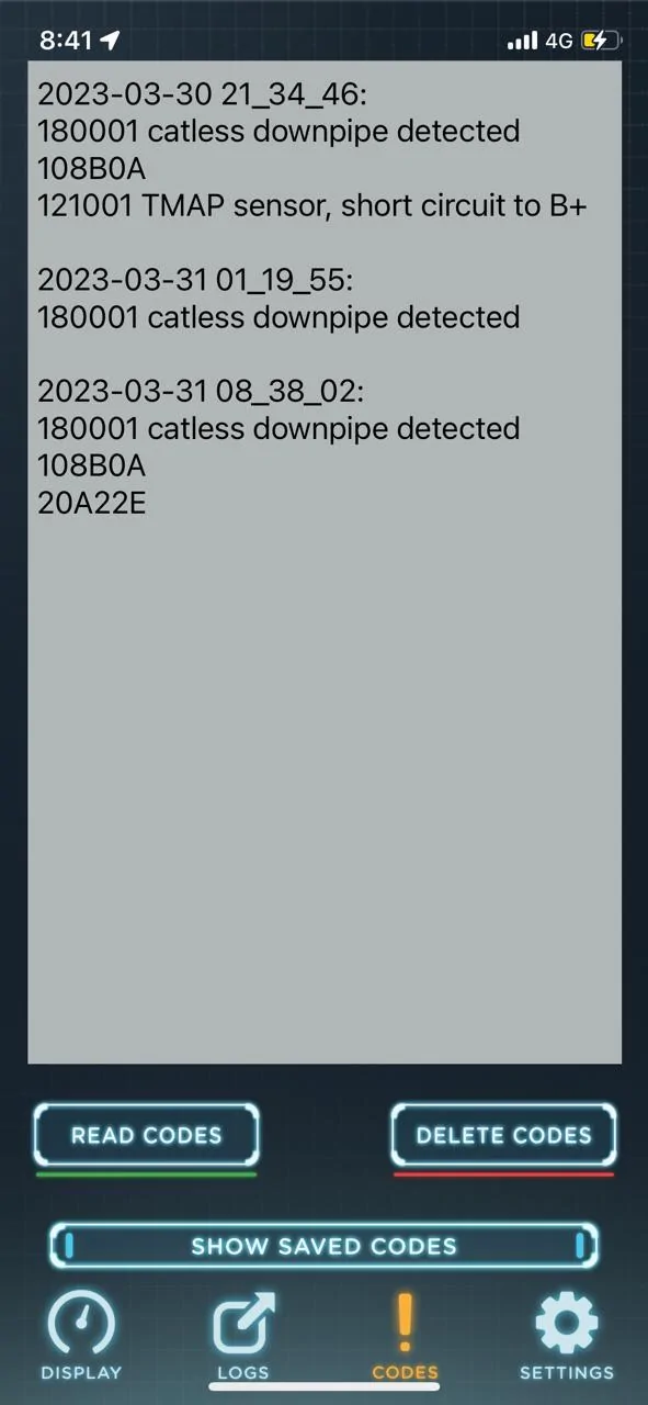

Soo I’ve had the jb4 for about a week or so. It’s been a problem after another first only the boost gauge was working contacted burger motorsports they helped me with that. I ran map 2 for a lil then started noticing my idles is even lower it used to be 750s and now its 650s. Performance was down as well. When I scanned the codes I got
121001 TMAP sensor, short circuit B+
I looked around on the internet looking for answers. Found out it might be a loose sensor. So I checked all the jb4 connections and the air intake sensor as those are the only sensors I touched. I noticed my intake was loose as well as the air intake sensor. So I tightened it up. Air intake sensor moves around a bit but nothing unusual I guess. Started my car up this morning still the performance is down and idk what to do the TMAP sensor is not coming on anymore as I read and deleted the codes before. Any idea what’s going on?

After a thorough investigations of all the sensors and a bunch of other stuff. It turns out it was just the intake clamps that were loose. I pretty much checked every mod I did on the car. I thought I had a downpipe leak, but the turbo gets louder on map 2 and a bit less burbles also shifting sounds weird, but turns out its normal. Everything is functioning normally now. However I did get 2 codes that I'm not sure what they mean. I got the usual catless downpipe code that's normal, but I got 108B0A / 20A22E dont know what these codes mean. I contacted BMS they gave me an explanation for one.
20A22E:
Coolant pump in low-temperature
coolant circuit: locking detected,
switch off
I dont know what it means or what it does. Other than those 2 codes everything seems normal.

I’m not sure if it threw a CEL, because I have a catless dp and it always has a CEL on so I’m not sure. I was just scanning for code’s because I had the TMAP sensor code come up. I was trying to get it again, but it didn’t so just to make sure everything is fine I contacted BMS about the other 2 codes make sure it’s nothing and then they gave the explanation to one code which I mentioned above. Everything went back to normal. Idk if I did anything wrong or right. Maybe the connections were not connected right or something was wrong I’m not sure. However everything is fine now. I just want to know if these codes are nothing to worry about or I need to do something about them.
