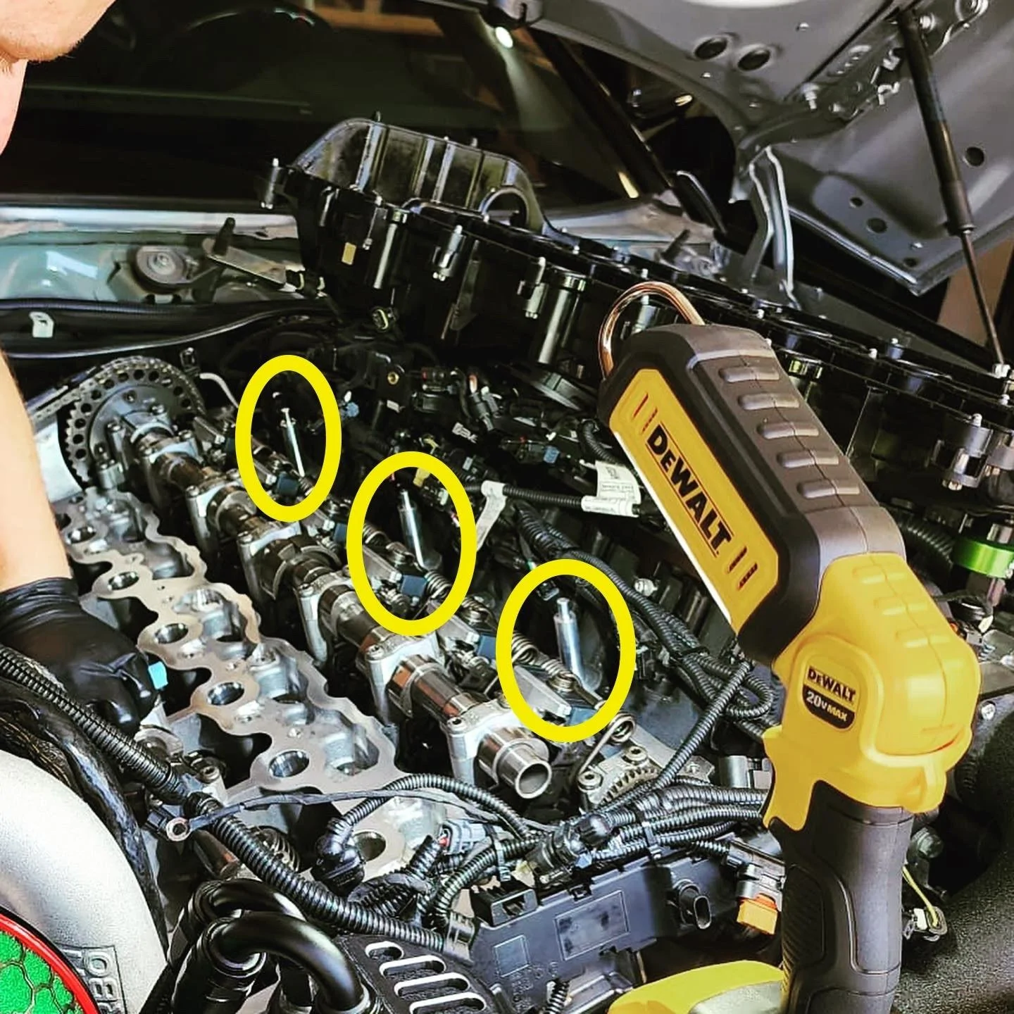

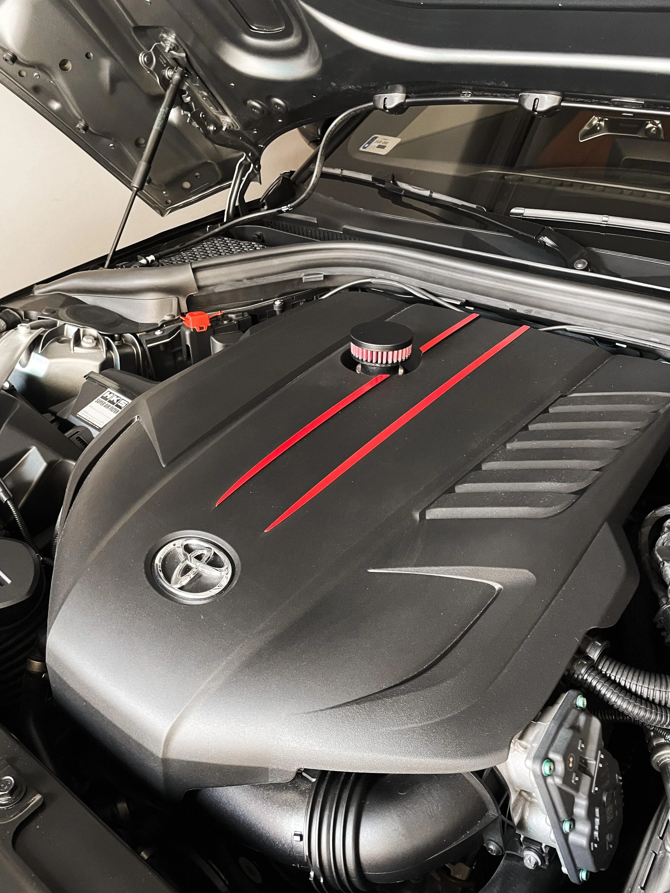

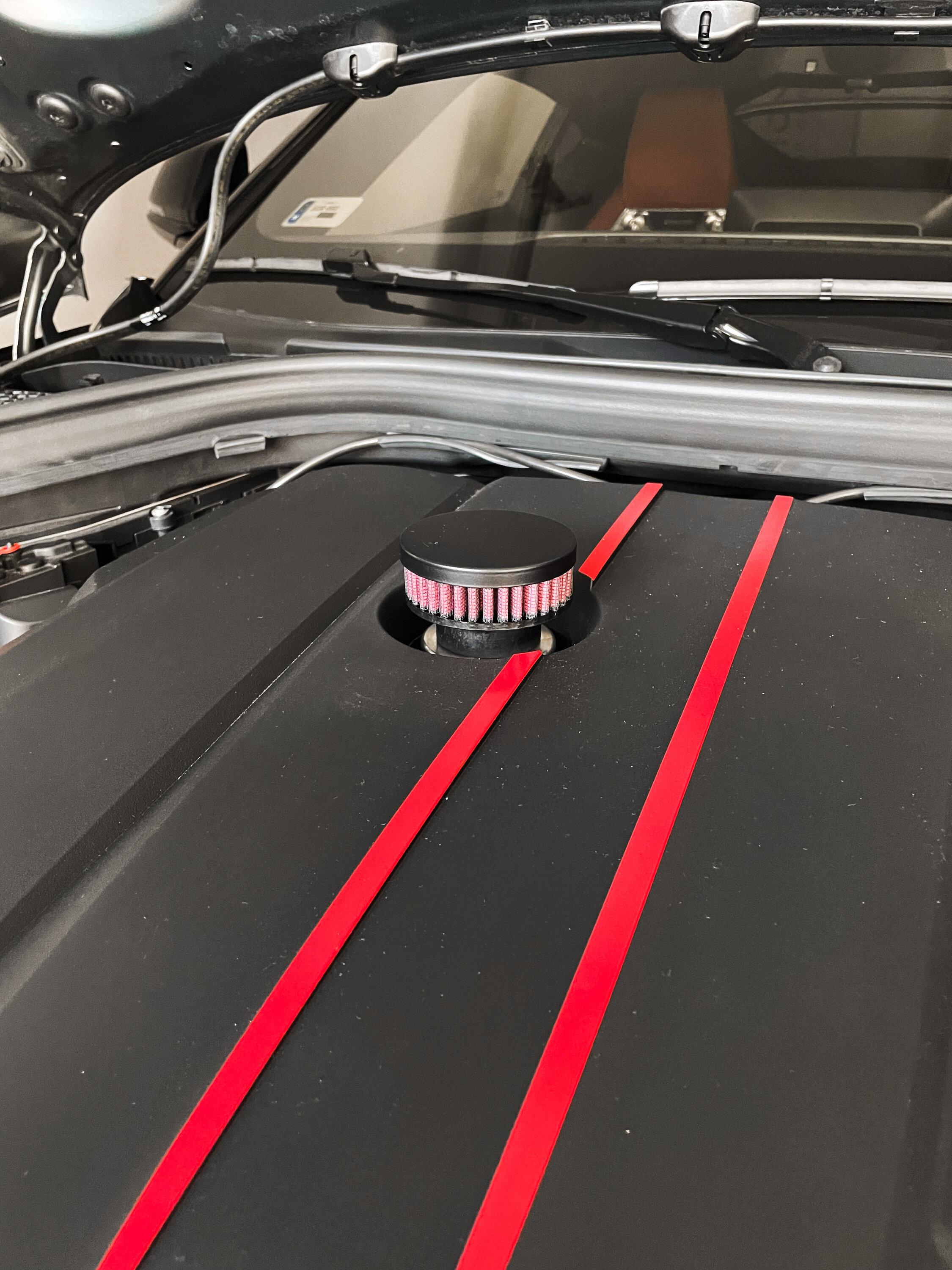

Are you running the PCV line that comes out of the block onto your catch can? The KLM fitting does not have the one way check valve in it, so it will just fill up the KLM can. Highly suggest removing your catch can and checking to see how full it is/emptying is. Guarantee its completely full of oil and has nowhere else to go.
On mine I capped the engine block PCV port and just ran the VTT oil cap breather instead.
Also: Suggest getting either PCV port block pins or a Visconti valve cover upgrade to compensate.
Thanks a lot!!
I’ve seen people Cap theirs like yours but I wasn’t sure what they did with the block fitting. And yeah my catch can was filling up like a can of oil every 1-2 weeks shit was not normal
I ordered the Visconti cover already. Definitely gonna cap off the block fitting now

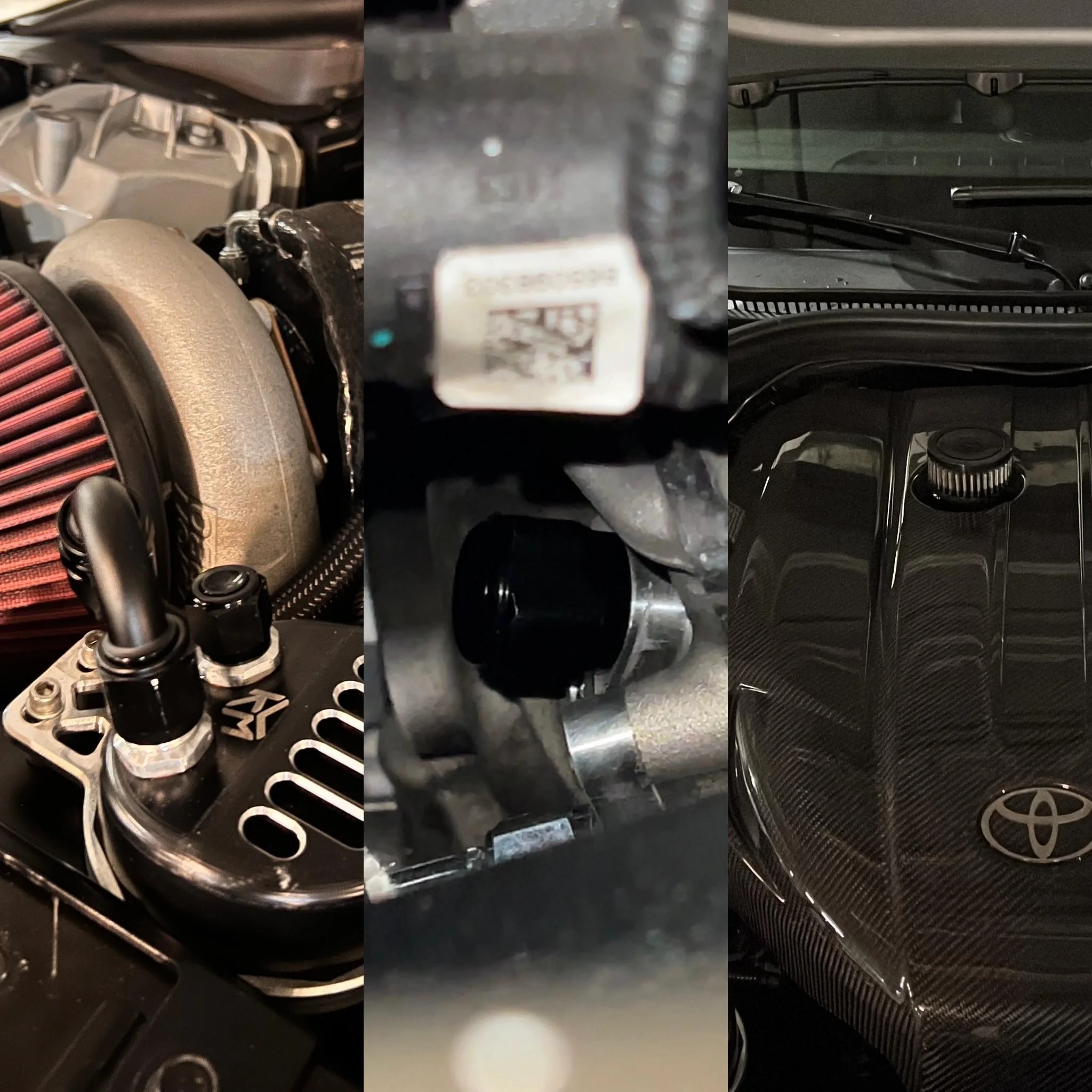

Also where did you get those caps at?

You can also take the OEM fitting and fit a barbed fitting on to the end of it to put a breather on it. The factory check valve on the block is actually a one-way INTO the block not out of it. However Capping it works fine as well. ?
I ordered them on Amazon actually.

The valve on the block goes INTO the block? Wow.
Could you please share a link to the block valve cap on Amazon?
