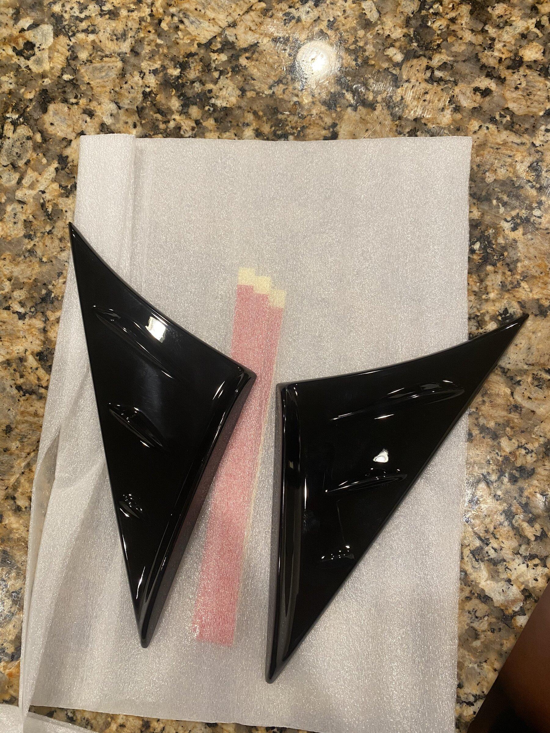

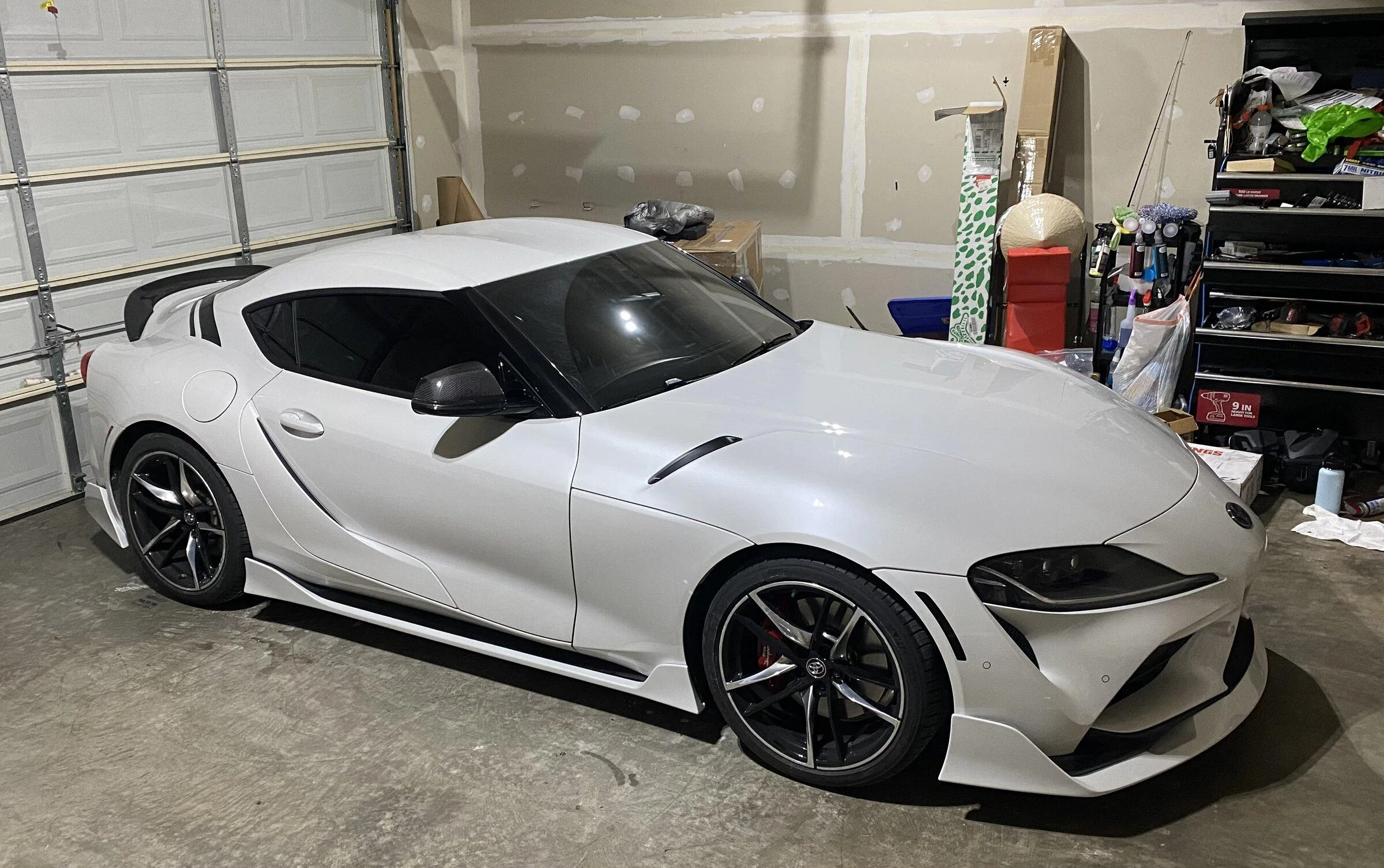

Added Seibon duckbill and A91 gloss black stripes

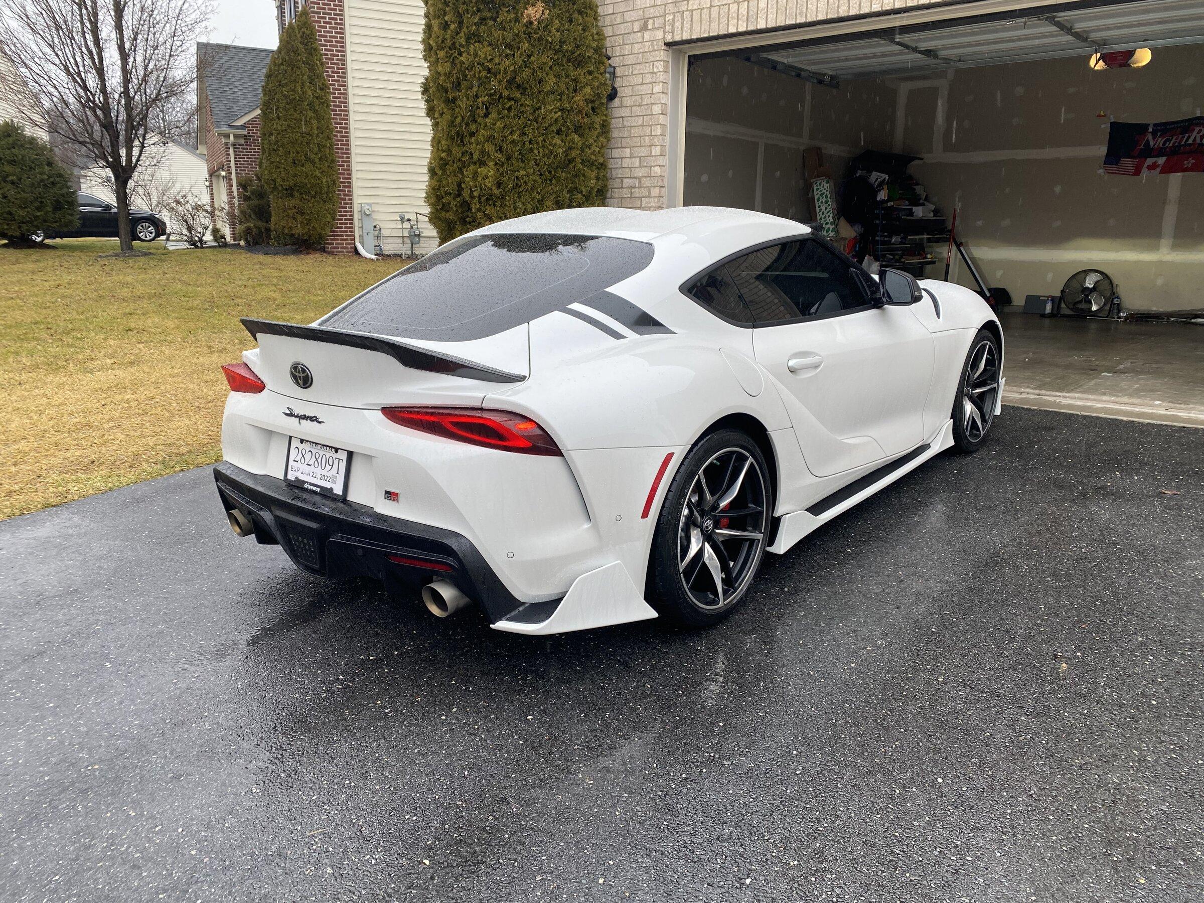

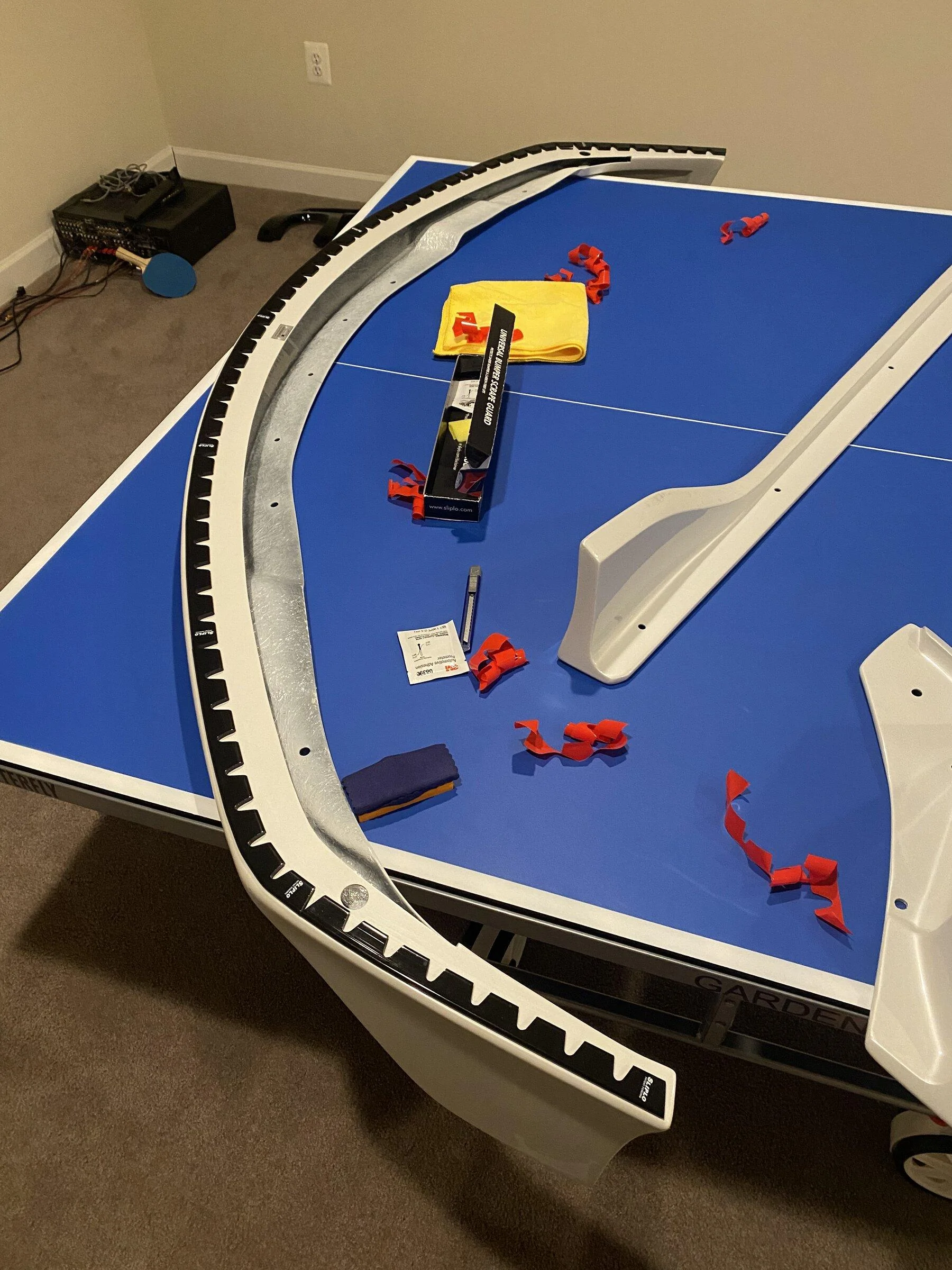

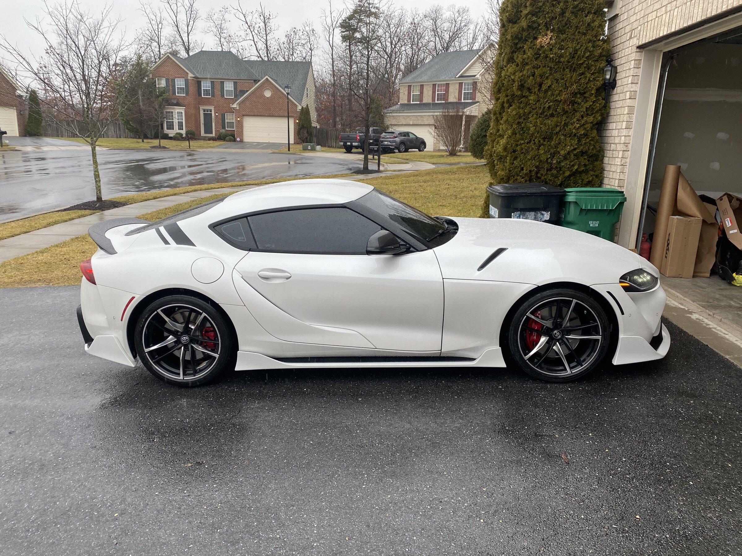

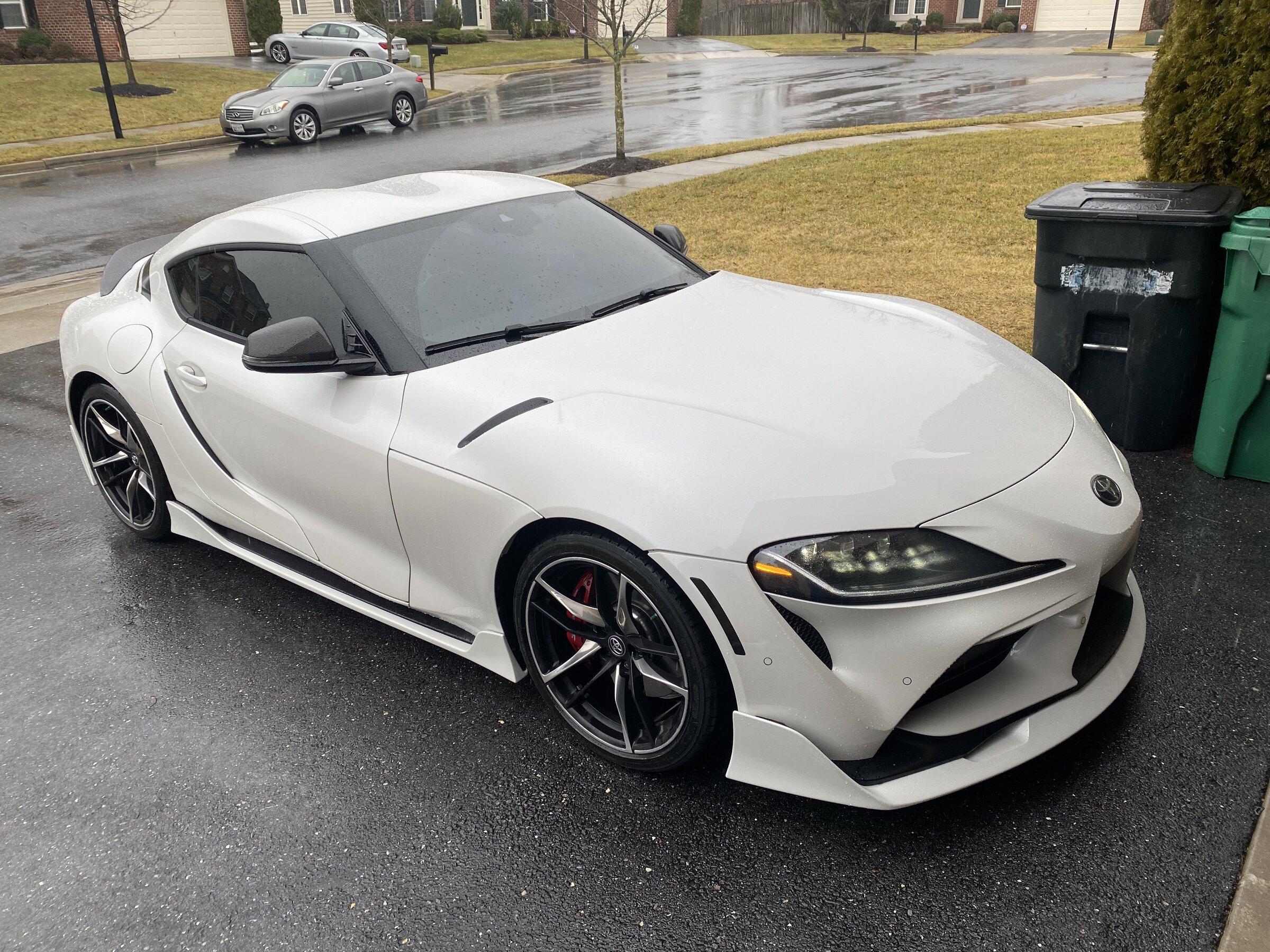

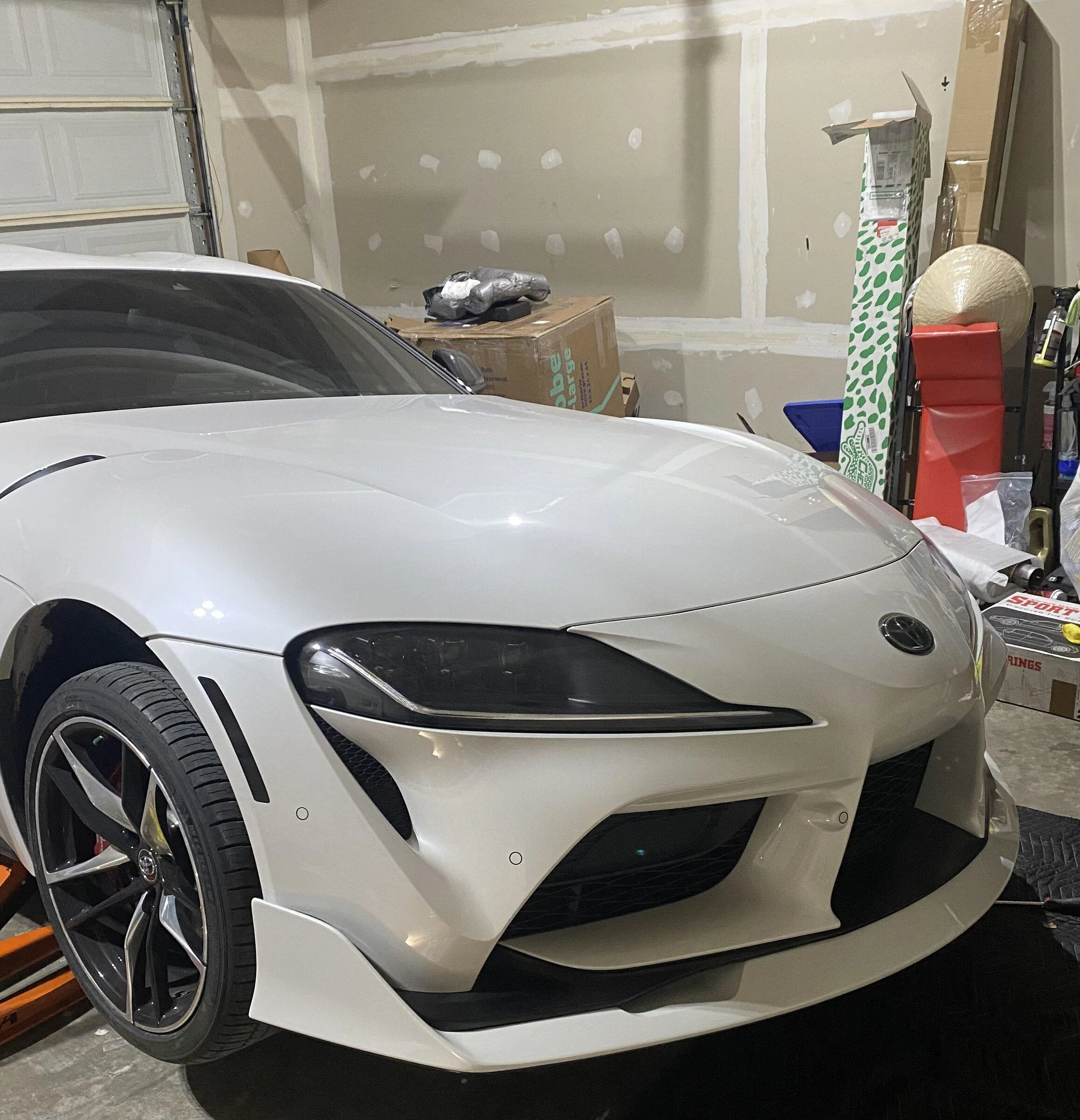

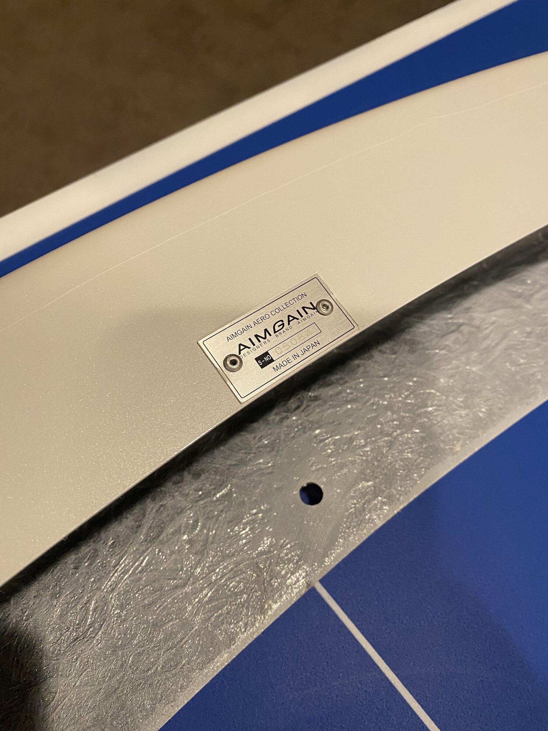

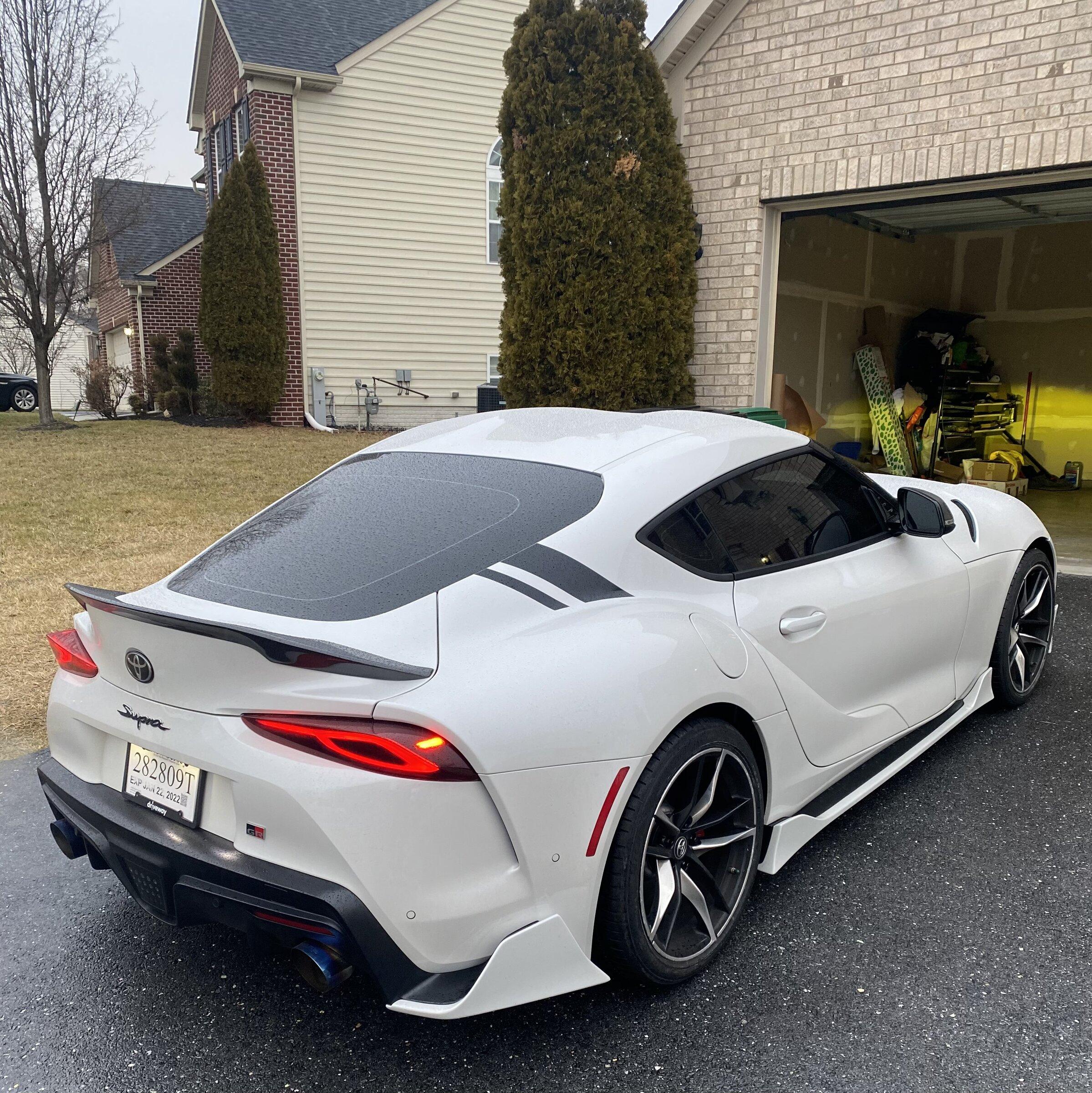

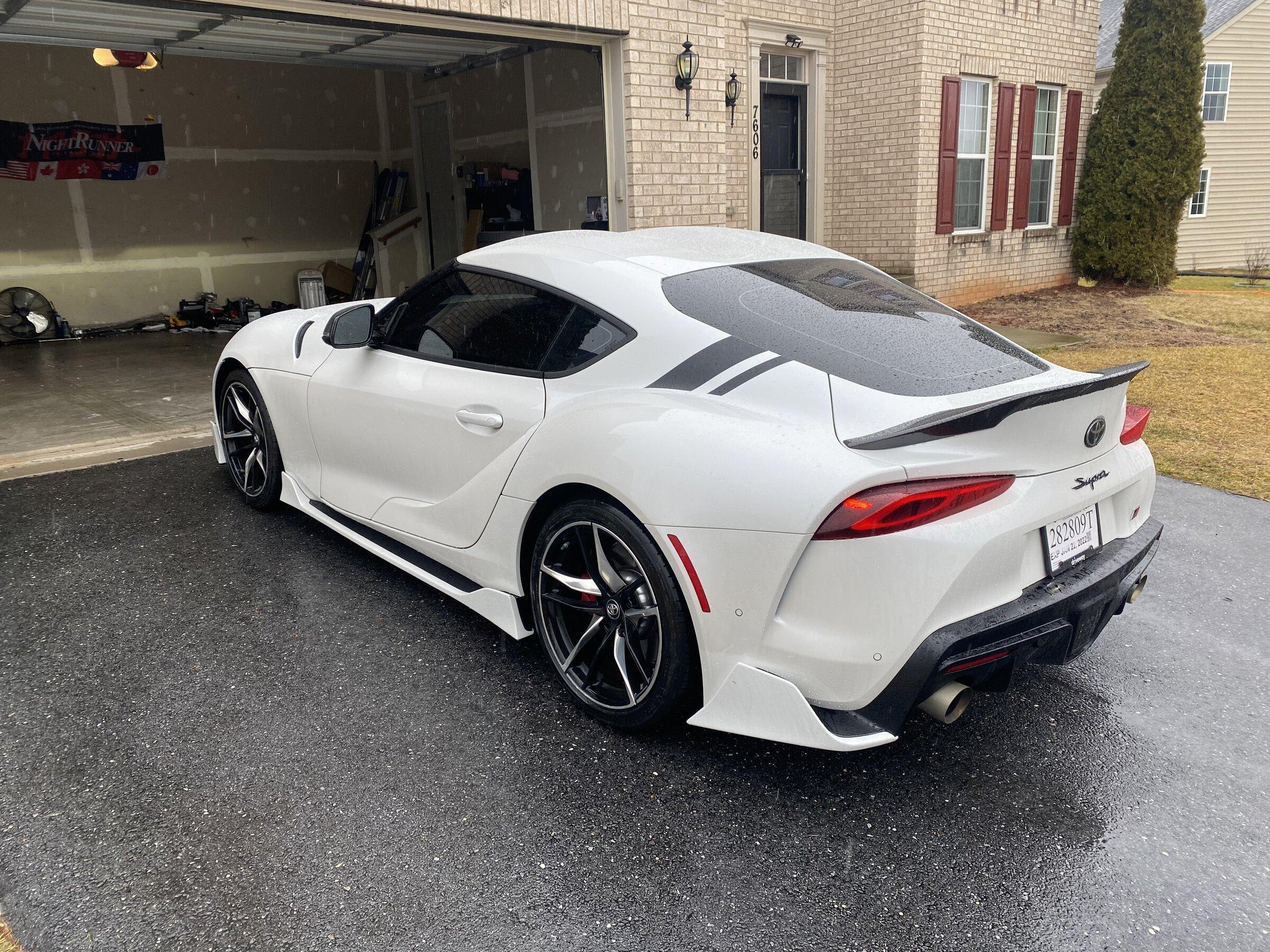

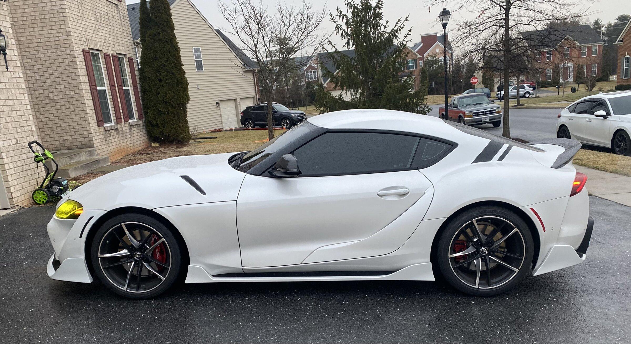

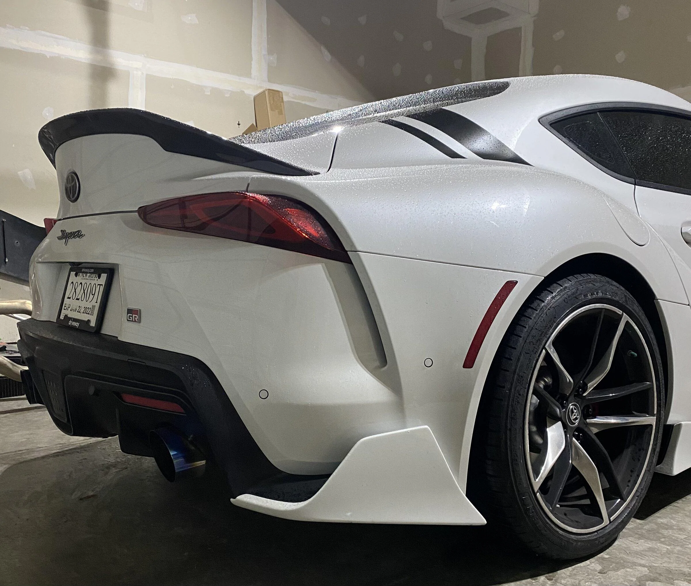

2/3/22 Authentic Aimgain Type1 lip kit paint matched
Ppf’d and ceramic coated the pieces myself. Sliplo on the lip for protection
Diffuser hasn’t been put on yet. Haven’t had time yet. I painted it gloss black but now wondering if I should’ve also painted it white, but we’ll see once i get the diffuser on
Also need to wash the car lol. Paint match spot on, but cars very dirty lol

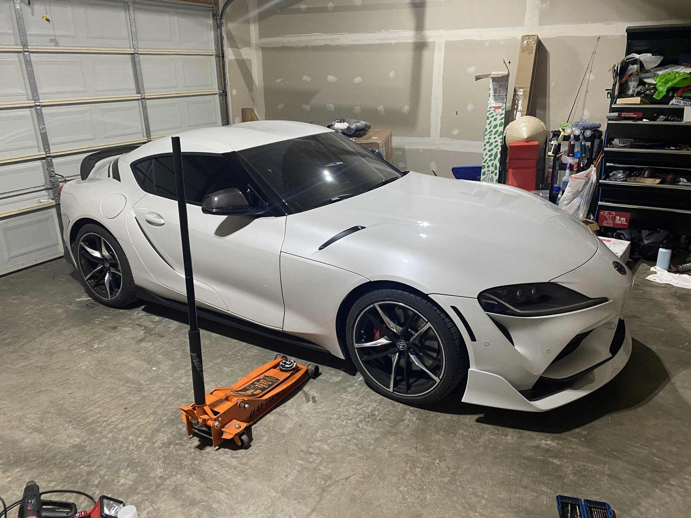

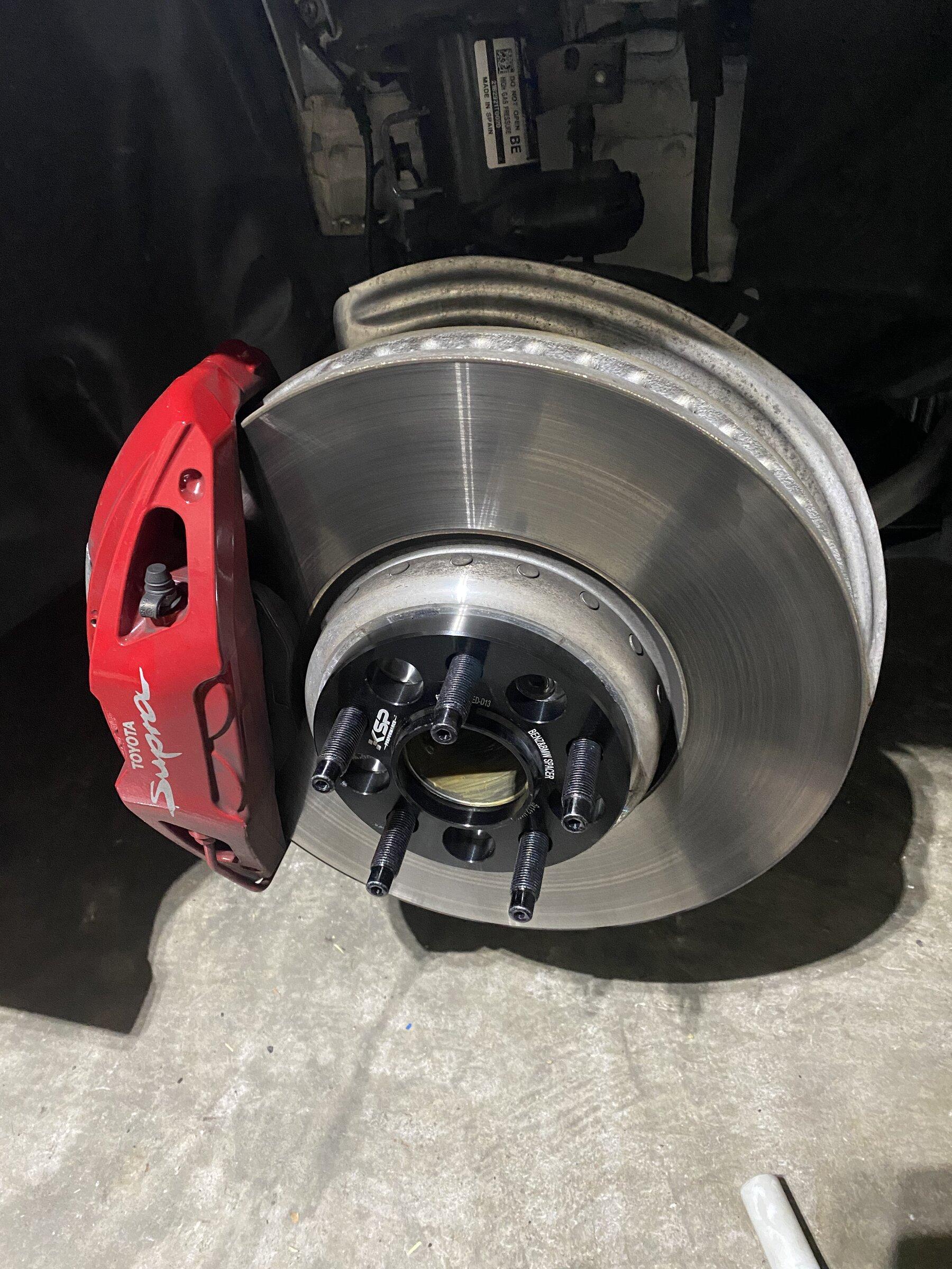

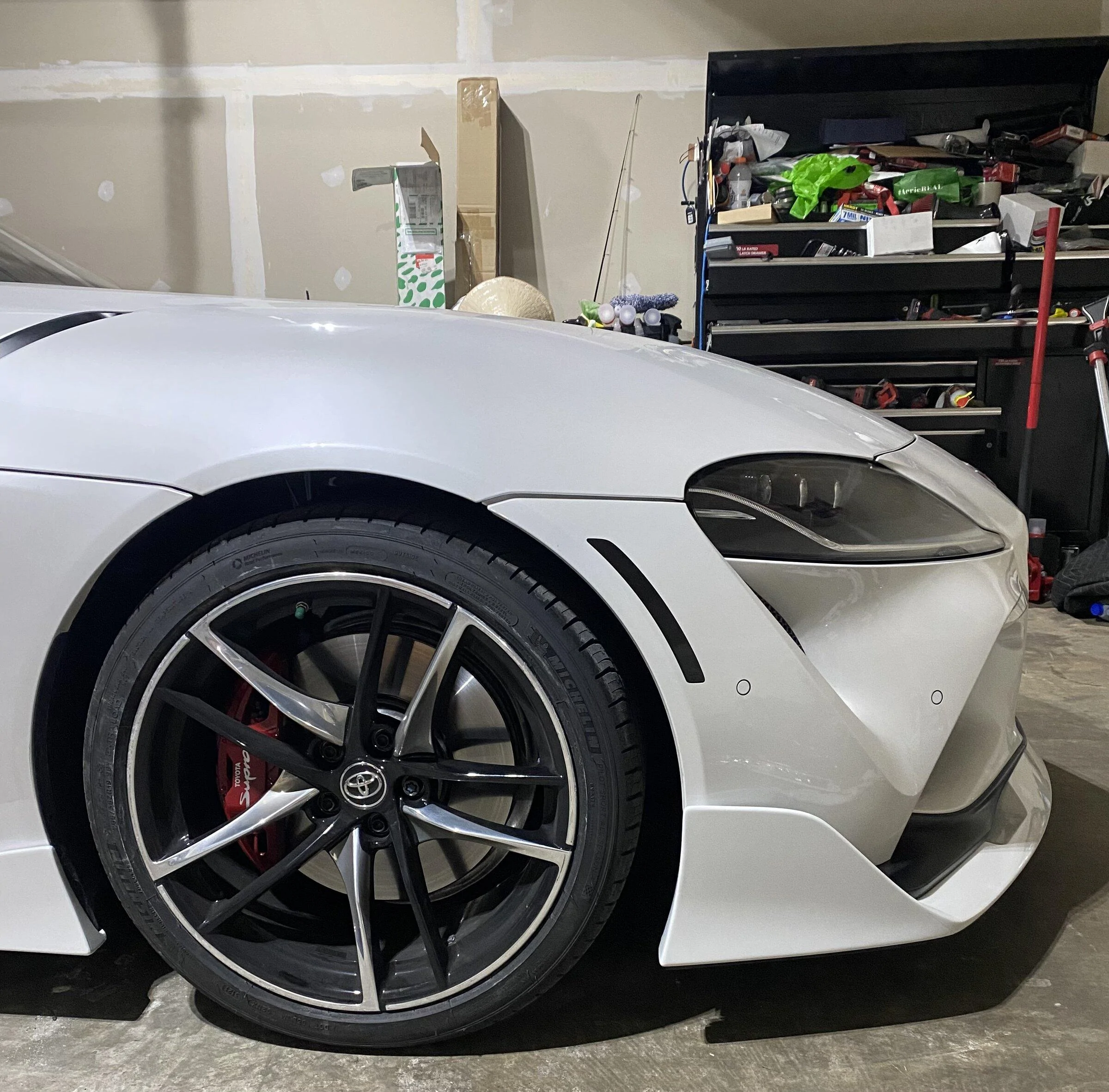

2/7/22

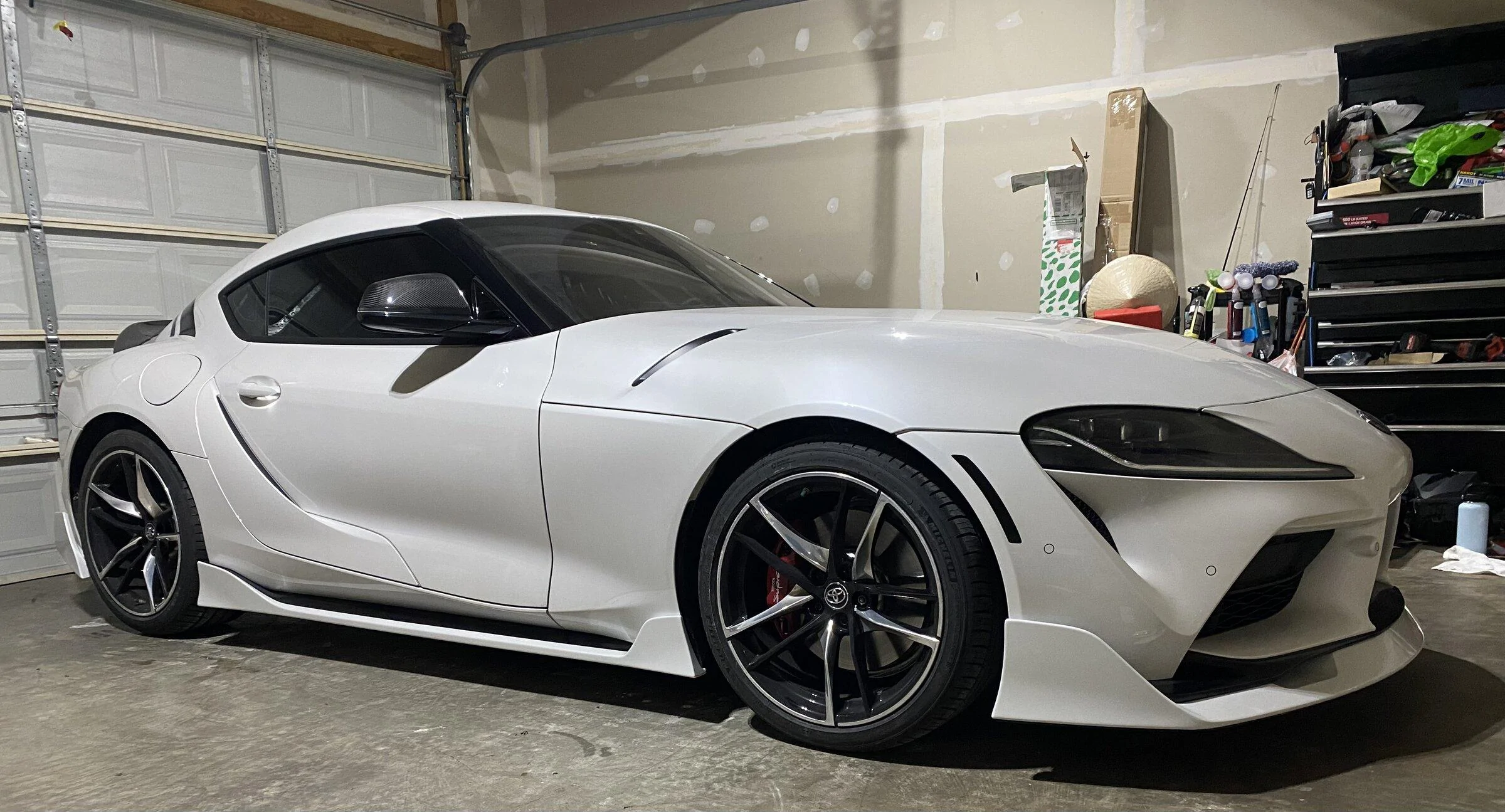

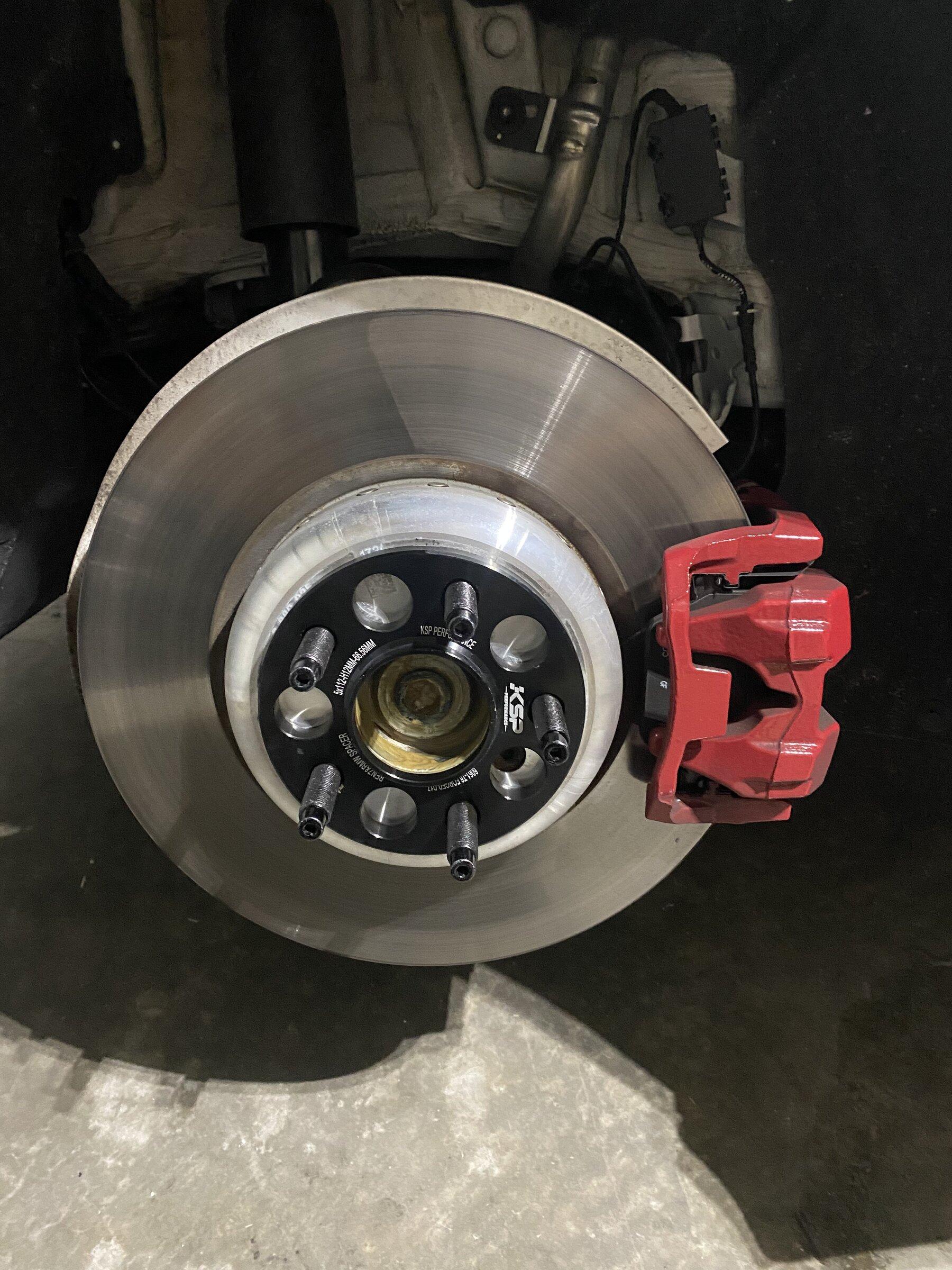

Stud conversion with black conical nuts and KSP spacers 15mm fronts 12mm rears from amazon.
Spacers fit snug on both the hub i test fitted and oem wheels. Good mount of saving over the other more expensive ones
https://motorsporthardware.com/product/78mm-black-bullet-nose-race-stud-kit-14x125-14x15/
KSP 5X112mm Wheel Spacers,12mm... https://www.amazon.com/dp/B0834KBW5M?ref=ppx_pop_mob_ap_share
KSP 5X112mm Wheel Spacers,15mm... https://www.amazon.com/dp/B0834KSLD9?ref=ppx_pop_mob_ap_share

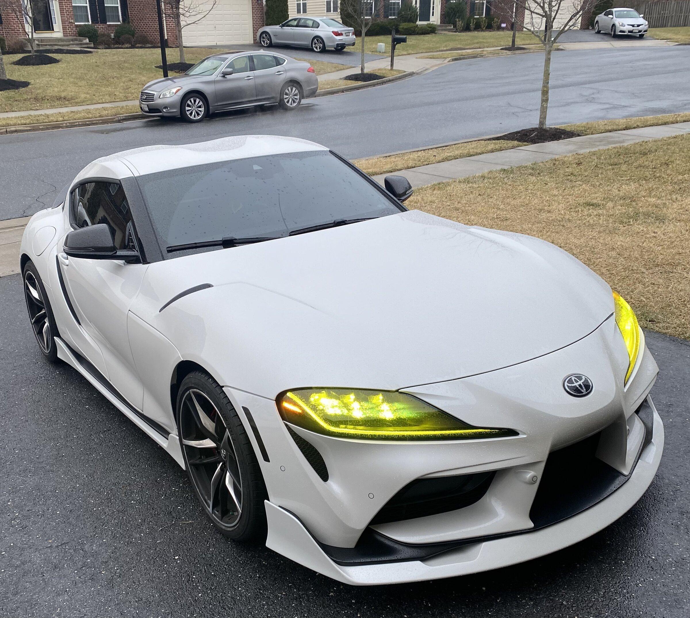

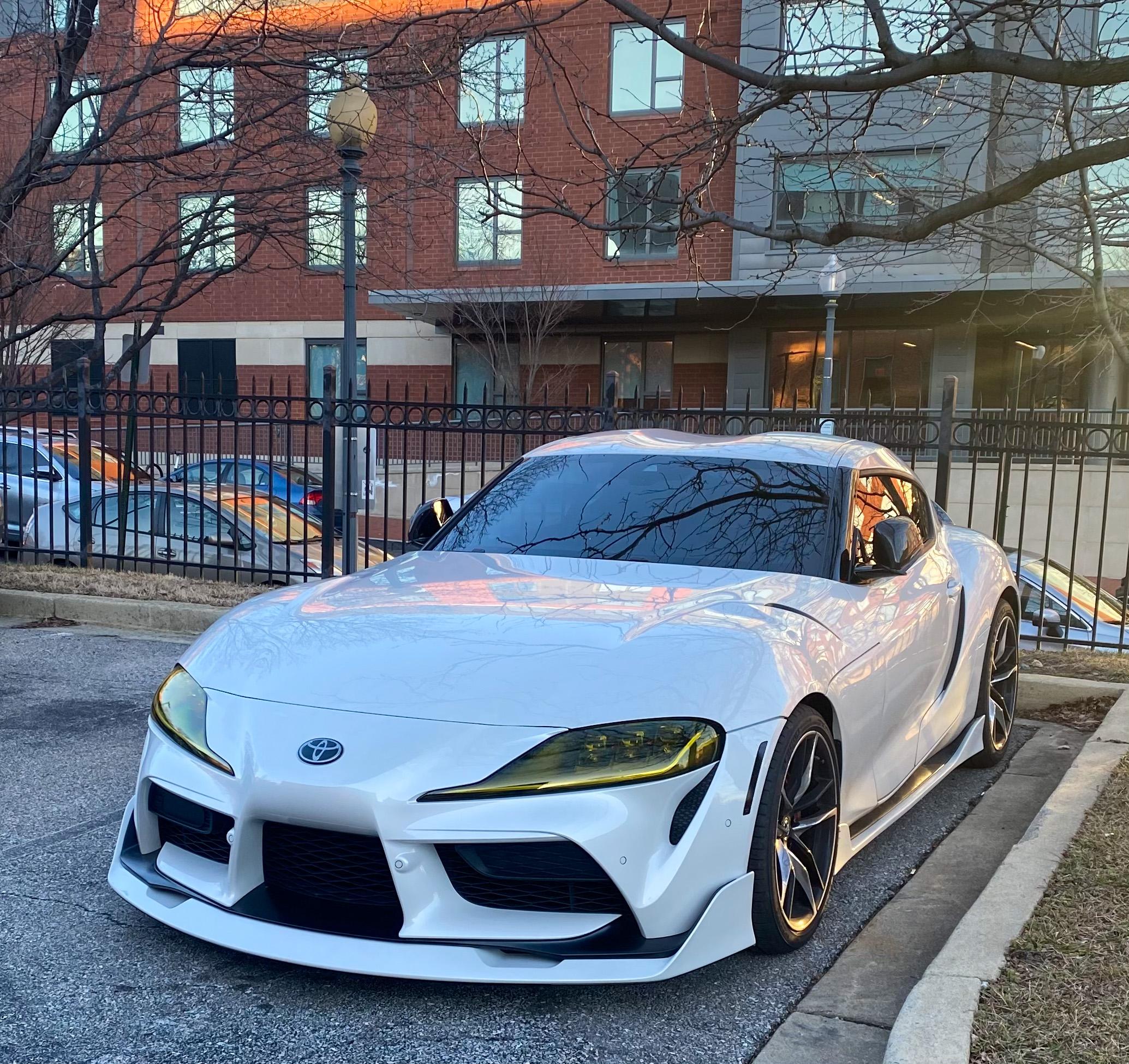

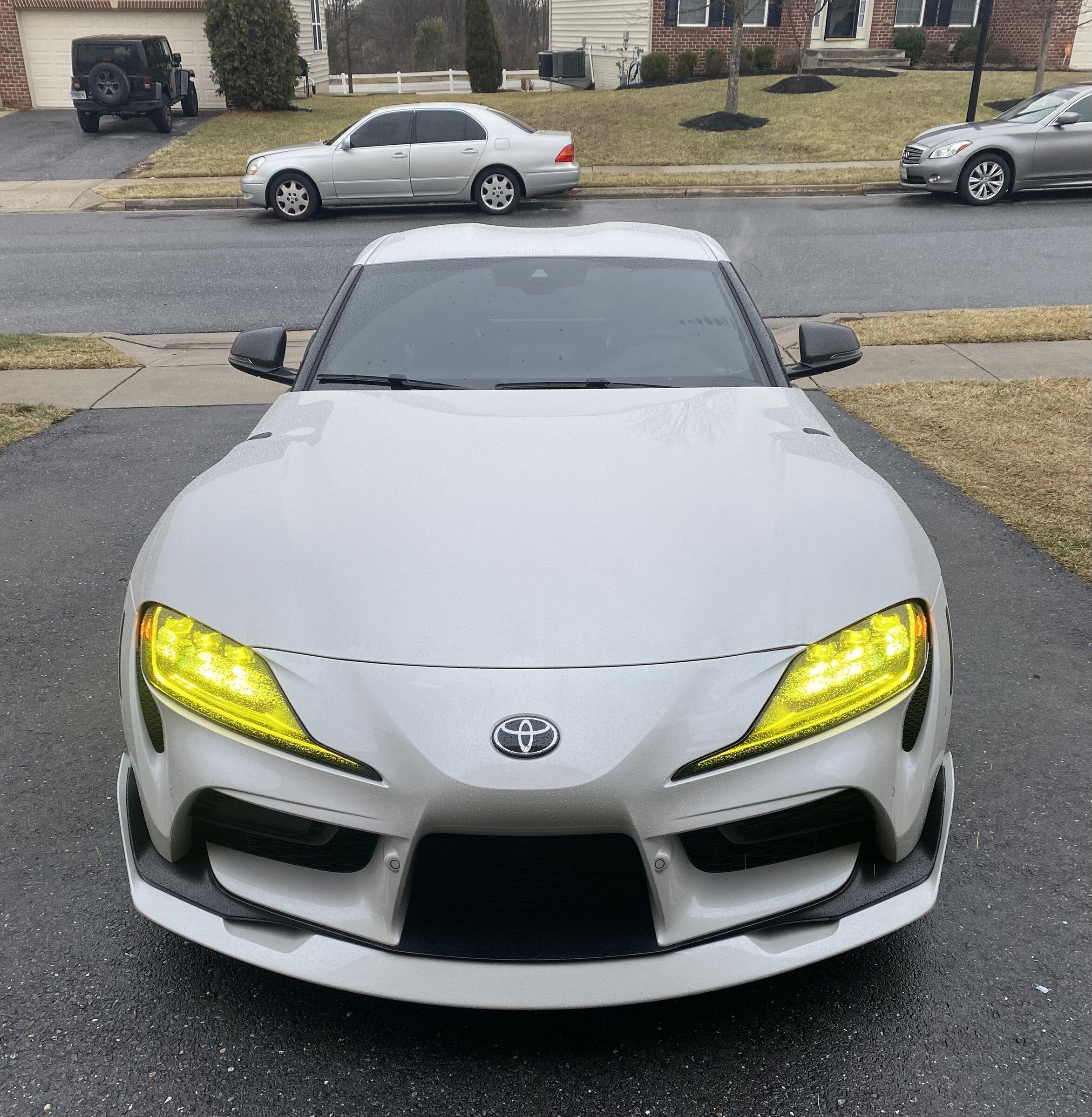

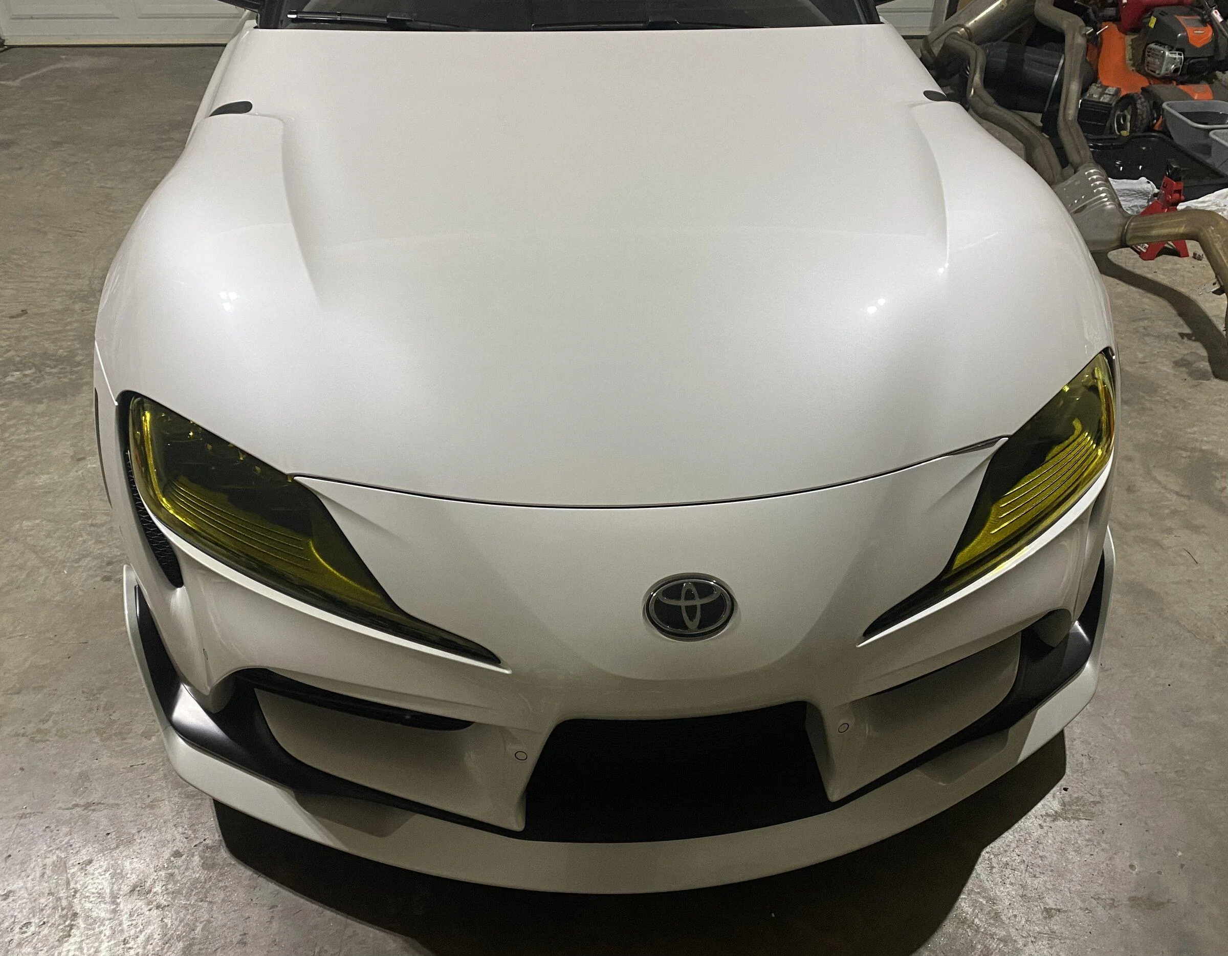

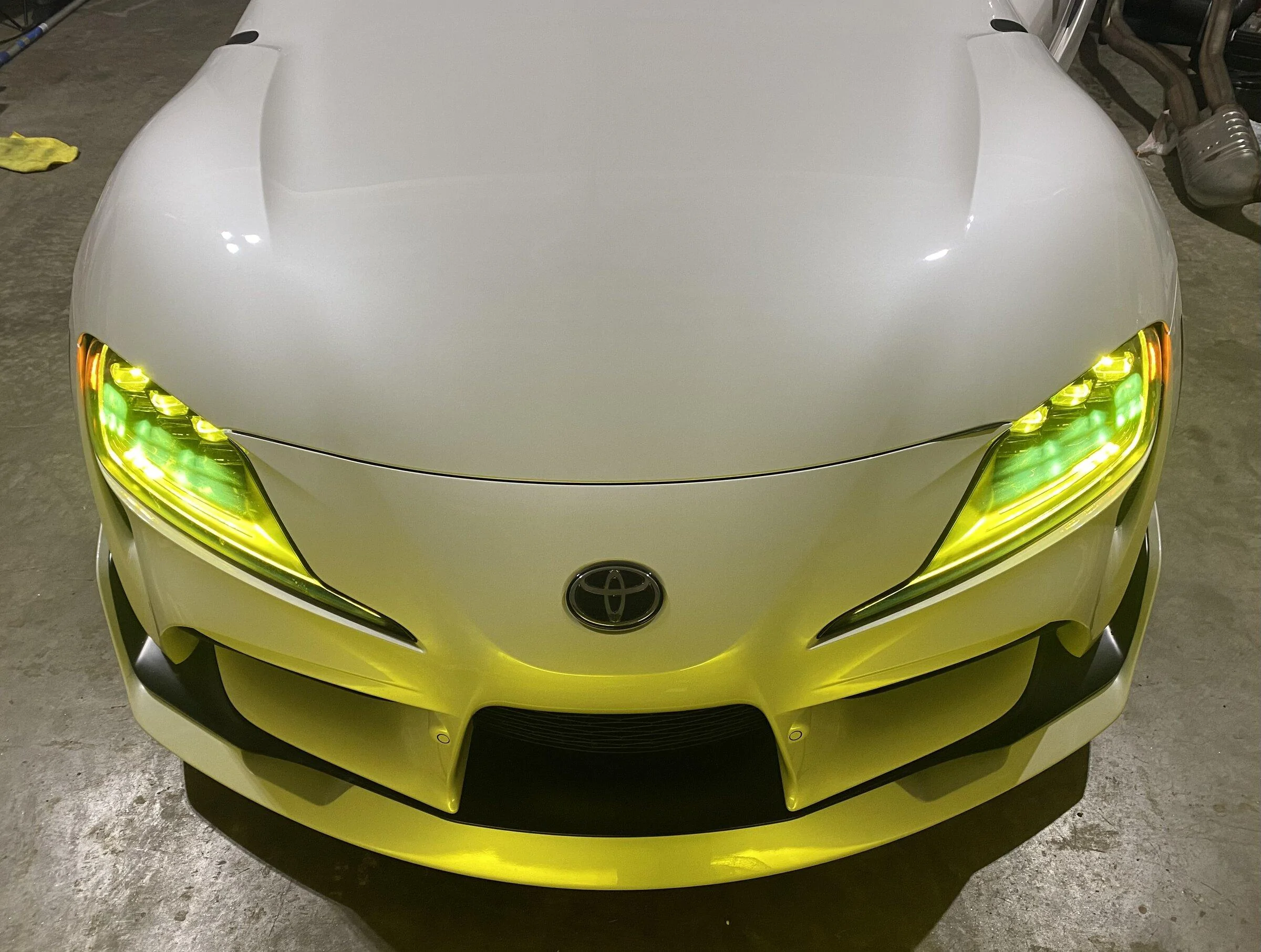

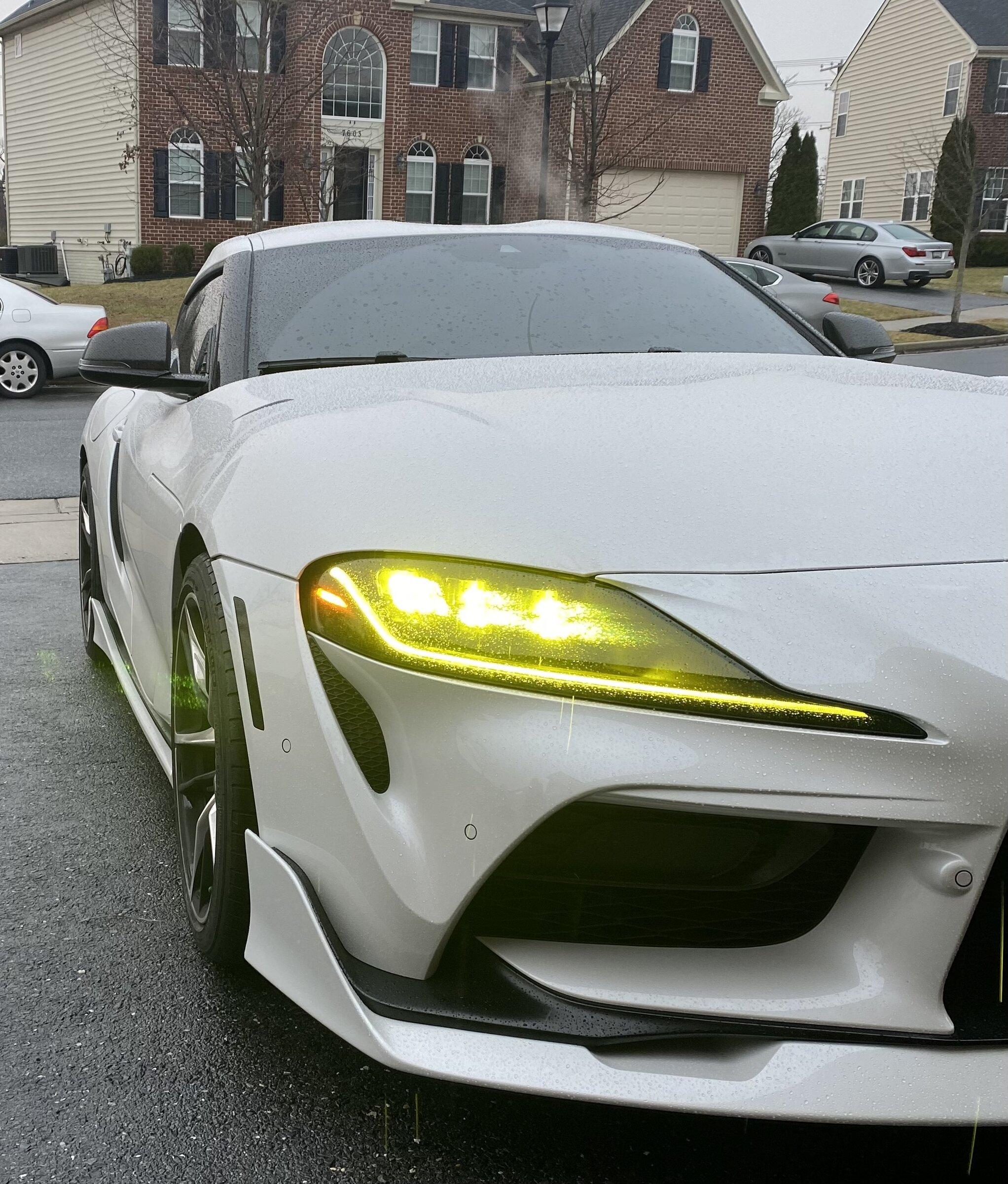

Lamin-X yellow precut headlight film
Pics of the KSP spacers 15mm F, 12mm R with oem wheels on Michelin All Season 4 (255/35/19 F, 275/35/19 R)

Did you parts come predilled. Or did you need to make the holes your self?
Since this was authentic aimgain the holes come predrilled and rivets and hardware provided.
I think a rexspeed kit does not have any predrilled holes (I believe lol, don’t quote me on that? just what I’ve read)
So the authentic kit super easy to install and very good fitment.
Front lip reused oem hardware and just one new hole to drill
Side skirts all new holes and rivets/screw but holes already predrilled for ya. (Good to have a second hand to hold as you line up and drill)
Rear spats reuses oem holes with just one new holes rivet/nuts
Rivets are M5 rivets

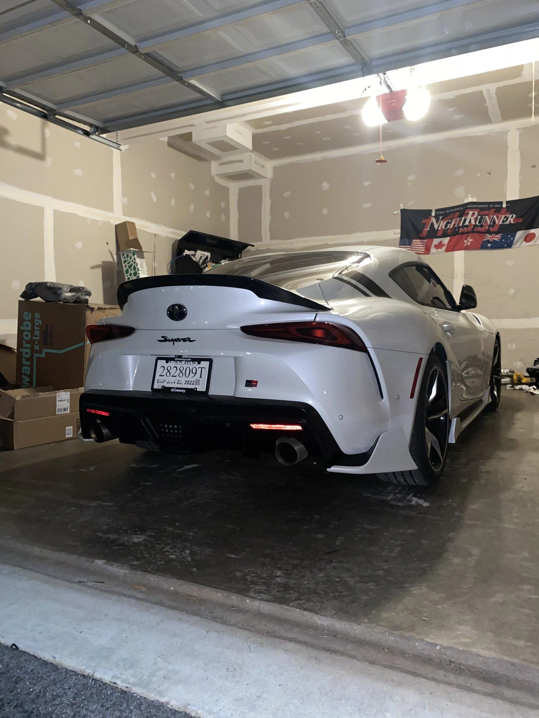

Diffuser haven’t tackled yet I just know I’ll have to cut the oem rear diffuser fin

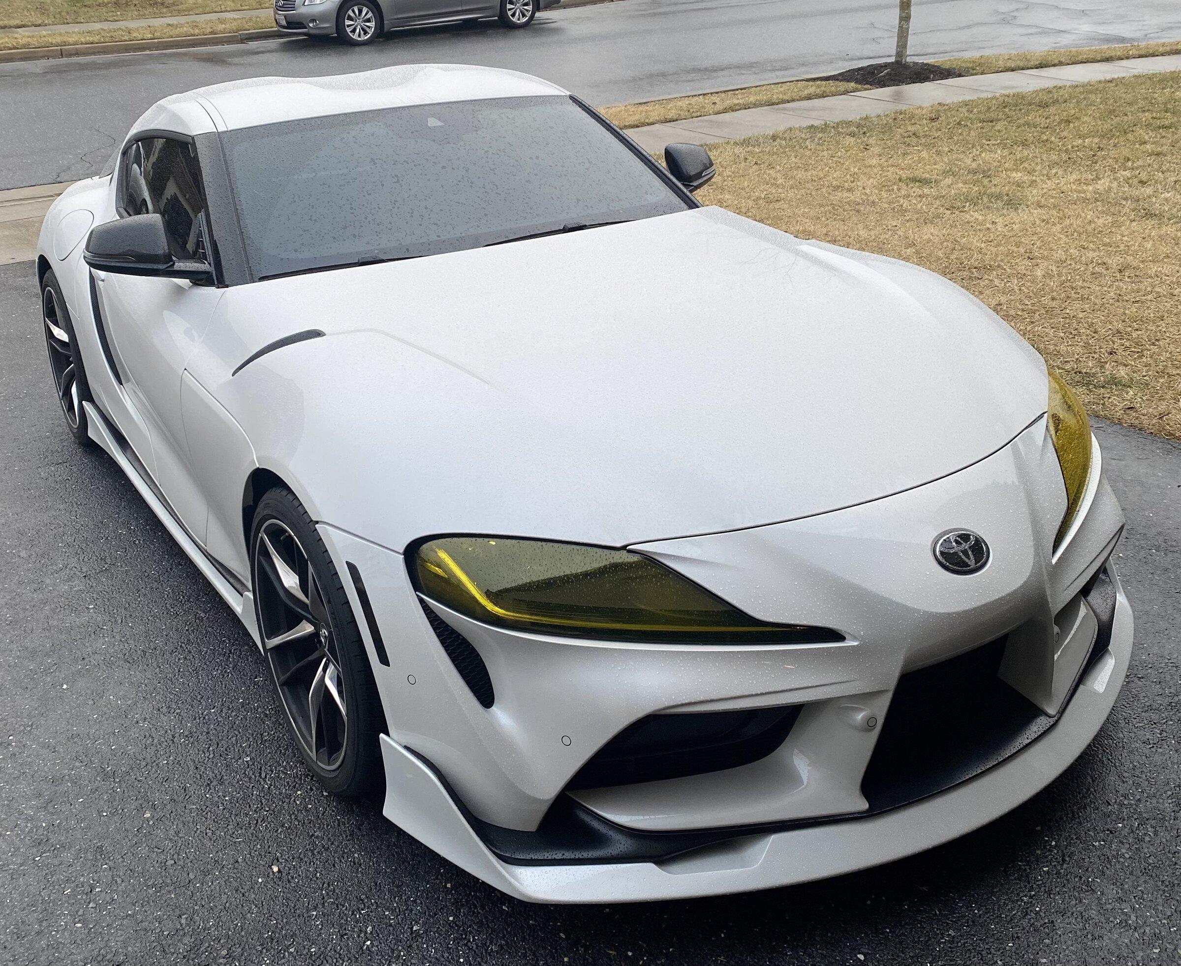

I think this picture illustrates this best. If whoever you bought the aero from claimed that was paint-matched, I'd get a refund. The white is clearly brighter/not as beautifully pearl as the rest of the car.
Oh the car is very dirty lol. I need to wash the car and repost more photos.You can see by the rear spat / skirts / lip where I wiped it first. Can see the dirty vs clean line

Who wants to make bets on how long it will take to get pulled over with those yellow headlights? :cool:
Ran them on my typeR before no issues haha. Maryland usually is chill about it but we’ll see lol

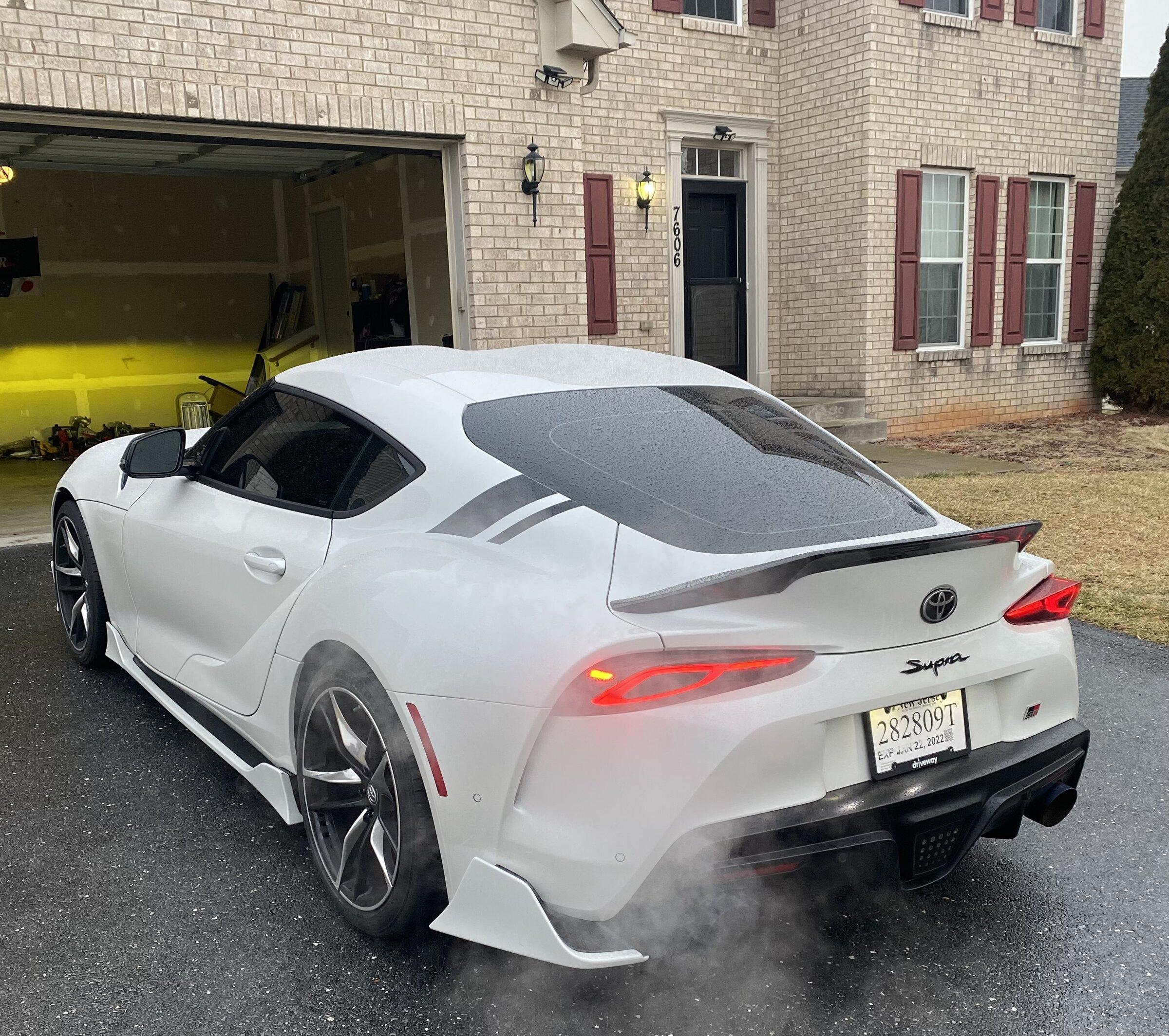

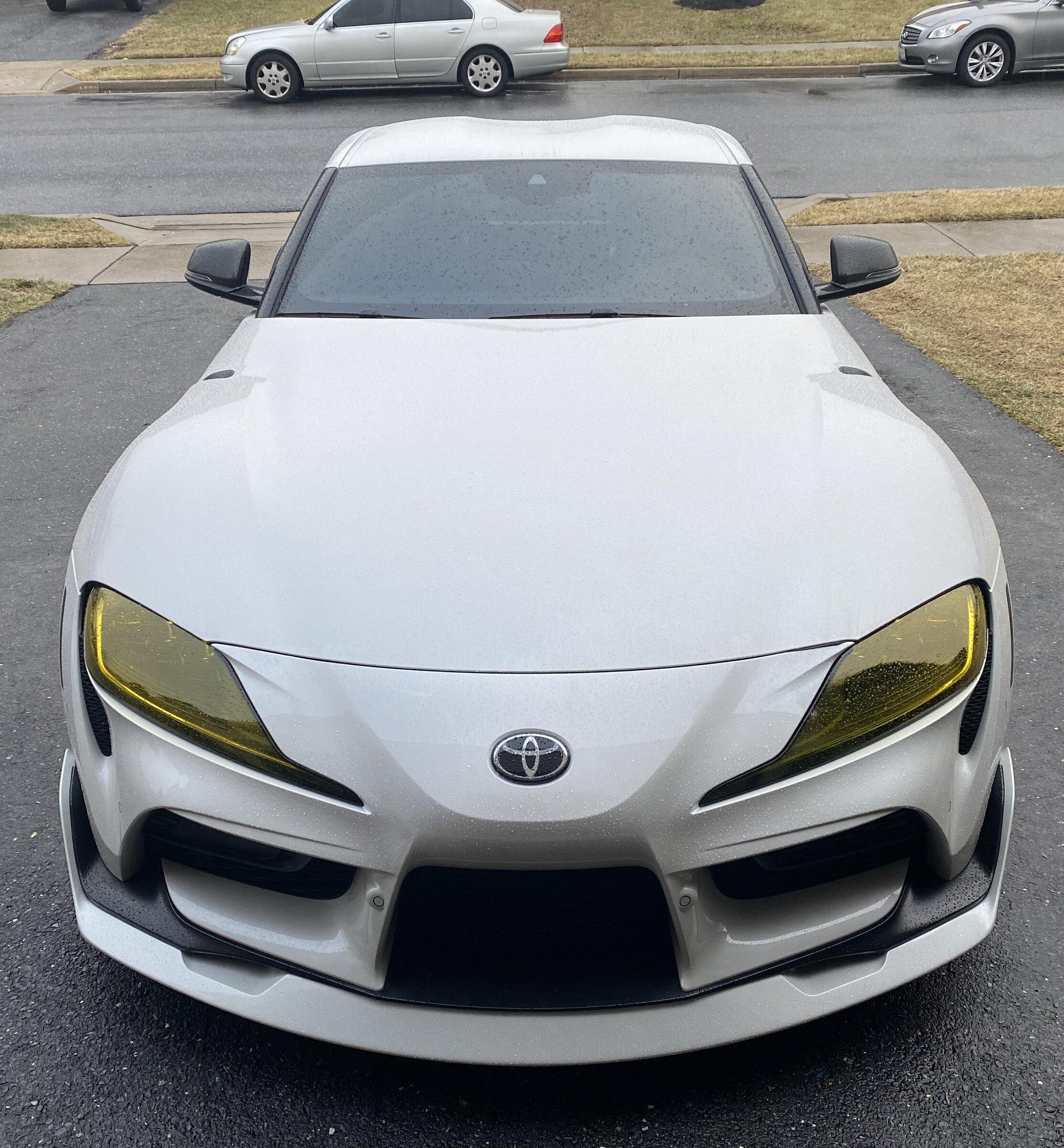

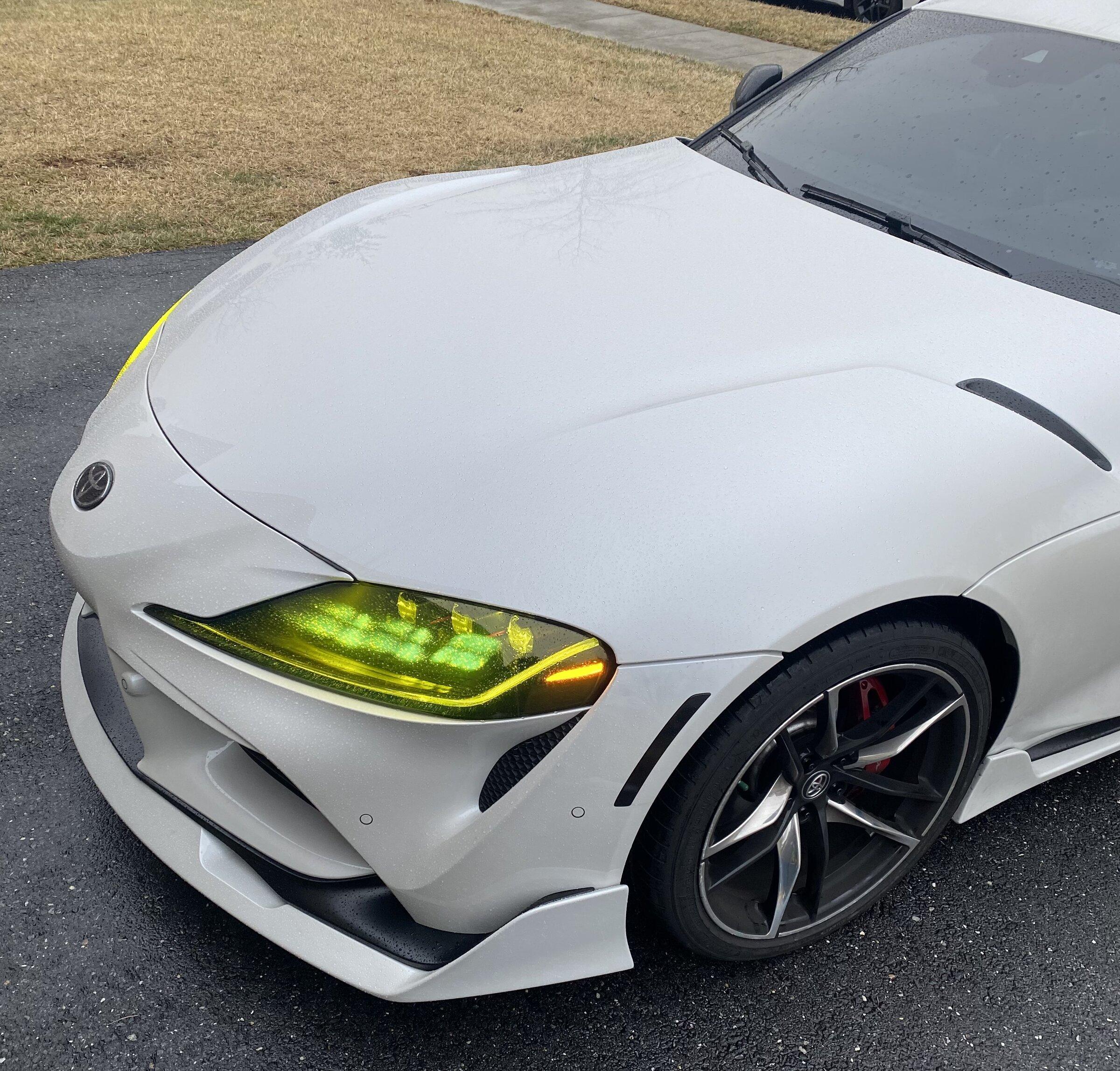

2/8/22

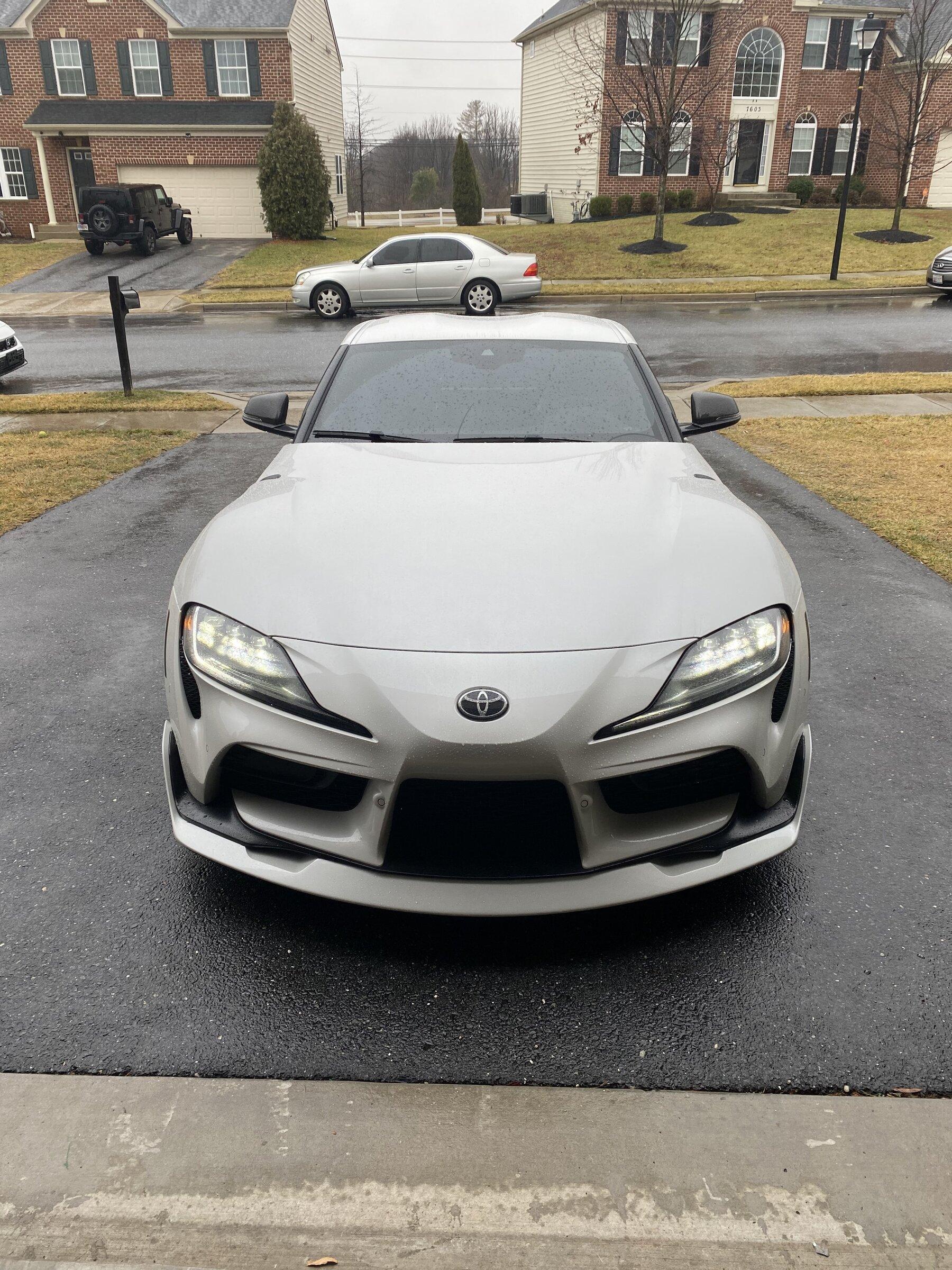

Another front end pic - still need to wash car
