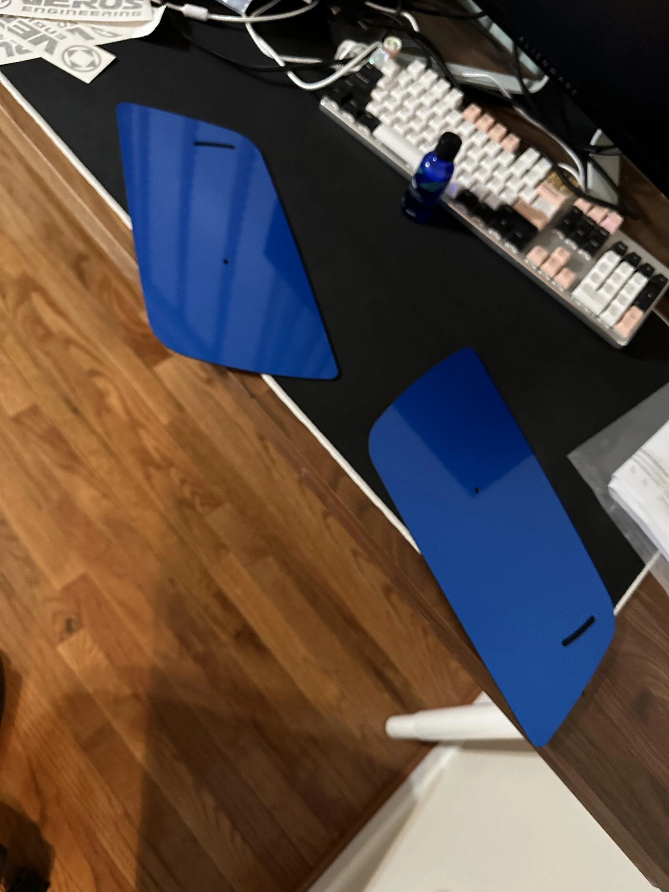

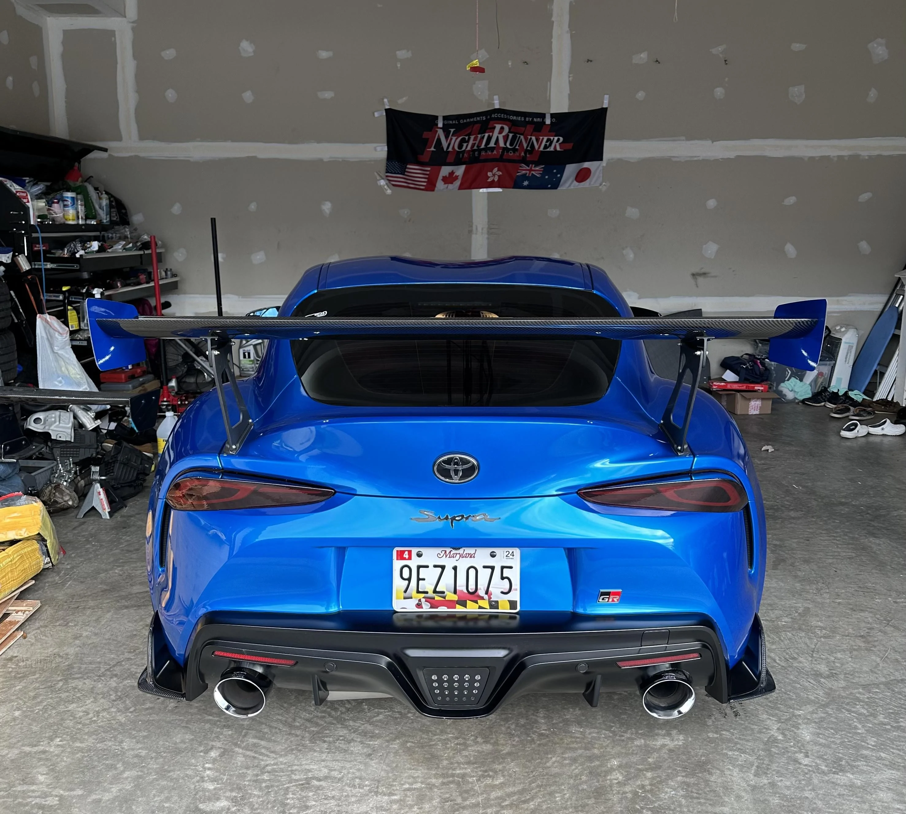

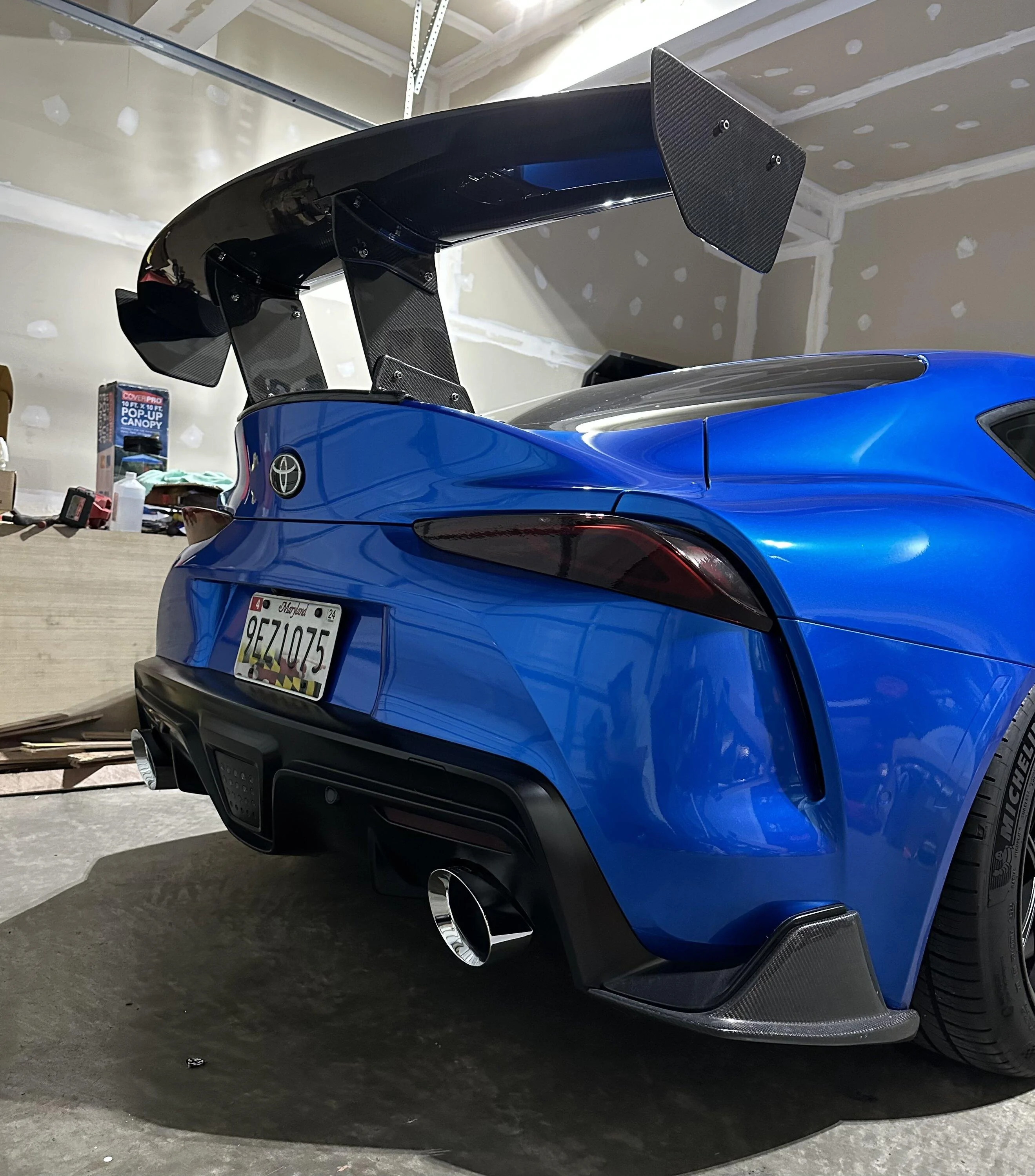

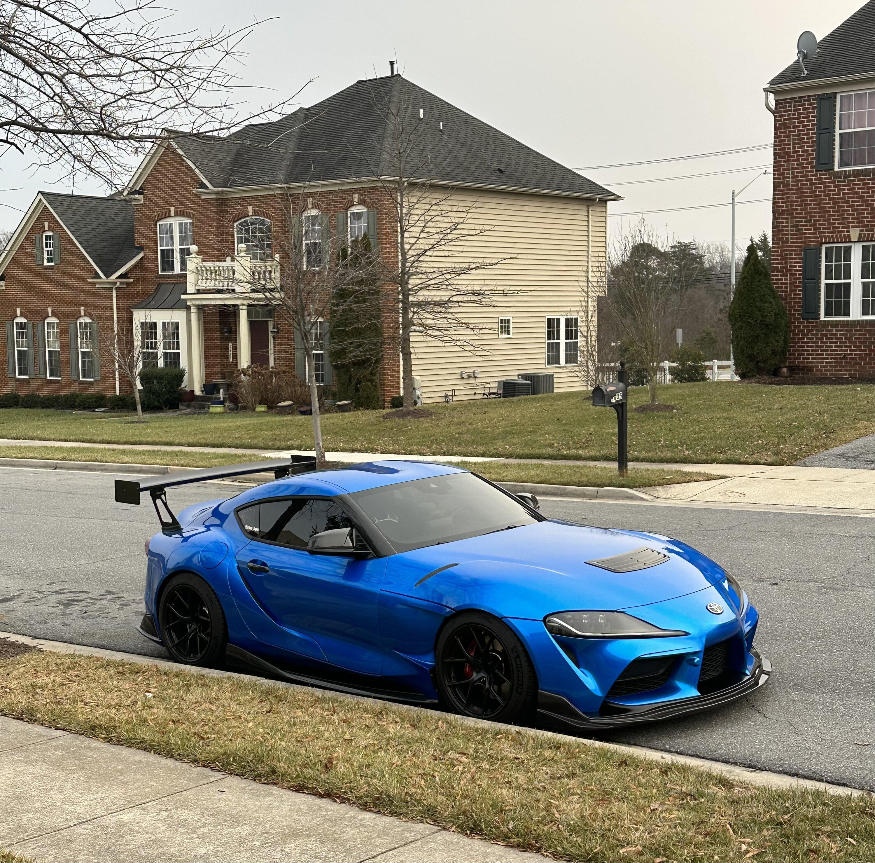

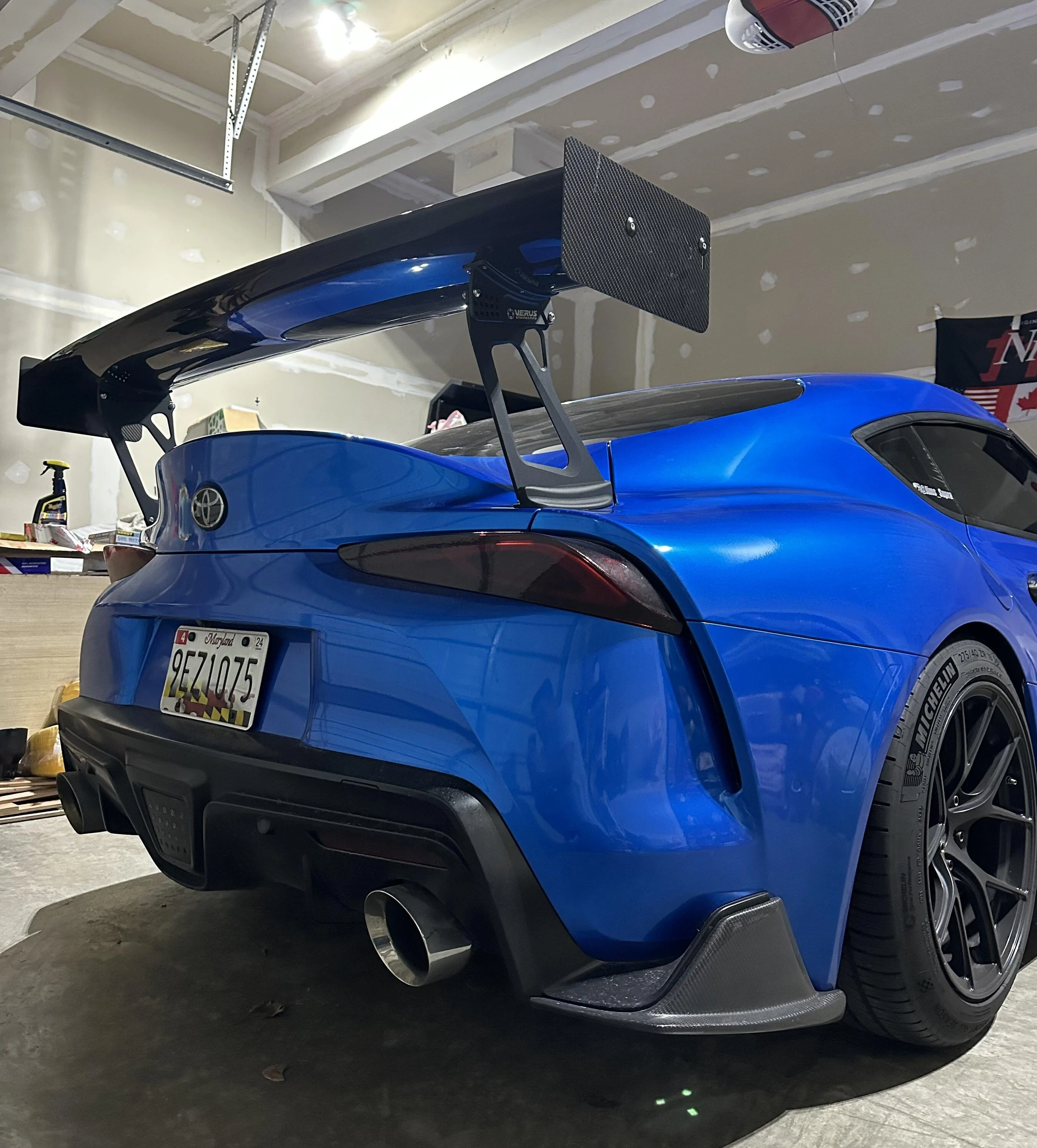

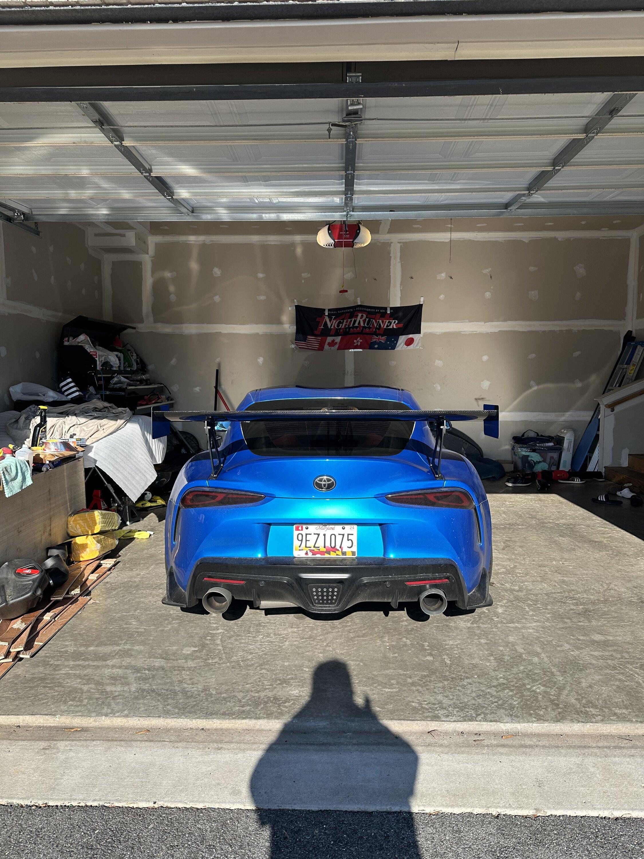

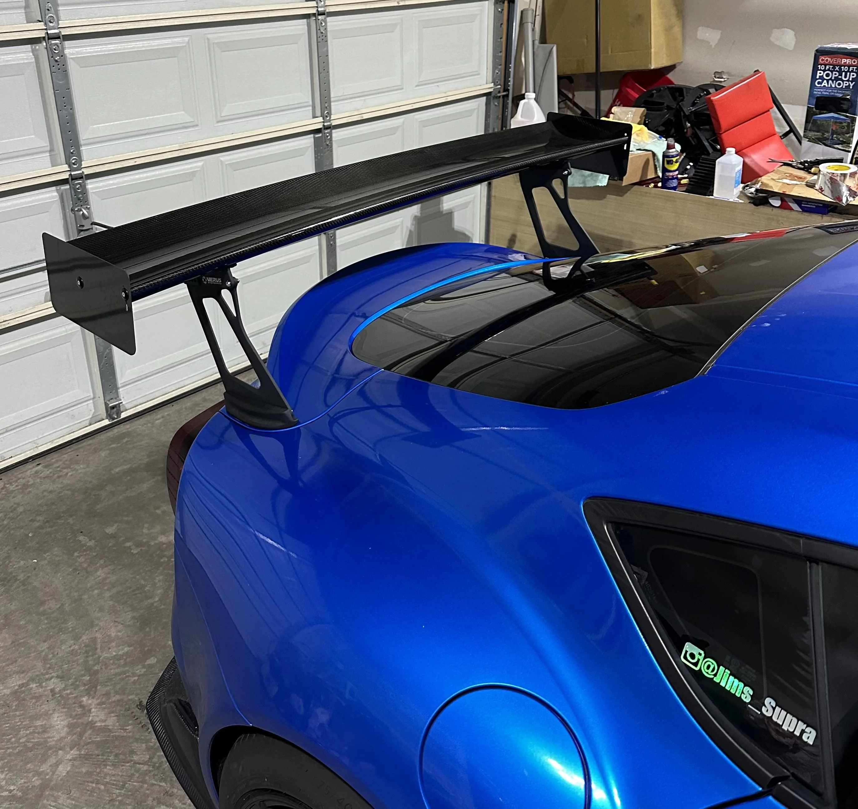

Finally got time to lineup the VRS Wing and Canards. Going to end up getting an authentic. No issues with the VRS wing, fitment was decent but just a touch movement when driving, very very minor but I’m OCD with that. Others haven’t had issues on track with it but personal preference the wing going authentic next. Looks amazing tho and the current downforce balances the car
realized also that the VRS Wing mounts are hollow and not solid so probably why there’s slight movement. Could get mounts custom made or try to make them more rigid but nah lol

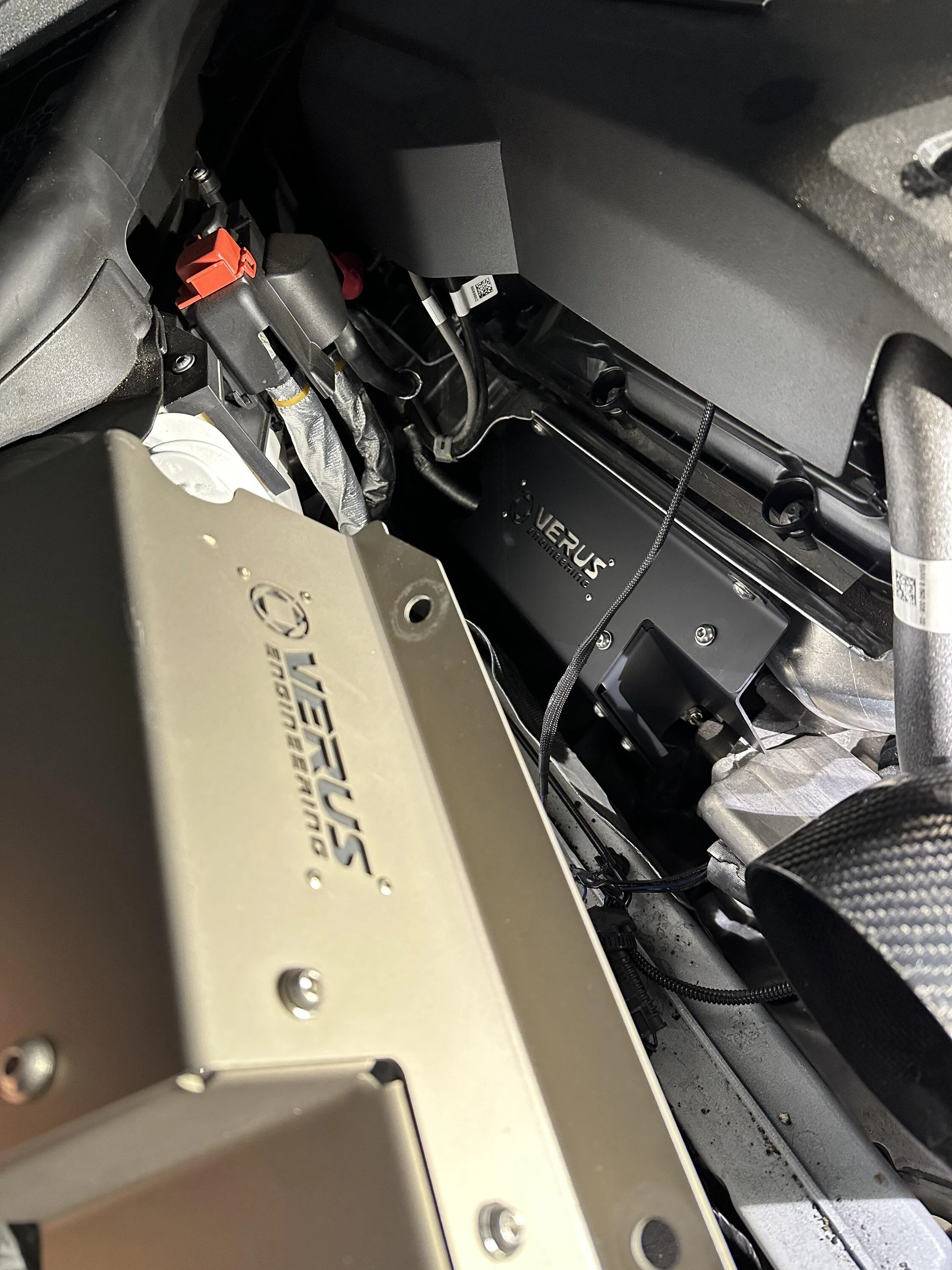

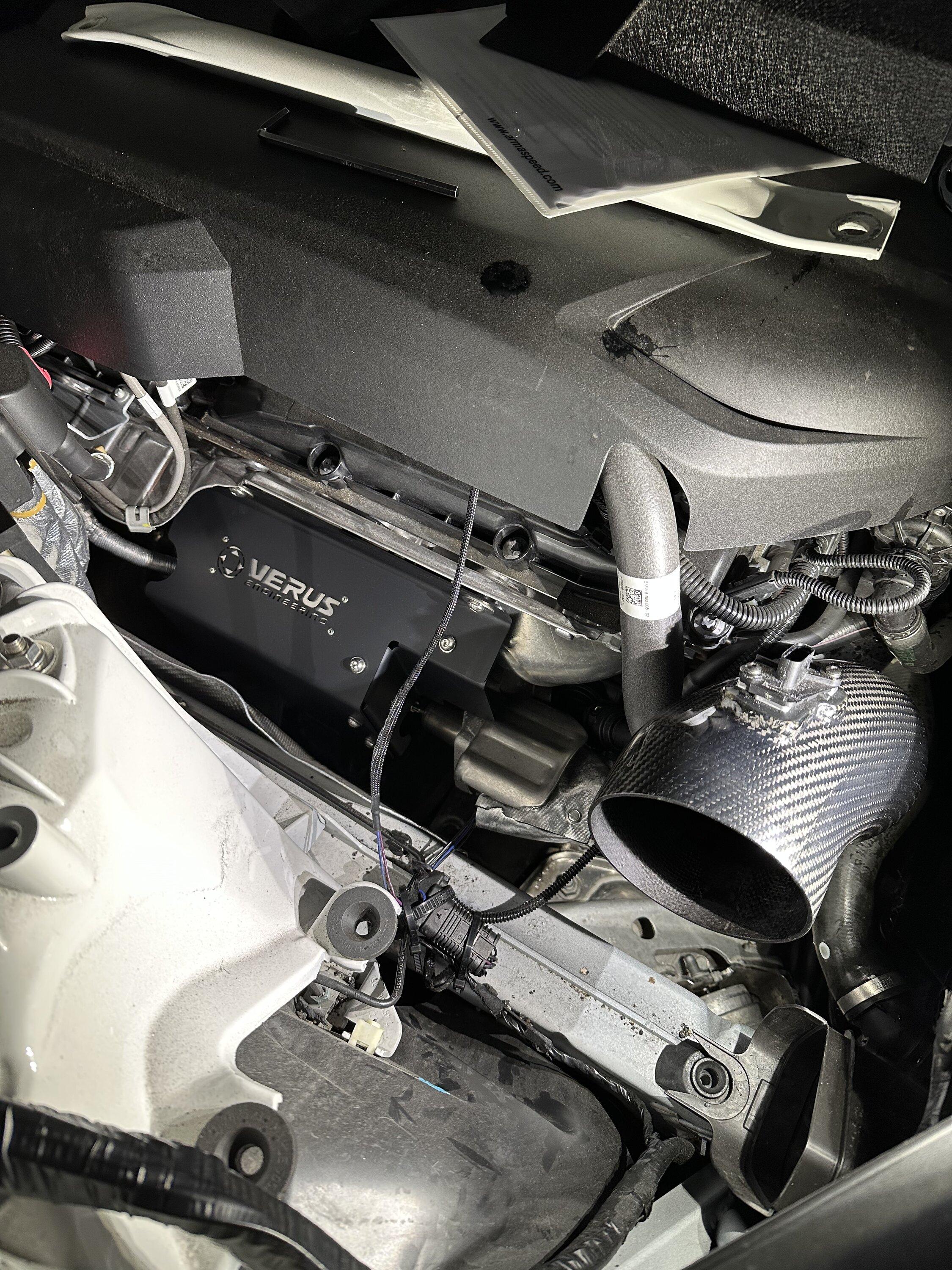

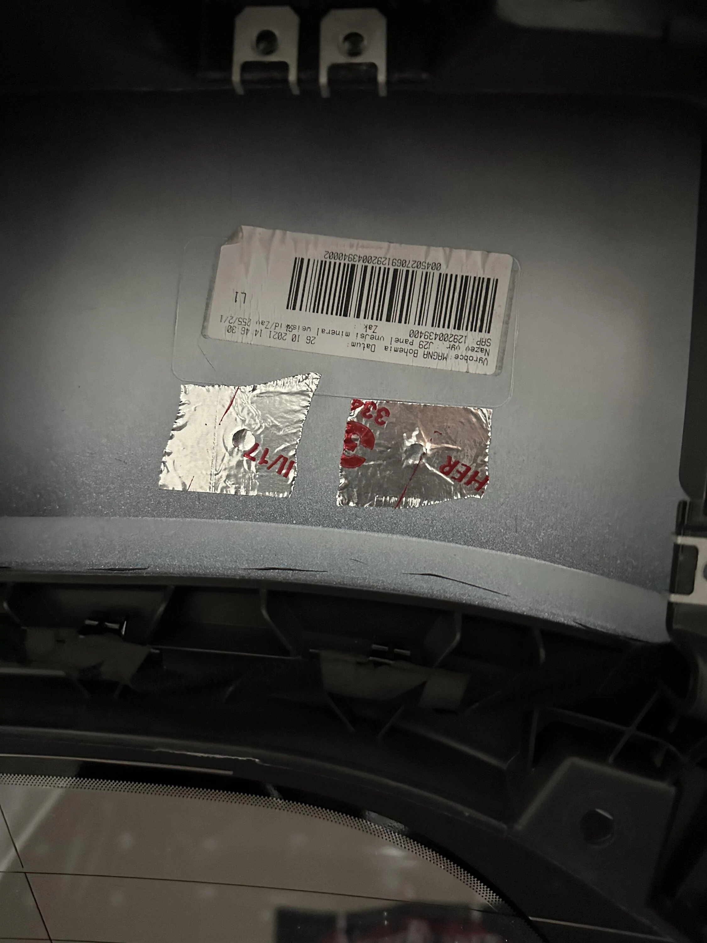

Switched over to the black Verus heatshield. Can see the color difference between their black vs silver

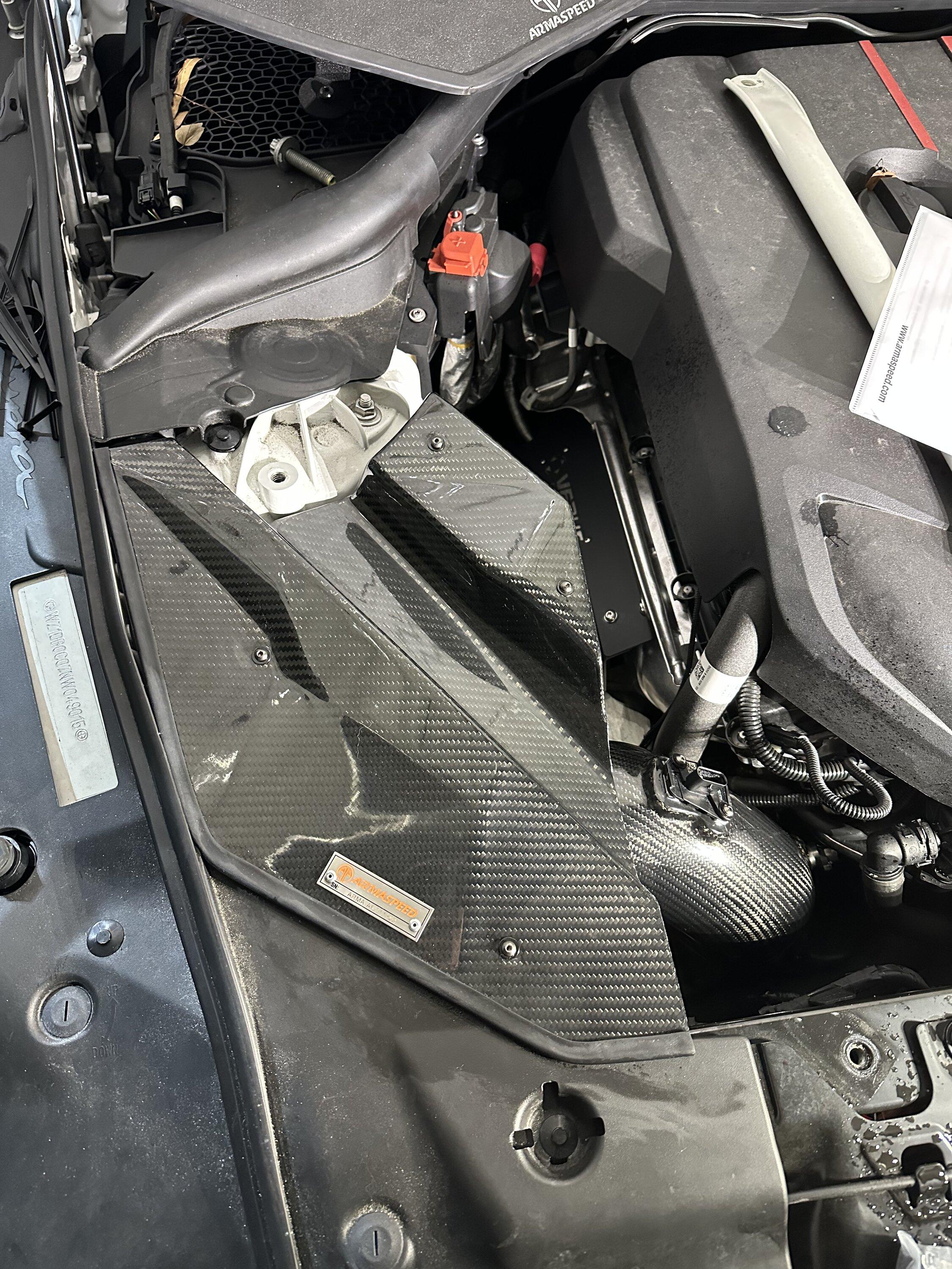

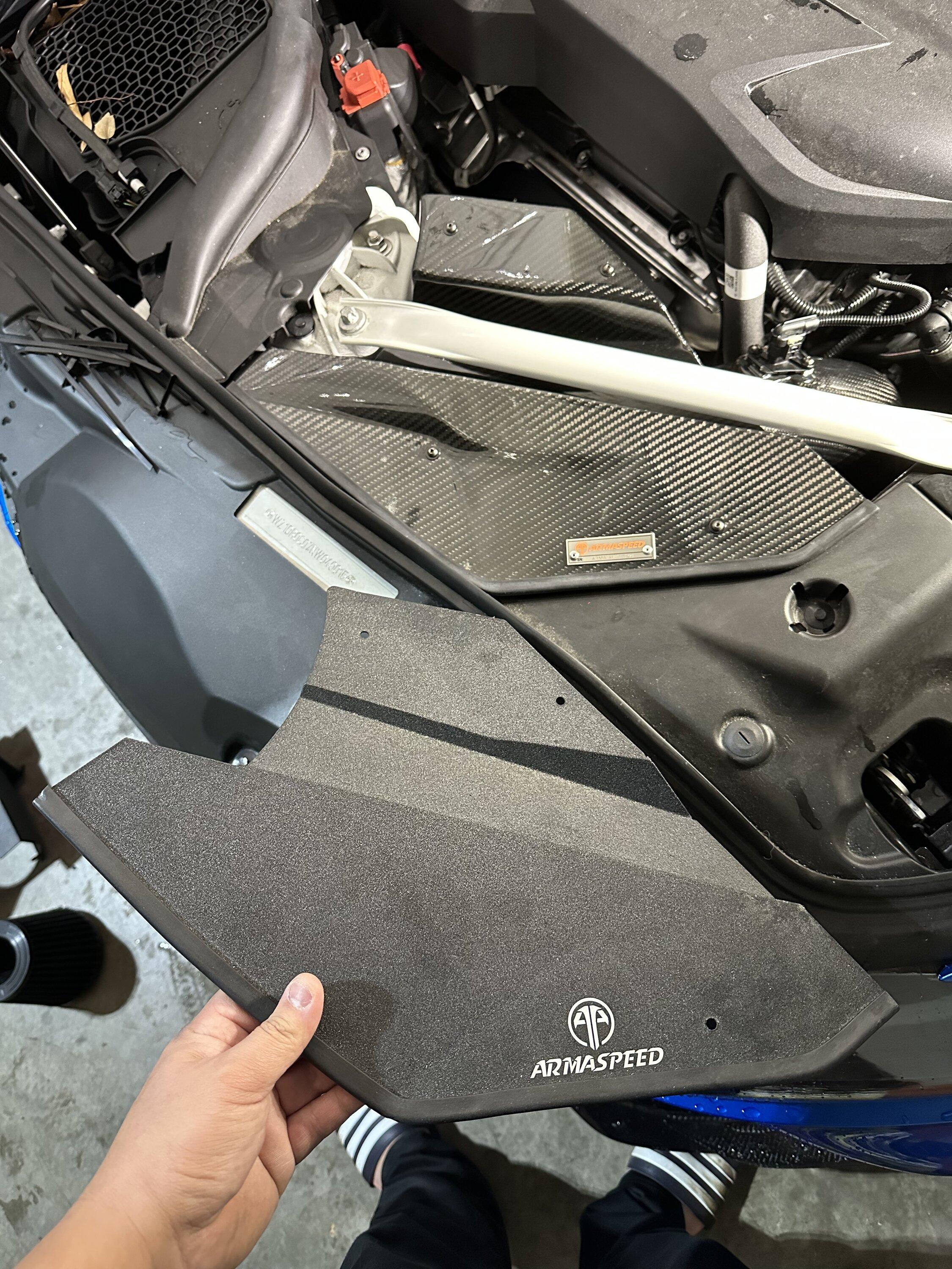

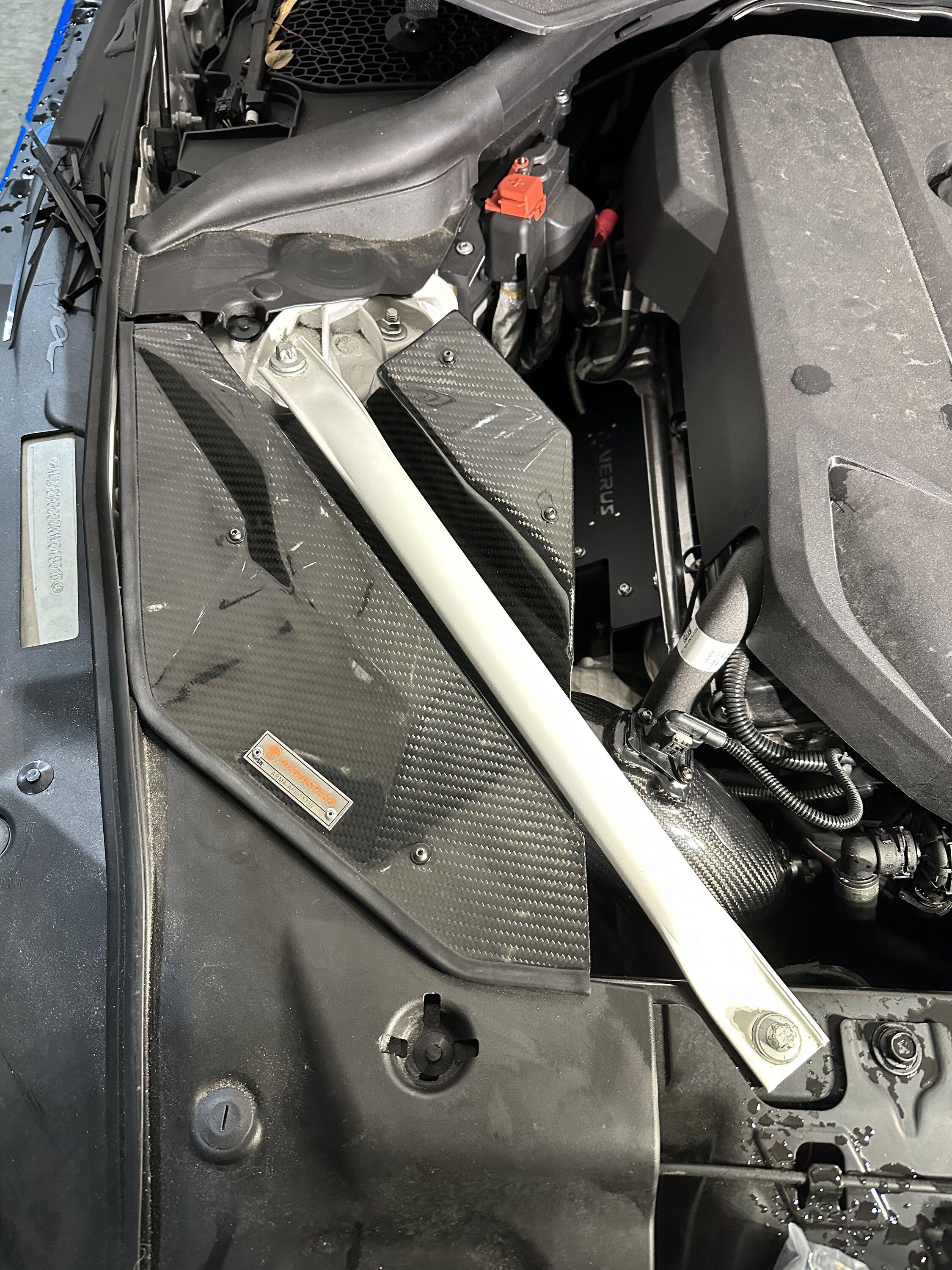

Changed up to the carbon armaspeed intake cover as well. It’s not a straight swap from the covers, you’ll have to swap the intake box housing piece as well. Luckily the intake tube stays without needing to remove it for the swap

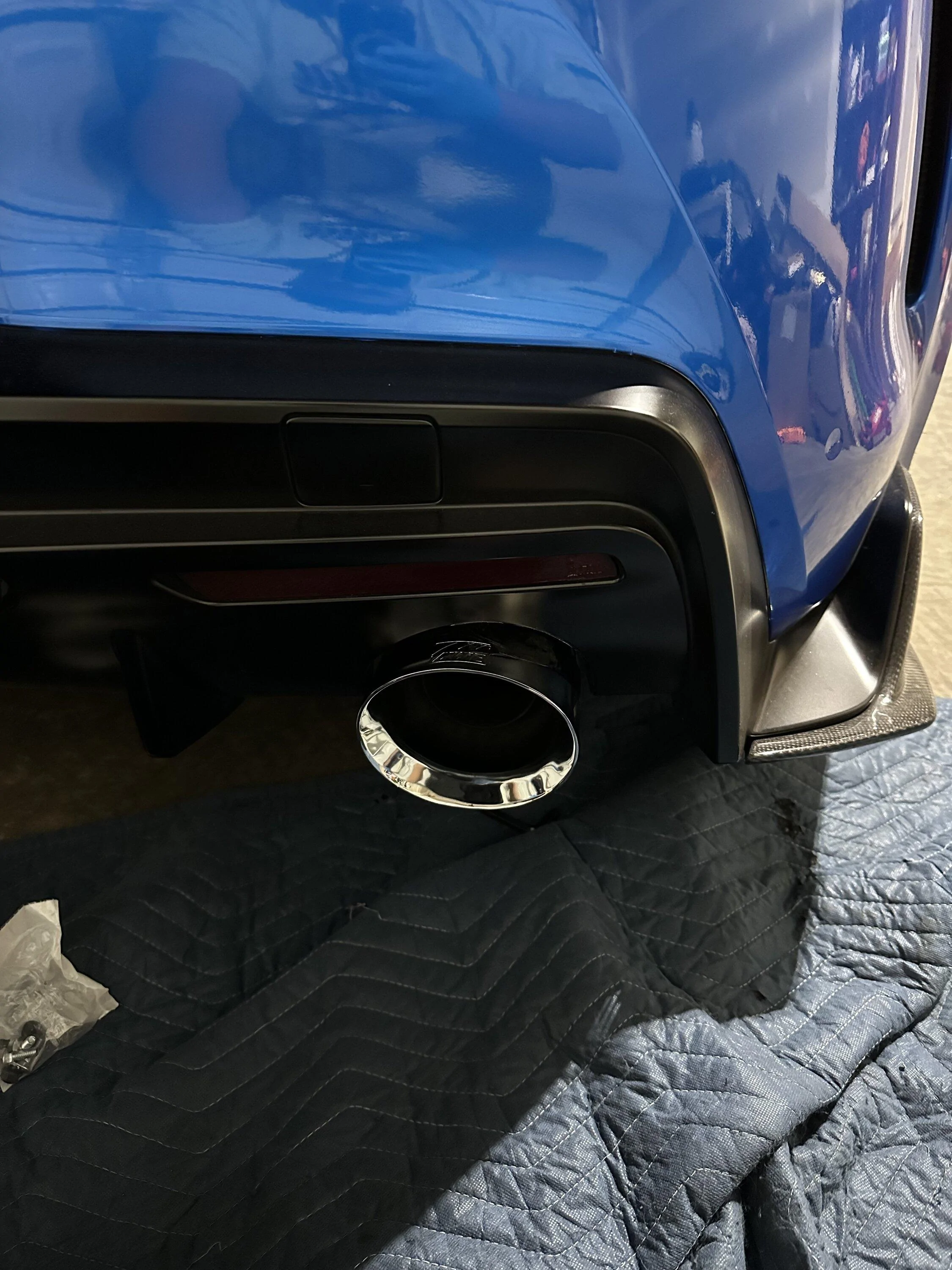

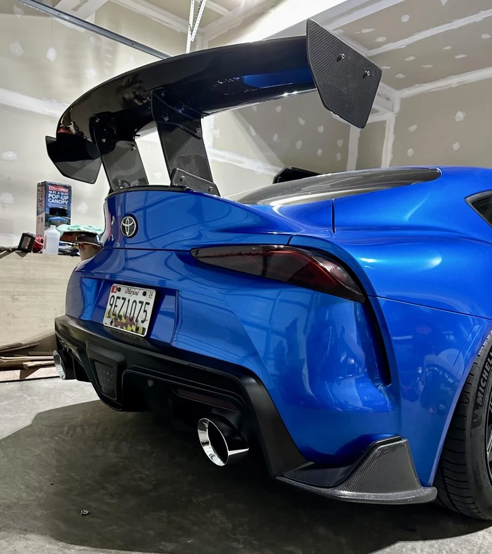

Was able to add on AWE tips onto the MBRP exhaust, perfect look with the chrome tips

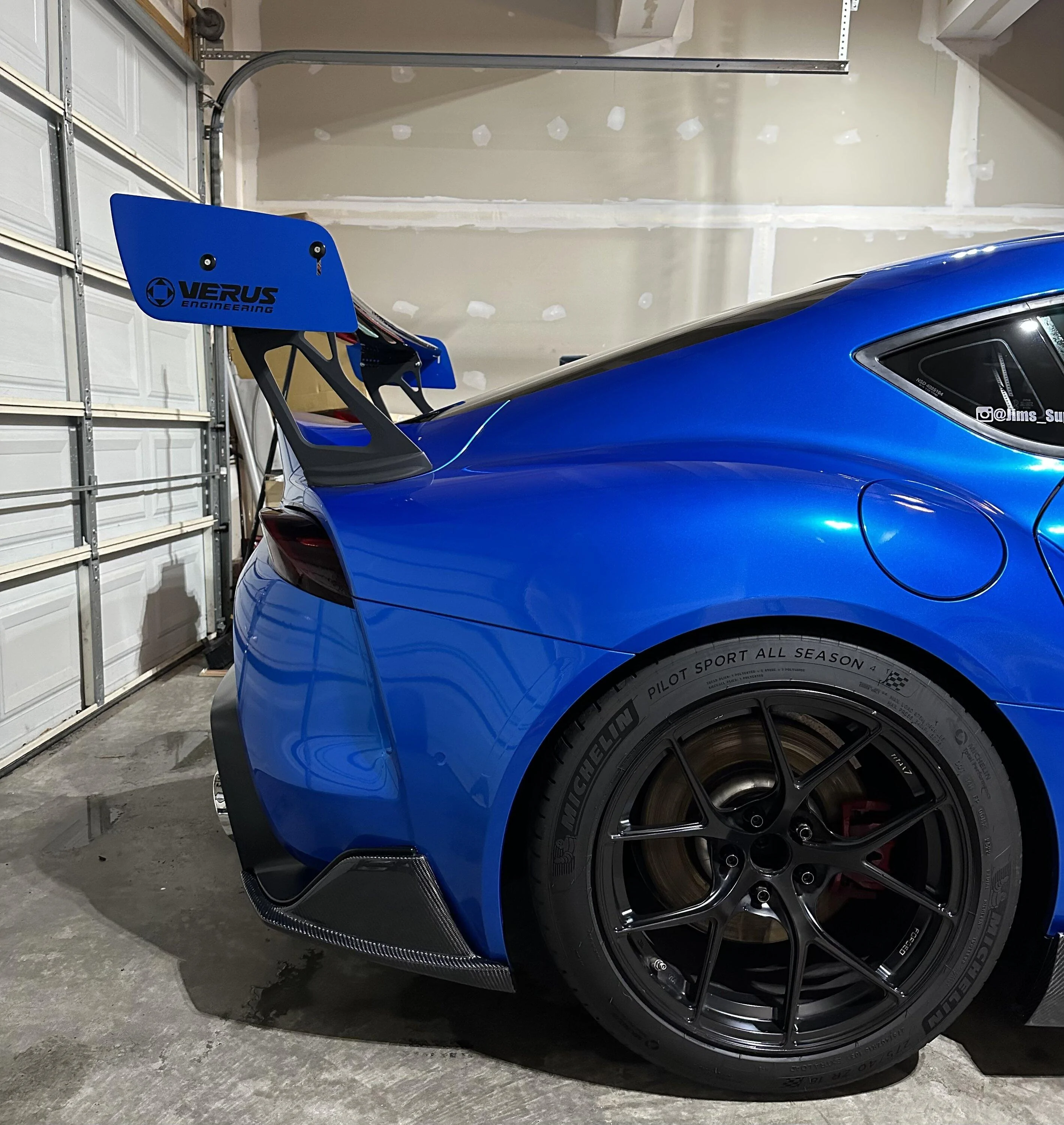

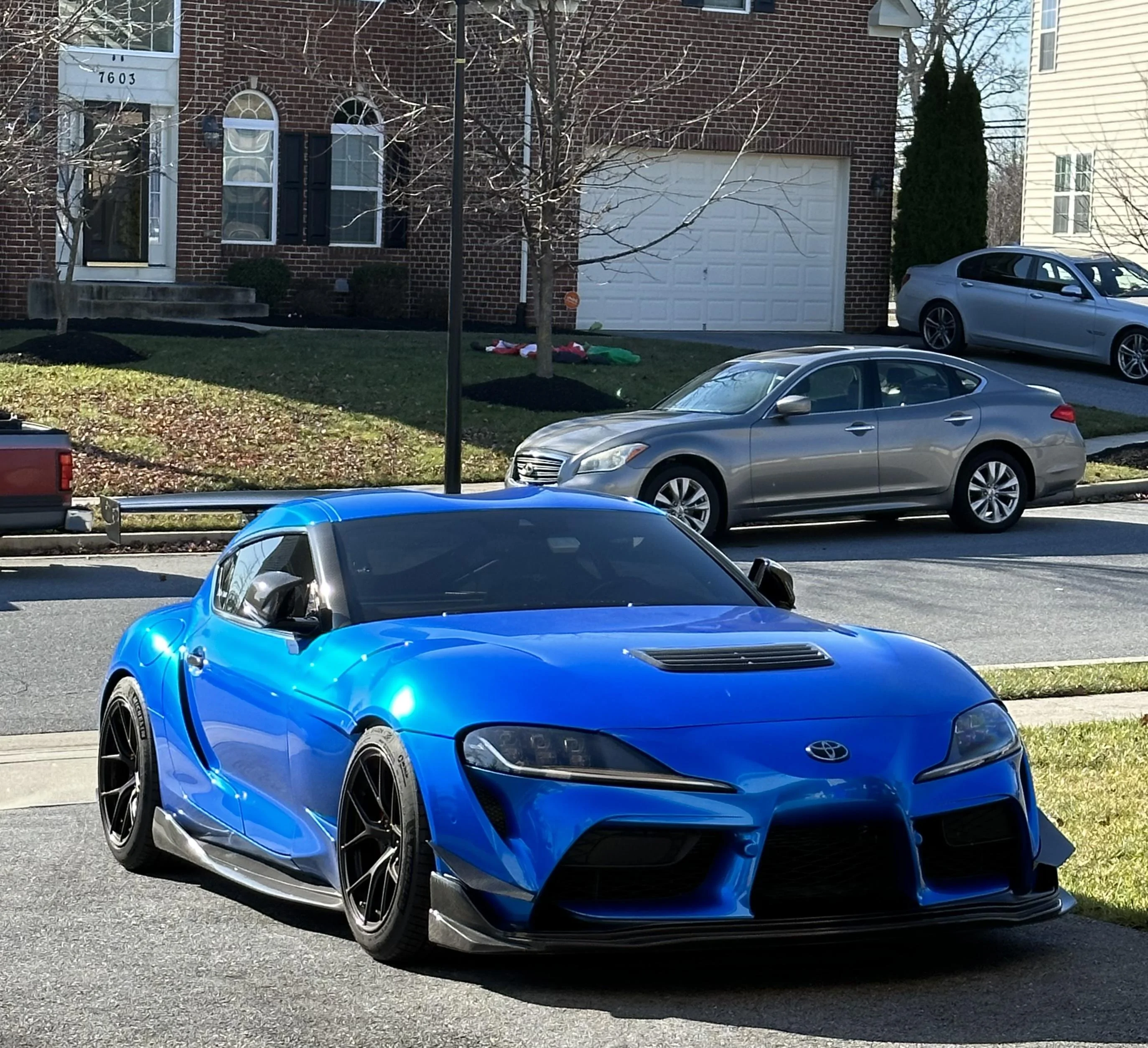

That is quite the wing! ?
The rep varis wing is nice but I’m going back to a track focused build with the Verus setup again haha. Gonna mix it with some carbon bits here and there

I went through like three Verus wings actually haha.
so I love the quality of the Verus Engineering wing. Very very well made, packaging was superb, etc. mounting and installing was a breeze because of the template they provided
first wing I had paint matched and sold because I went on a random journey of wrapping the car and wanted cf again. So i picked up another then sold to do the bootleg varis pieces. But I missed proper functionality so went back to Verus again after getting it from a local.
for any cf pieces I always ceramic coat them personally to upkeep it from UV and normal cleaning purposes. This time around I did also ppf the top half of the Verus wing and ceramic coated with CarPro U.K3.0

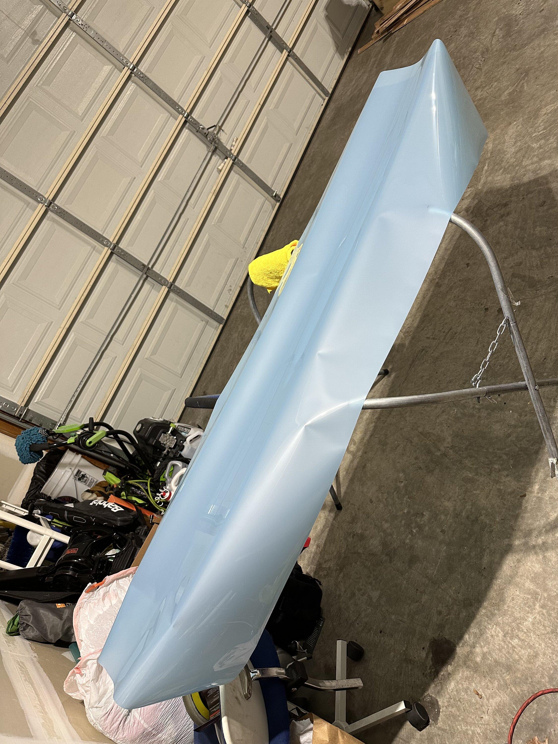

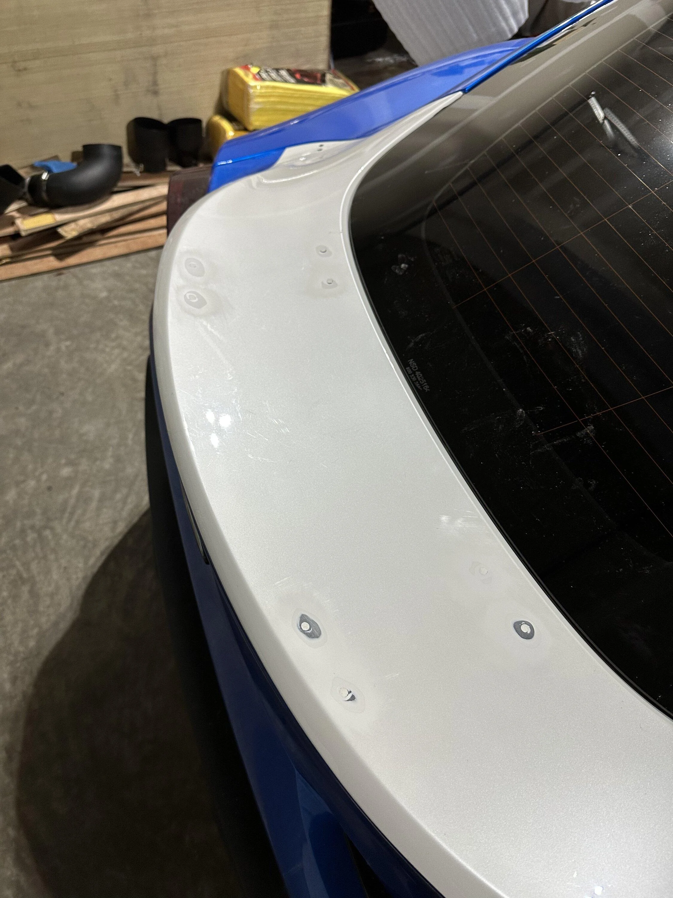

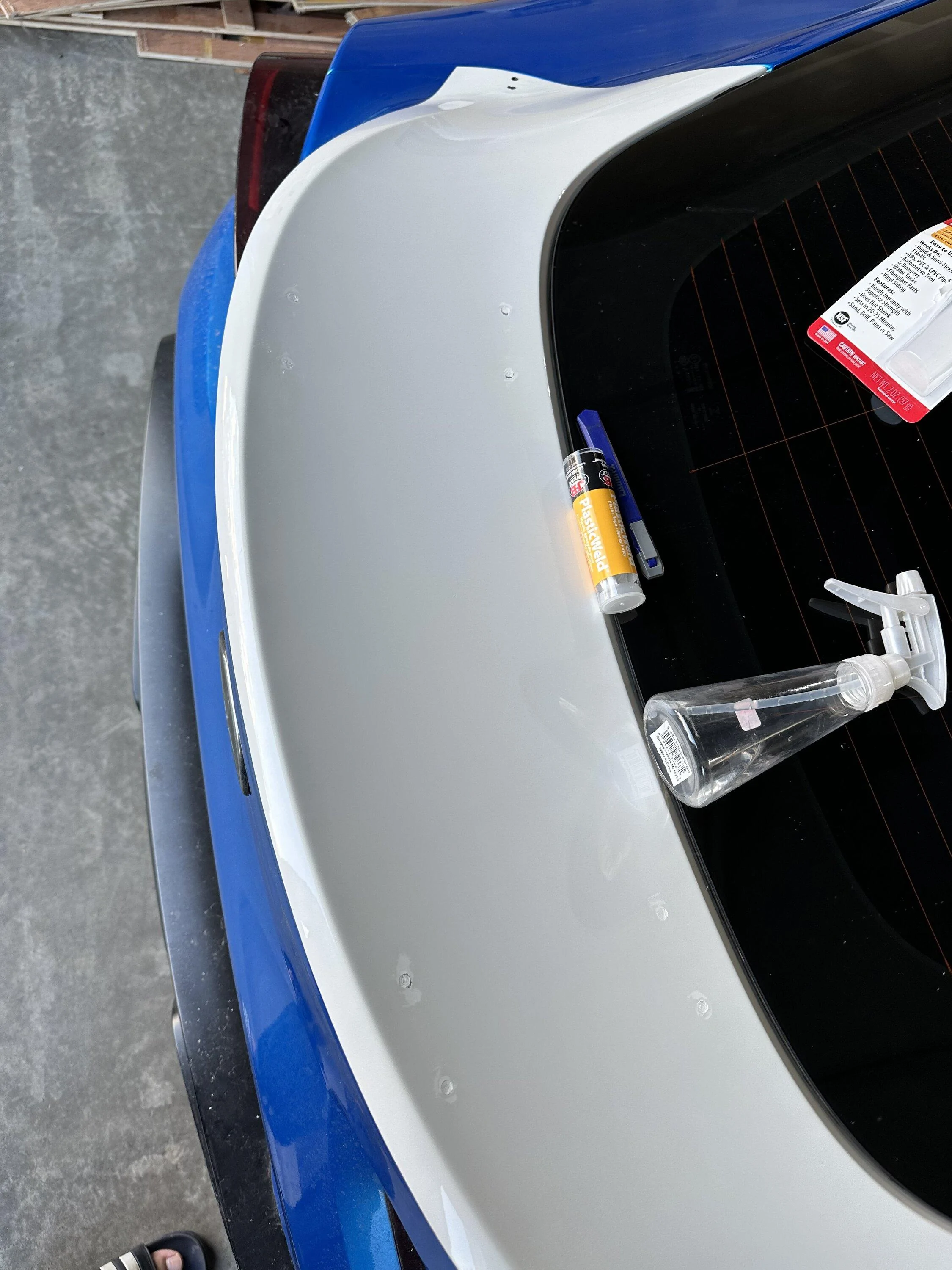

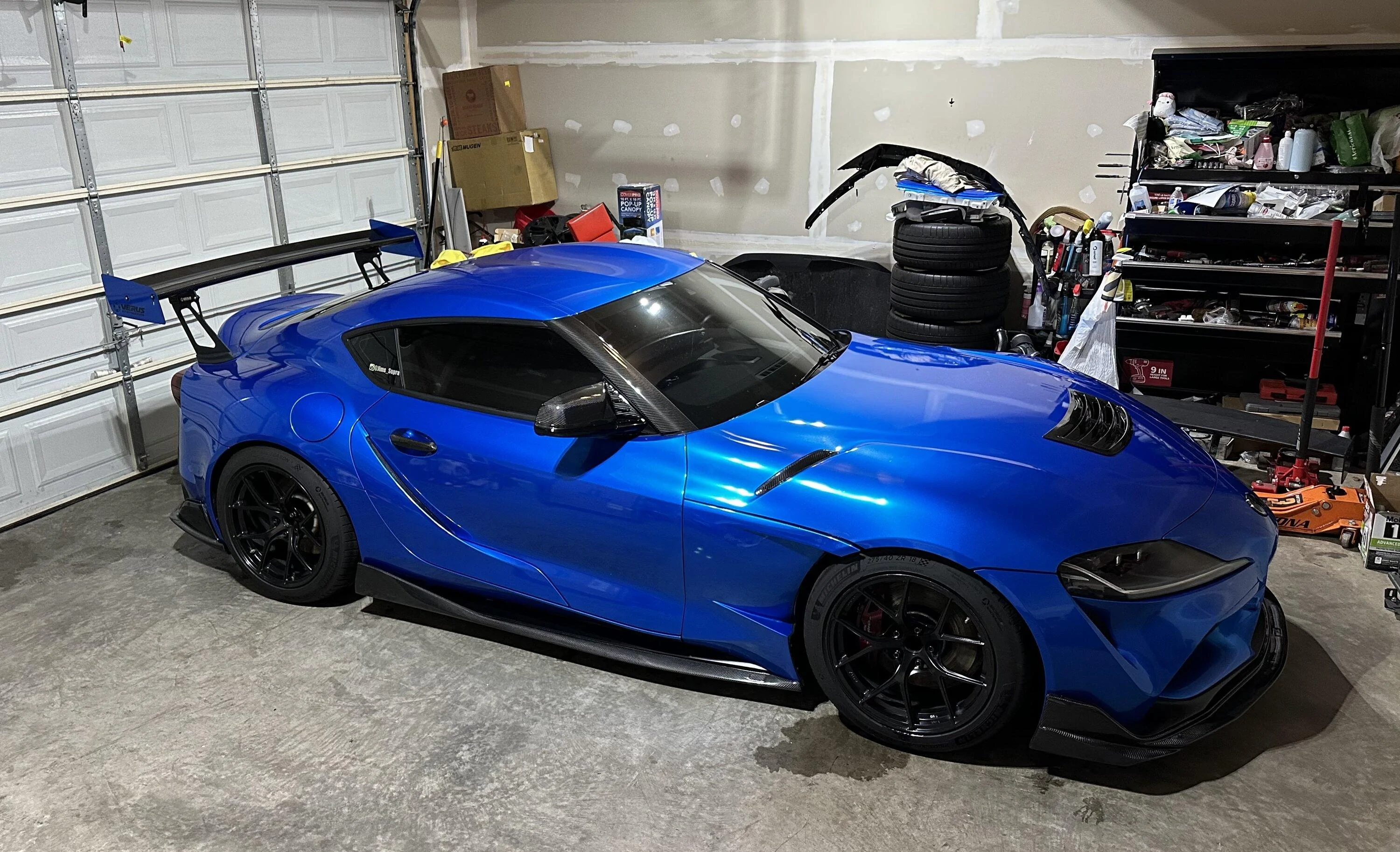

Ended up filling the holes of the trunk from the faris wing. Ended up pretty nice. I plan to get the trunk resprayed if I ever take the wrap off and go back to absolute zero
trunk material seems to be mainly plastic I guess, so some jbweld putty did the trick and sanded smoothly enough when I ran my fingers across

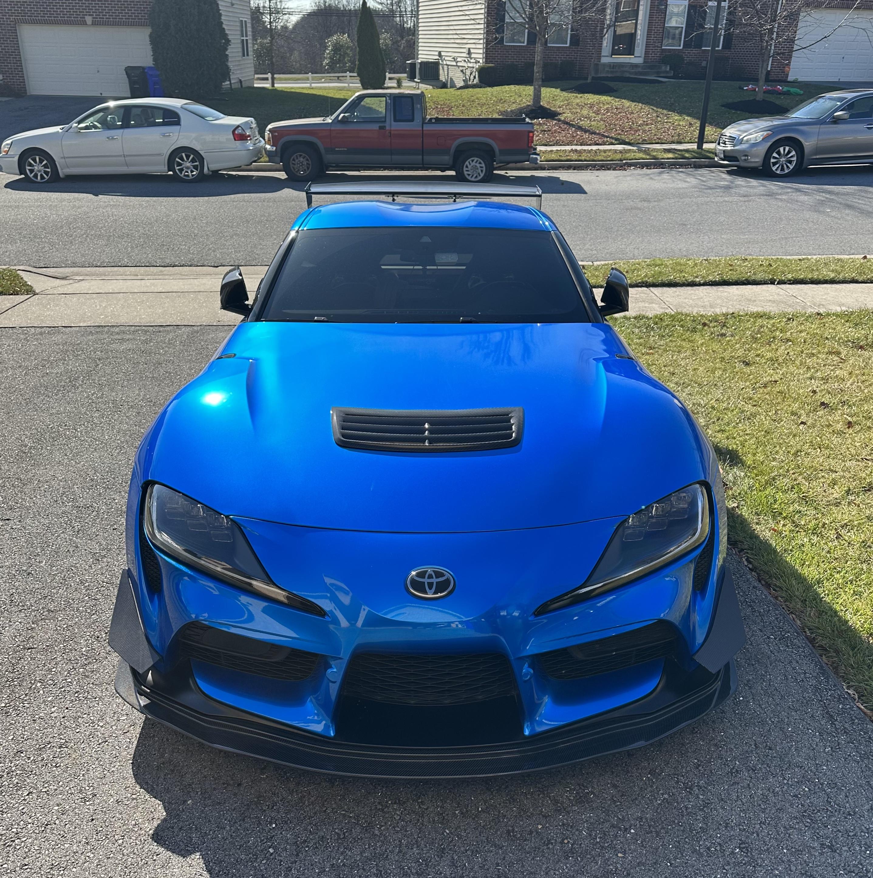

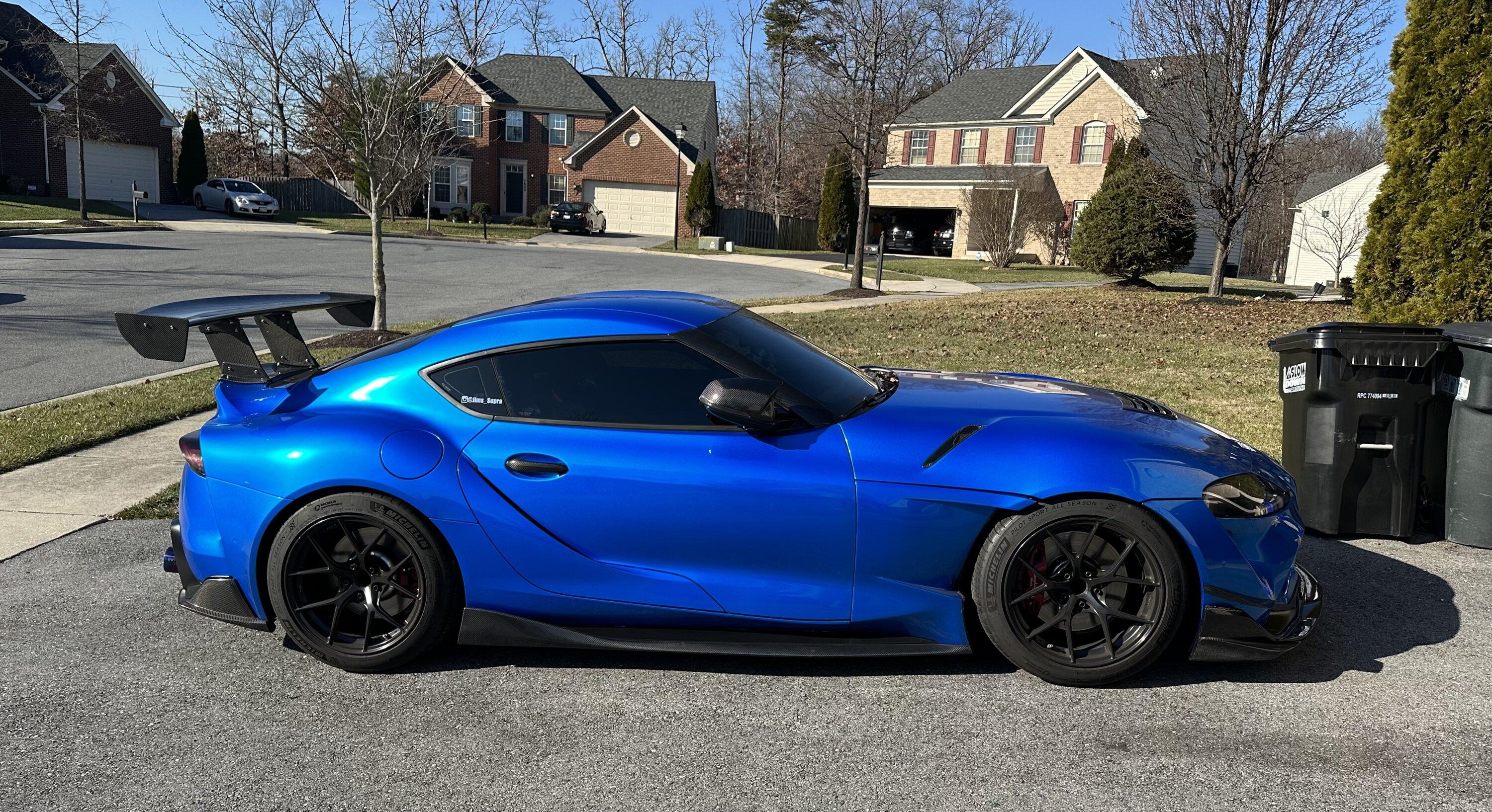

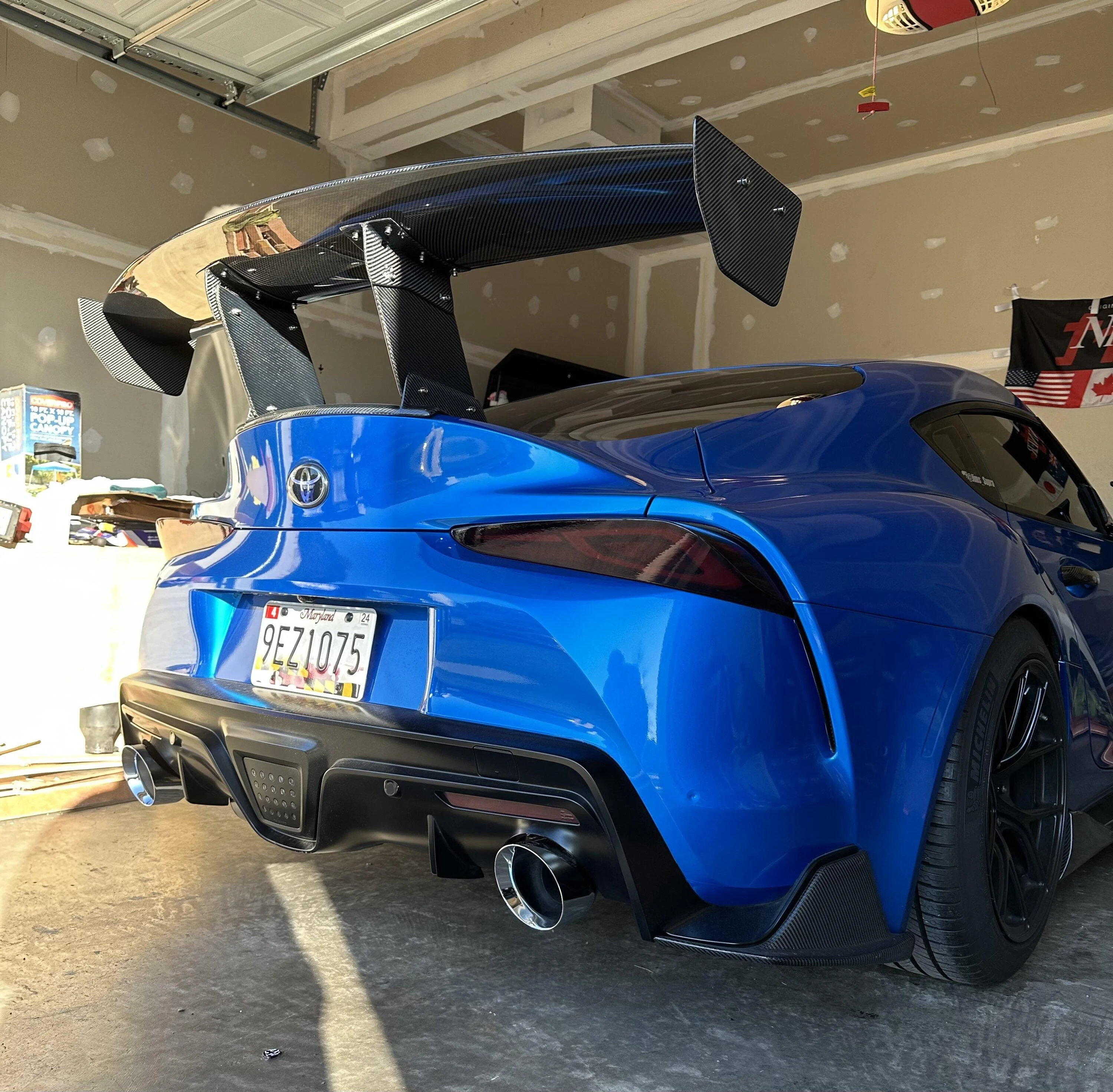

Verus Engineering wing again!

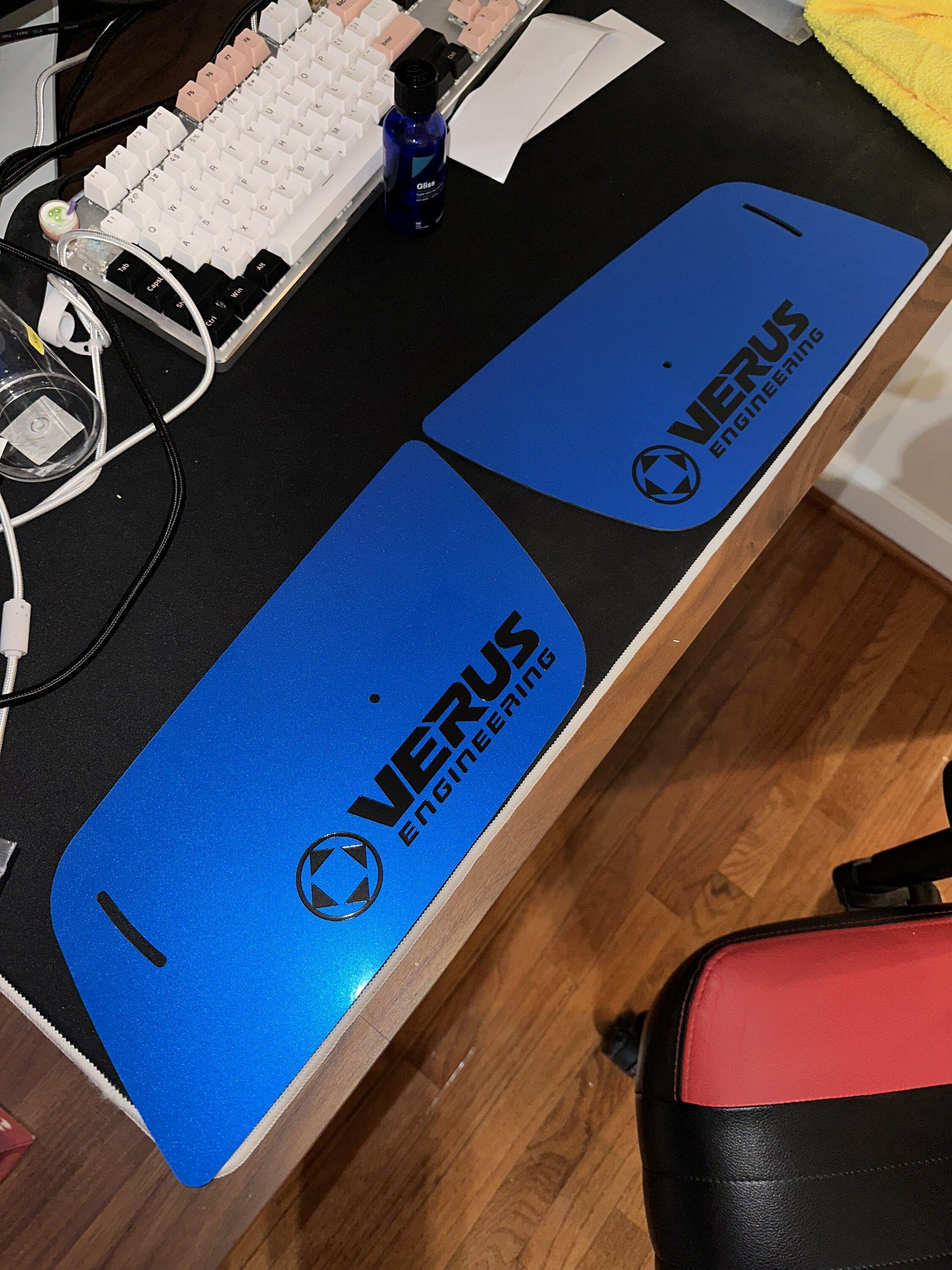

Verus wing with the VRS lip kit

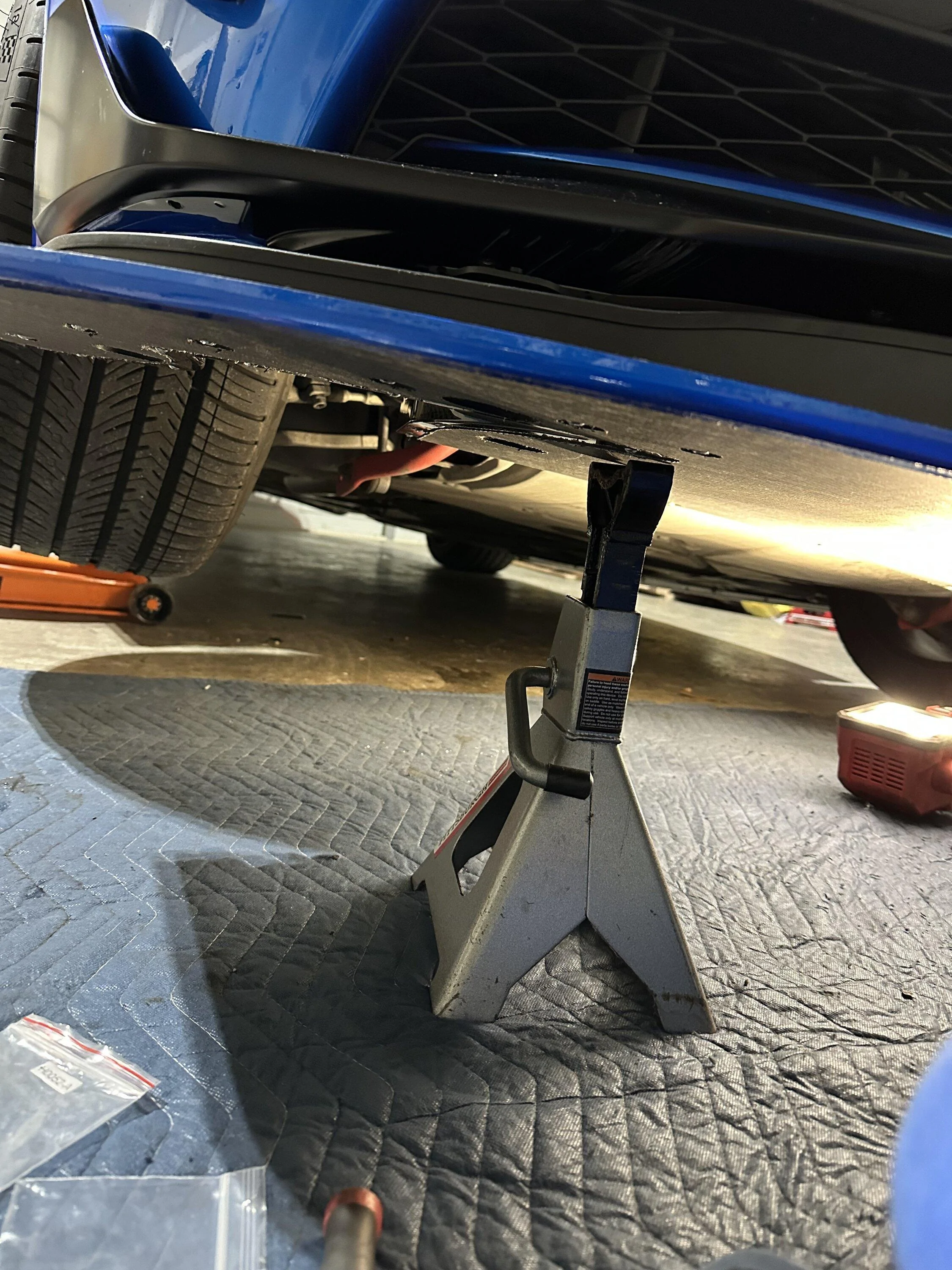

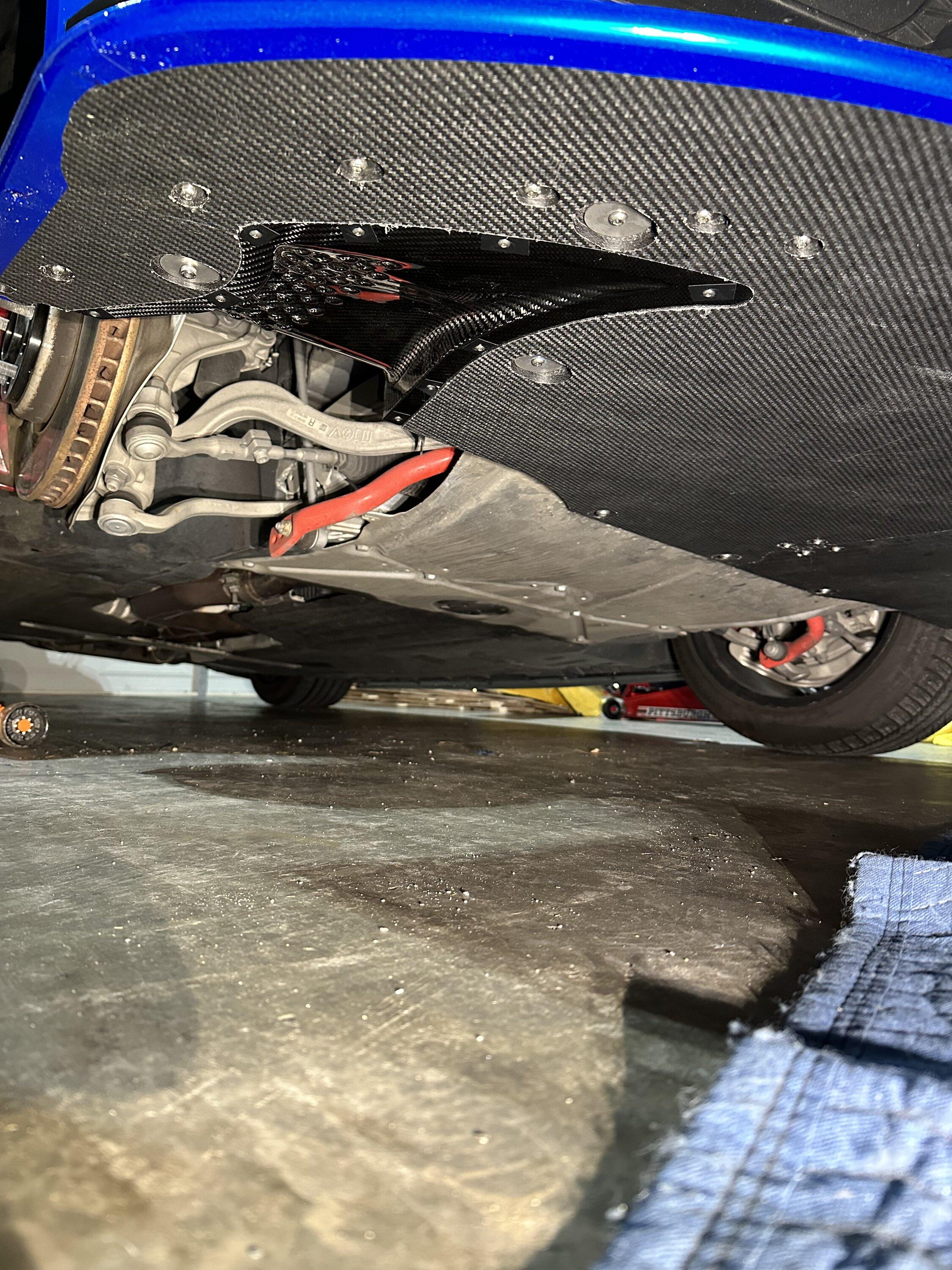

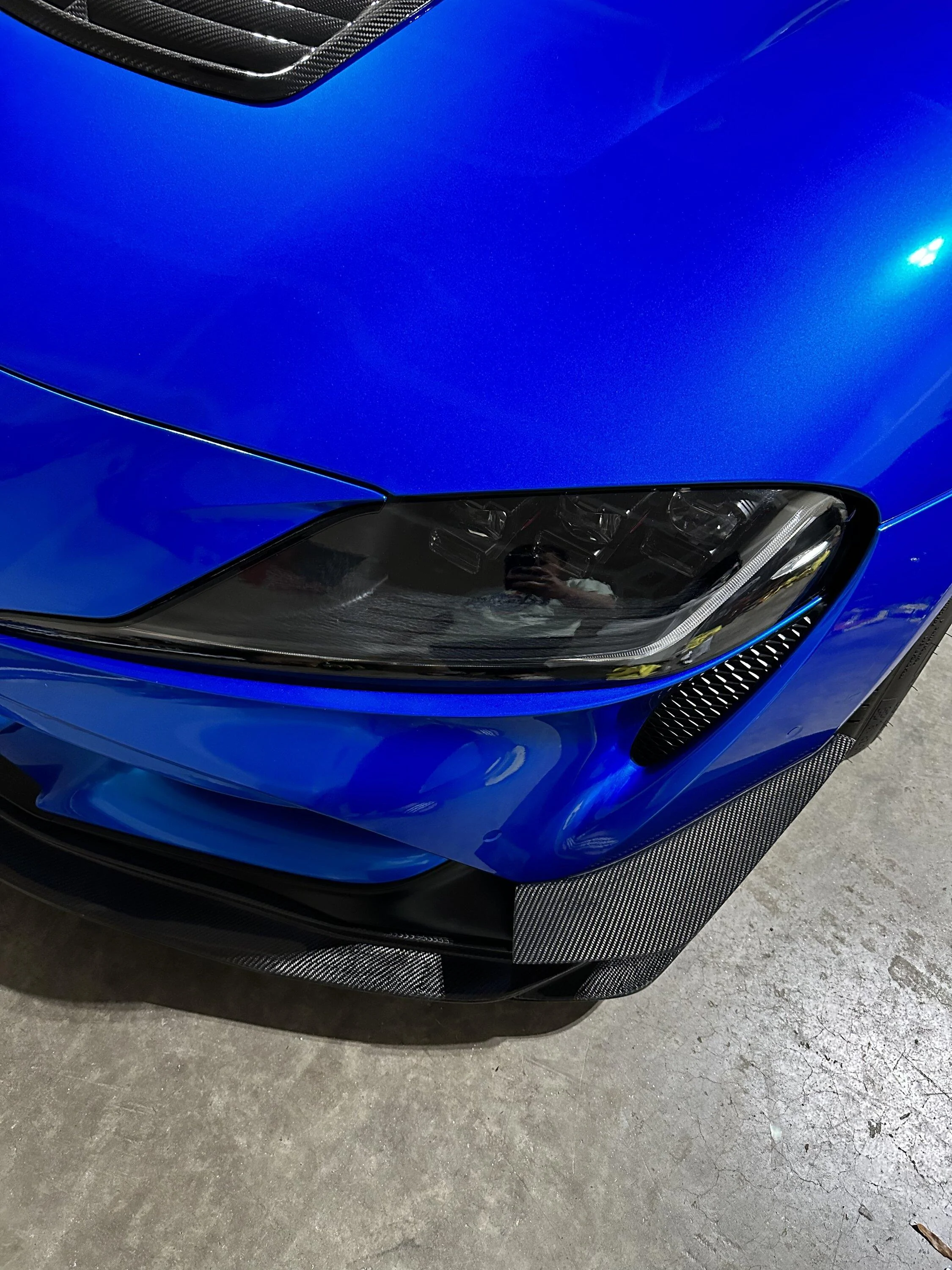

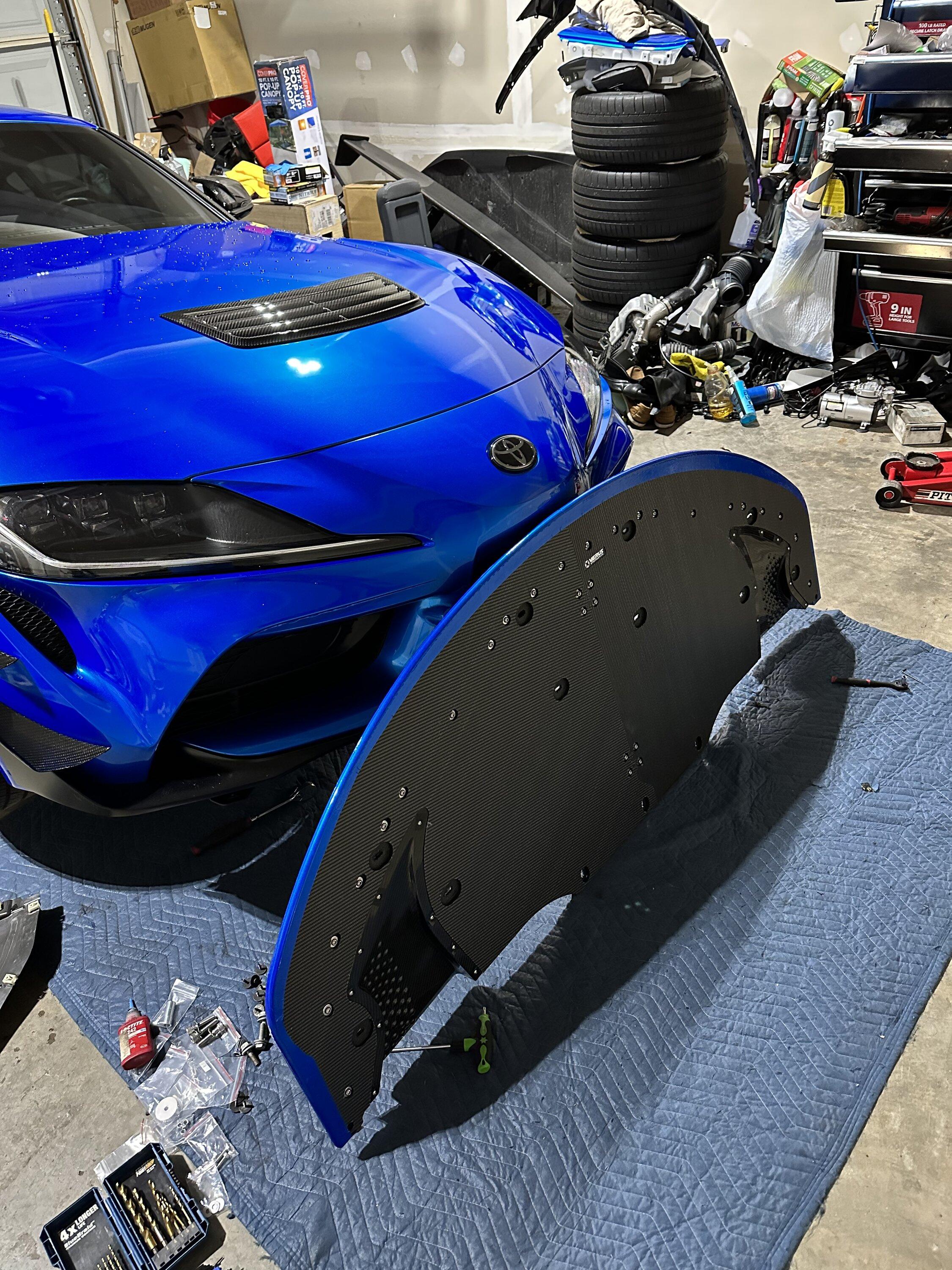

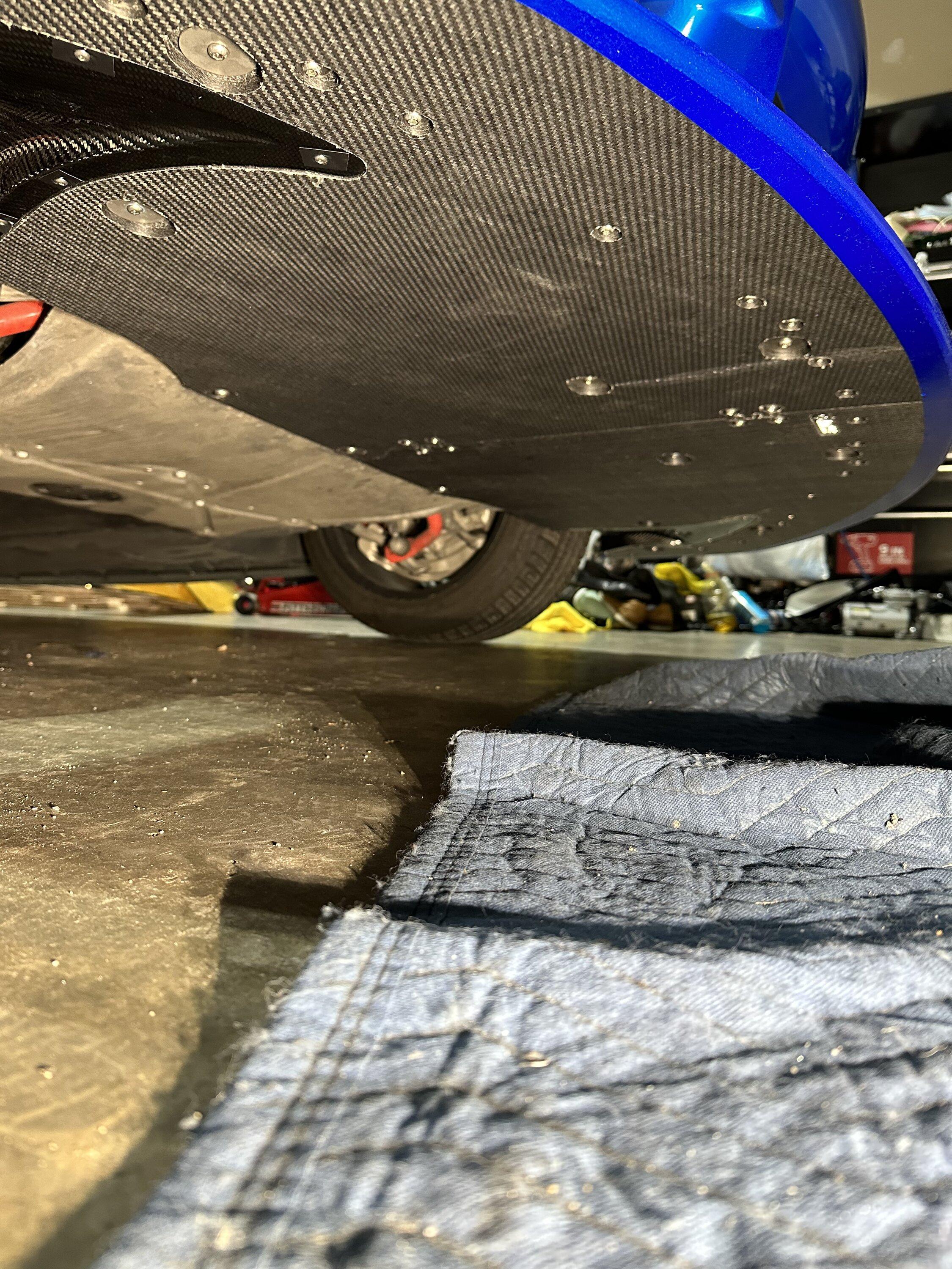

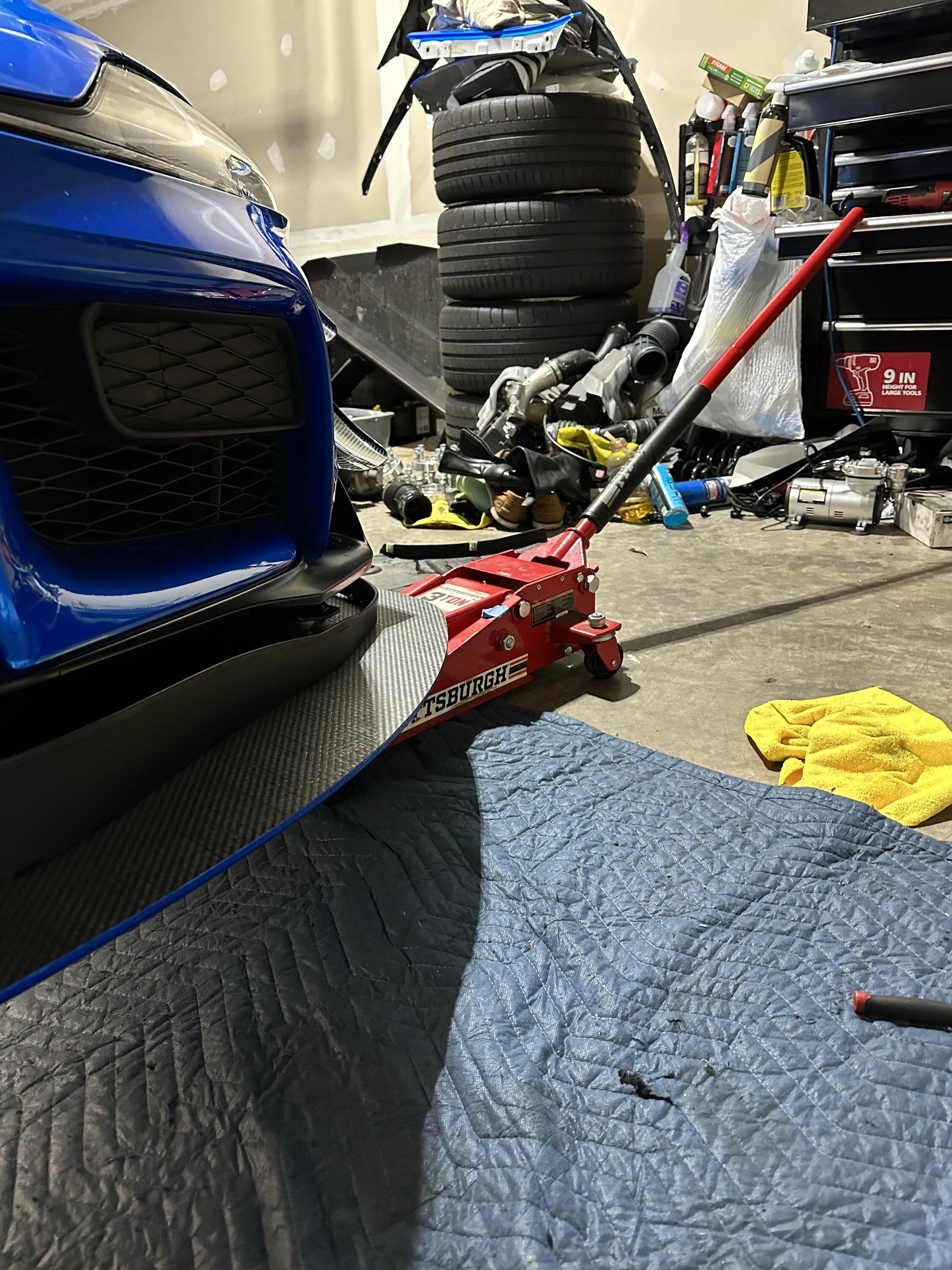

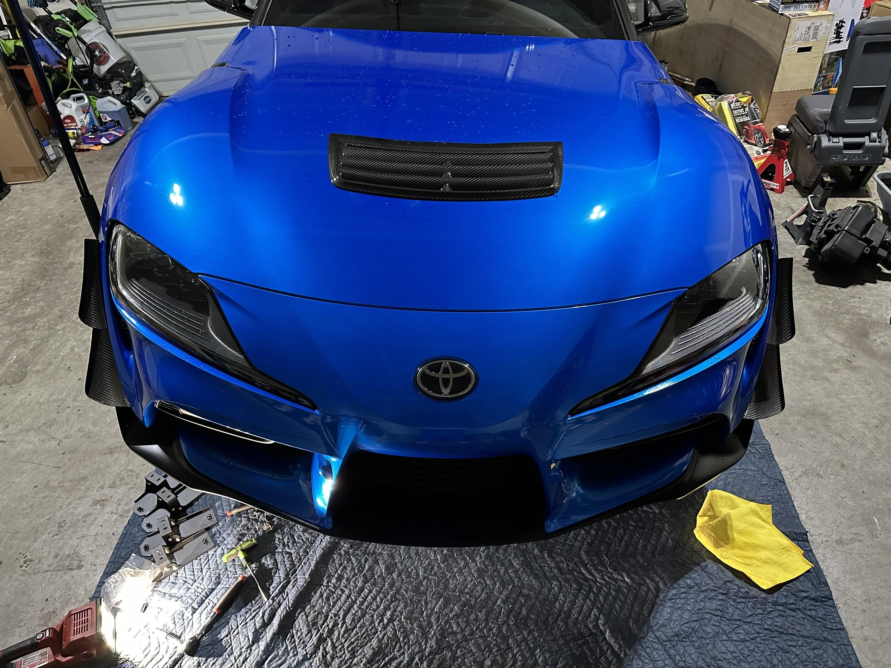

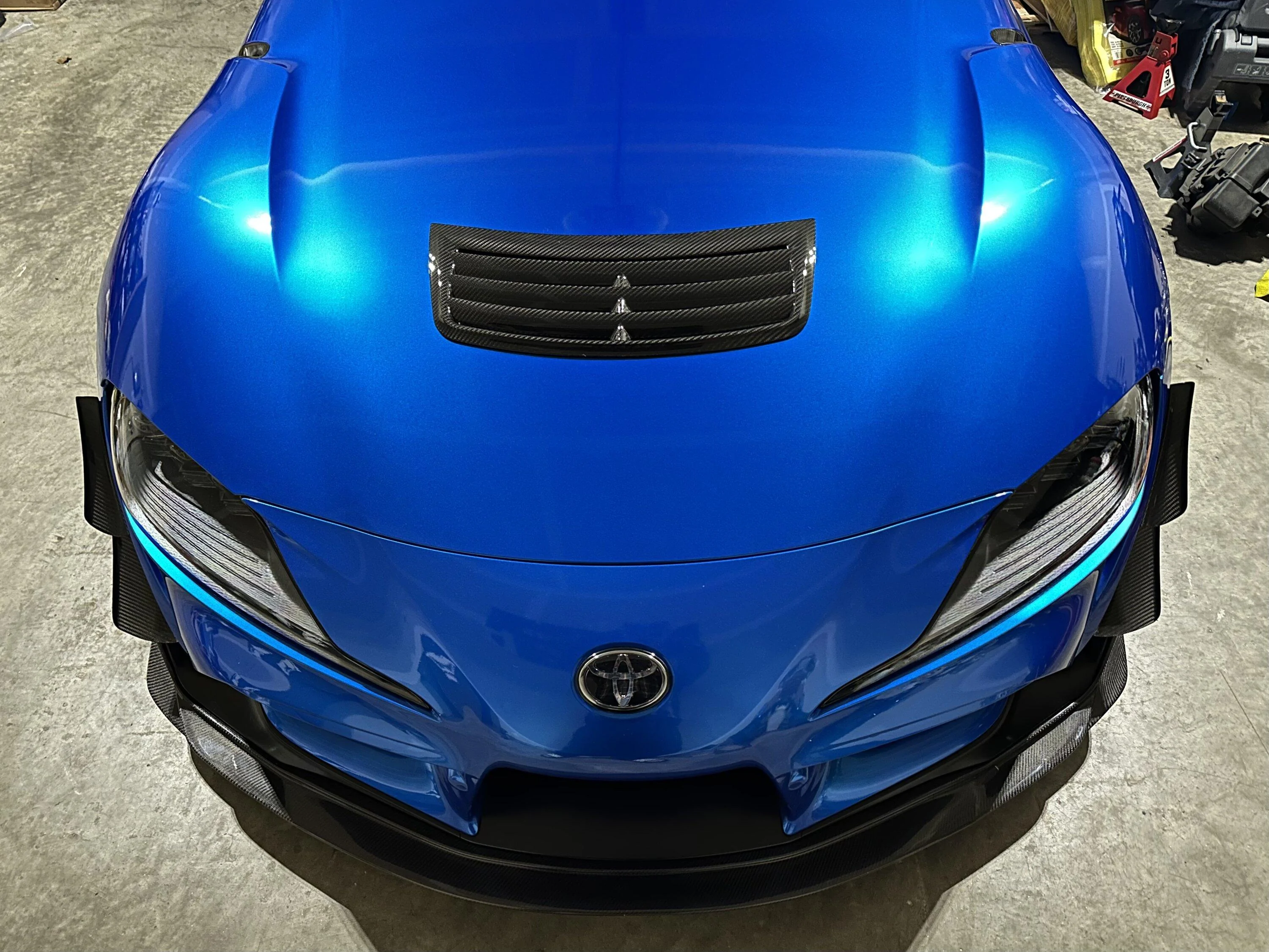

Verus Engineering high downforce front splitter! (https://www.verus-engineering.com/s...ront-splitter-kit-mk5-toyota-supra-3652#attr=)
man this thing is a beauty as it is larger all around than the V1 splitter but most importantly incorporates the splitter diffusers/tunnels underneath
install was fairly straightforward. I had the V1 splitter before so the cutting and rivnuts were already done
only extra cutting I had to do was the area in the fender well so the splitter diffuser tunnels will sit flush. Also there’s one small area underneath the side of the bumper you will need to drill a hole so the hardware can sit flush through
The install I did alone as one person so I used the help of my jack and jackstands to help situate and hold up the splitter so I can fine tune it so everything can sit flush. Note: I had to slightly less than 0.5mm lightly sand down one side of the splitter diffuser cuz it wouldn’t sit flush when i bolted the splitter diffusers/tunnels. Minor thing nothing difficult , anyone can do in my opinion
Also , I added some black tape on the splitter diffuser/tunnel bolts to make sure everything is sealed when I drilled through the carbon diffuser/tunnels
