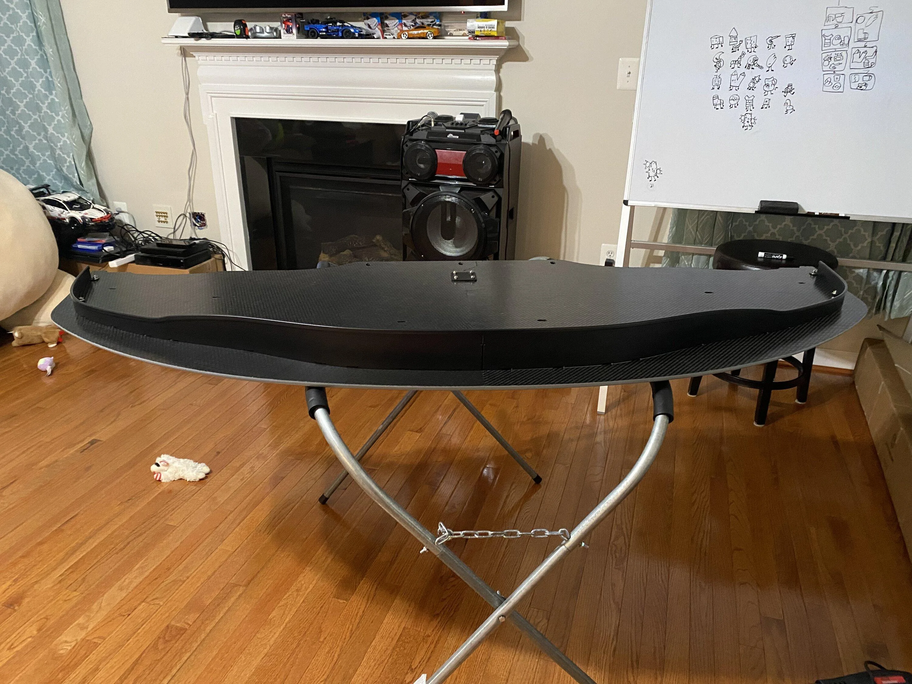

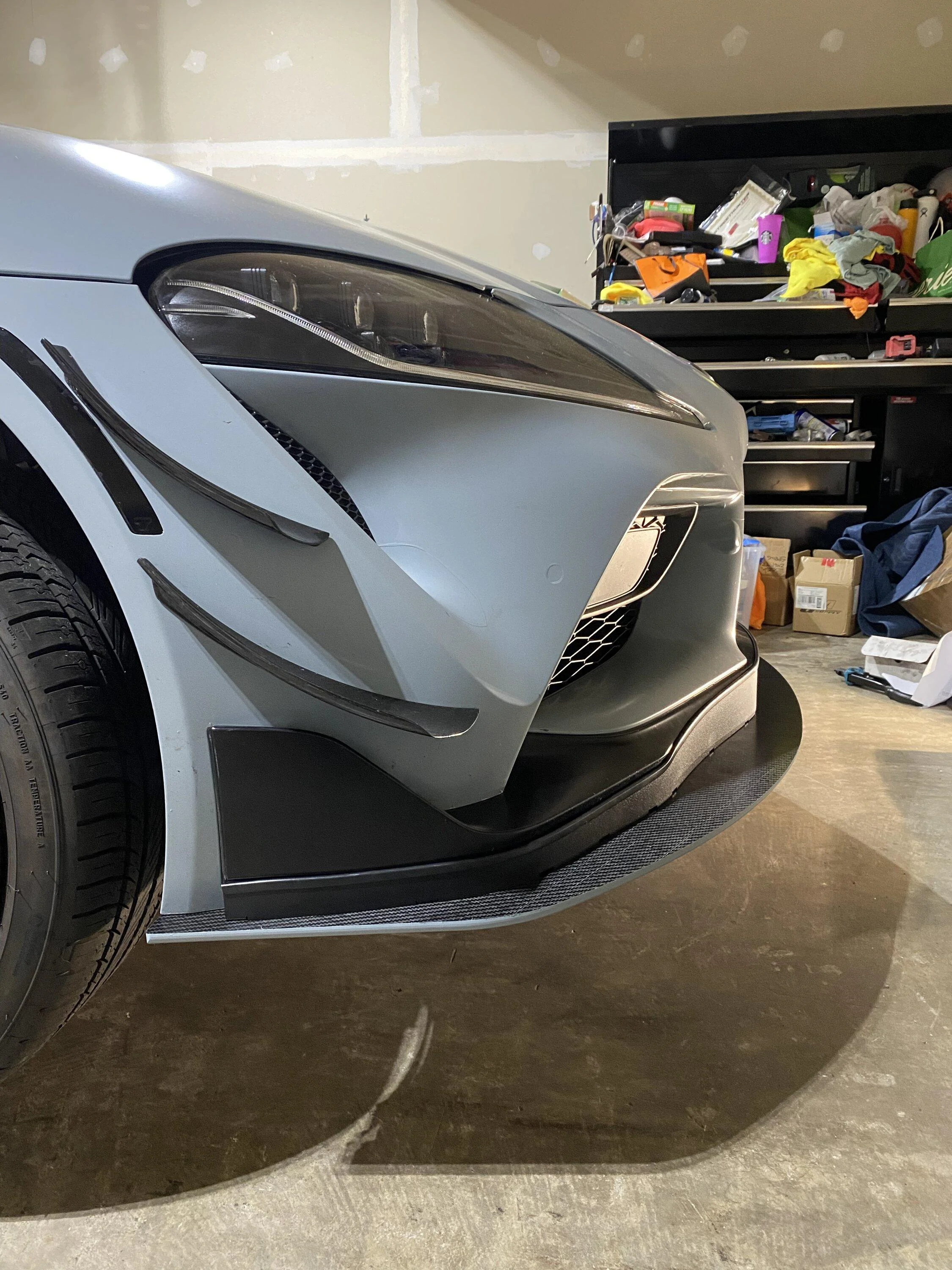

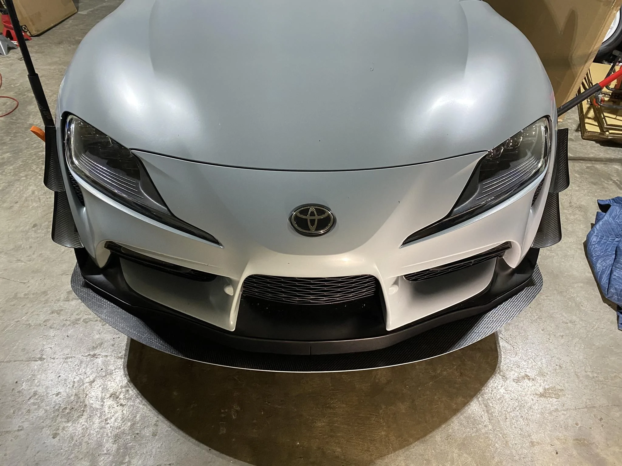

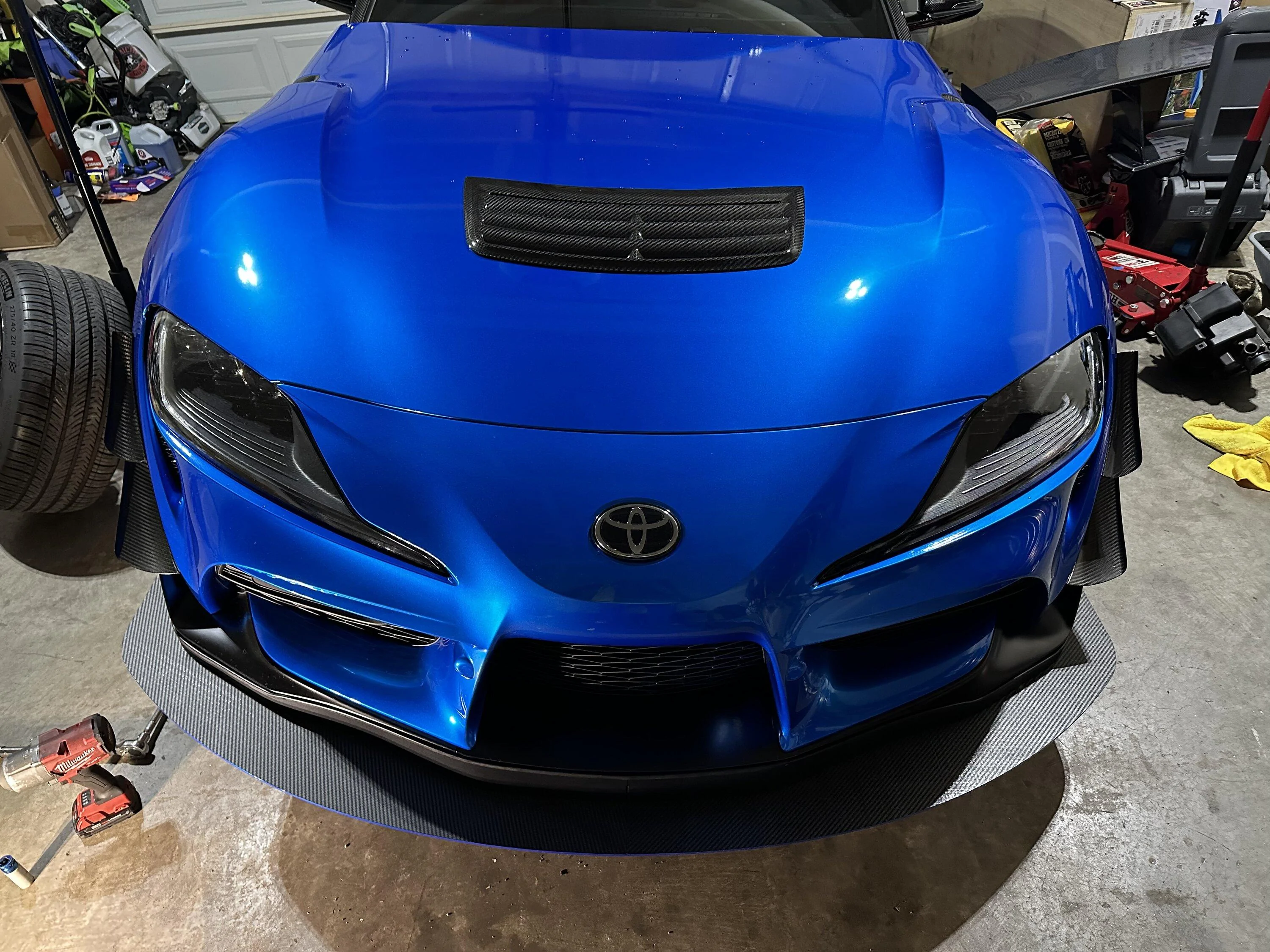

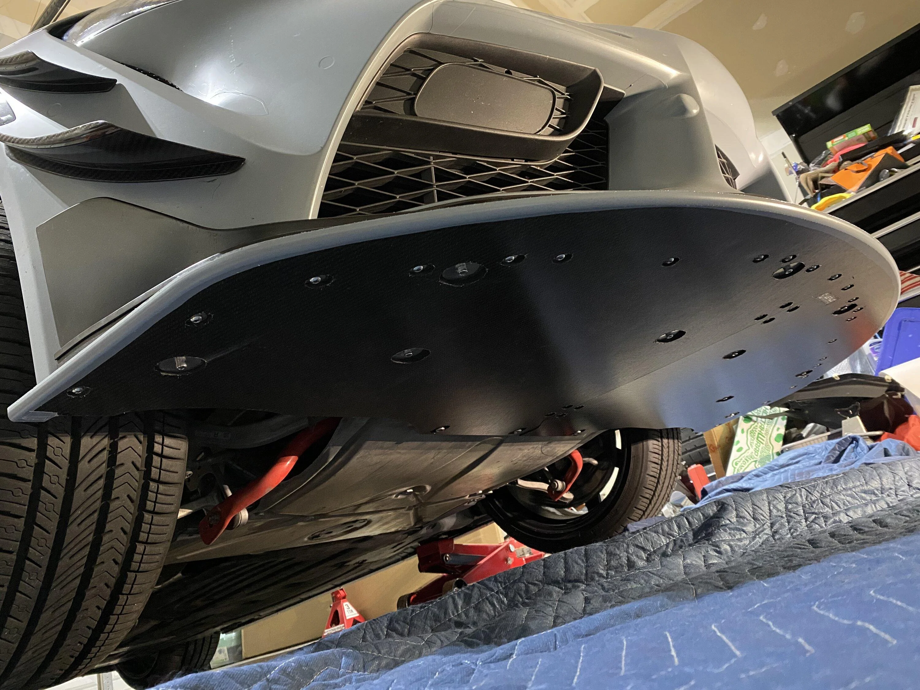

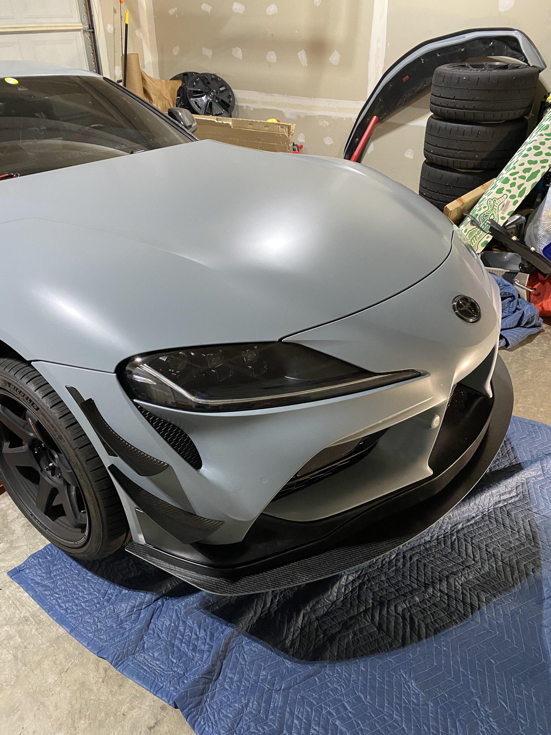

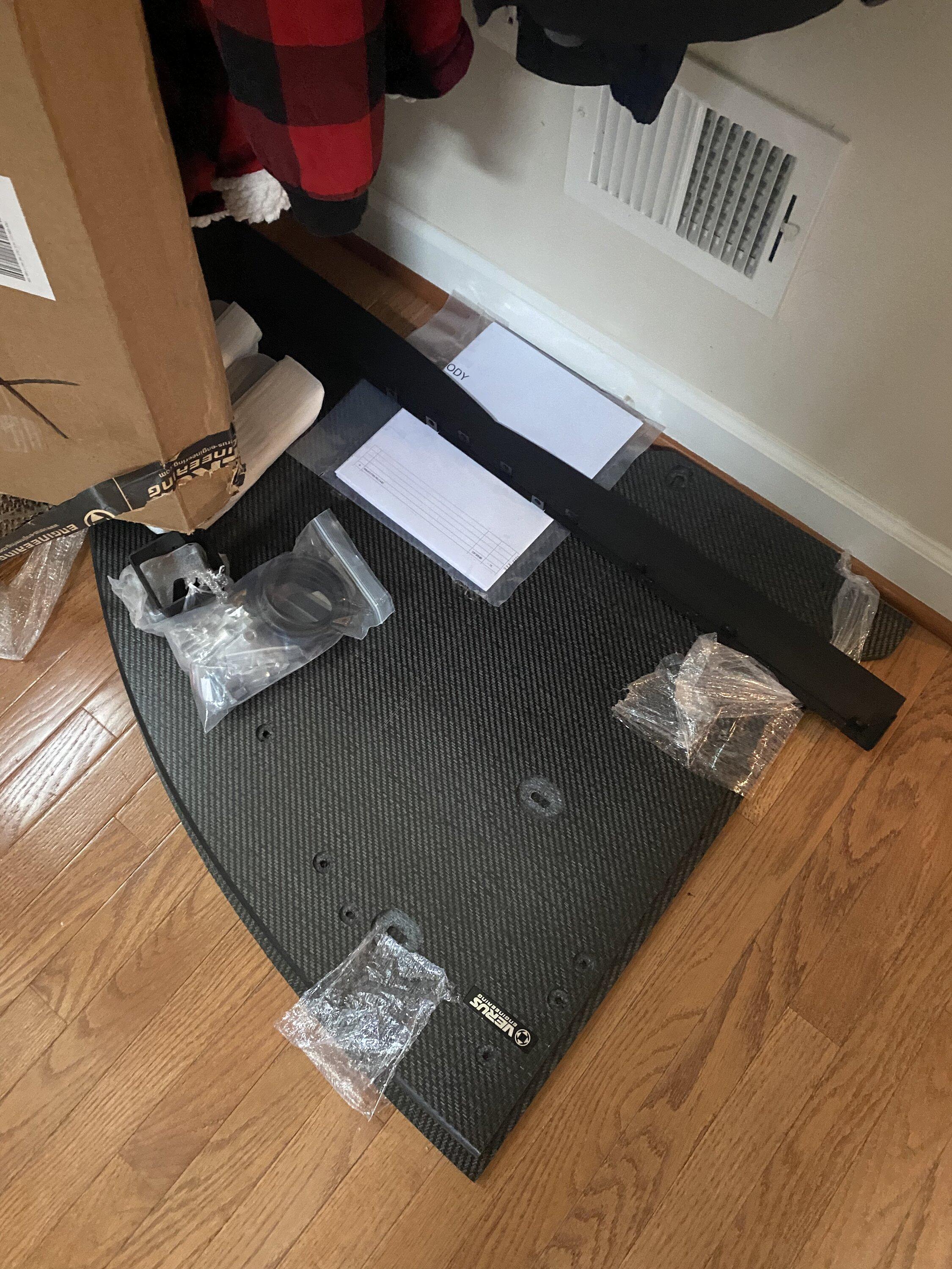

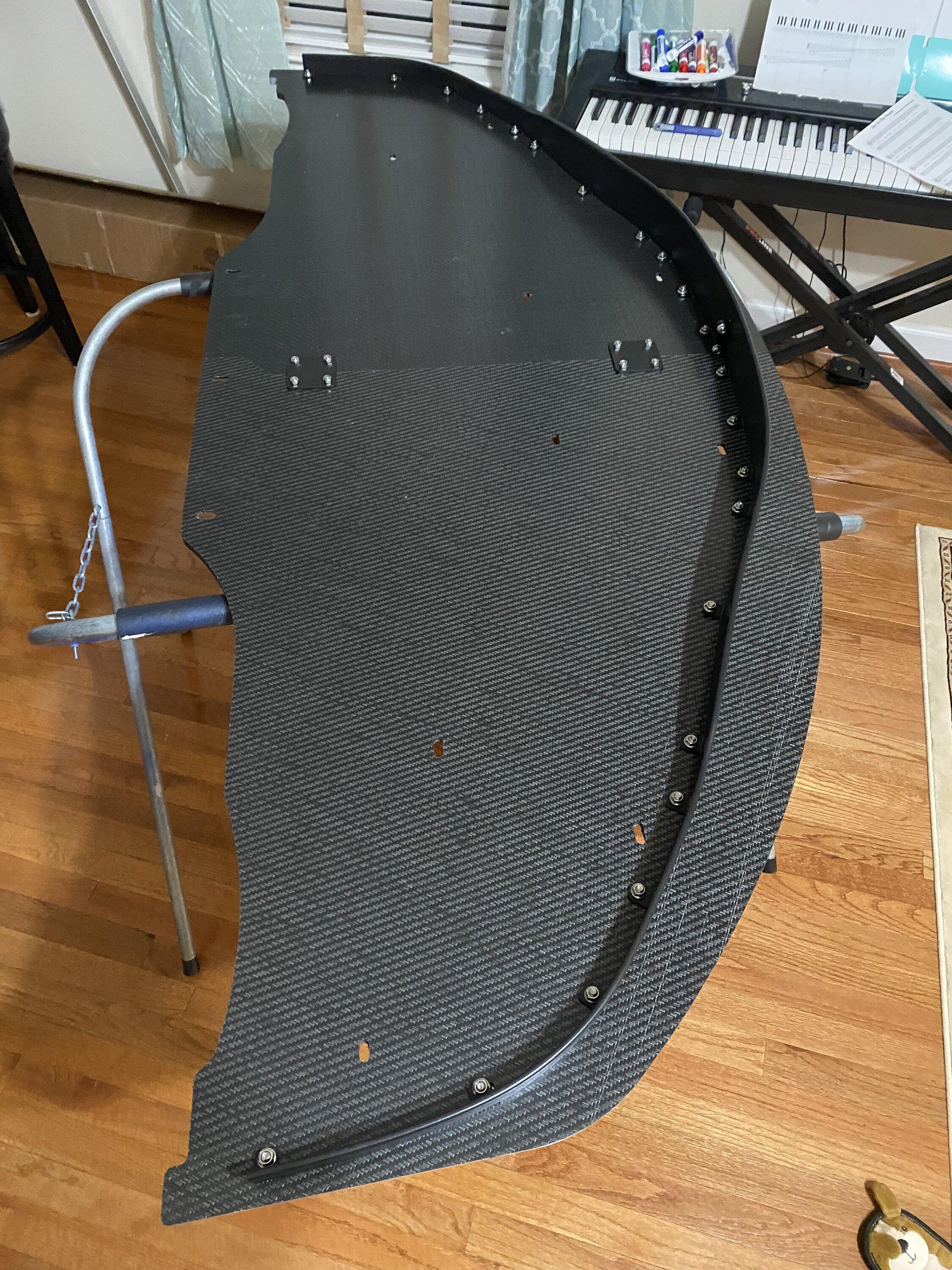

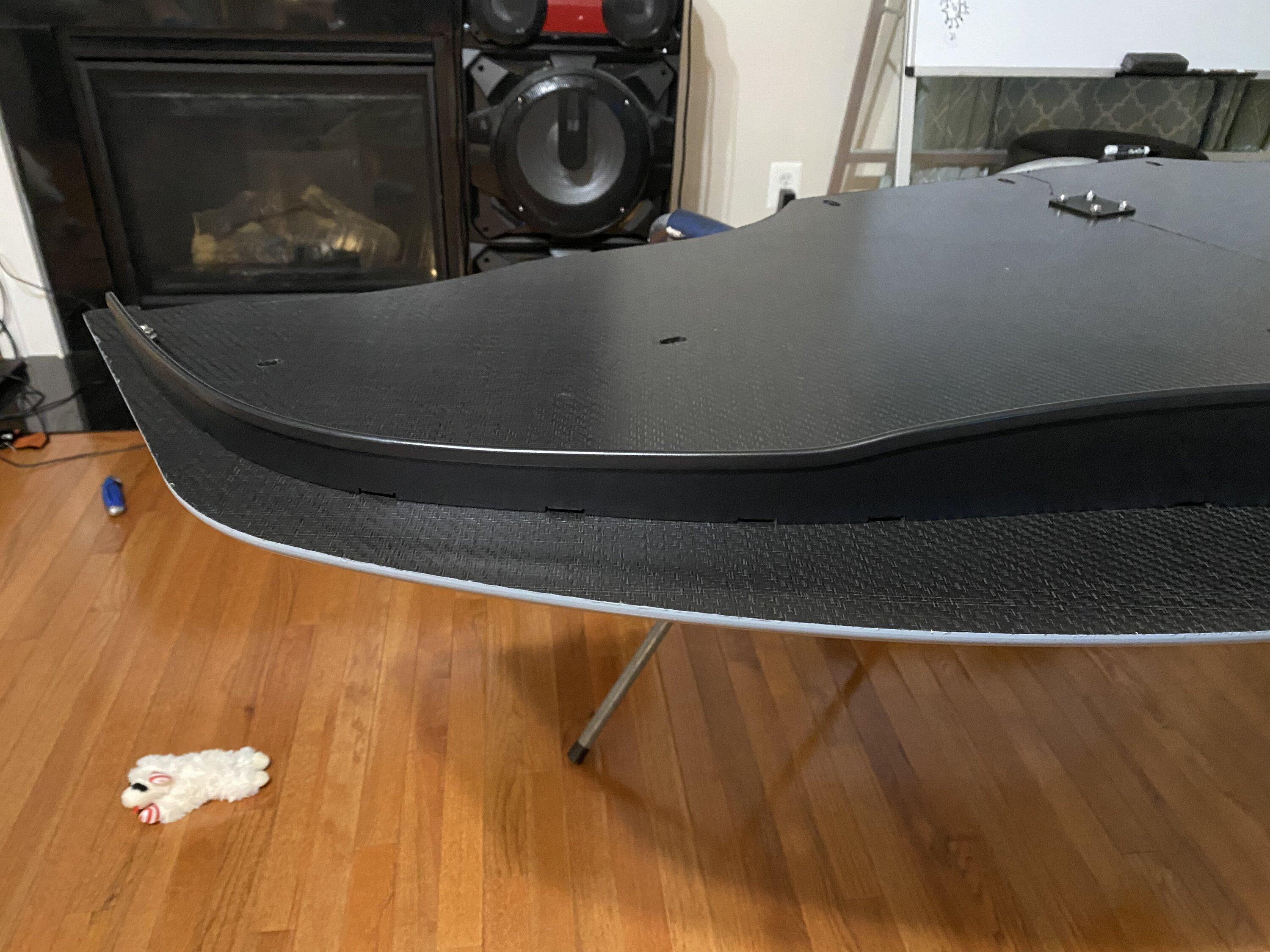

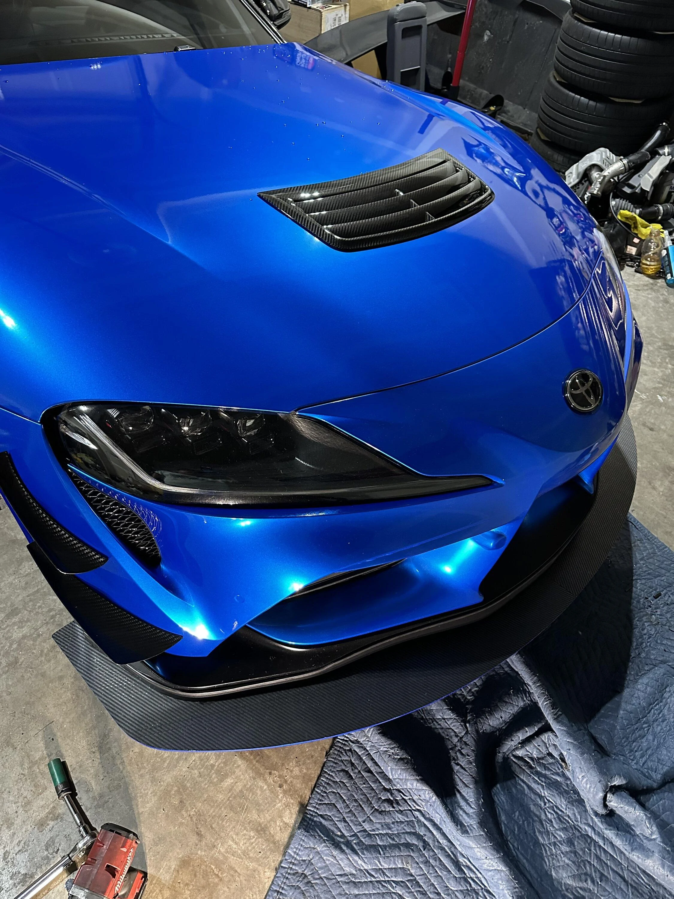

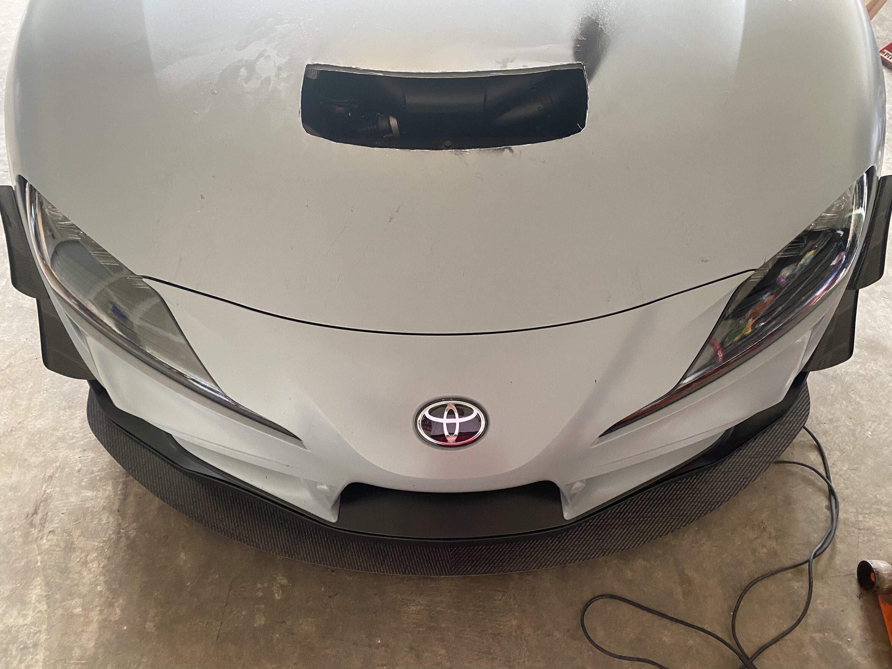

Verus Engineering front chassis mounted splitter! They’ve changed the splitter material to a more carbon carbonpolyweave look that’s glossier you can say
some pictures of the splitter assembled off the car and adding some pinstripe touch to accent the splitter with the rest of the Verus kit. I love the way their splitter is made with holes for the bolts so noting scrapes the bolts so removable is easier when needed.
The Verus splitter also has a cool functional airdam that allows air to not get between the splitter and lip. I’ve learned to love serrated nuts because it’s so convenient to not have to put a wrench or socket on the other end when tightening! Love it

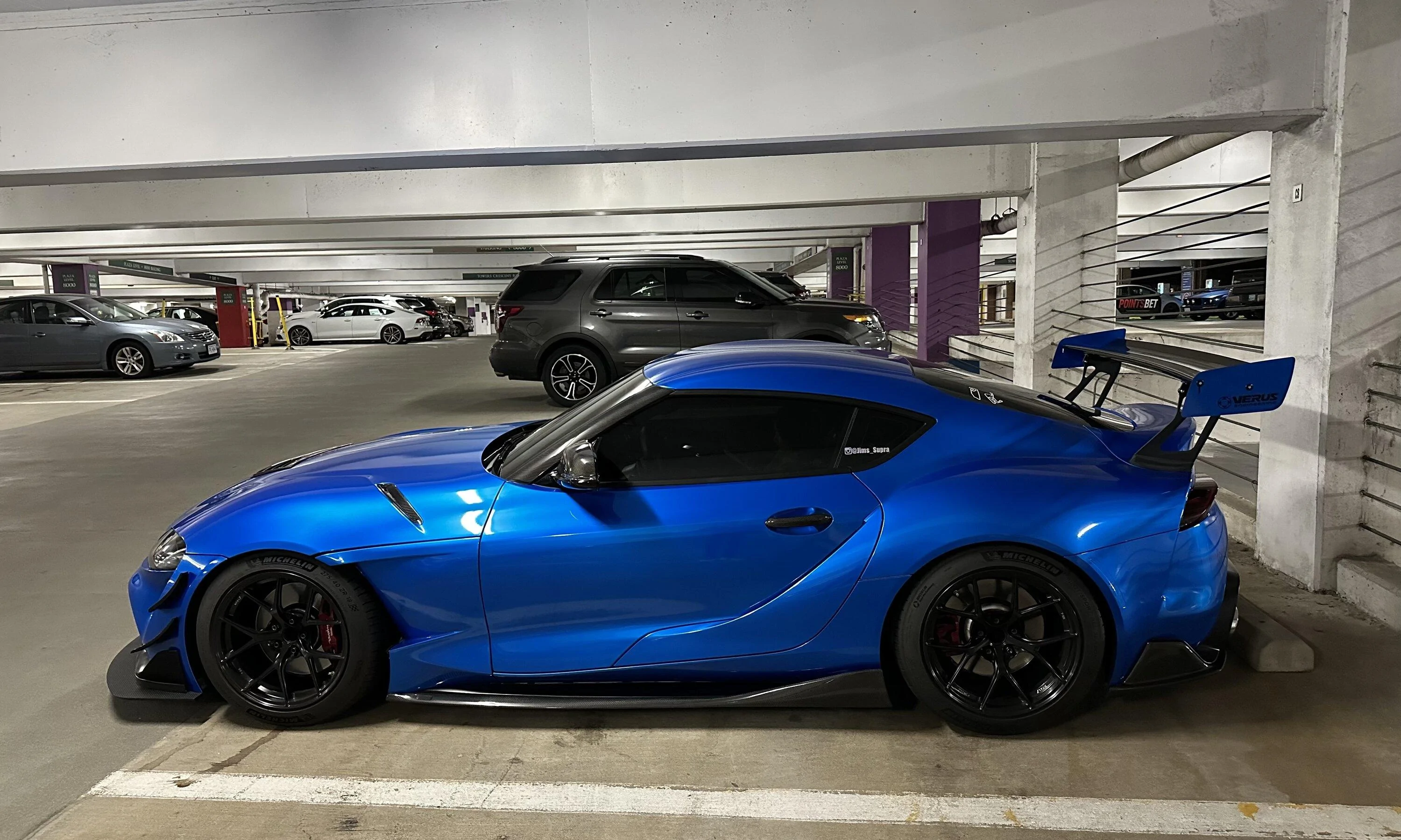

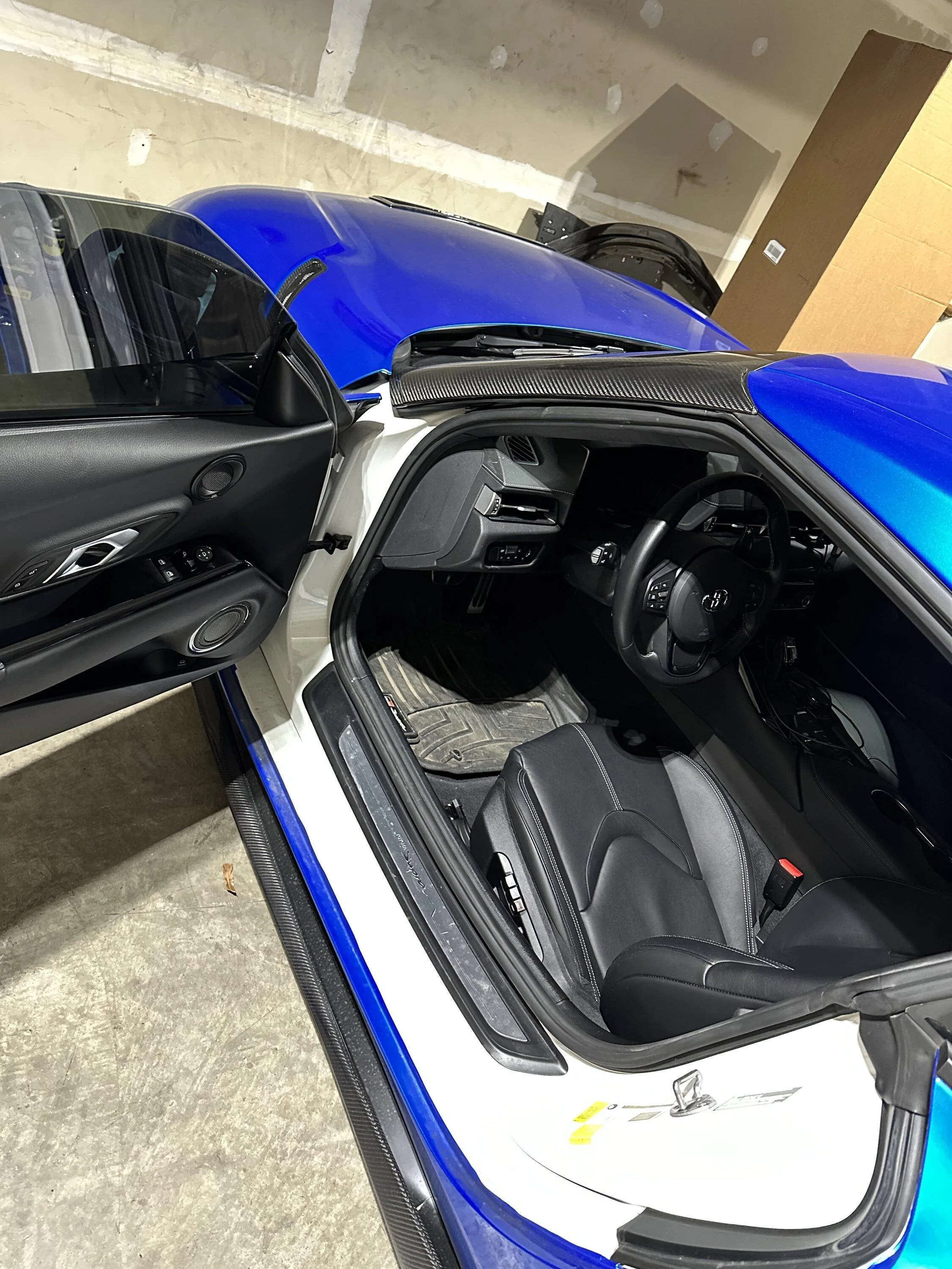

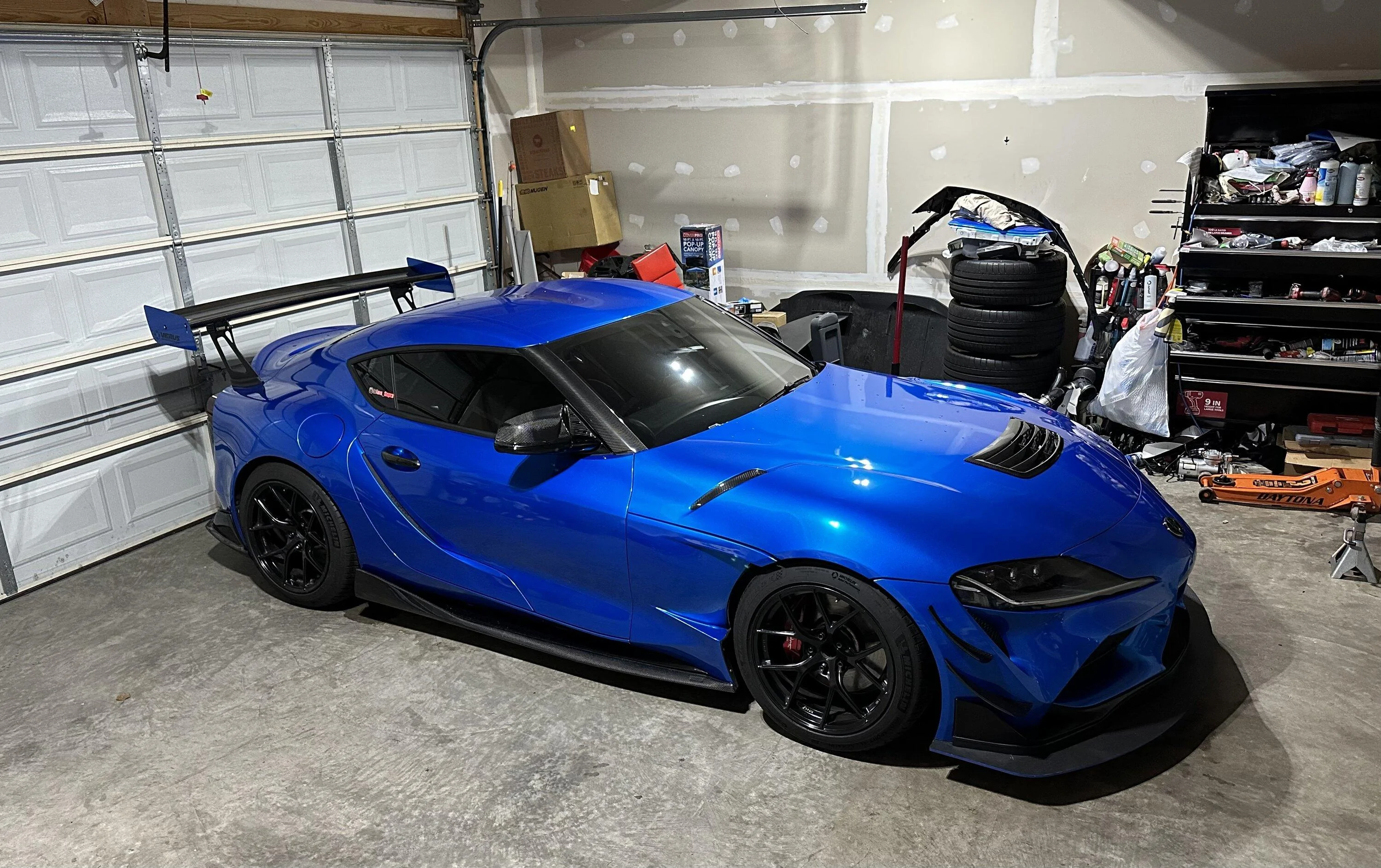

Ended up swapping in a cash deal trade back to black oem setup. I think the black interior is actually very clean and combos well with the blue and subtle white

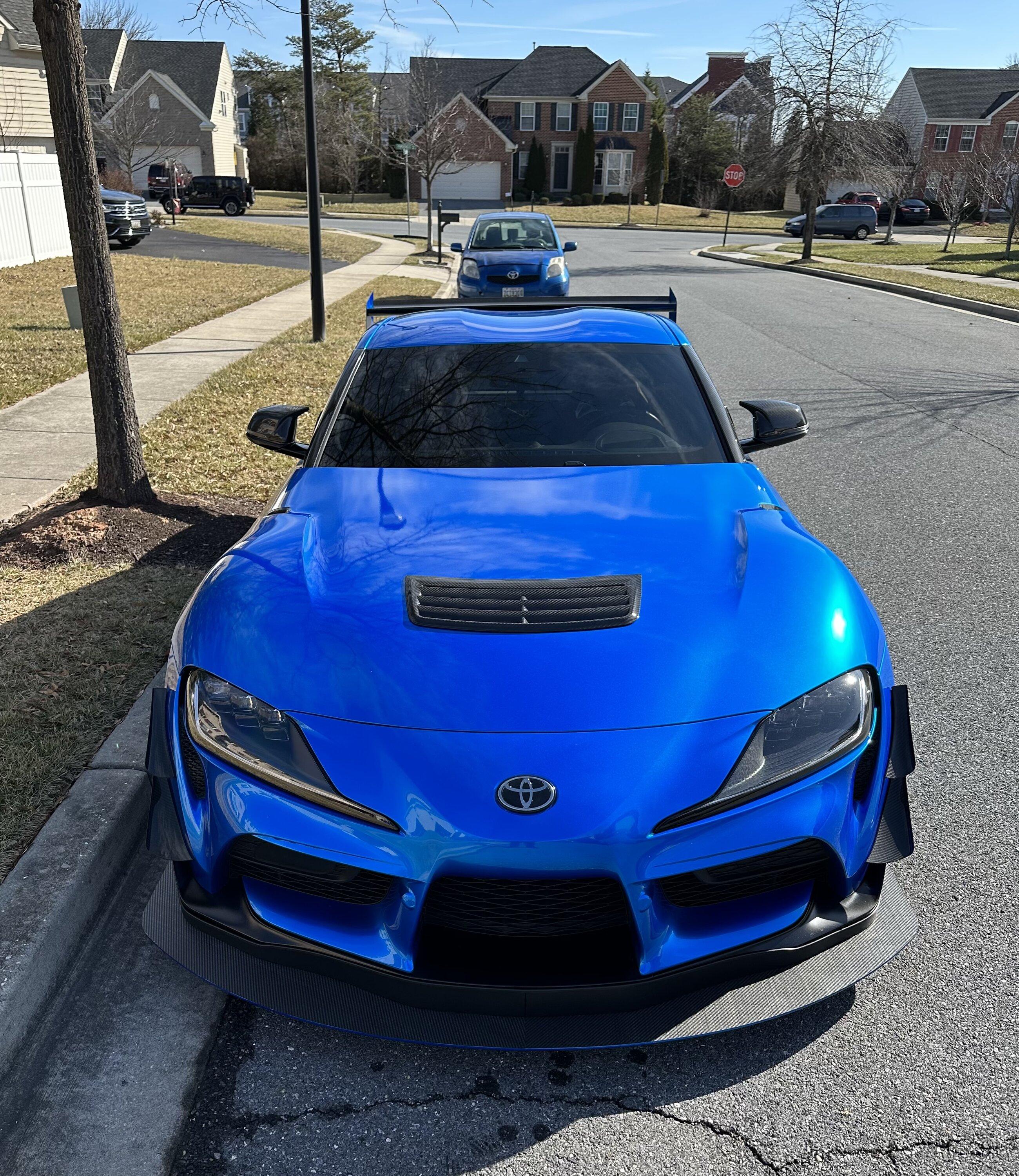

Parked in the streets of DC

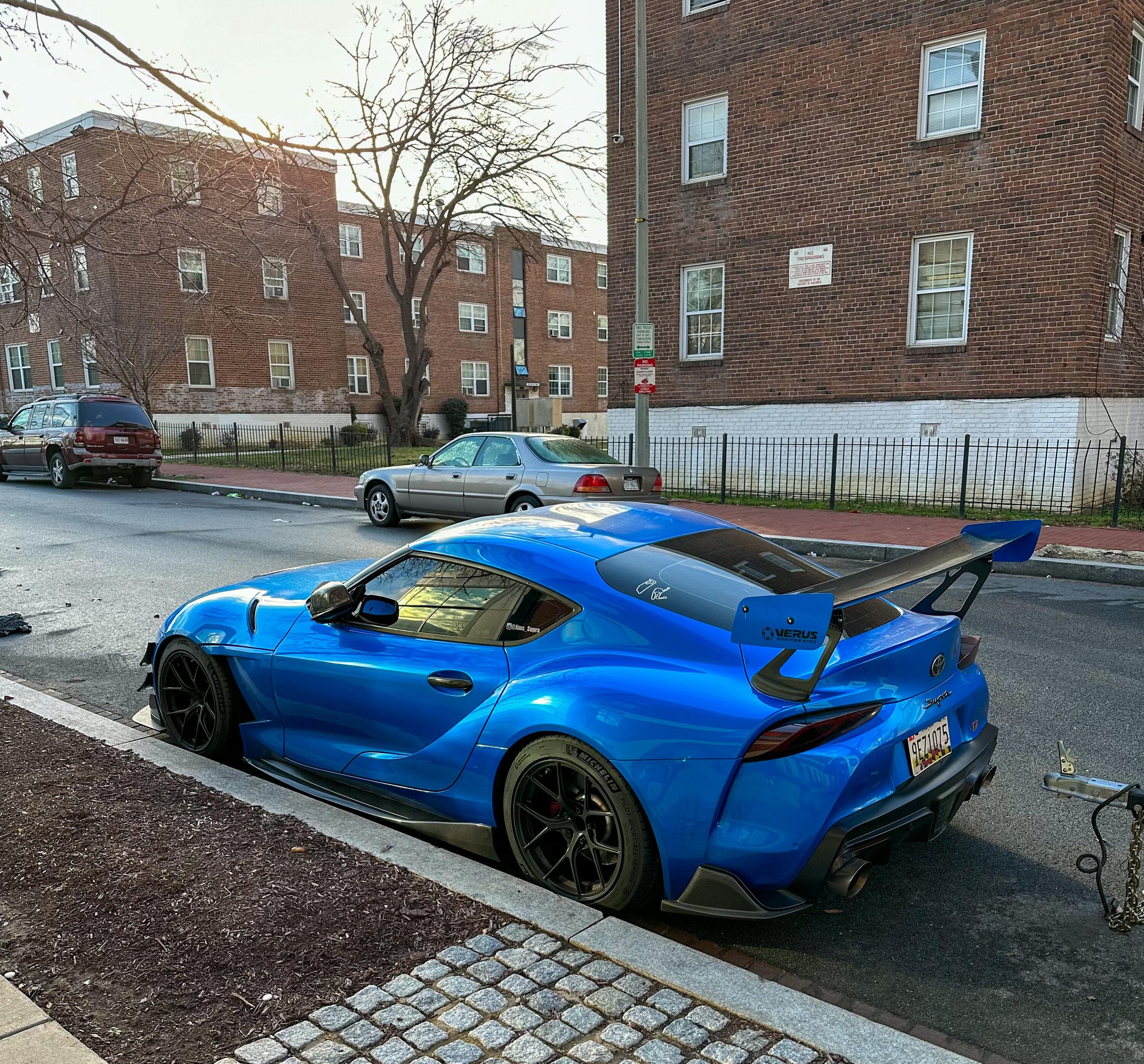

wrap color: KPMF Gloss Indulgent Blue

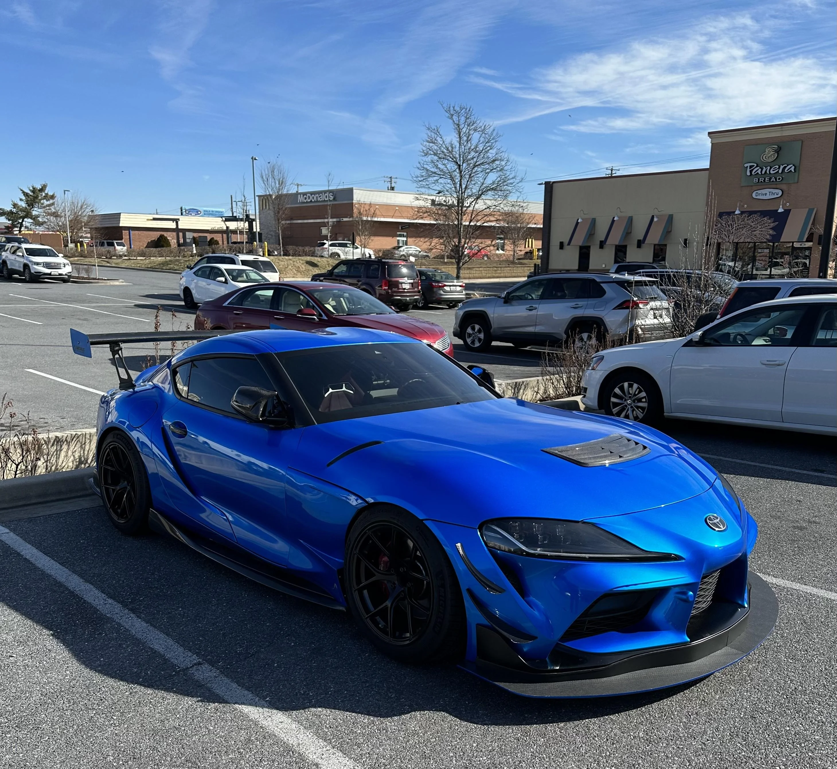

Seemed like a good shot haha. Planning to change up the color of the wheels in the coming weeks. Planning to pickup a pair of rear oems to have a squared oem set and changing the color on them too

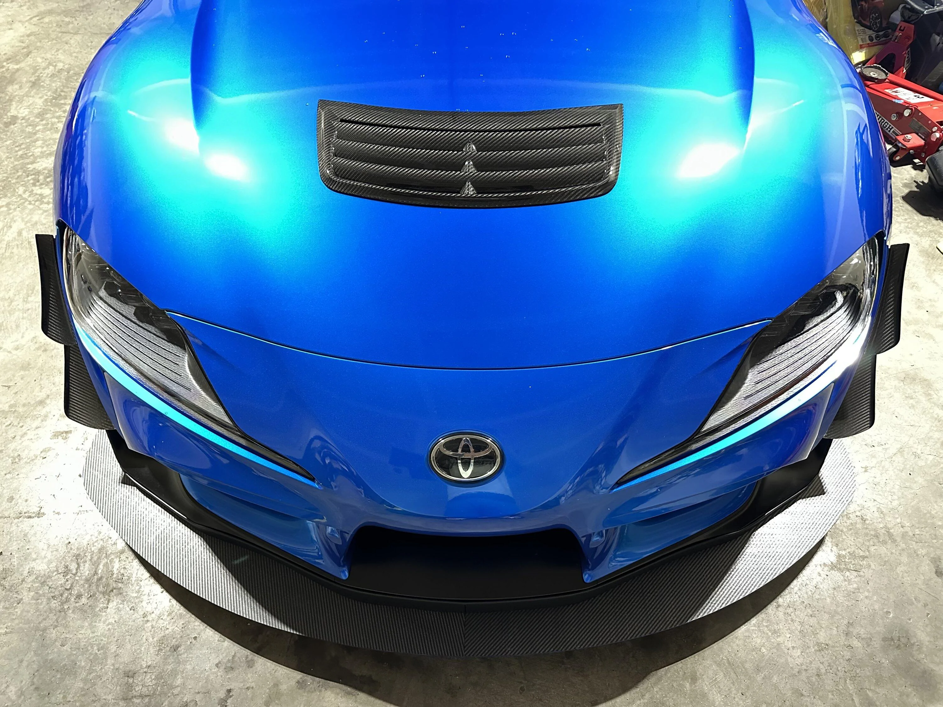

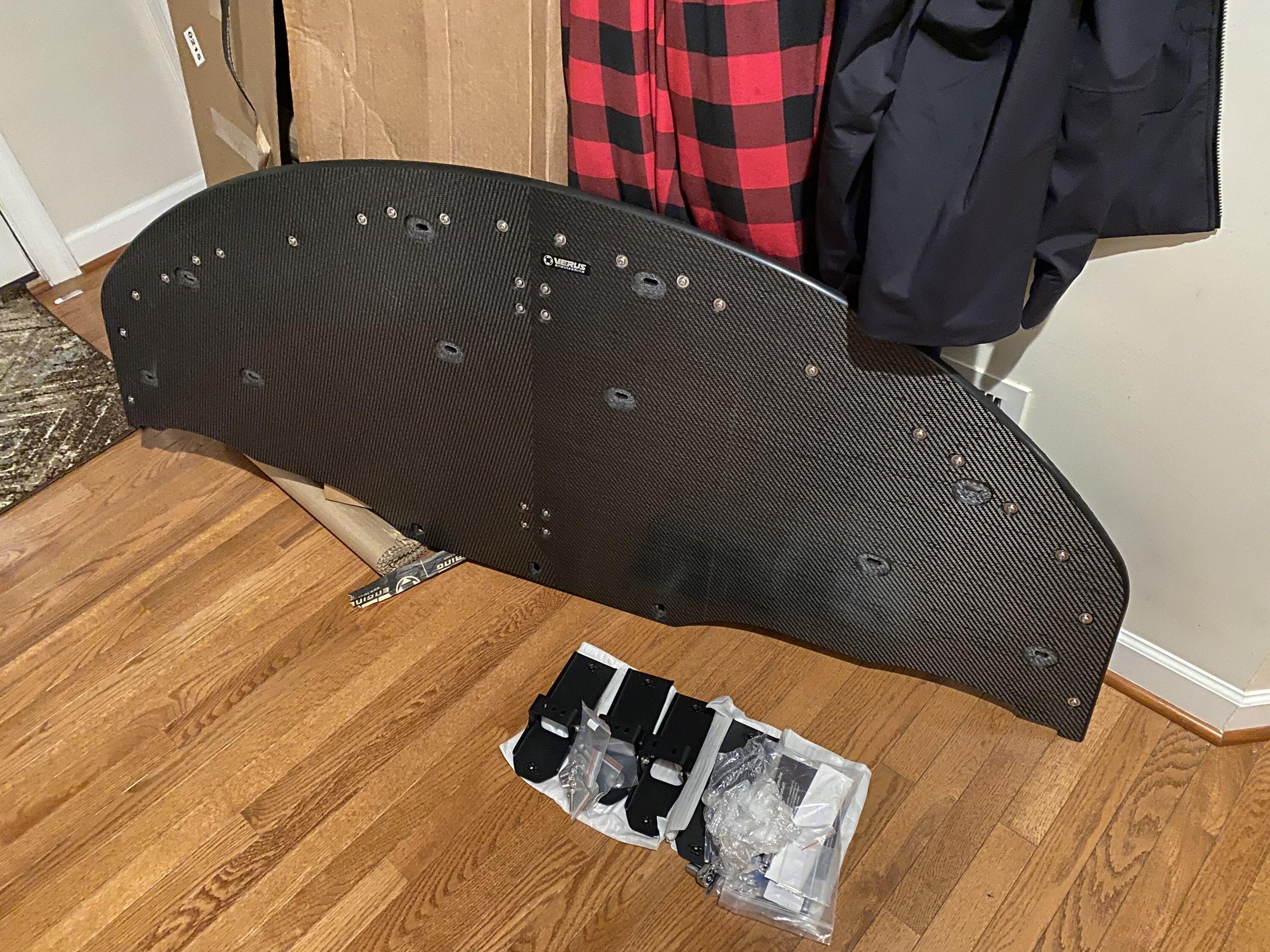

Hi downforce endplates from Verus! Need to get these on asap!

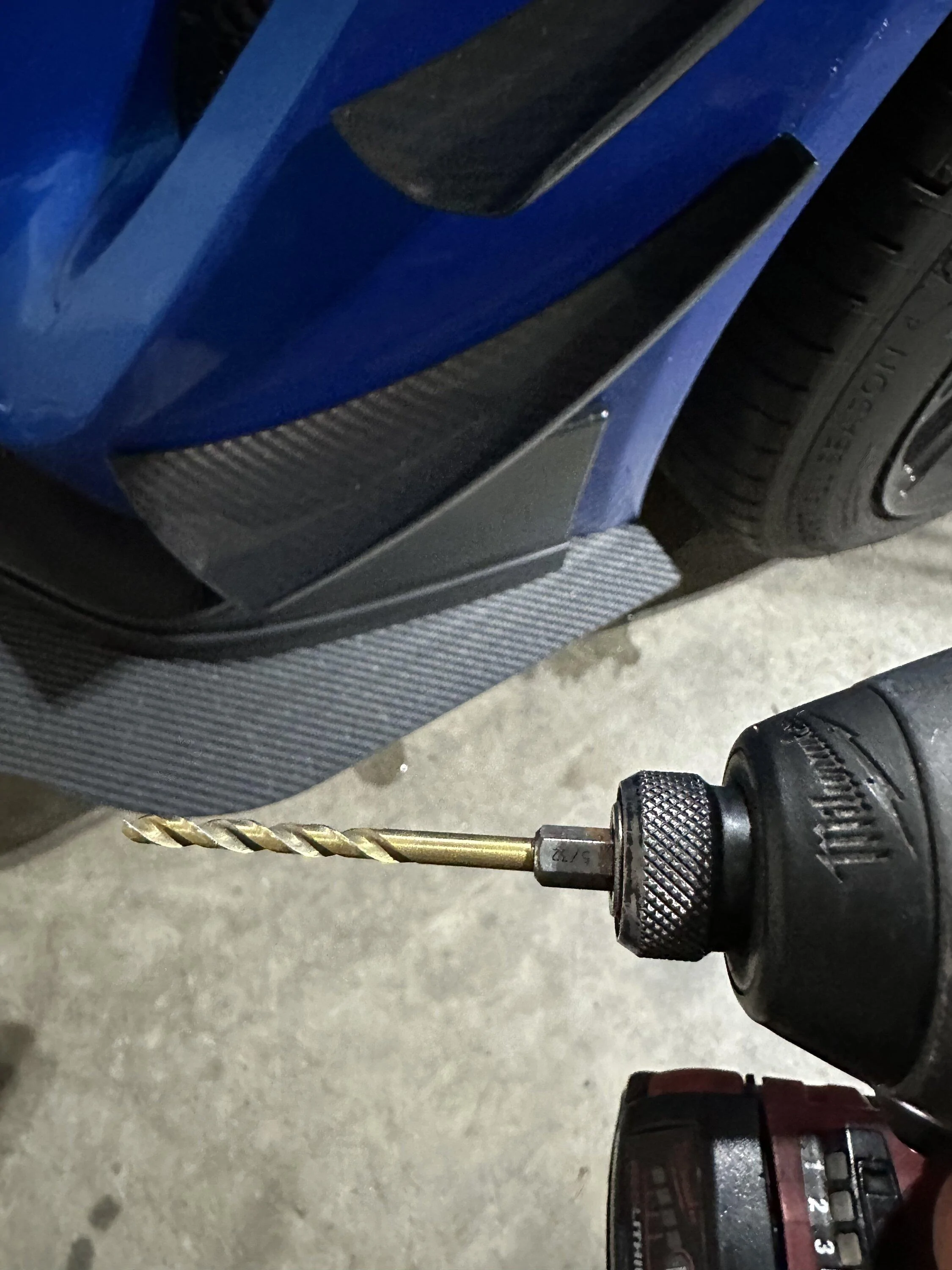

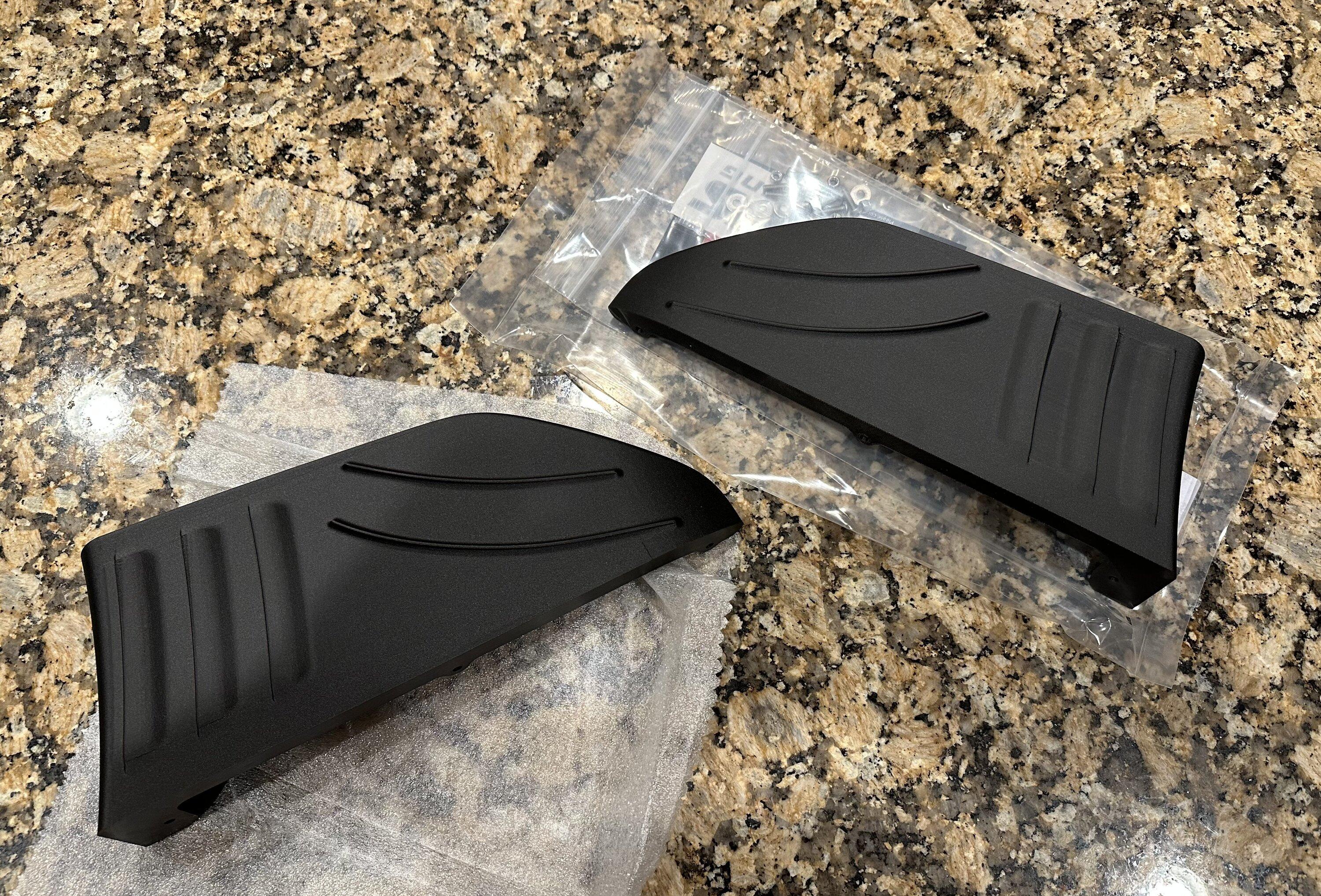

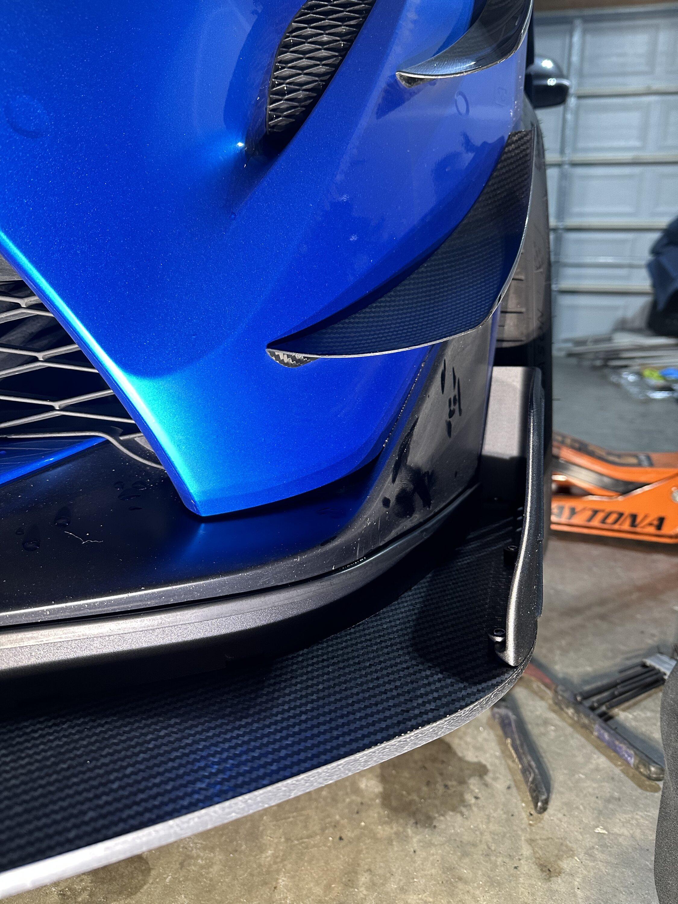

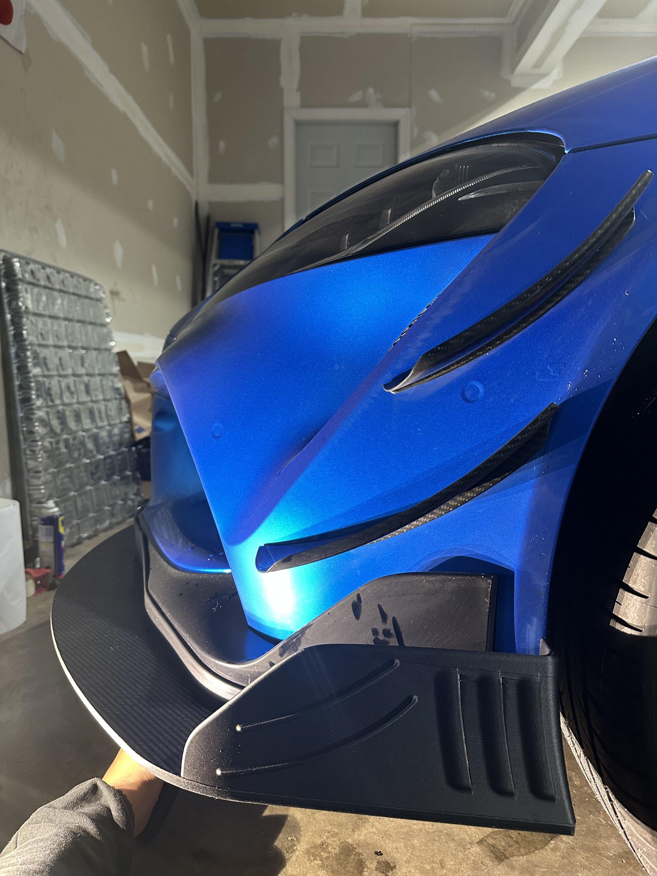

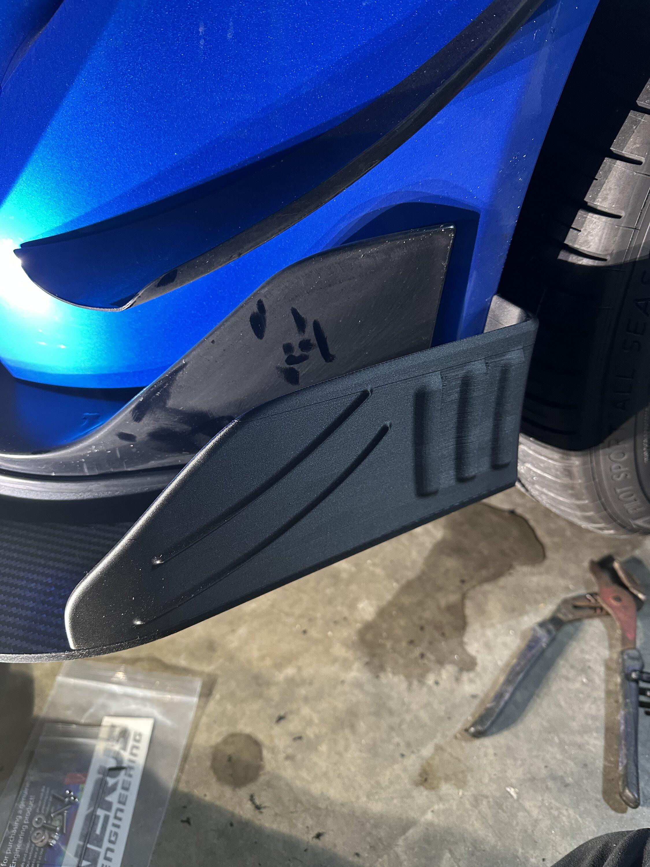

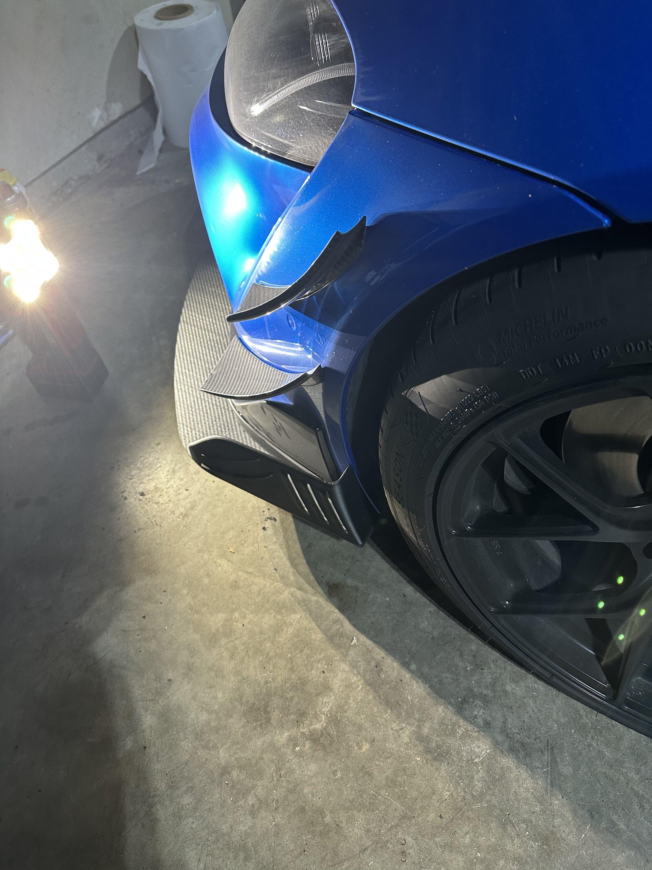

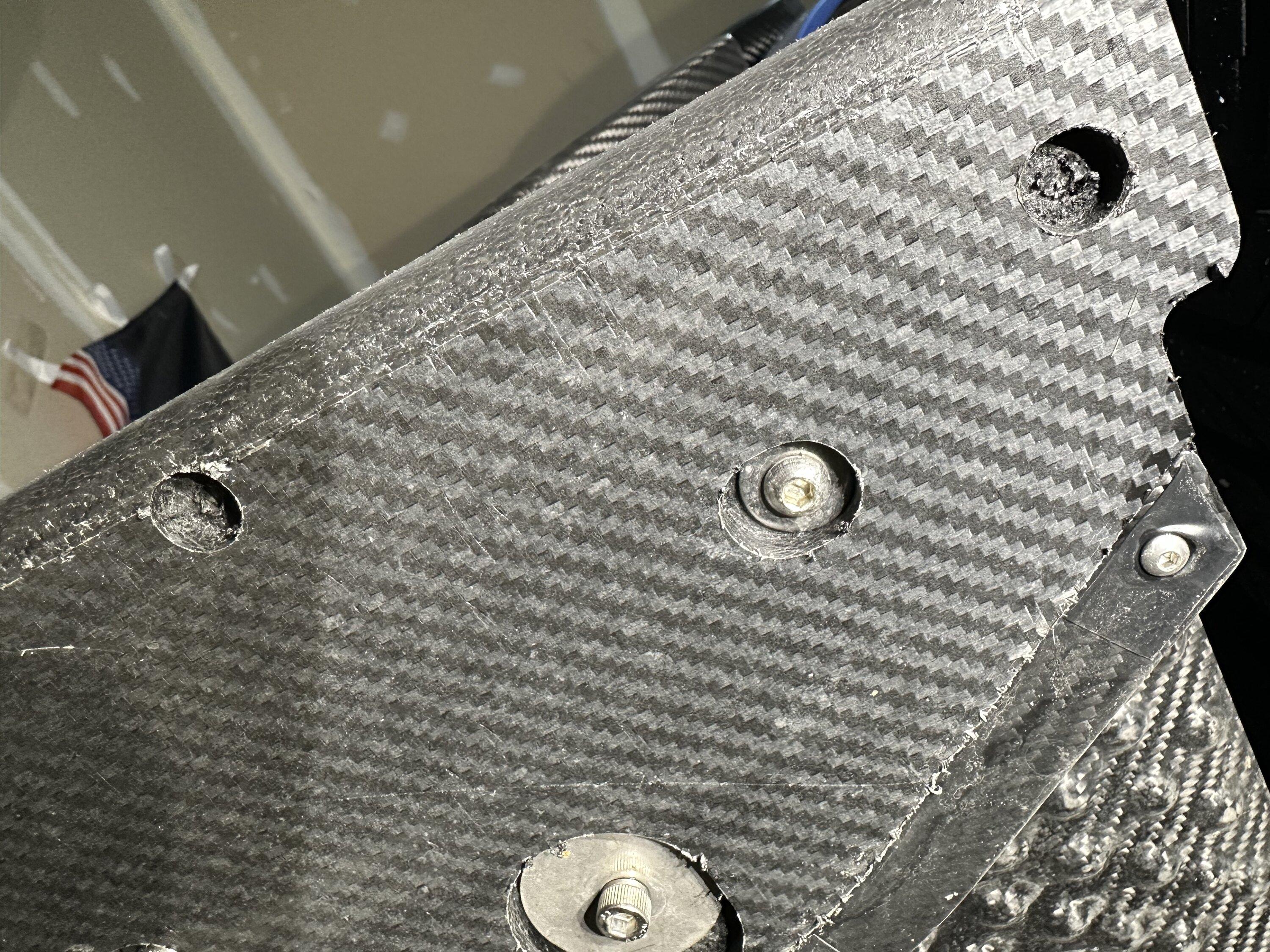

Hi-downforce endplates are on! From Verus engineering to go with the hi downforce front splitter
very easy to install. The nuts sit right in place. The holes were precut from Verus underneath and I drilled with a 5/32 bit as instructed and tightened with 2.5mm allen key. Snug hand tight nothing too crazy since they are nyloc nuts too
Fit and finish was on point. Very cool to see all the functionality. Can’t waste to test in in upcoming track events, hopefully April time
