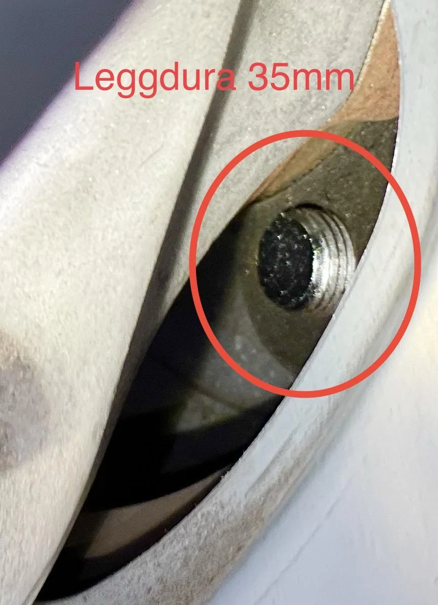

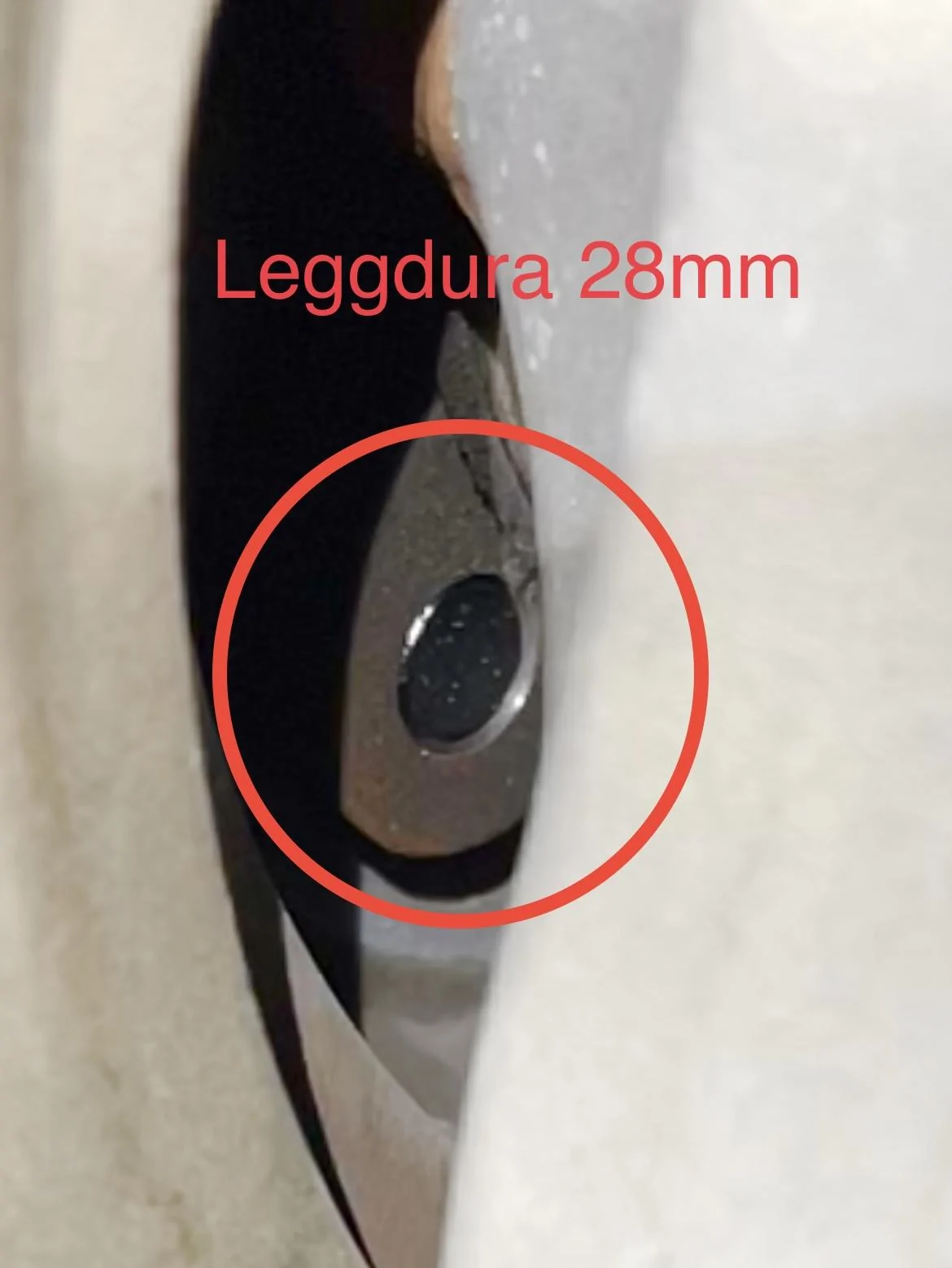

I would highly recommend the 35mm lengths for aftermarket wheels. Here is why:
Most aftermarket wheels are thicker than stock. In this picture you see the 28mm Leggdura lug bolts with my HREs.
The 28mm lug bolts don’t reach the last thread in the axle hub. There are only 8 threads on the hubs so every thread counts.
Here is what the 35mm lug bolts look like. There is enough length to engage every thread.

Would this hit anything? Being that the bolt extends past the hub?
Loco38SUP
Loco38SUP
Feb 17, 2021
55
2,372
3,435
No, I’ve measured the clearance. There is 34mm front and 32mm rear spacing from the back of the hub to the tallest contact surface.
The 35mm lug bolts as seen in the pic above extend 19mm front and 18mm rear. There is plenty of clearance available.
