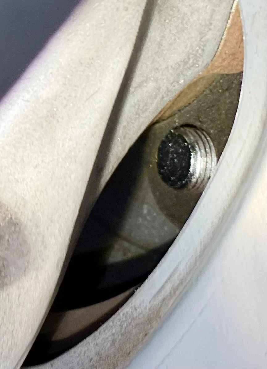

With recent discussions about lug bolts I wanted to share some data I gathered while upgrading mine.

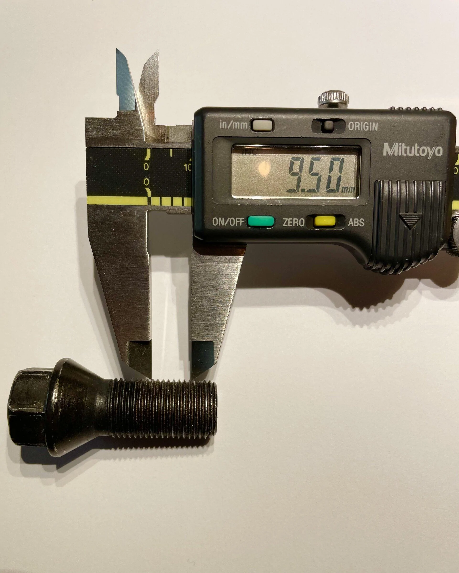

The factory hubs only have 8 threads of depth. This equals about 9.5mm or 3/8” engagement with the lug bolts, see pics below.
The HRE wheels I’m running have thicker mounting pads. Since I’m tuned I wanted a little more of a guard-band in case something went wrong.

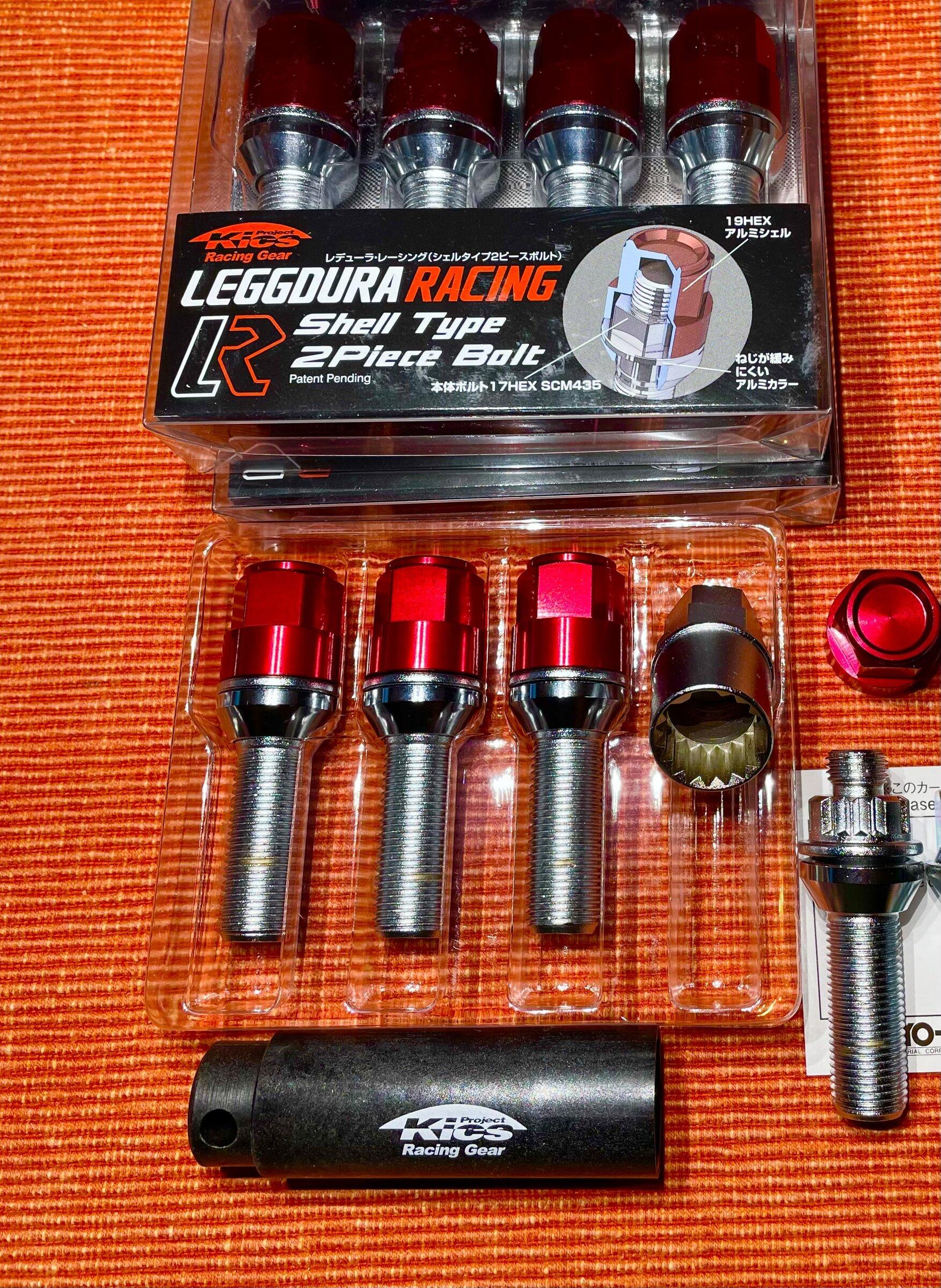

I decided to go with the Kics Leggdura 2-piece racing bolts. They’re made of SCM435 Forged Steel and feel solid when torqued to spec.
The bolts are extended versions (35mm) and give me the extra piece of mind I was looking for.
Here are some reference dimensions for people looking at getting longer lug bolts.
- Dimension from back of wheel to end of stock lug bolt (mounted) = 21mm
- Dimension from wheel hub surface to spindle mounting bolts = Front 34mm, Rear 32mm

The Kics lug bolts are working great. I’ve noticed less settling after installing them. When I re-torque them after 30 miles they don’t move at all.
The link you sent are the M14x1.5, be sure to order the M14x1.25. That’s the right thread size.
-RJM
