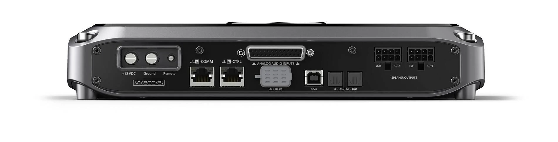

Please enlighten me, will the installer not be able to tap into the factory high levels?
Here's what is going in:
Focal T2 4" for the doors
Focal 6.5 components replacing the 8"s (replacing the rears and the 8s)
JL Audio VX800/8 DSP each speaker individually
RF T1000 powering 2 JL 12TW3s
The audio for the premium JBL system is supplied through the MOST interface. You will need a digital interface to accept the MOST signal and output an optical signal to go in to the JL amp.

damn system costing me more and more at every turn! So I assume this Helix is plug and play with the existing harness? I just don't know much about it I'm an old school car audio guy so even the DSP is new to me.
The input for the stock amp is provided by a MOST fiber connection. JL amps do not have a MOST connection so you need an interface that accepts that connection then converts it to an optical output that the JL amp accepts.
You will also need an aftermarket wire harness that will plug in to the OEM harness and the JL outputs.
Technic makes a nice one:
https://technicpnp.com/product/toyo...hardware-kit-for-most-converter-applications/
Or you could look at a Mobridge K2 that is plug and play.
https://mobridge.us/product/mobridge-most-amplifier-bmw-audi-mercedes/
My installer said they are not by-passing the factory amp going to use the high level outs with a step down converter into the JBL 8ch then there is a RCA pass-through from the JBL to the mono amp. Sound right?
Sorry I'm not sure how the process works with keeping the factory amp installed. I was always under the impression you want the cleanest signal possible going in to your aftermarket amp. Sounds like the installer is going to take the digital signal after it has been processed (now analog) for inputs to the JL amp. TBH if it was my car I would keep the signal digital the whole way to the JL amp, and remove the OEM amp. I just don't see a reason to keep the OEM amp unless you are just adding a sub amp only.

I’m not sure the VXI amps even have high level inputs. I definitely recommend changing the amp out for an interface for digital
analog inputs
