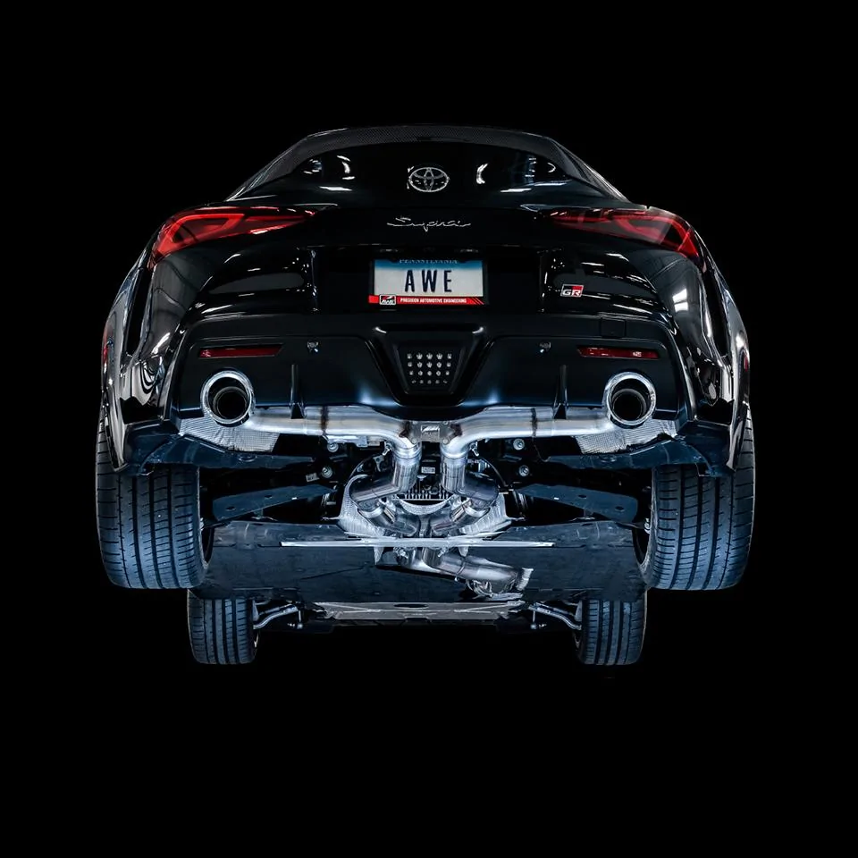

I would suggest changing your sound system to something like this and driving with the windows down. :D
Wow!! Haha I love it, what you have done to your car? Do you have that installed?
