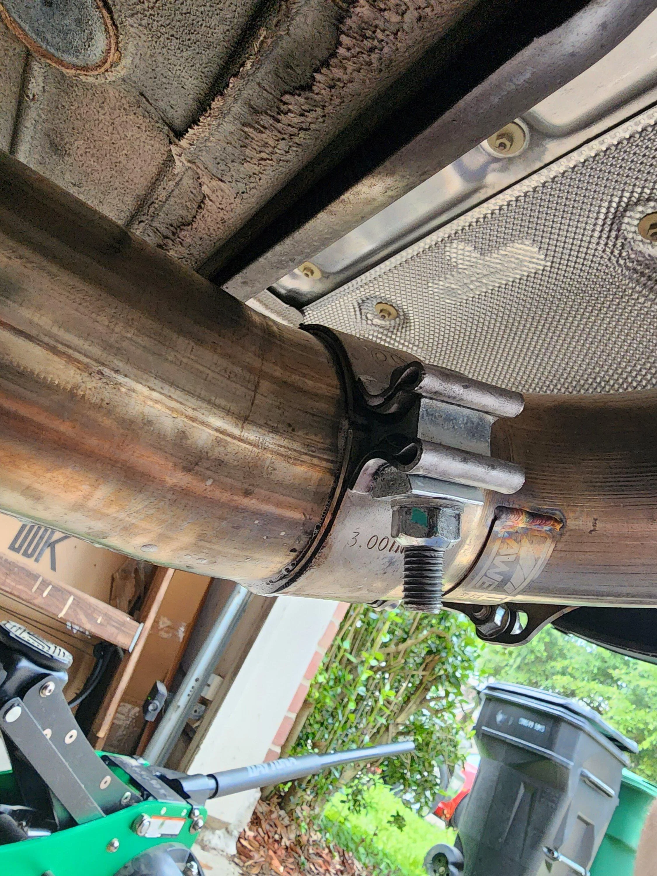

Seems like no matter how much I adjust the clamp, this thing leaks (soapy water test)..

Put a skin of High-Temp Red or Copper RTV on the male pipe before you slip the female end over it. Clamp, let cure, no more leaks!

Not always on this car (saw this on two other platforms), but sometimes the pipes just oval and don’t seal from AWE. You need a high temp RTV or take the pipe off and make sure it’s round.
