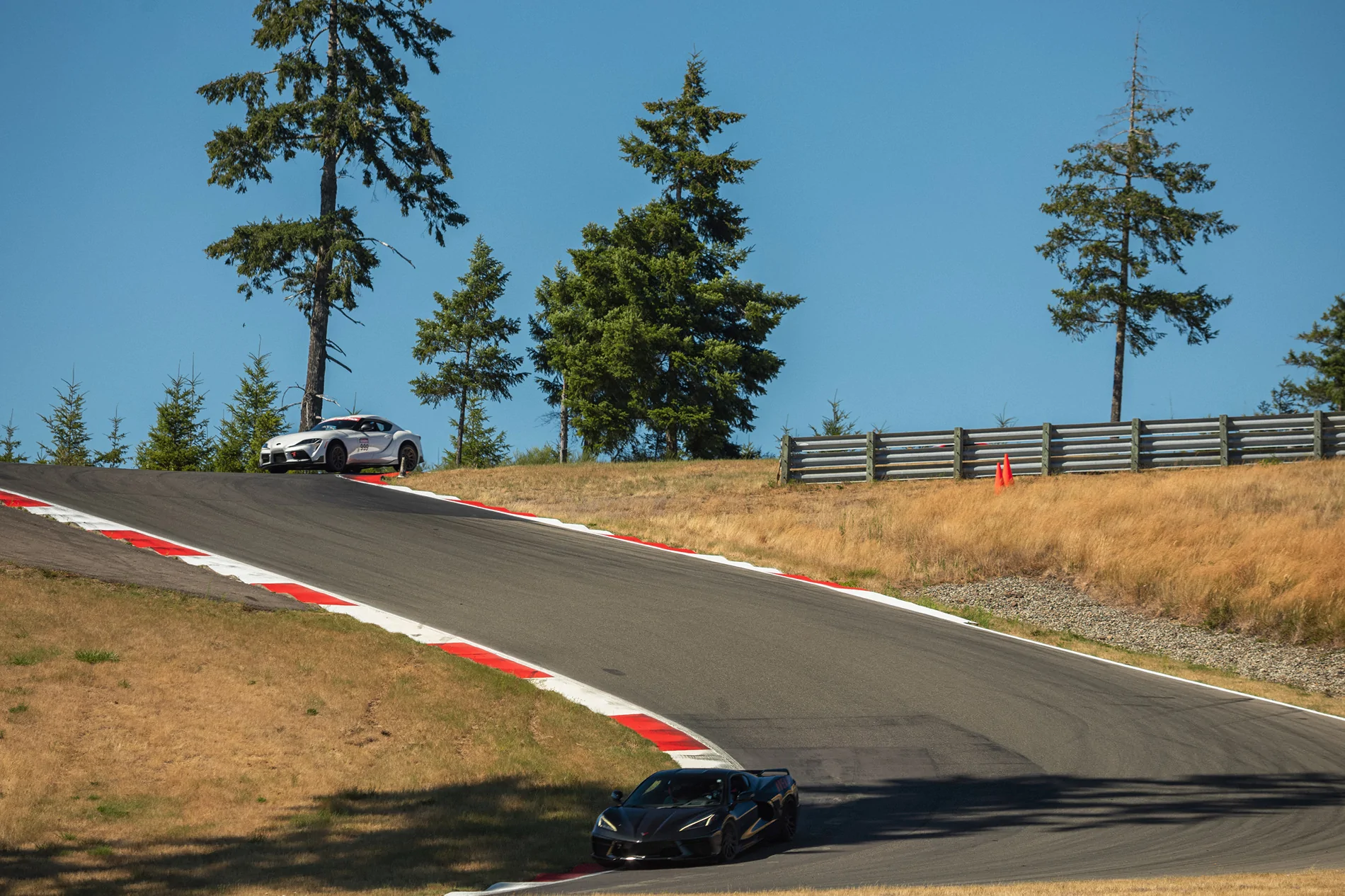

If ABS is engaged in a heavy braking zone followed by a hard left hand turn(picture for exact example(The Ridge Motorsport Park) the car falls into a limp mode. It accelerates extremely slowly under wide open throttle. The work around is to upshift and downshift quickly.

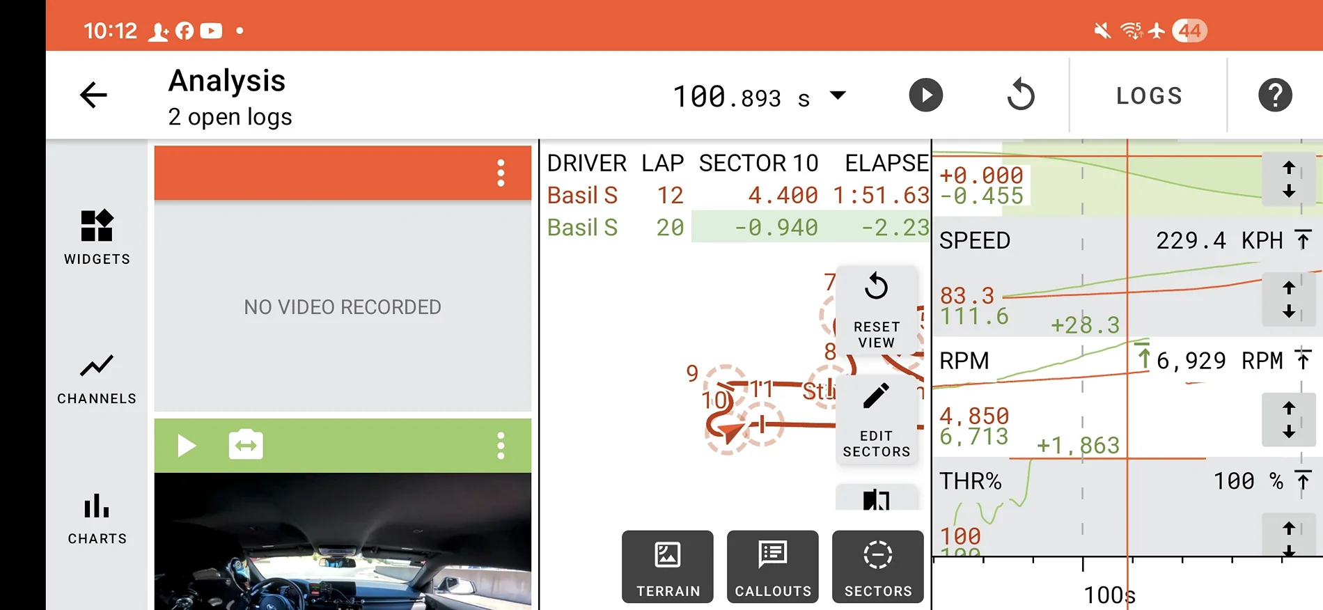

I'm using Circuit Storm/Solo Storm which is pulling the CAN data. I overlayed a log. you can see the demand is for 100% Throttle but the RPM climbing slowly, Speed not climbing and the delta falling fast.(Green is fastest lap)
Is that pedal or throttle? Pedal would be the request and throttle would be the actual throttle plate. Did you get the CAN info from my spreadsheet?
I found your spreadsheet and sent it to the developer for confirmation. I believe its likely pedal.
