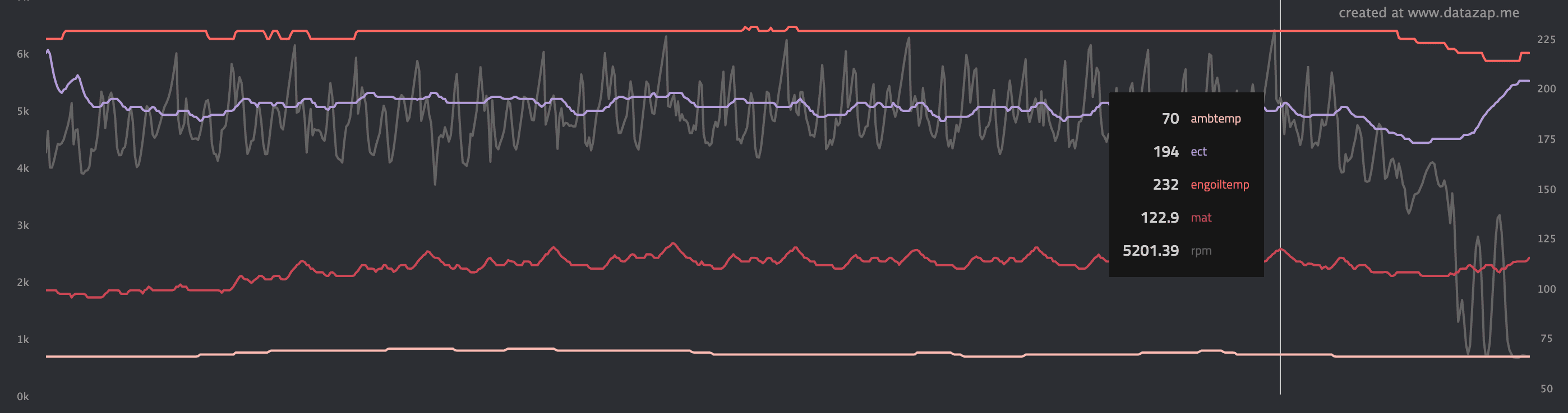

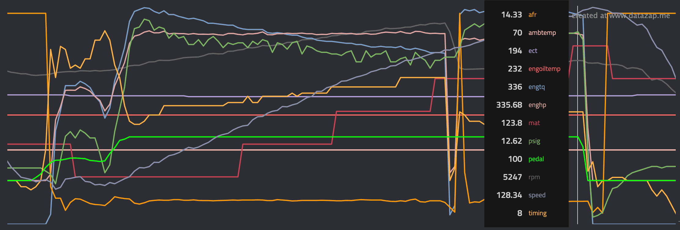

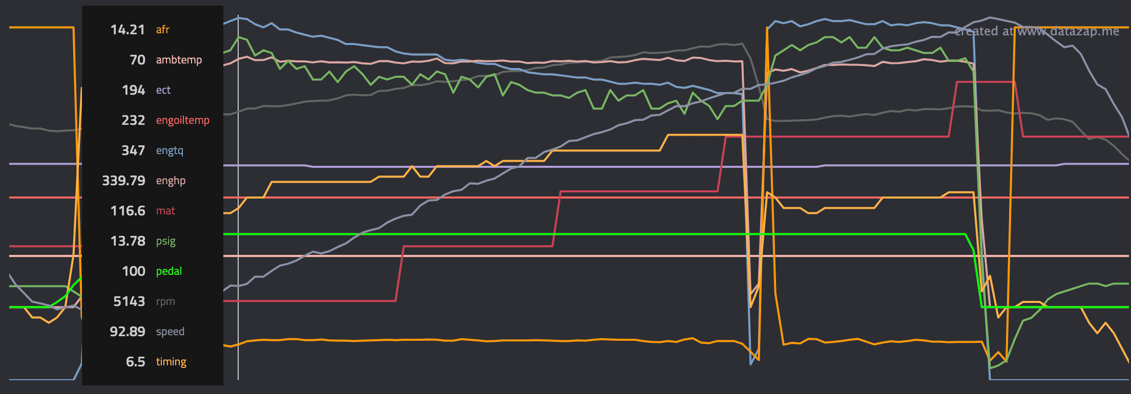

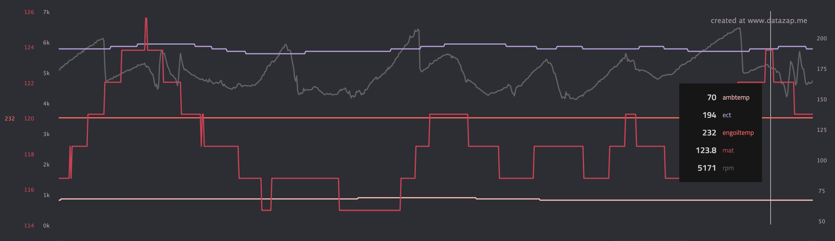

Now that I finally have datalogging in the car, here is some data for my intake temps. I drive in advanced class and usually in the top 5 faster street cars lap time wise.
2020MY
Stock Tune
100% stock power hardware down to the paper air filter
9 laps total in this log
Approx 70-74* ambient this session
Full log for people interested in poking around
Full session zoomed out, notice the IAT recovers really well, up and down:

Final Lap, zoomed out:
Final straight, Final Lap, beginning WOT:
Final straight, Final Lap, ending WOT:
