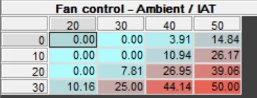

Mods that made the biggest difference in cooling:
Intake manifold
Hood vent
Everything else just added to the whole
Another fun fact, our fan never operates at 100%, or even near it, with OEM tuning.
Intake manifold
Hood vent
