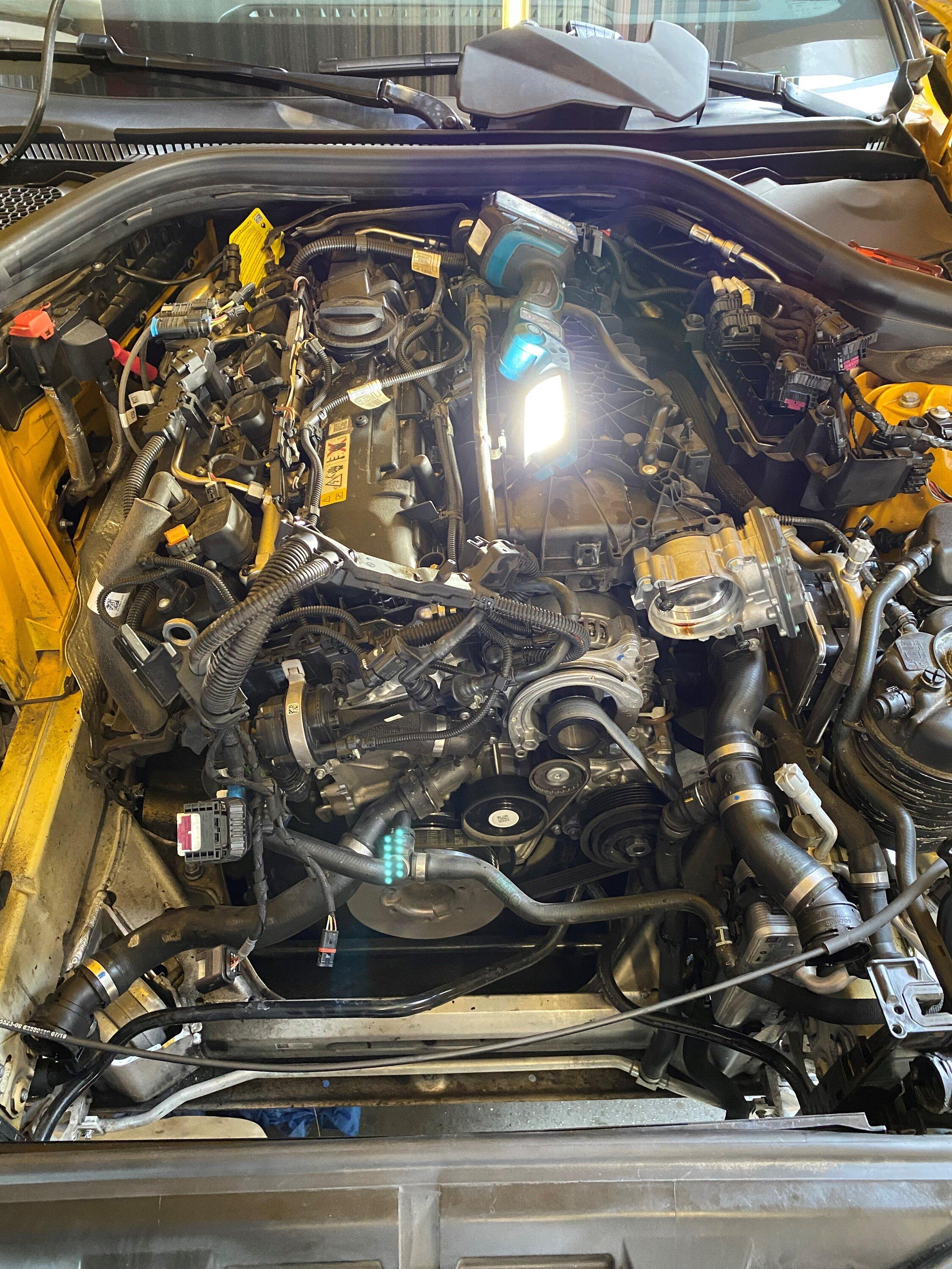

Thanks everyone for the info. The shop is convinced this was a defective turbine. They have it all hooked up with the new turbo and verified the coolant flows properly.
I'll setup an app to monitor temps and I'm going to dial the tune down to 80% for the next event. Once I know whether I'm keeping this car or switching to the manual, I'll invest in some better cooling. Thanks!

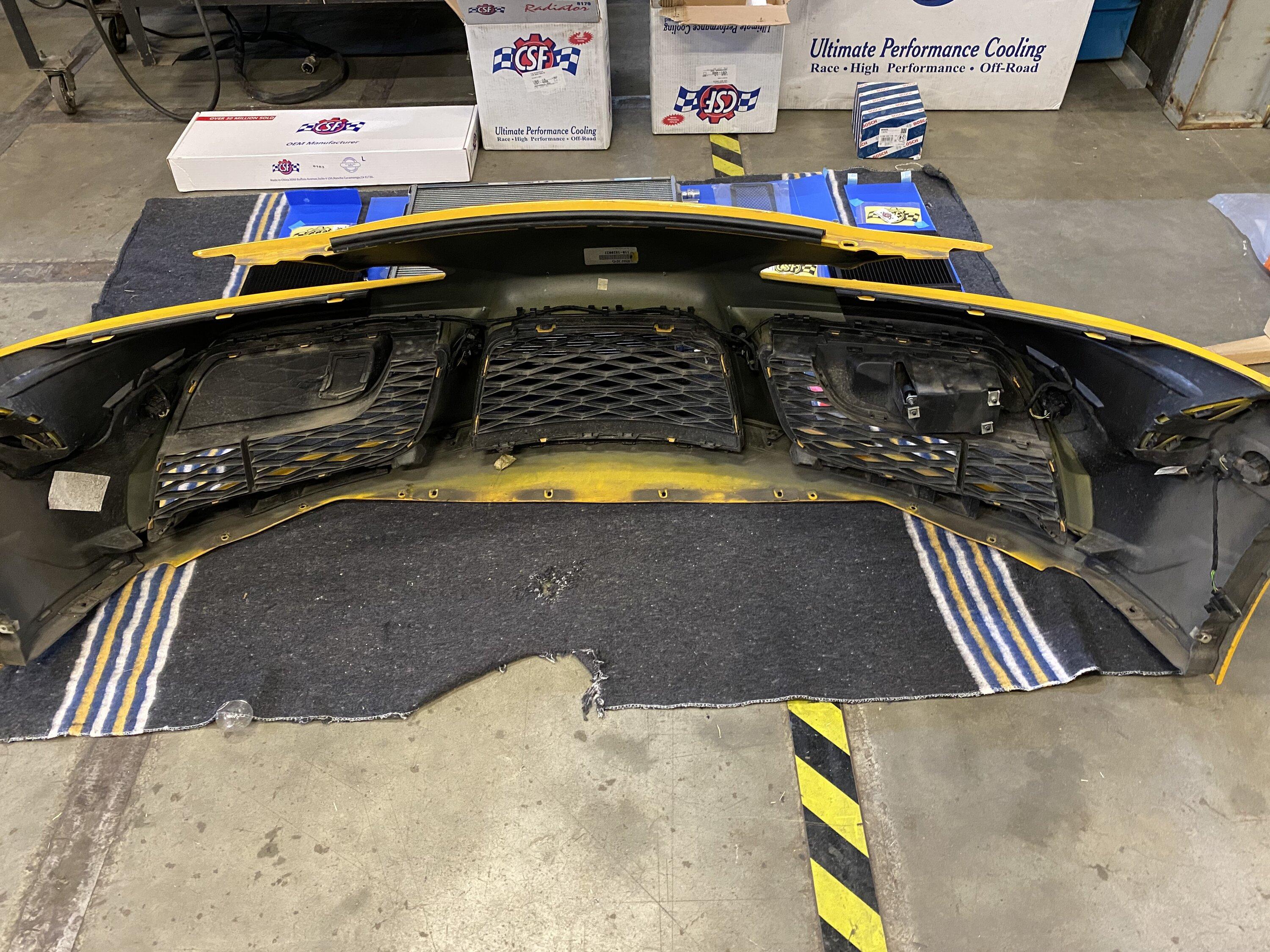

Last weekend, by removing the front bumper and all radiators, we figured everything out:
So I am going to list it up here, which may provide other people as well with useful information.

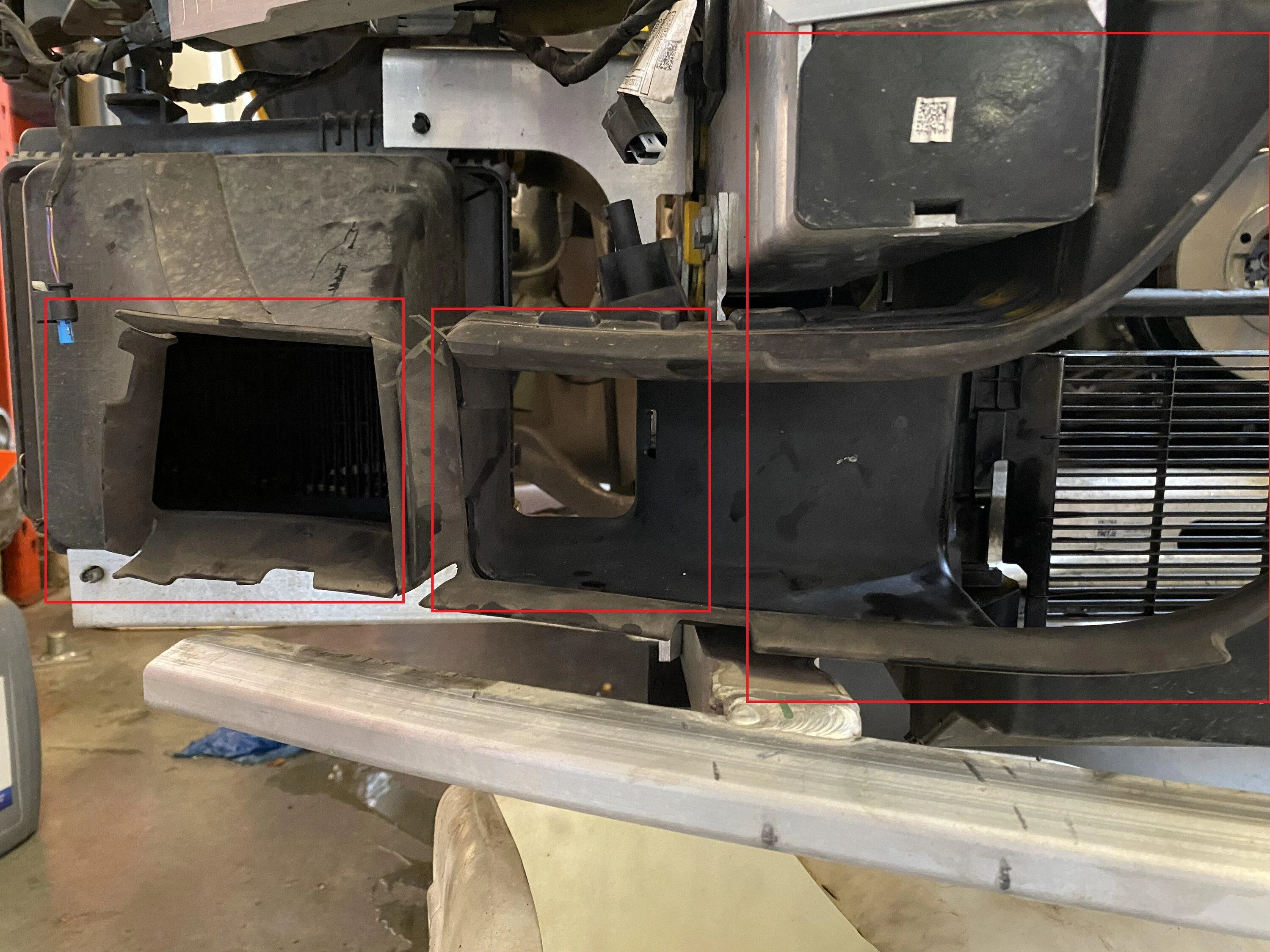

In our front bumper, we have '3 main hole section' when standing in front of the car.
  • Left
  • Center
  • Right

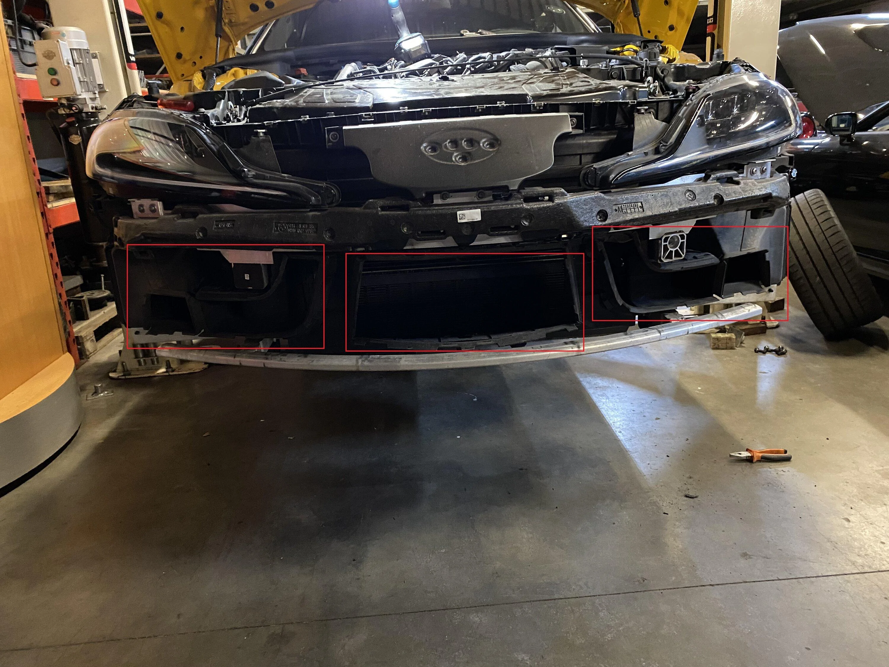

Below a picture of the bumper, when its detached, where you can clearly see these sections:
When looking at it from the front of the car (sorry, picture is a little bit dark):
The left and right main sections, are actually divided in lets say '3 sub-sections':
  • The outer section, is used for airflow towards the air-to-water radiator
  • The center section, is used for airflow towards the brake rotors
  • The inner section, is used for airflow towards the components that sit behind the main center section
You can see it clearly in this picture:

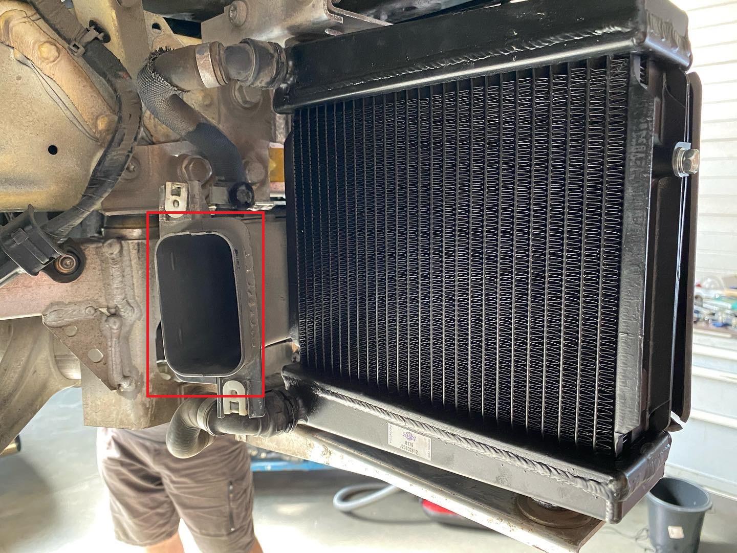

When looking from it on the other side, you notice the small radiator and the part that lets the air flow to the brake rotor:

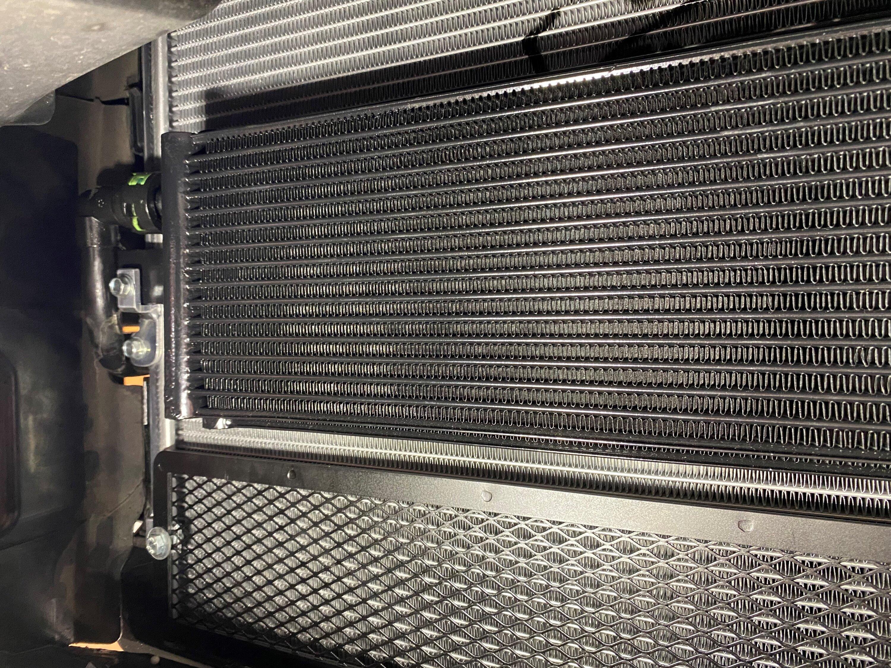

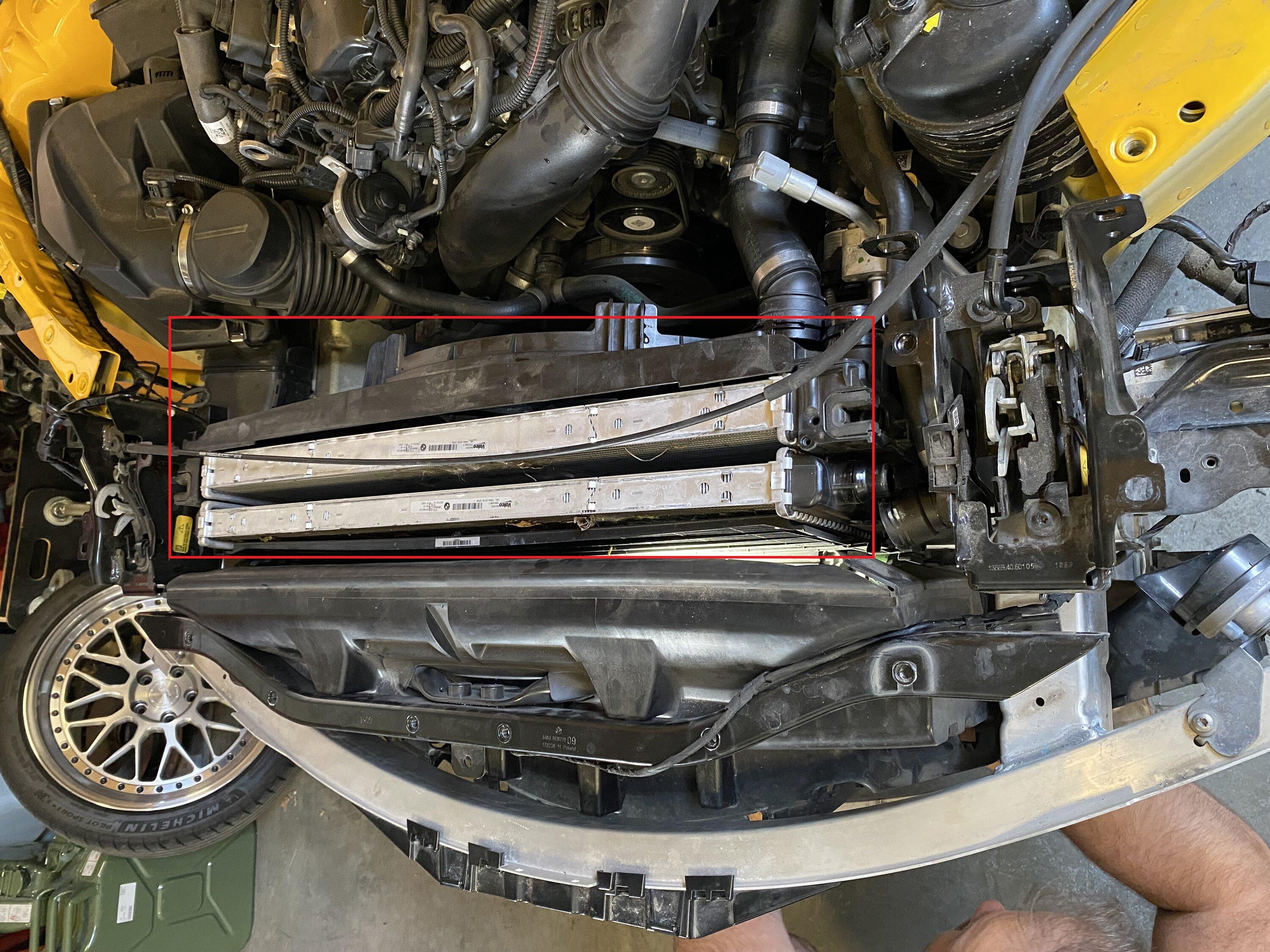

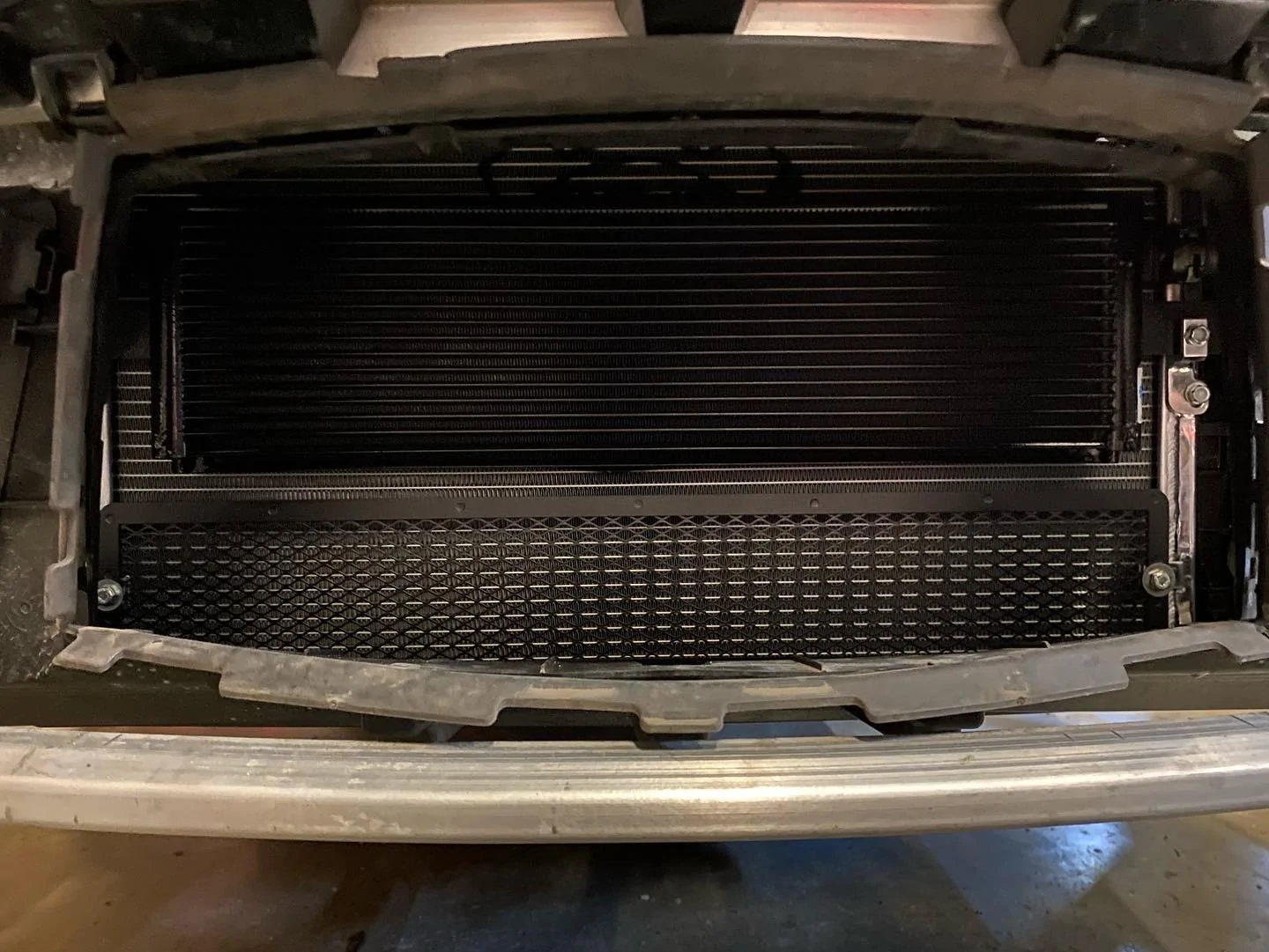

Now back to our main section again... in the main center section, we have 3 coolers present. The are in the following order when looking at them from the front:
  • First, we have the transmission cooler
  • Second, we have the heat exchanger
  • Third, we have our engine main radiator
  • And behind the engine main radiator, sits our engine fan
On the pictures below, you see in black... the CSF transmission cooler and behind it the CSF heat exchanger:

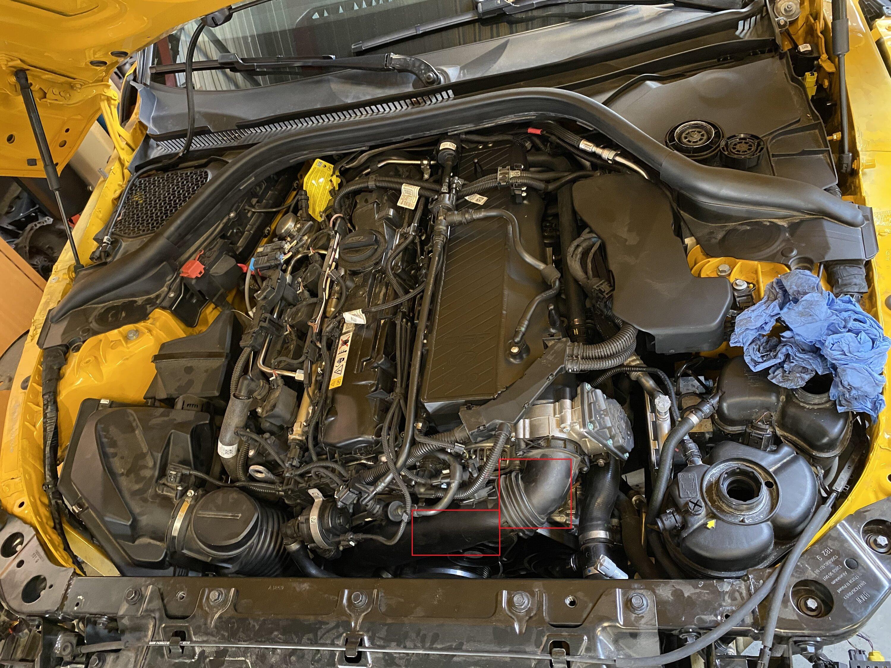

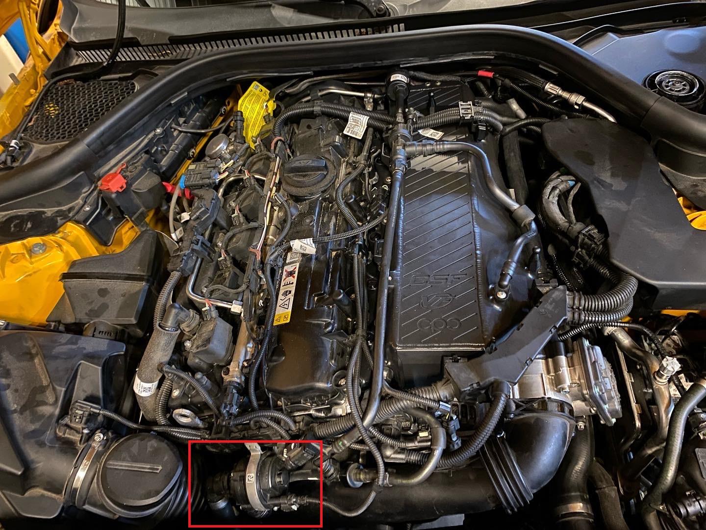

When looking from the engine bay's top perspective (standard oem stuff), you notice the heat exchanger, the engine radiator and the engine cooling fan:
Ok, so now that we know how our front bumper is dividing the airflow towards the several (sub)-sections, we can list up what each component is doing
Starting with the main center section, we have the following:
  • The transmission cooler, is off course cooling our automatic transmission
  • The main engine radiator, is there cool the water which flows through our engine (keeping the engine itself cool)

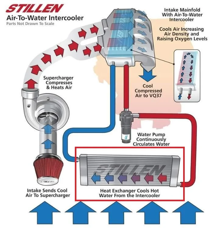

  • The heat exchanger has actually two purposes:
    • Its main purpose is to cool the water coming from our intake manifold (it has the integrated chargeair-to-water cooled intercooler)
    • Its side purpose is to also keep the water cool, used in our AC (AirConditioning) unit. Yes that's right, the heat exchanger also makes sure... that we have cold air in our car :)

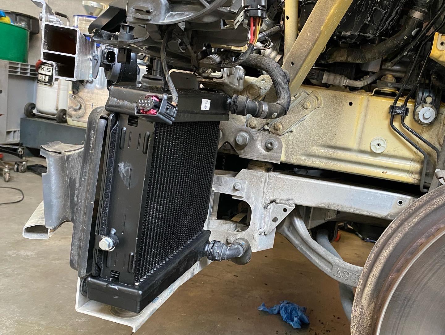

On our right section (when standing in front of the car), we have the following:
  • The small radiator, which cools the water towards our turbo
And finally on the left section (when standing in front of the car), we have the following:
  • The small radiator, which serves as the auxiliary engine radiator. Yes it assists the main engine raditor, to cool the water which flows through our engine

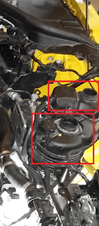

We have two water circuits on our Supra (so we also have two expansions)
  • The small circuit is used for the water of the heat exchanger
  • The big circuit is used for the water for all the other radiators
On the picture below, the top one is the filler for the smaller circuit, the bottom one is the filler for the big circuit:
As extra information:
  • The big filler has a sensor inside, to check for 'low coolant level'. To prevent that the engine would not cool in case of low coolant
  • The small filler does not have a sensor. The ECU just relies on the IAT temperatures and adjust timings (when you have low coolant in that circuit, there will be no alert triggered on the screen in your car)

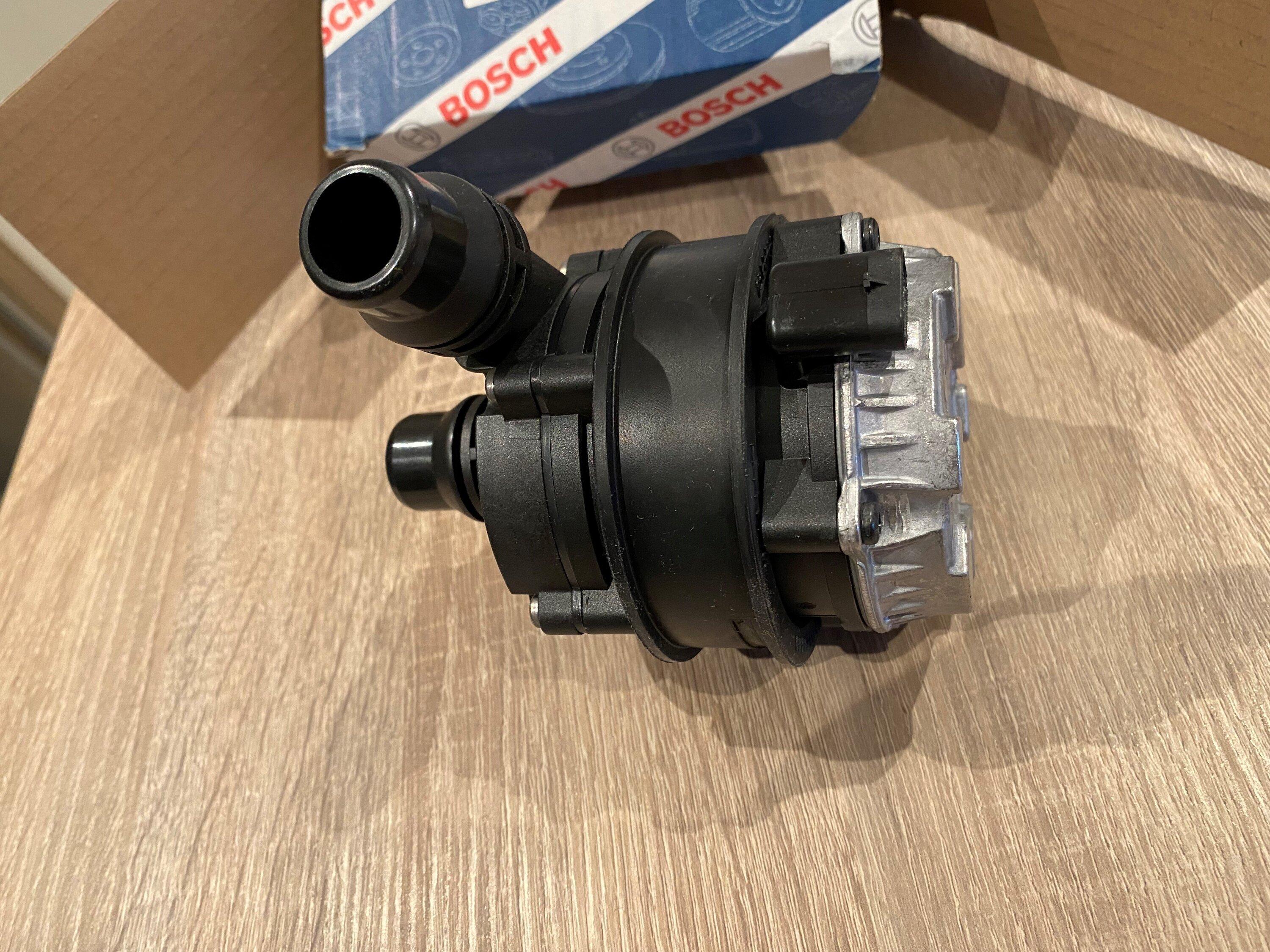

To keep the water flowing, we have 3 water pumps on our Supra:
  • A mechanical one, which flows the water for cooling the engine
  • An electric water pump, which flows the water for our turbo (right side radiator when standing in front of the car)

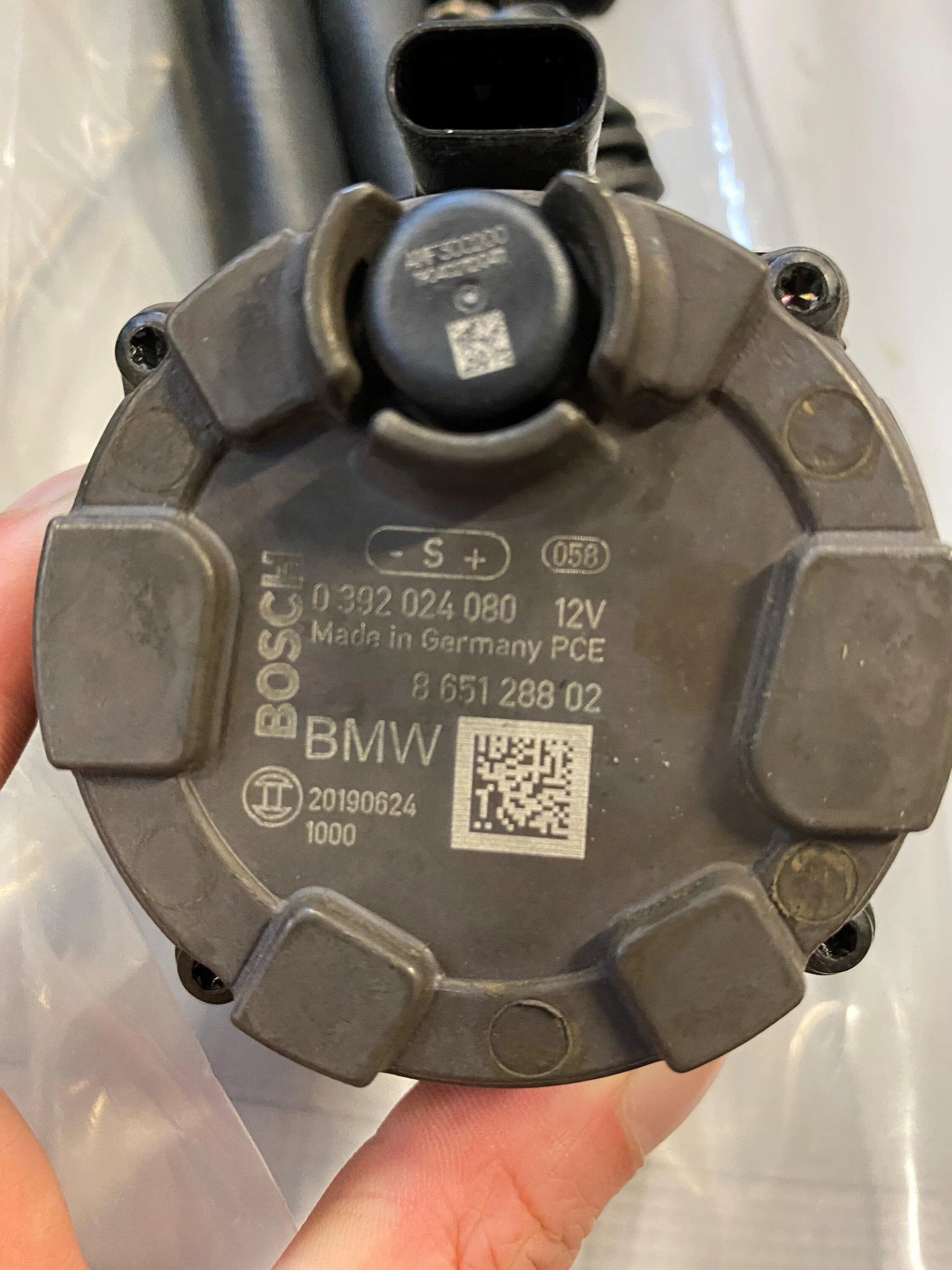

  • An electric water pump, which flows the water for our intake manifold (heat exchanger). Also referred to as the EWP CharegeAir in the logs
For reference, the ChargeAir Electric WaterPump looks like this (I upgraded mine for a higher flowing one, for testing purposes):
Hope it clarifies a little bit our entire cooling system on the Supra, as it did for me :)

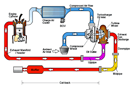

Just for information for the community:
  • The turbine is the HOT side of your turbo (the one where your exhaust gasses spin the turbine wheel)
  • The compressor is the COLD side of your turbo (the one where your intake air gets compressed, which afterwards is referred to as charge air)
So in a normal functioning turbo, the compressor side never gets hot.
But if your turbine side or compressor side failed, it can be due to the HOT side of the turbo, running to hot, or transferring its heat to the compressor side:
  • On the compressor side, this can for example be due to not properly cooling down your car/engine after a session, in case your cooling system works fine
    • Keep in mind that normally, you perform a few cooldown laps on the track.
A link of Garret explaining why turbo's are water cooled:
So one of the things indeed to check (and apparently it has been verified by the shop), is the flowant of the coolant.
So why did his turbo fail... maybe not enough cooldown laps or shutting down the car to soon after the session. I mean, at this point it is guessing :)

As you know by now through the explanation, both the intercooler and heat exchanger, work in tandem. You can't exclude one from another... they work together.
So fitting a big ass intake manifold, will result in a bigger surface to cool the charge air. However if the heat exchanger is not up to the task to also cool down the coolant water of that intercooler... over time, the system will start heat soaking.
The same applies to the heat exchanger. You can fit as huge heat eschanger to keep the temperature of the coolant water of the intercooler as low as possible, if the intercooler does not have to surface volume to dispeat that heat of the charge air... over time the system will start heat soaking.
Again, both are required. Which one do you require to upgrade first... it will depend on what you do with the car and under which conditions. In my personal opinion, I would first upgrade the heat exchanger, when you daily your car or take it for a 'spiritual driving'.
