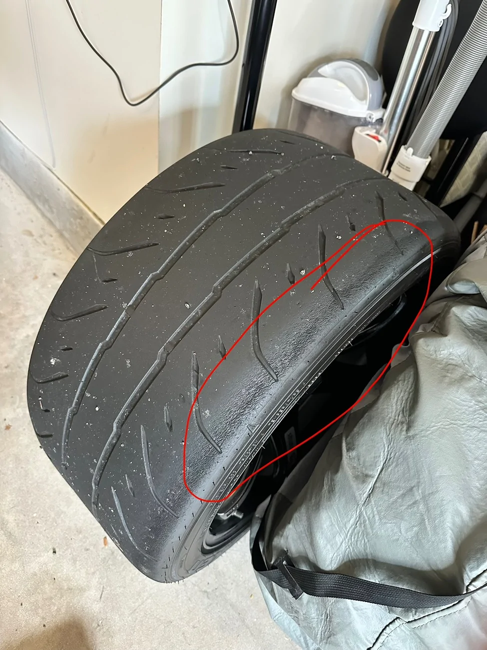

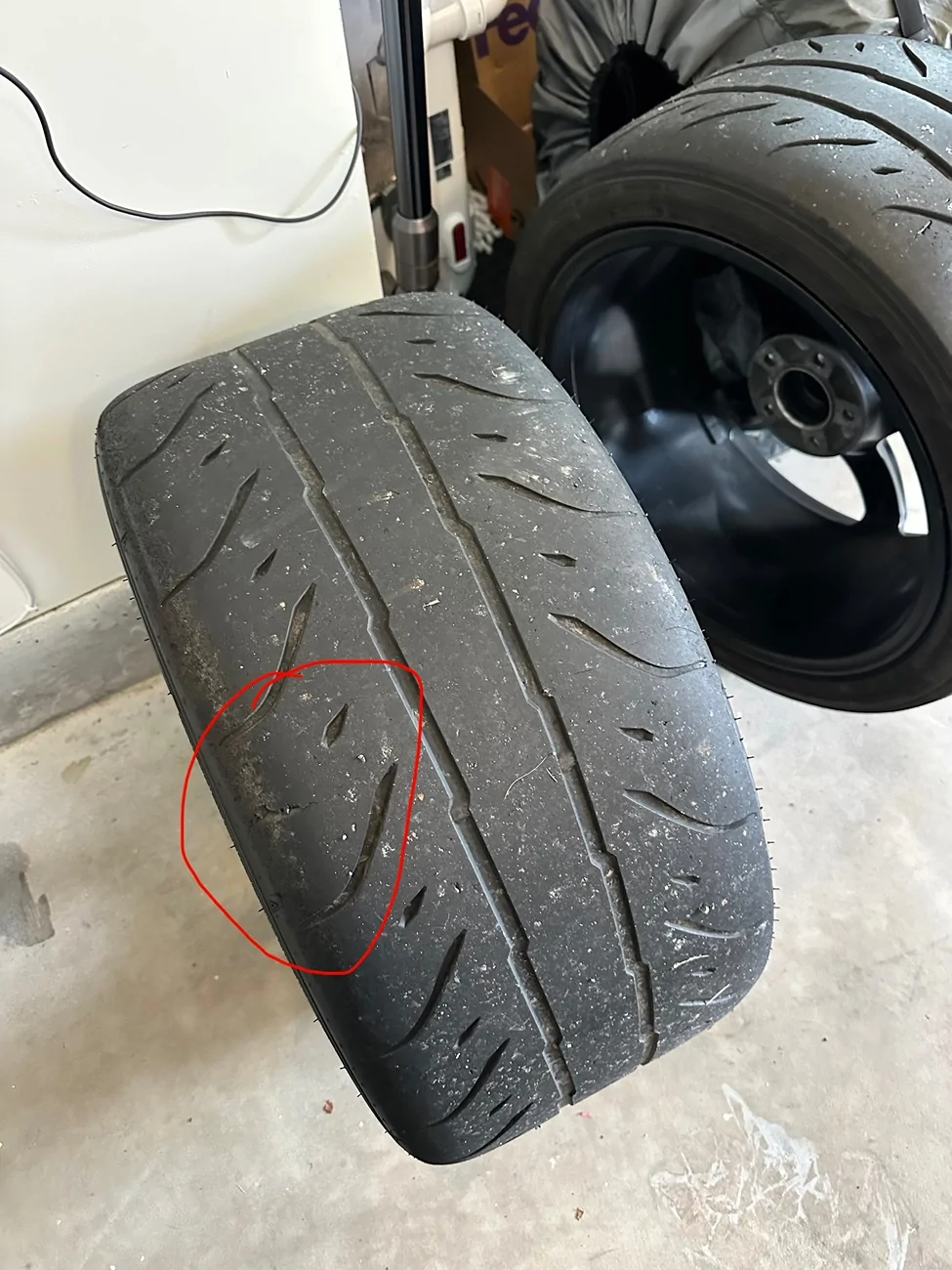

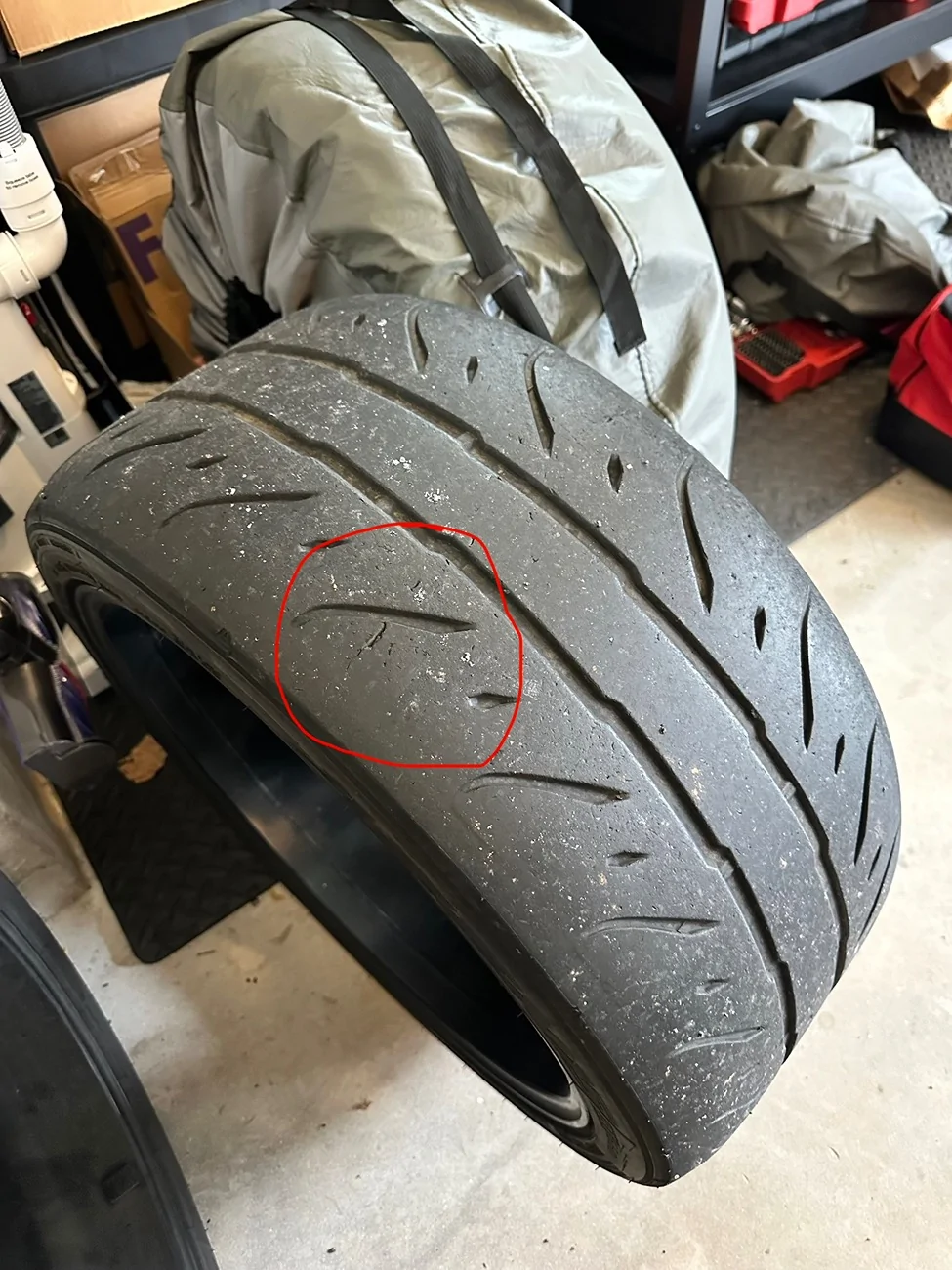

Are these tires cooked or could I juice out another session?

OP please take no offense. Based upon the information that you provided in your post, it appears that you are not seeking the fastest lap times but are working on your basic track skills. If you still have sufficient grip to be safe on track, then your tires can provide you more laps. If your tires lack sufficient grip to be safe, get new tires.
I would like to go faster as I think I'm getting better at the track but will give these a go for an event and then decide from them. I'll use one of the tracks I normally go to as a benchmark.

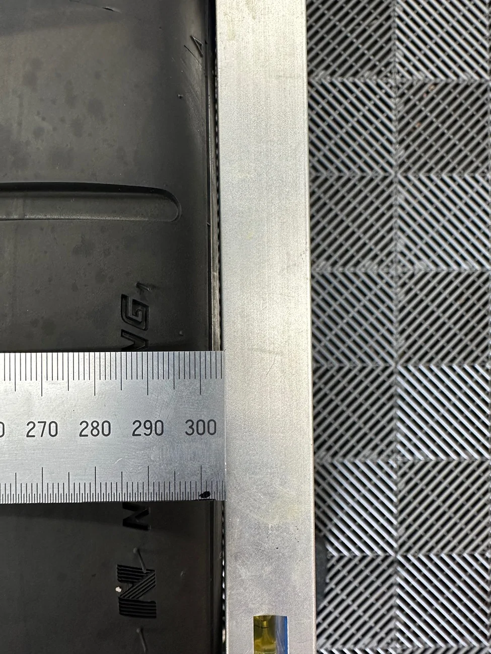

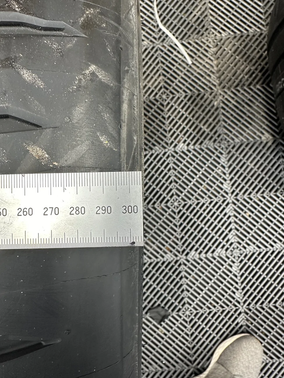

CRS and RE71RS are the same , I’ve measured both. At least in 295/35/18.
Now I'm curious about other sizes because I was fairly sure about that.

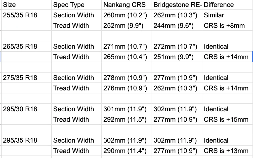

This is what i could find online. Grain of salt and all that
