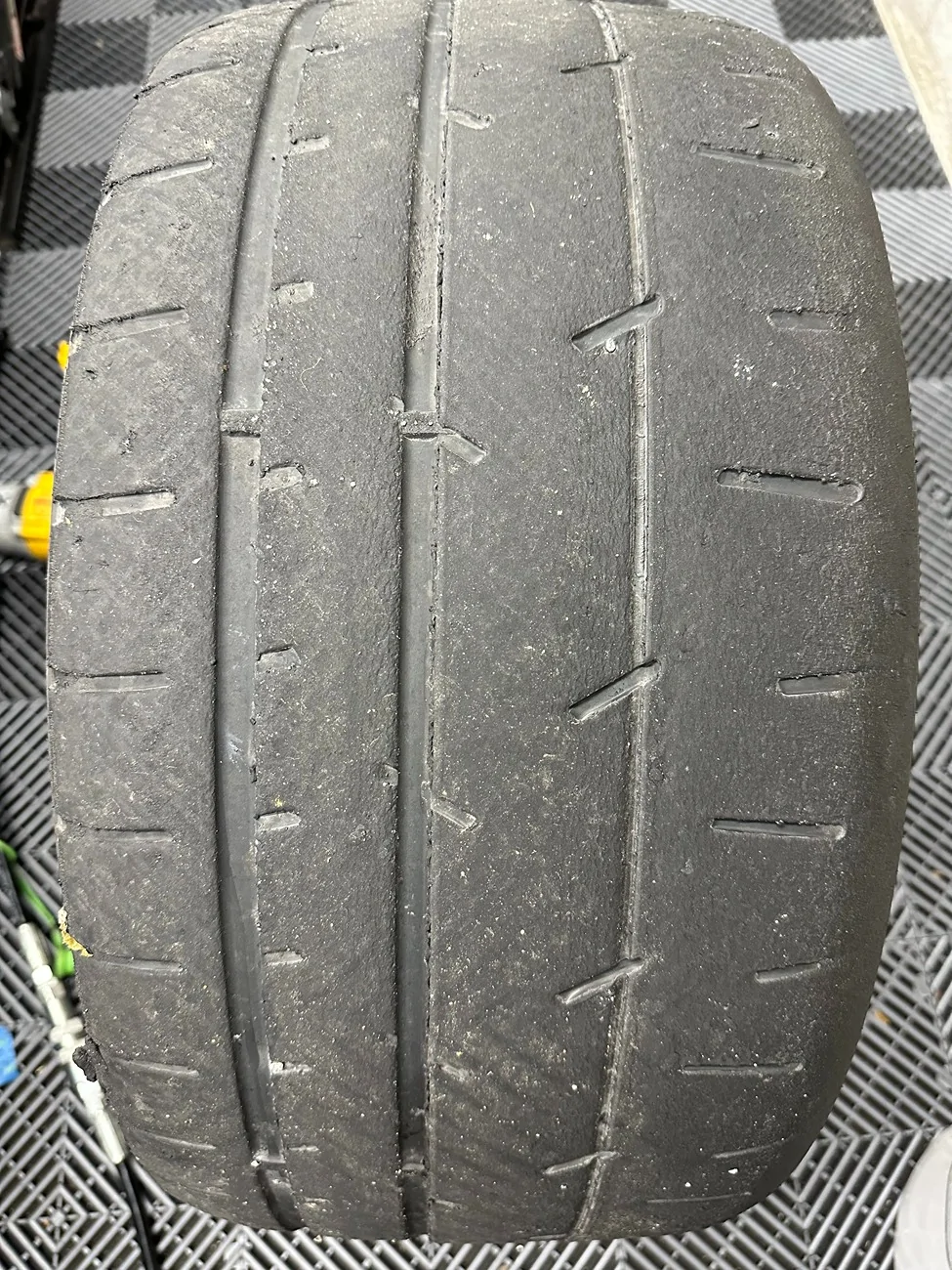

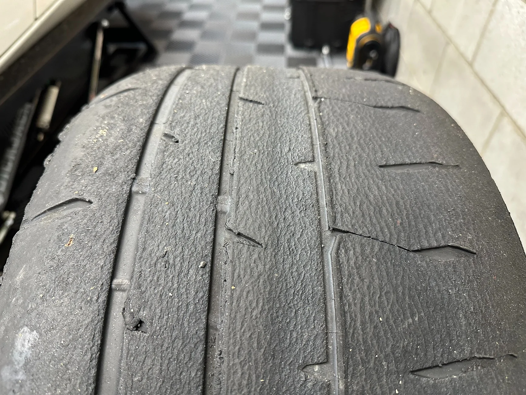

Are these tires cooked or could I juice out another session?

But, to put it back to the original question, the RT660 heat cycles out before other tires do. The tires in this thread are cycled out, and while they can be used, I would not if you're chasing lap times. Yes, any 200tw can cycle out before the tread is gone, and it's definable in the data. Not all cycle out, and it is car specific. There are lots of good details in various sources showing that heat cycle life, along with personal experience, doesn't always line up. I've had multiple sets of tires good to the cords in 71RS and A052. YMMV, but the general consensus in the motorsports world I live in has the 71RS/A052/CRS rarely cycling out before simply wearing out.

The general consensus in the motorsports world I live in has the 71RS/A052/CRS rarely cycling out before simply wearing out.
I'm sorry, this is simply not true. Every single driver in the supra track discord would say the same. Every single TA record setting supra driver would say the same. If what you state was true, there would be no reason for people trying to set TA track records to throw stickers on every time. It would save everyone a ton of money too. The thing is, it's not true.
If 71RS/A052/CRS are fast to the cords for somebody, they aren't driving them fast enough.
If someone runs a set of CRS and they don't try to kill the driver at some point from their heat cycled out candy shell, they aren't driving them hard/fast enough.
RE71RS just get slower, but don't turn into widow makers.
Speaking confidently from my own experiences as well, I've been though multiple sets of 71RS and CRS, and am at the pointy end of lap times at local tracks.

You're going about the logic the wrong way in the section I bolded. The reason they're fast to the cords is they're wearing out the tire before it can heat cycle out. One of these tires heat cycling out (generally) means you're not driving them either hard enough, or long enough in a given heat cycle. Putting a bunch of short but extreme heat cycles on them like a true TA car will generally run them through the usual 8-10 cycles a tire gets before using all the tread. A funded, or running for actual contingency/money/wins car that lives on the ragged edge for 1 out lap, 1 flier, and 1 in lap will be better served with fresh tires before a weekend since they'll be putting 8-10 cycles on over 2-3 days.
The average track day, or grassroots TA driver that stays out for the whole 20 minute session is more likely to actually wear out the tire before it cycles out because they're doing 7-10 laps in a session. Even at the events where I'm running TA I'll treat it like a 20 minute session after the first 1-3 laps when the tires start heat soaking. No reason to waste the heat cycle by coming in and trying to cool off when I'm a privateer and it's a plastic trophy on the line.
Regarding the CRS, I haven't run a set of those to the cords. I didn't like the V1 and never tried the V2 so I've pretty much stuck with the 71R/71RS/A052 for track since then.

Here are two examples of my "backwards logic" tires that have dropped at least 1-2 seconds in pace on a 1.5 mile track. Both far from the cords.
