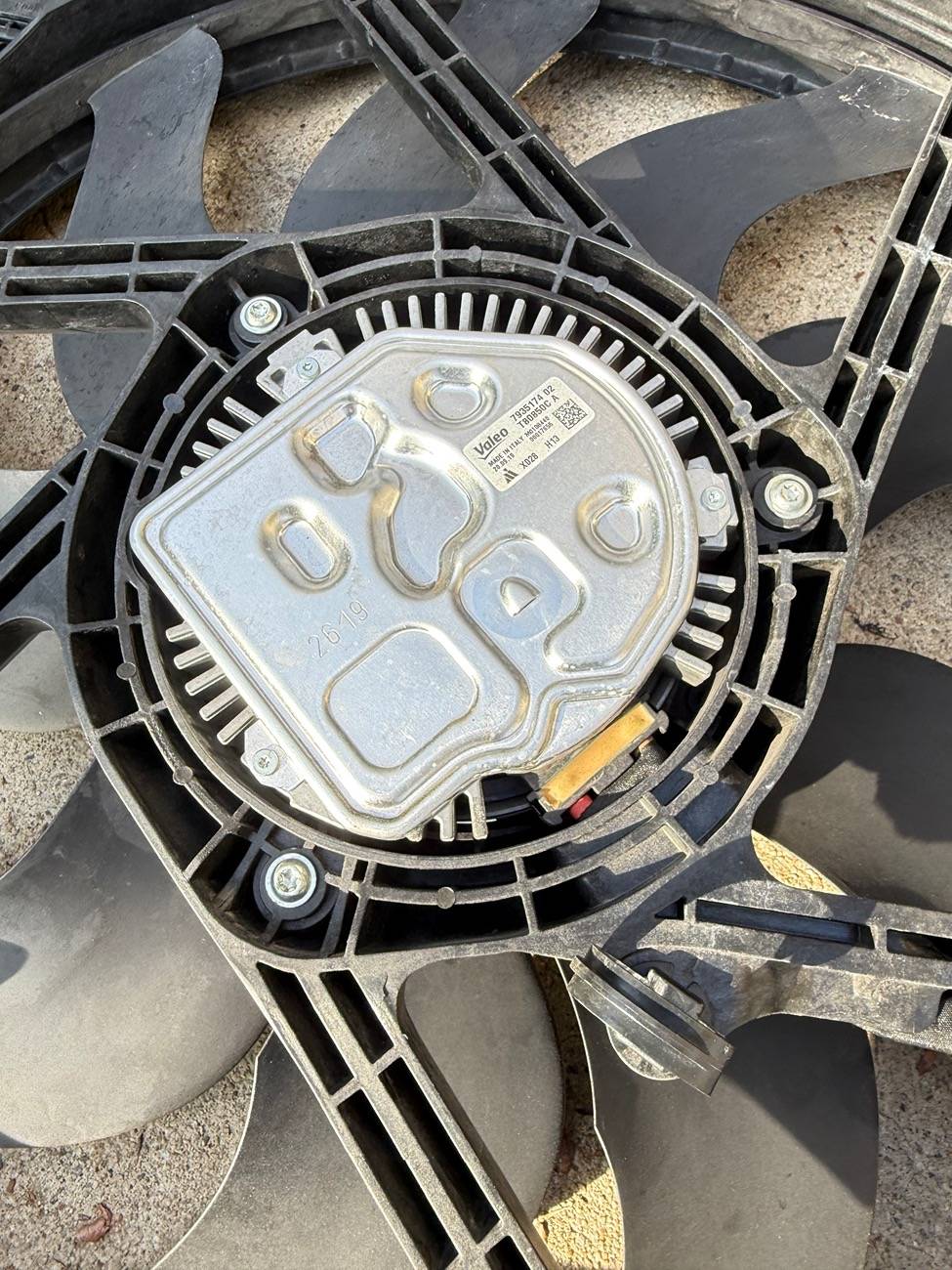

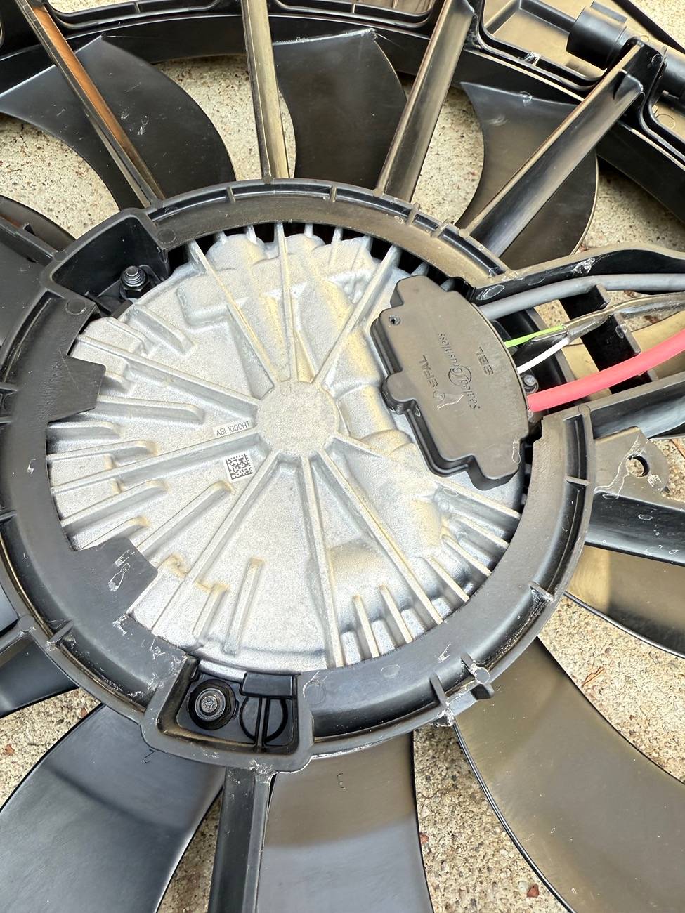

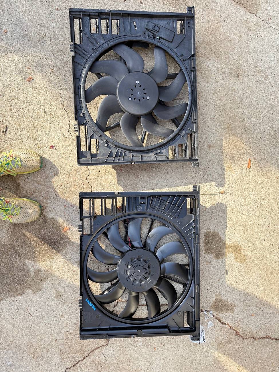

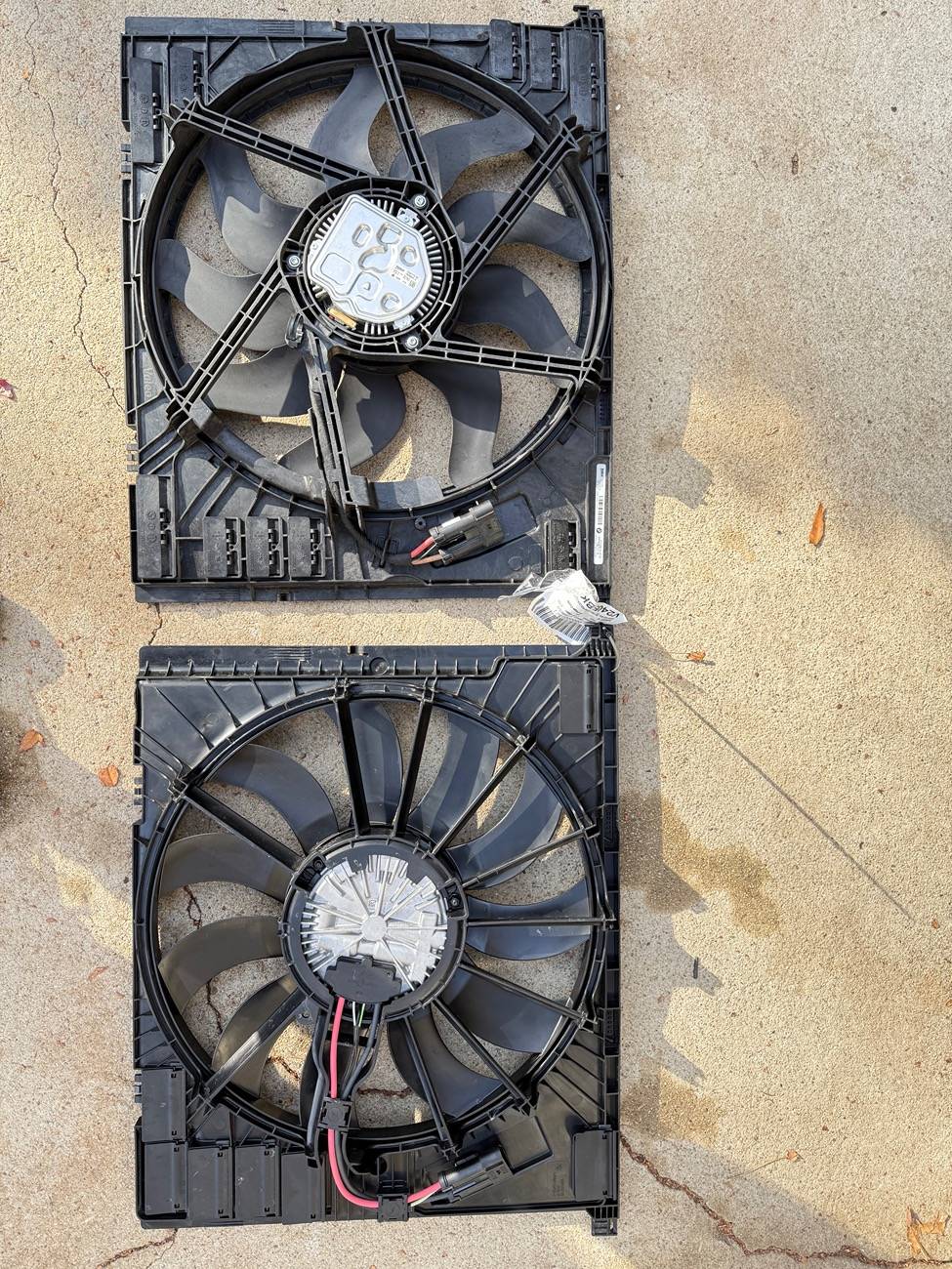

Pretty straight forward swap, although quite a bit of stuff needs to be removed to get access. Just had to swap over the clip on the fan shroud that holds the transmission cooler line.
differences seem to be:
- blade design (as already mentioned)
- shroud housing
- different # shroud flaps and location
- heatsink and motor
Minor bonus, fan is quieter. Haven’t looked at the rotation of the fan, but it looks like the blades are inverse. Putting my hand in front of the grille still feels like the air is still being pulled in and not pushed.
