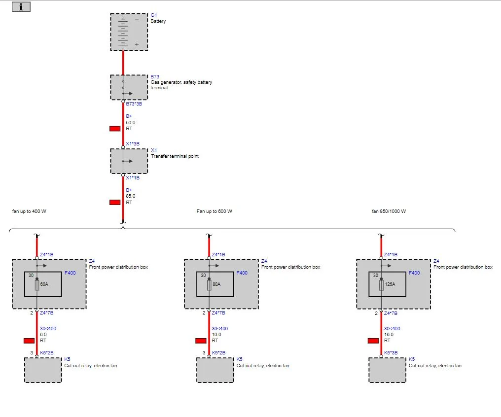

Another cooling mod to mention is upgrading to the G series M 1000w radiator fan. Our Supra one is 800w and a different blade design.
The M series 1000w fan is what they use on the Supra GT4. BMW also uses it on the M240i/M340i/M440i with the cooling package.
It's a drop-in mod and helps the whole front cooling stack (radiator, heat exchanger and trans cooler). The negative is it's $1100 or so new. You can try and find used ones off wrecked cars on ebay and get them for about half the price.
Will the fuse on this circuit need to be upgraded given the larger power consumption? when given.
Z4m40i
Justin
Nov 30, 2023
161
180
Salt Lake City
2020 BMW z4 m40i, 2020 BMW X7 40i
just wanted to follow up in this since I just ordered a radiator fan.
You shouldn't have to change anything else out since the 850watt fan found in our cars shares the same exact wiring, fuse amp, and cut out relay as the 1000watt fan.
Thank you.
