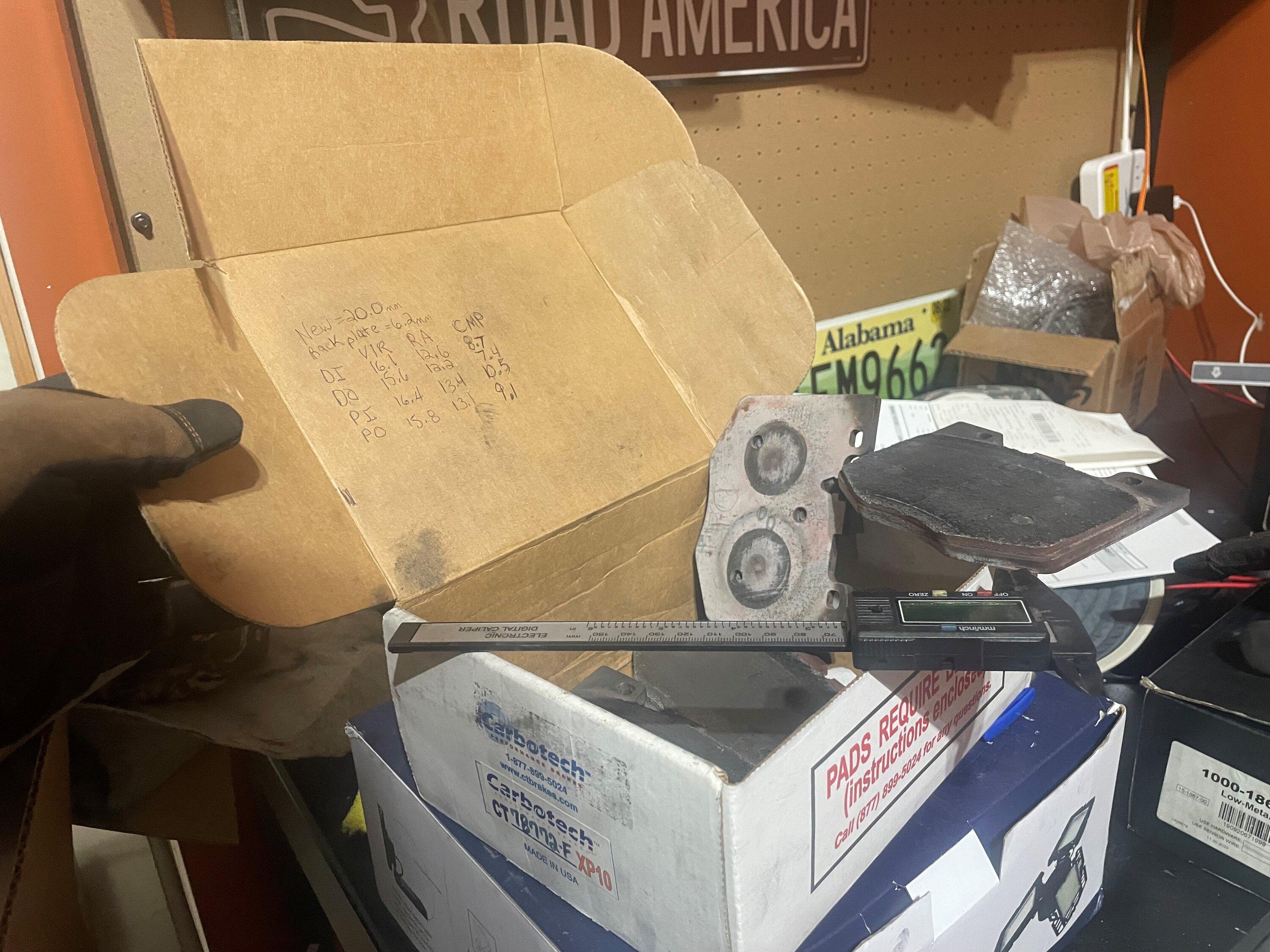

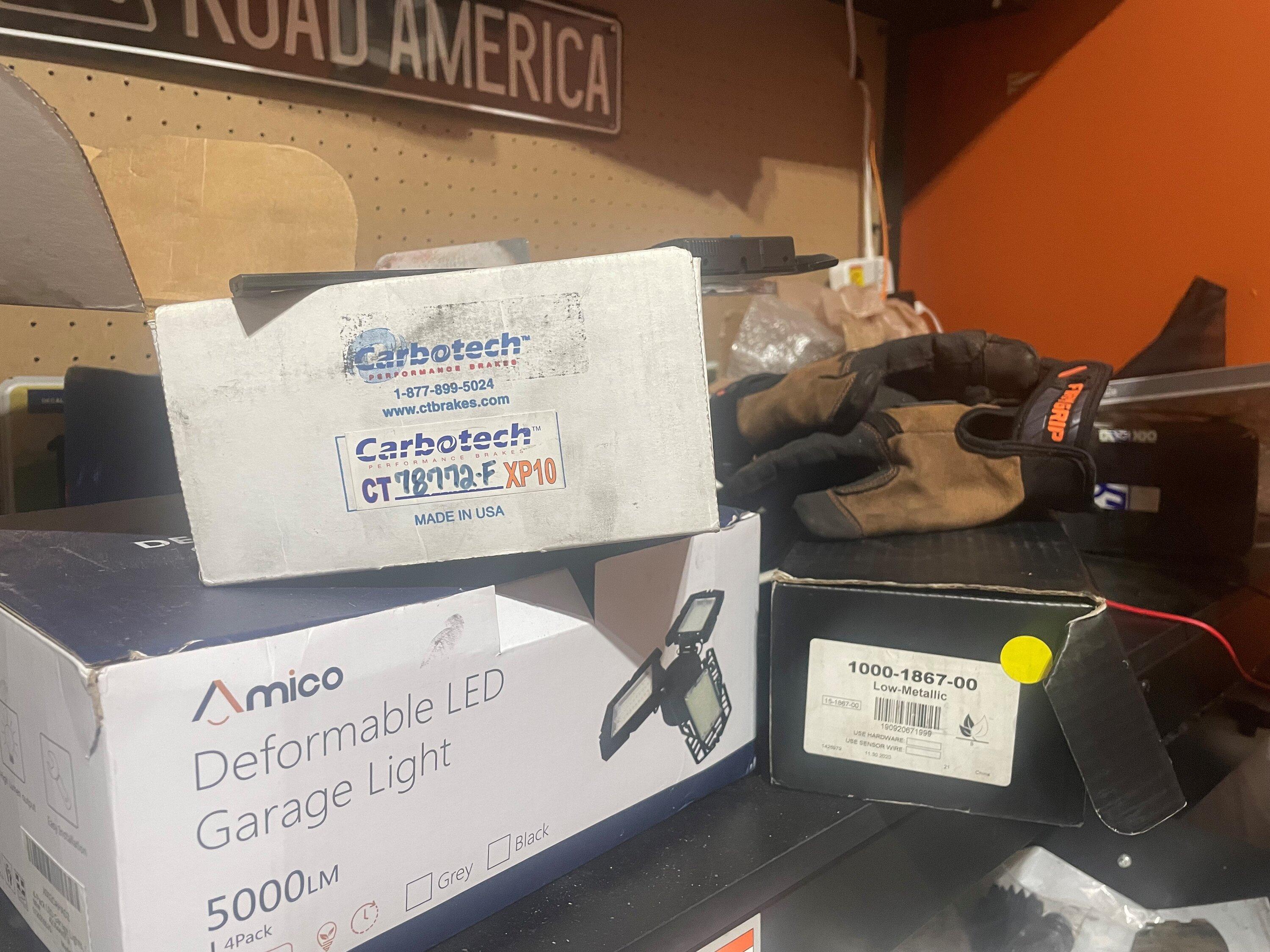

I have run several pads but have not found any to last more than four-track days. I am willing to pay more if I could find an endurance pad with good stopping power. I always track the wear on the pads after every event and mark the box with the results. Below are the pads that I ran this past weekend. The Carbotechs I only had on the car Saturday and the DFC's on Sunday.
The Carbotech XP10's last four-track days.

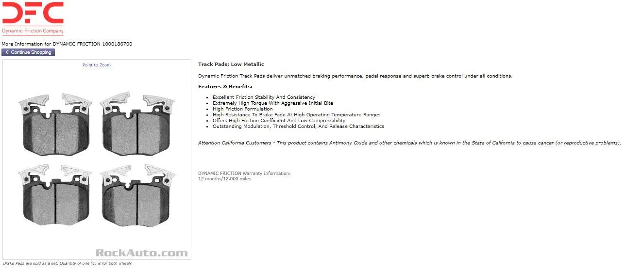

Best bang for the buck are these Dynamic Friction pads 1000186700 (if you can find them), they only last 2 or 3 track days and the price is incrediable. I would rate them as good as the XP10's.
Sounds like you need CSG pads. Those carbotechs you have been using are notorious for not lasting long.
Hell, even Project Mu club racers will last longer.
