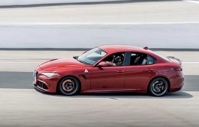

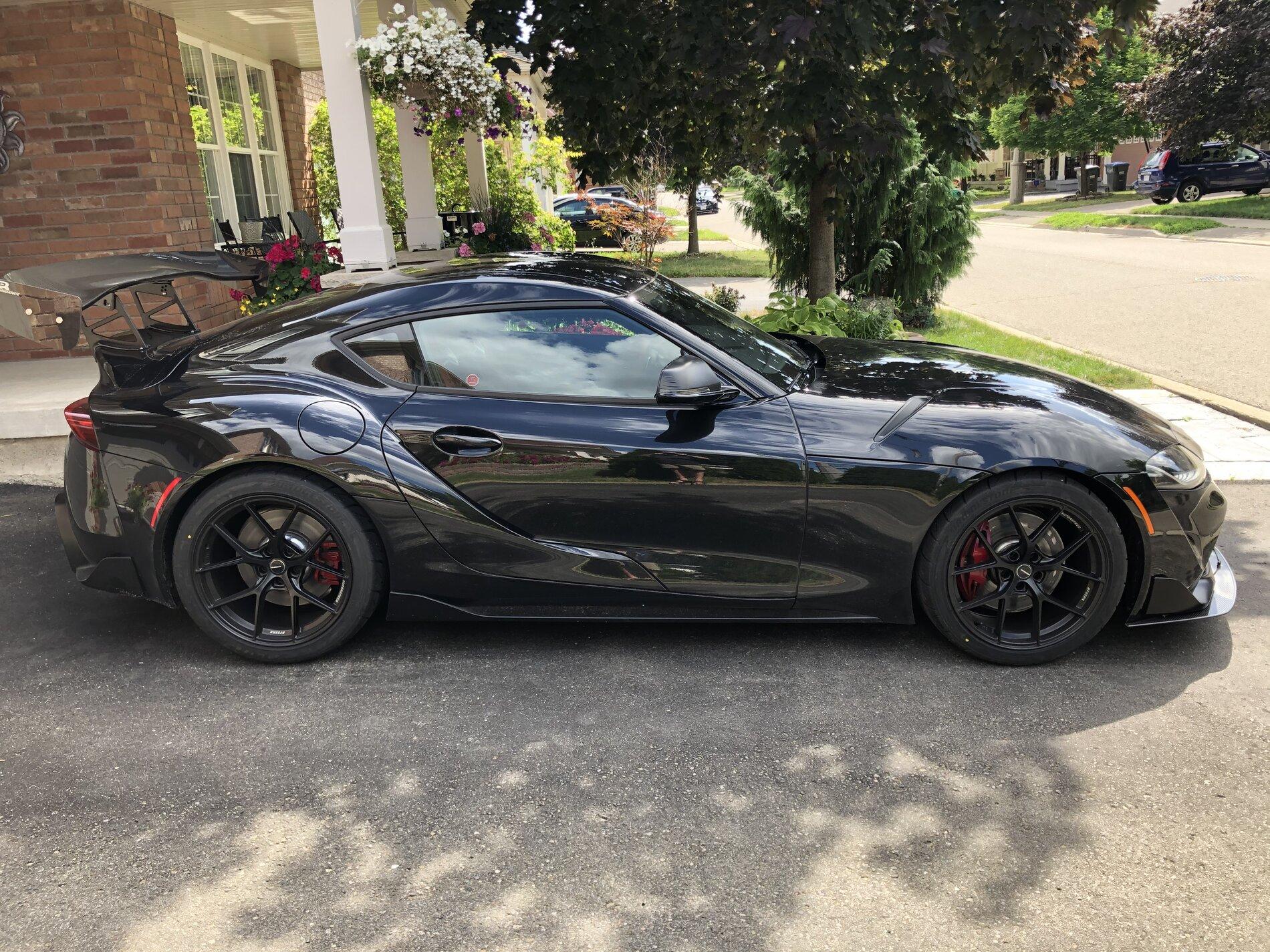

As far as the Giulia Quad goes, I no longer have it and just forgot to delete it from my profile. It was a tremendous car when it was working well, but in around a dozen track days I left in limp mode for every single one of them. Over the two plus years I had it I finally figured out some work-arounds to reset the computer, but it was a bit of a headache. I was willing to put up with it because it was such a blast to drive, but I was excited to make the move to something more reliable and here I am complaining about the new toy, lol. I stuck my favorite shot of the Alfa below and it’s replacement. RIP
