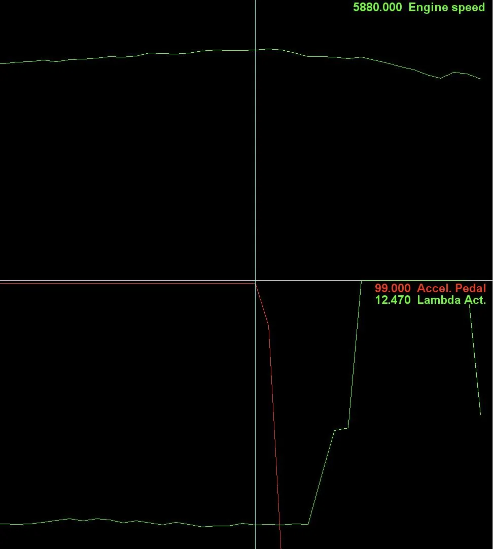

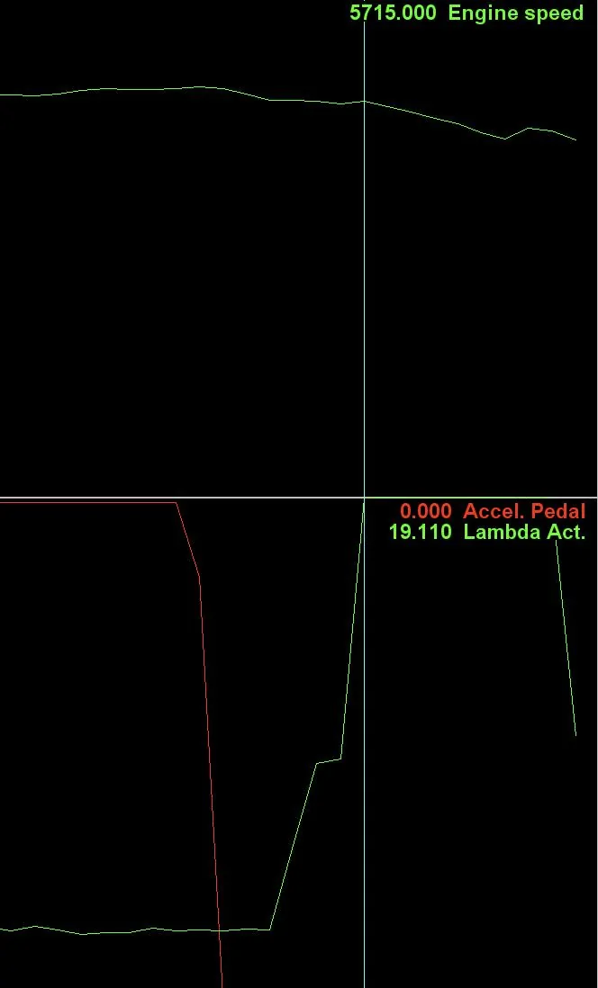

Still incorrect. Injectors drop, car goes lean because no fuel is needed, no combustion, no pop, boom, etc on a properly tuned car.
I know you like to double down on your incorrect statements, but let the people that know things help the OP out.

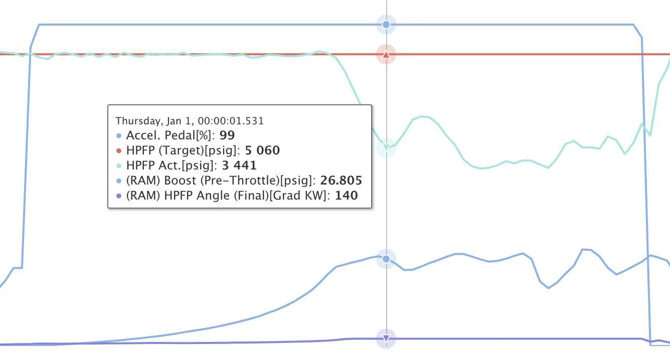

Jmanlevan
Jordan
Mar 20, 2023
38
812
933
Denver, CO
HPFP crashed from maxing it out. 126* is the max angle, you hit WAY past that. Too much boosty for ethanol level.
