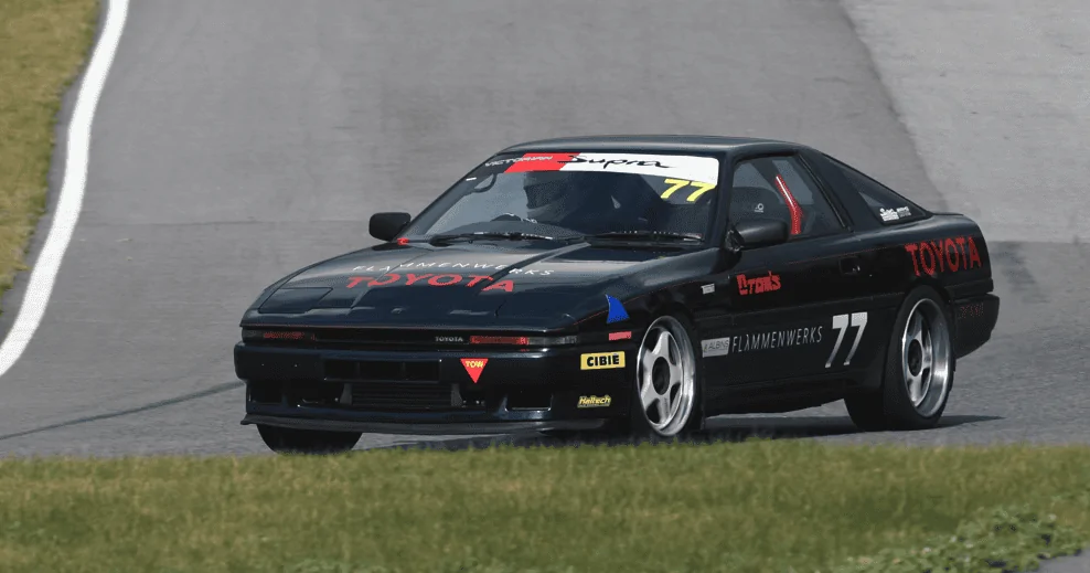

Nice, Nice. How much are you putting down to the wheels?
Not heaps - I drove the car for 4 years with a 2JZGE and tried to find the limit. Then upgraded to the 1JZGTE - running a meagre 340hp at the wheels.
But I'm only 1s off a Cayman GT4 time at my local, so I'm trying to get there with skill rather than outright power ;)
