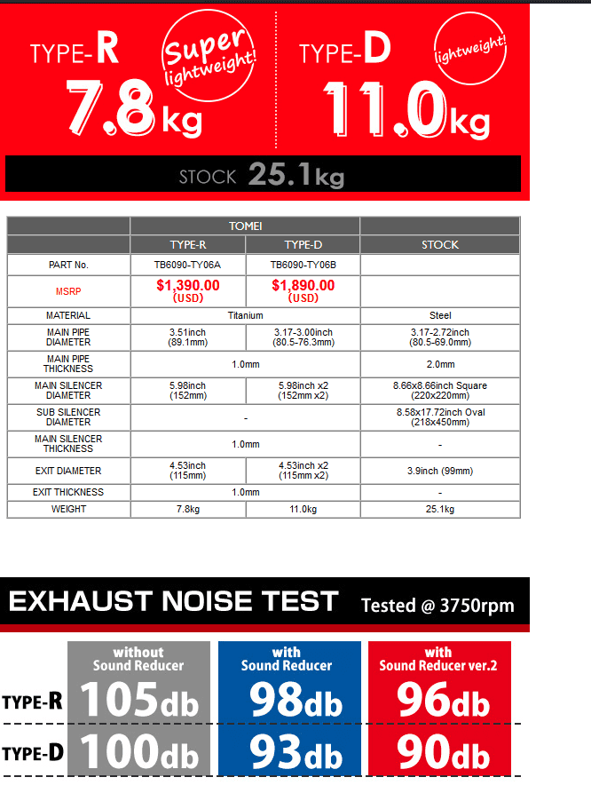

I really like the Ti, as the thinwall gives it a little more of a rasp and less of a 'deep humm' tone... But other than weight savings, that's the only difference with Titanium.

Something to watch out for with Tomei
Not to keep beating the aFe drum (feel like I'm shilling for them at this point) but given the four V-bands that hold everything together, it's really easy to dial in the fitment and get things positioned correctly. Just work your way front to back a couple of times turning things and you're done.
The Tomei uses slip joints and band clamps, which given the friction are significantly more difficult to turn with precision once installed as compared to V-bands.
I'm a V-band believer now. o_O

Yeah, I only use V Bands when fabricating exhausts too.
The Tomei fitment is fiddly - but I am OCD so it had to be millimeter perfect. I did have to slot the holes on the brace between the two pipes at the back, and one side sticks out maybe 1-2mm futher than the other, but the tips are centred in the cutouts, no leaks, happy days.
But it's certainly not as bad as clickbait youtube morons would suggest, and definitely wouldn't stop me from purchasing the exhaust.
