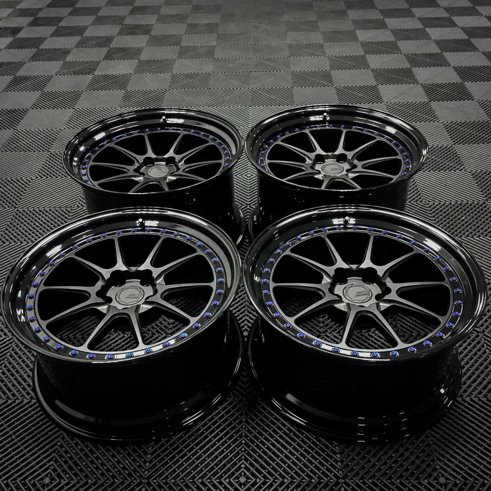

Loving the build and updates. Whats the specs on the tires (I saw the wheel specs) and drop? The stance is just right.
LS3Twins
LS3Twins
Ryan
Aug 22, 2019
290
512
Charlotte
2021 Supra 1998 E36 M3 LS3 Twin Turbo
Thanks man.
The tires are 305-35-19 Mickey Thompsons and the front tires are the old rear tires (275's)
To be honest it needs 30 profile tires to not piss the car off and I'll eventually switch but all my money is going to finish this big turbo build. I'm not fully settled on the ride height because I might be heading to the dragstrip and try and get a solid 1/4 mile time tomorrow night if we can hit it hard on the dyno today and tomorrow. She has 10's in her now and looking for 9's. After that I will keep it pretty low for a daily driver setting.

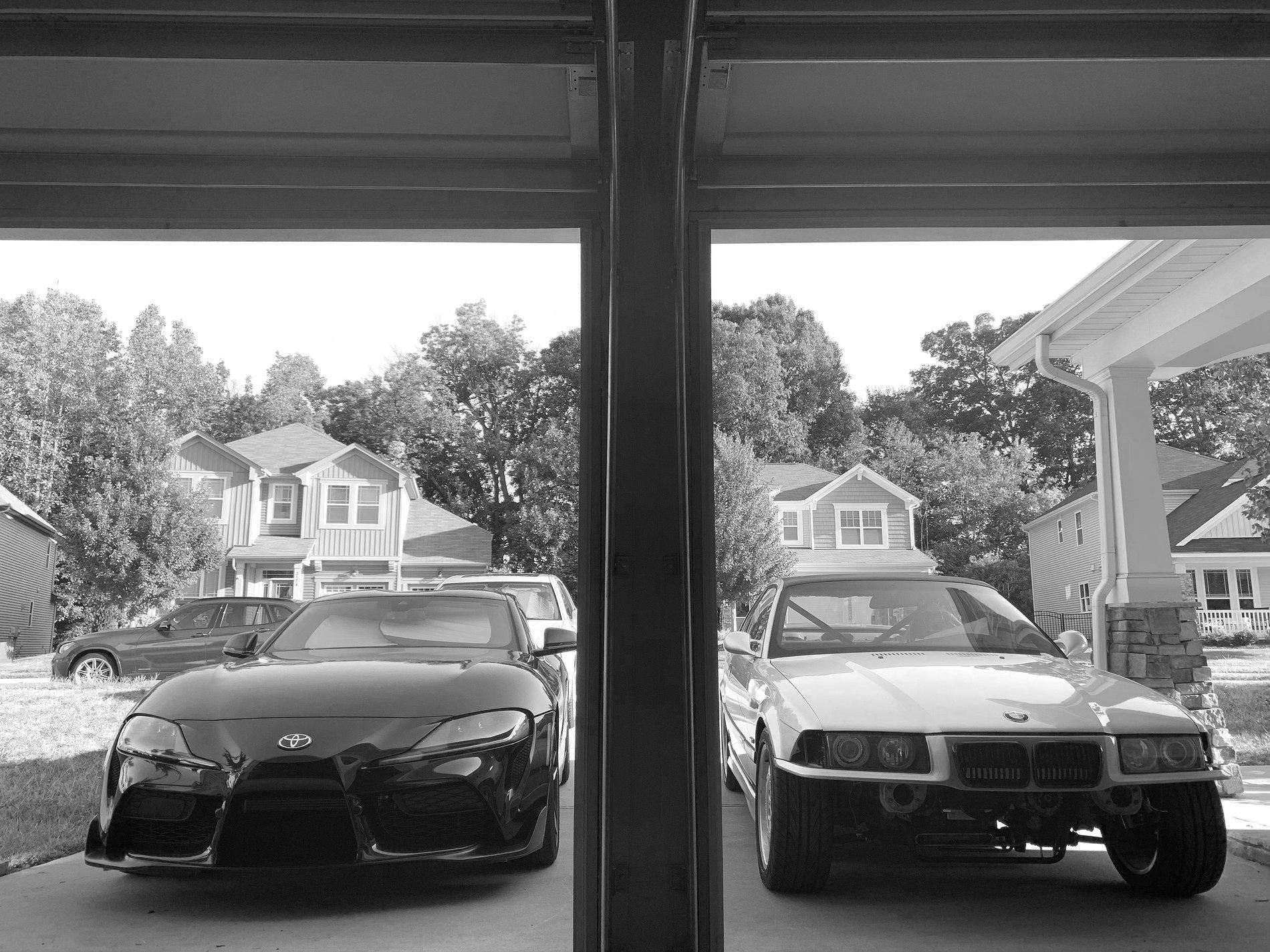

A couple of pics of my humble little garage.

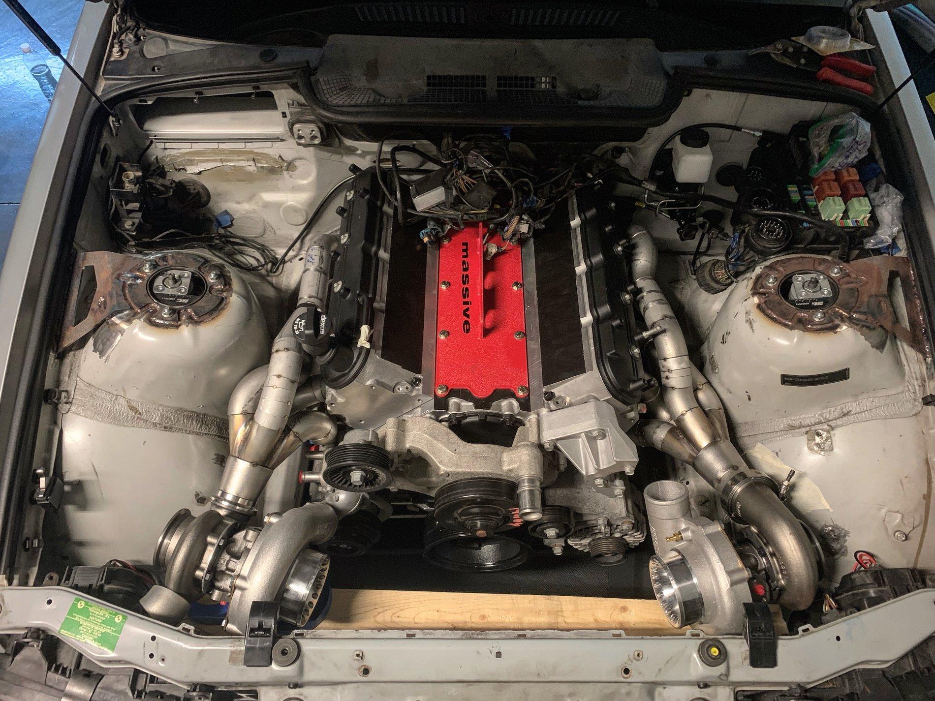

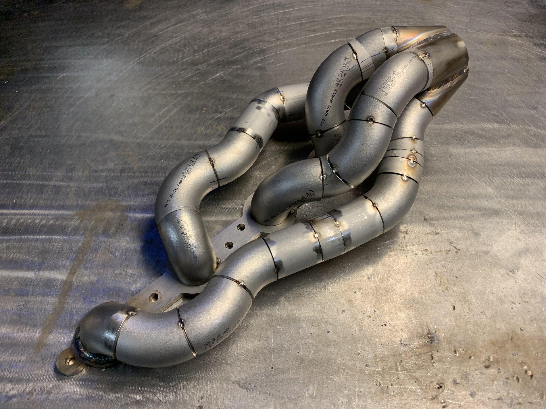

Some updates on the M3 build while the Supra is at Full Race Motorsports for the next 2 weeks.
I finished up the turbo manifolds and turbos are in their final resting place. Fuel system is completely done. Wiring harness is in and have to finalize my locations for the coil packs.
Next up will be running oil lines for the turbos and then setting up the shifter for the TR6060.

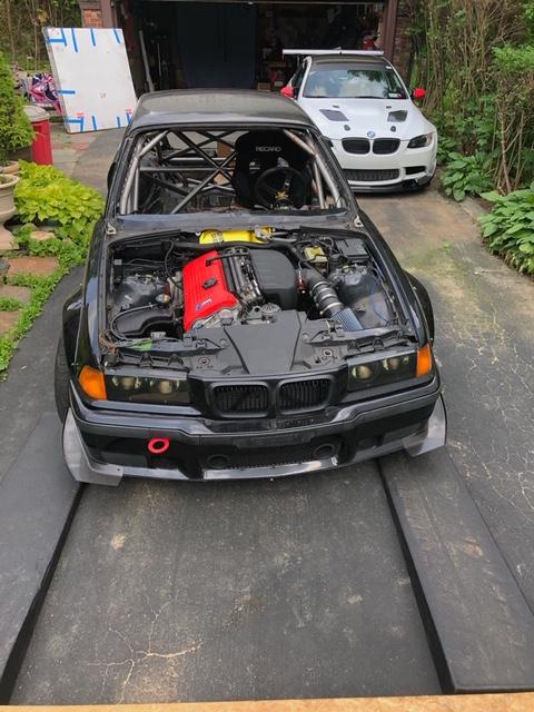

I'm happy to have updates to my builds and thread title.
  • The Twin Turbo LS3 M3 is now running and will upload a video soon. Currently working on charge piping and clutch bleed line to get her on the road.
