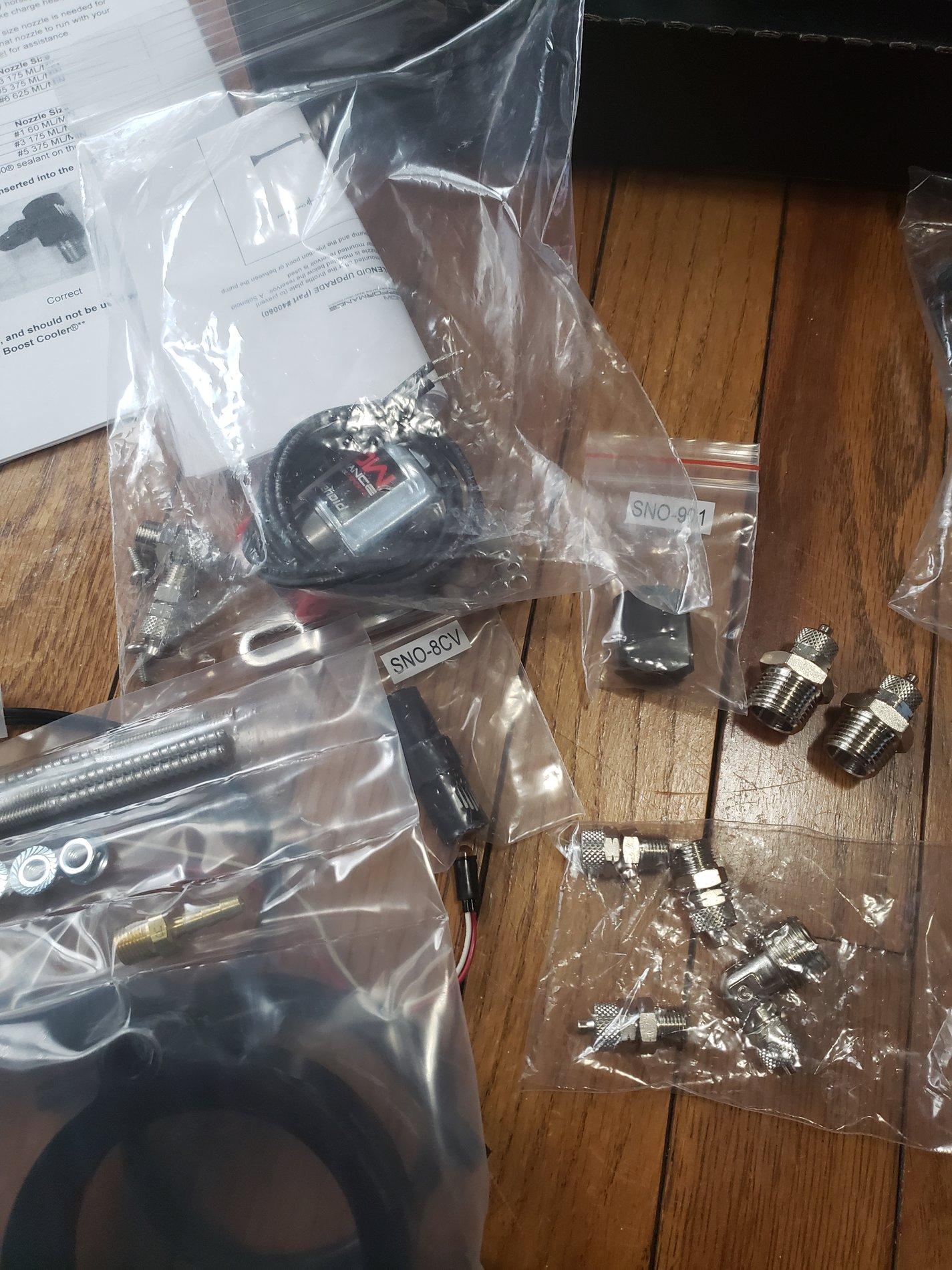

I'm curious what size jets the @Titan Motorsports Meth Kit uses? I just got mine but not sure if I can tell by looking at them? The description indicates it comes with 2 nozzles.

me too as well becuase that is my next purchase and want to know the same thing.

I'm having a hard time identifying the nozzles. There should be a number on the side I could use to determine flow rate.

if you could let me know what the nozzle size is when you figure it out would be appreciated
