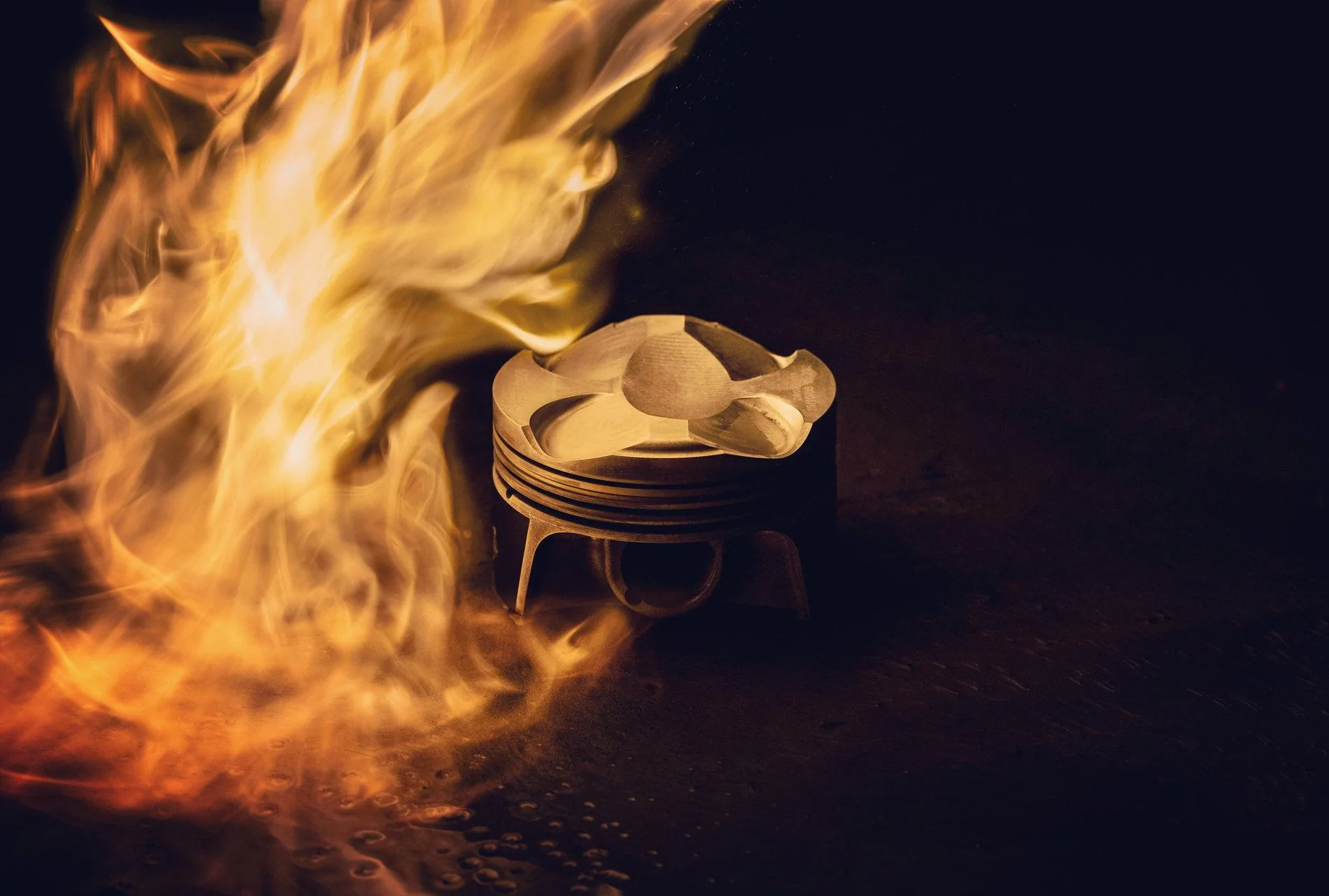

I also have some good news and an update on my build. I now have Mahle Forged Pistons for the 2020 Supra. I took some pics last night and will post one here. I can't wait to get these in with some rods and see what she puts down. The car is still at Full Race Motorsports and I should be flying back out to pick her up in the next 2 weeks or so and will drive her back from Phoenix to North Carolina.
