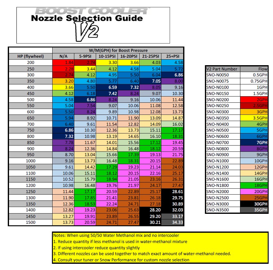

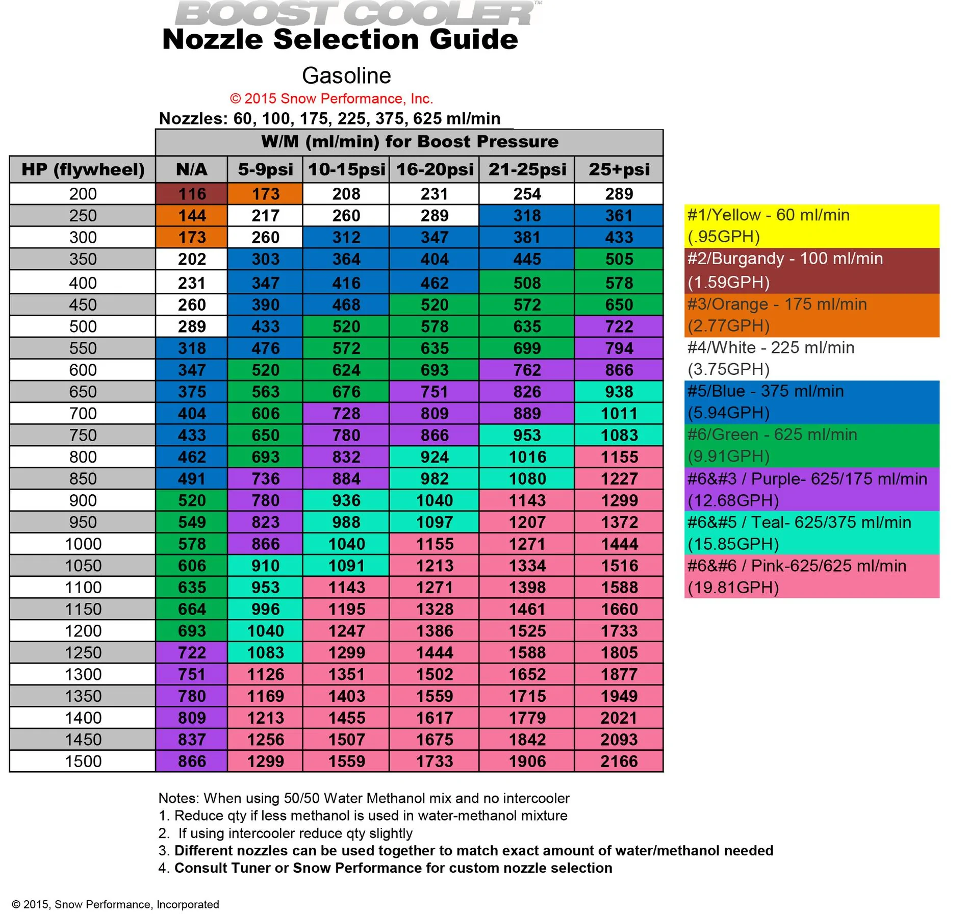

Found them. They look a bit different than what's in the installation video. One is a 3 and one is a 5. I'm assuming you only use one of them?
3 - 175 ML/MIN
5 - 375 ML/MIN
whostorm05
Ryan
May 18, 2019
254
115
Indianapolis, IN
2016 Subaru Outback 3.6R Limited, 1991 Pontiac TransAm
Per the chart in the instructions, 3 is for between 200-400HP and 5 is 400-600. It does not come with a 6 nozzle which is for 600-800HP.

awesome now i wonder if the 5 is big enough to not have the fuel limit issue.

@Titan Motorsports Any thoughts on if a #5 nozzle is good enough to prevent fuel limit issues? Any harm in using a #6, just draining meth quicker?

if that setup has two ports, use two smaller nozzoles to equal the one big nozzle. Better atomization. And atomization helps with distribution in a manifold that has restrictions in it that will affect distribution (the A2W intercooler).
What fuel limit issue are you talking about?

"The plate incorporates 2 NPT ports, one for the included methanol injector and a second which can be used for boost reference or additional sensors." - wondering if you could use two nozzles? I also wonder if you could run two nozzles off 1 pump?

Most pumps can flow like 2000-3000cc so your not really touching the pump capacity.
