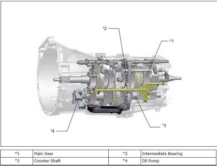

It also does not have a pump with which to pump said fluid
They show it as having an actual pump as opposed to the classic 'guided splash-lube' system we're used to in manual gearboxes. However, what pressure said pump can generate and how the oil is distributed are unknowns.

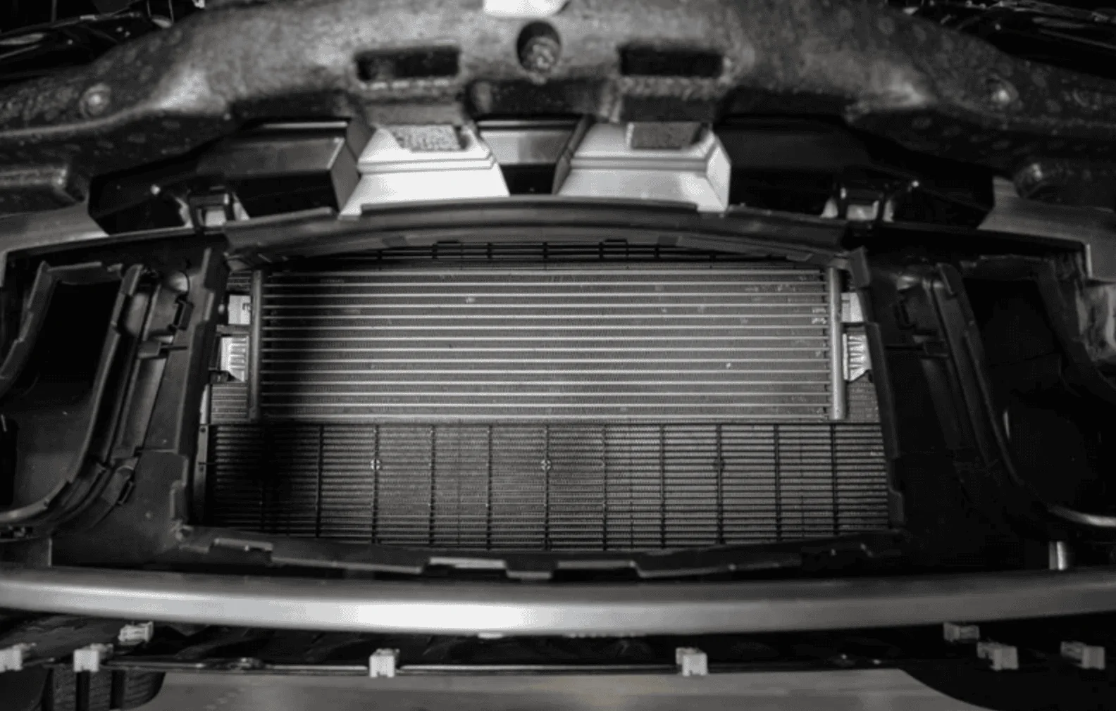

The auto trans cooler just sits in front of the front radiator stack.
Trans cooler --> intake heat exchanger --> engine radiator
Thanks for sharing that. It looks quite big. Will probably need to throw a thermostat in there somewhere.
Yeah it may be the same pump as in the G80 M3 since it's essentially the same base box (GS6-5XX), if that's the case it's for the gearbox's dry sump system which is very rare in manual boxes, helps significantly with keeping temps uniform inside (such as hard cornering and a shaft doesnt get splashed enough).
well fmd, that's brilliant!
Here is why you don't assume things, haha.
MA617M
Aug 27, 2017
2,304
5,168
lots
when you put a pump in, normally you have the flow through the input/layshafts, and oil squirting into gear mesh through holes in forks, shafts, sometimes even in the root of the gear tooth
well, that's how we design them at work and it works well.
