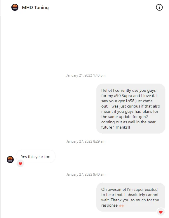

Reached out to MHD in regards to their latest B58gen1 update, and asked if we can expect the same update for b58gen2 anytime soon. Looks like we can expect it this year.
