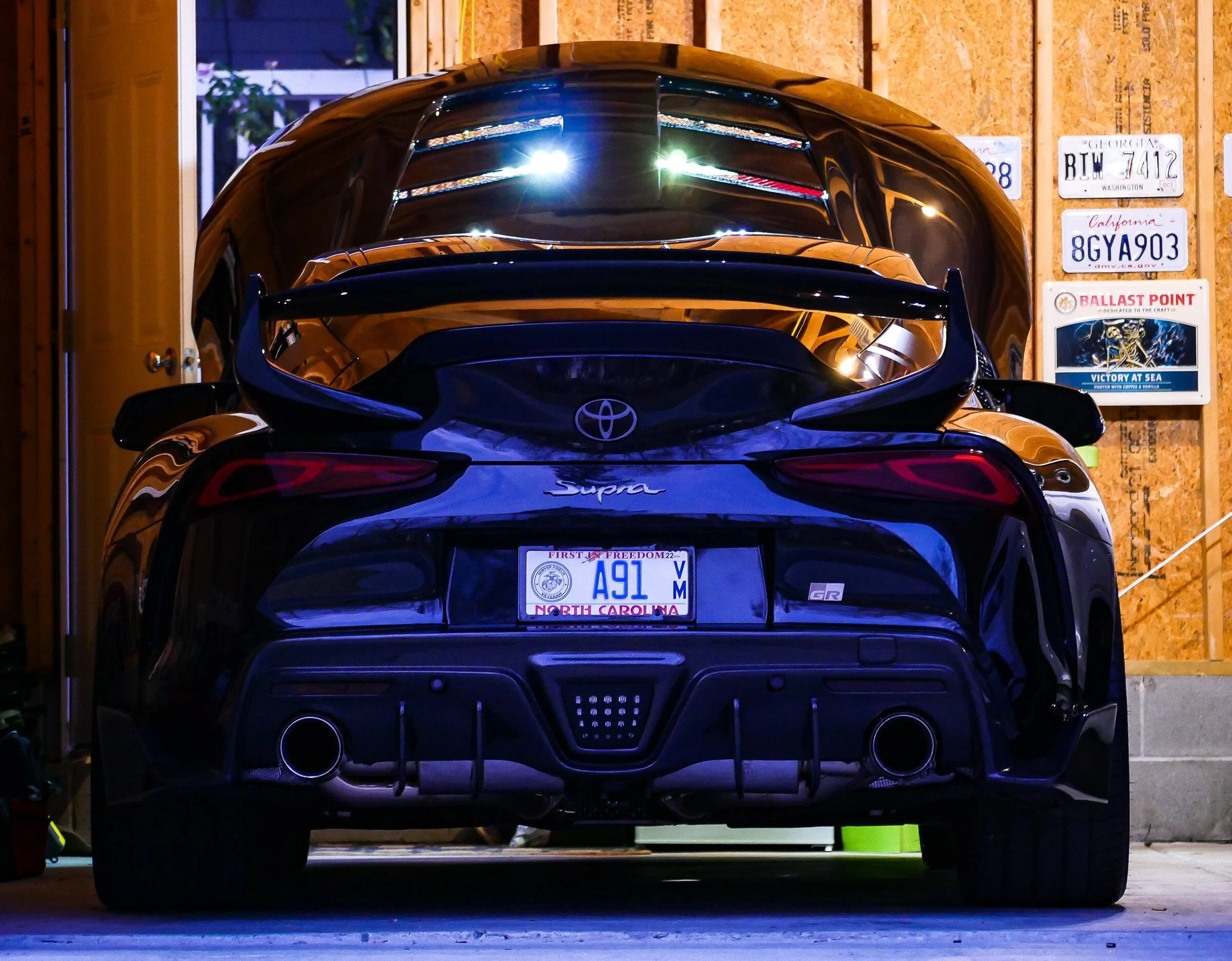

The build quality from Aimgain is top notch. The weave looks great, the resin application is applied very well, and the clear coat looks fantastic with a decent surface. It is also completely hollow and weighs nothing which makes it seem like it was vacuum bagged. It doesn't come with adhesive backing, which I prefer. I will find out how the fitment is today.
I would say this is a high mid-tier product on my ratings scale. Not quite OEM/TRD levels of perfection.
This was a bit pricy for a roof spoiler. There is a cheaper FRP version from Aimgain. You can also get cheaper CF replicas from other companies out there. They usually use cheaper resins, cheaper molding processes, and no QC. But from what I've seen most people on here seem to be happy with the end product. I'm just cursed with pickiness.

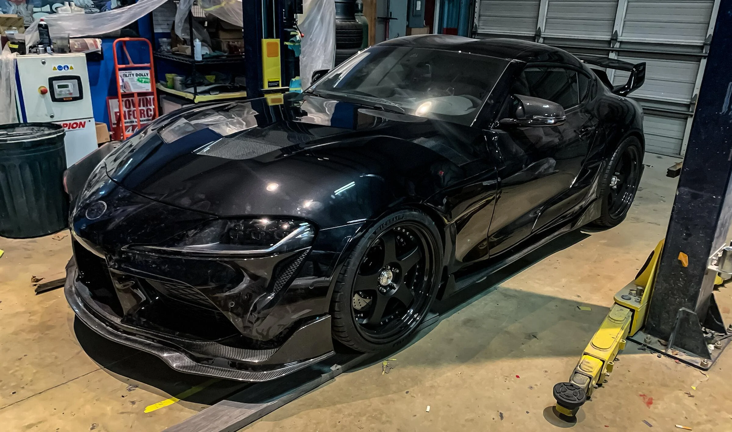

It should be back home tomorrow. Just waiting on the emblems to have the adhesive laser cut.
Can't wait to get the car home and get it detailed.
Edit: Now it seems that it's going to be Wednesday. Emblems aren't quite ready. ?

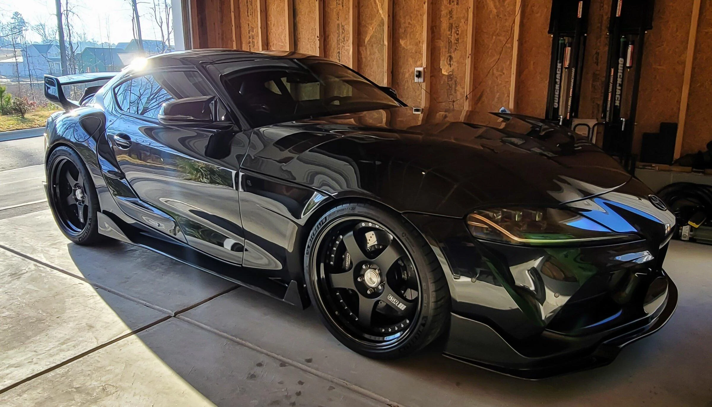

Finished up for the day. New Emblems are all on, Silver SSR decals added, SSR center caps adjusted to point at 9 o'clock and 3 o'clock, engine bay dressing done, 3mm spacers added to the front, cleaned the inner barrels. I'll probably start back up on Saturday. I've got to get this downpipe switched out.
Never done any of this shit before so I'm as slow as a turtle.

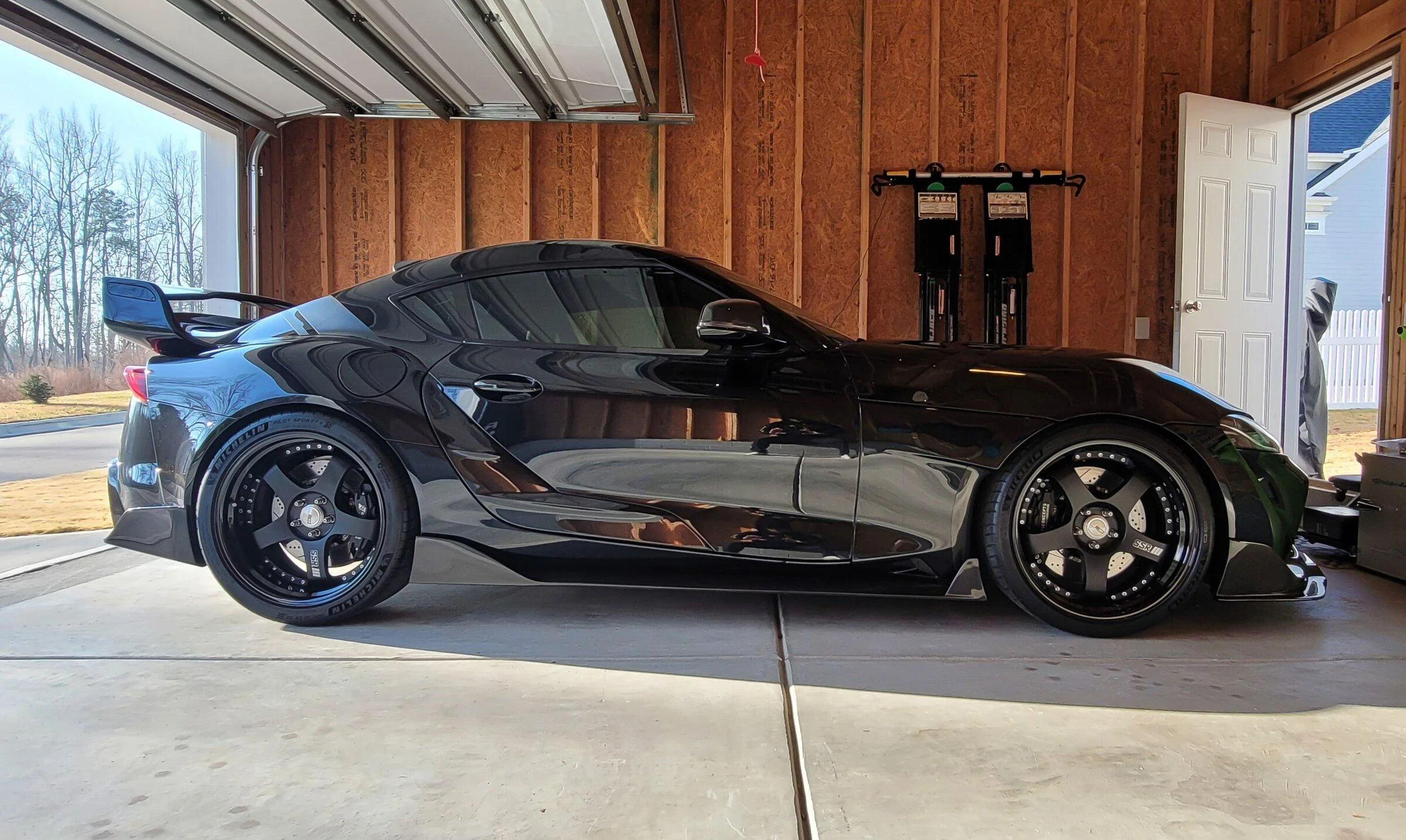

Reposting from the other thread:
I lowered the rear of the car last night. I had a mechanic in the area explain to me how to use a come-along and some ratchet straps on the control arms to relieve the tension on the springs.
All you do is:
  1. remove the lower mounting bolt of your shocks.
  2. wrap your ratchet straps at the end of each control arm and connect to the come-along.
  3. place a block on the differential cooler to keep the come-along at a "V" to have leverage to pull the control arms down.
  4. One you relieve the tension on the spring you can adjust the nut by hand. (Make sure to loosen the locking bolt if you coilover have one on the nut.)
  5. Remove all your straps.
  6. If have two people, one can lift up on the suspension assembly by the rotors while the other slides the bolt back in the shock mount. The smart thing would be to use a jack or a underhoist to do this... but I didn't have that shit.
Props to my wife for getting those bolts back into the shocks.
With this method you do not have to have a spanner wrench AND you don't lose your alignment doing it this way. You just adjust the nut by hand.
I'm new to this game, so I am super grateful that he showed this to me. From what I understand this isn't common knowledge. I had two different specialist shops in the area complain about having to remove everything to use the spanner wrench to adjust the rear coilovers.
Hopefully this helps someone out. I'll try to make a video this weekend to demonstrate. I should have done it last night. Oh well.
Anyways. I only lowered the rear by about 5mm. Any lower and it would start scraping when going over huge humps or dips on the road. It helped reduce the rake and I can no longer squeeze my knuckles through the gap. Wheel fitment is now absolutely complete in my books... until I get a second set of wheels ?.
