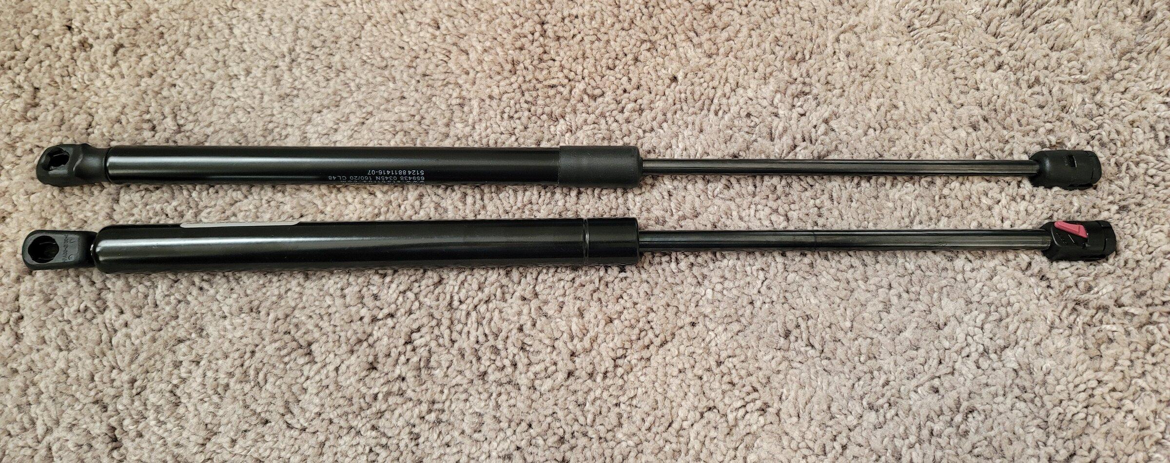

For those with big ass wings on their trunks. I found some stronger trunk lift supports with almost the same length as OEM. These are rated at 152 lbs of force while OEM is rated at 77. These also have a quick release mechanism built in.
Lift Supports Depot:
https://www.liftsupportsdepot.com/1...th-10mm-ez-release-ball-sockets-pm3667ez10-w/ T
hey are about $75 after taxes for a set. You can get cheaper alternatives out there. But I tend to like companies that have lifetime warranties with their products... even though I'll be voiding the hell out of the warranty.
Here's a comparison with the Stabilus OEM support.

Need to look but are the bolts hard to get to under panels?
There aren't any bolts for these. You just snap off some clips and they slide out. Probably the easiest thing I've done on this car so far. If you're fast you can probably change them out in under 2 minutes if you prop the trunk or have someone hold it.
I just looked at my trunk. Yeah very easily accessible. How have they been working for you?
Perfect. The trunk lifts automatically after lifting it a bit. 130 to 140 ish lbs of force might be best for some. I have a spoiler on there too. So I wanted to make sure it worked.
I am going to make a video as soon as I get my car back to show the difference.
I have the 12.5 Voltex wing, which might be heavier than your Street hunter wing. So maybe 152 lb would be best for me too.
