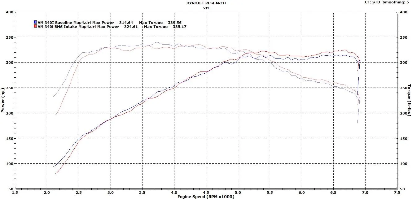

My question to the interwebz is if any of y’all are seeing noticeable differences on intakes with a tune? I know a lot of people are running the armaspeed and MST for the sound but is it worth the price difference? I planned on running a Mishimoto Intake unless someone has solid input for the higher end intakes.

I’ve been running the Mishimoto one since April-ish. No idea on power changes, but throttle response is sweeter and the turbo is more vocal.
Perhaps it makes a difference to power when tuned, but stock I wouldn’t expect so

the intake will add~ 10 whp with or without a tune as proven by dynos. The brand of the intake does not matter in terms of the power increase.
