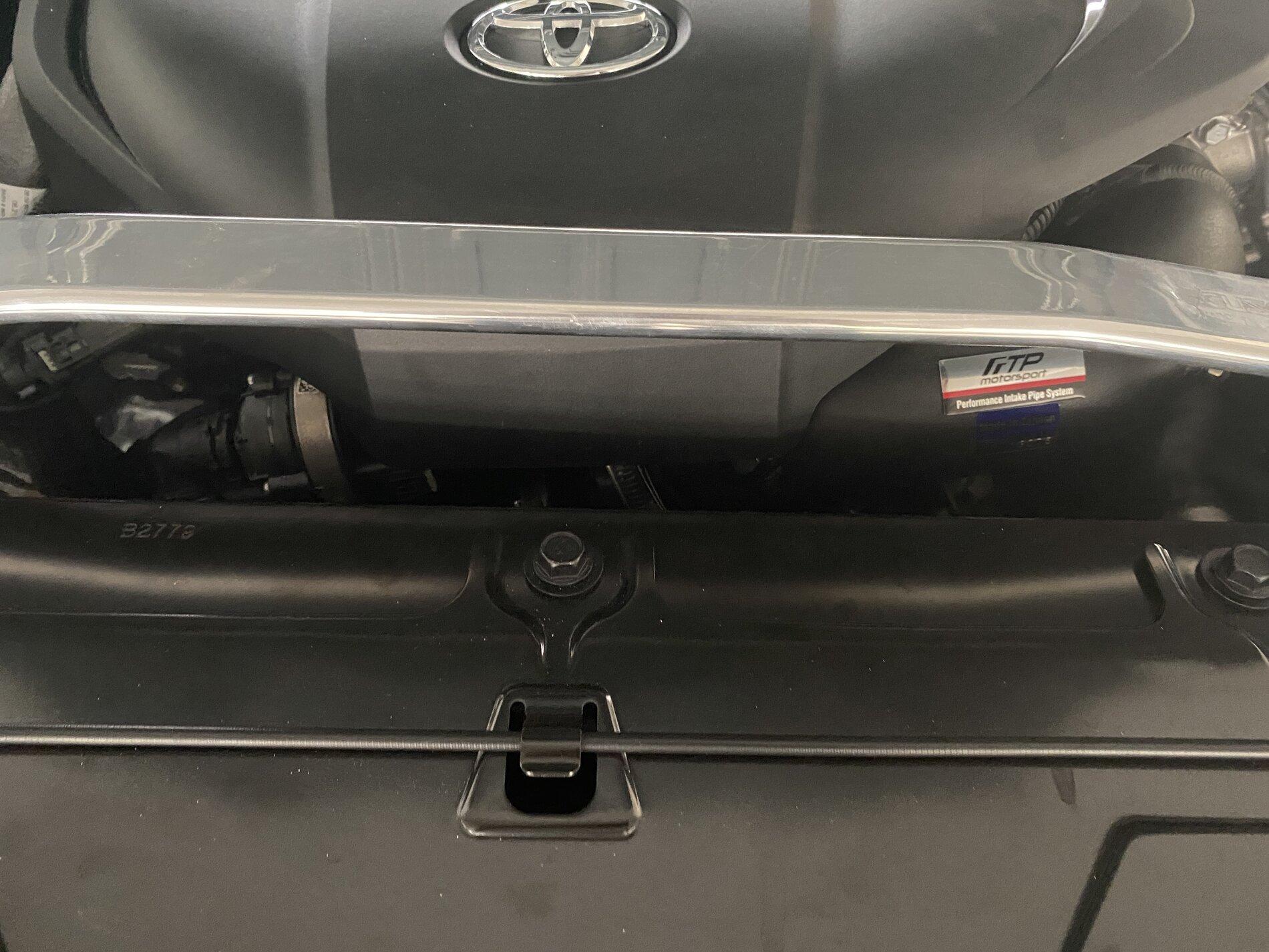

Oil found in charge pipe , mishimoto oil catch can like not doing it's job.

None of the current catch cans on the market really do anything for the supra besides looking pretty (not applicable to all products) under the hood. Its a pretty widely covered topic on these forums - they all pretty much come up dry and do nothing :dunno: in addition to mishimoto having extra problems for some users of reported white smoke (also covered).

Yep, Iā€™ve seen posts by a lot of people running catch cans. Iā€™ve never seen a single person who said it actually caught anything. All of them have said the same thing, the catch can is always dry and any issues they had with oil in the charge pipe have continued.

so oil in charge pipe is a known issues and as of now just live with it ?

Maybe the question is did you have oil in charge pipe before putting the OCC?? Maybe the OCC, or installation, etc. whatever is causing a leak or vacuum where it's not supposed to be.
Try removing for few days/weeks?

yes I saw oil in charge pipe before installing the OCC after installing still saw oil in charge pipe.
Yes, as pizza is bad for you.. but we all consume it cause we are alive and healthy until we aren't.
Correct. The b58 does a really good job of taking care of that oil in combustion.
No one has ever caught oil. All the big power tuners including mine donā€™t use them. Waste of money. If it makes you feel better by all means. Itā€™s your dough
