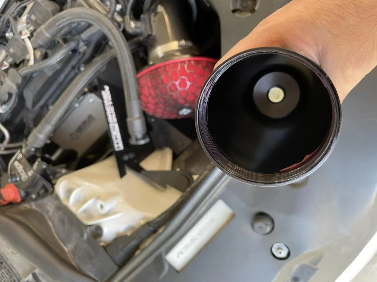

Unscrewed mishi boltZero oil. Opened Forge can.. Zero oil
Intake tract.. Lots of oil (HKS filter is soaked see pic above)
Can't really figure oil source :dunno: No smoke so turbo seal should be fine..
Thanks for taking the time and updating us @a90moe . Ugh, this must be super frustrating. That intake is absolutely drenched. So zero in Mishimoto can and zero in forge can. Looks like they are both failing at serving its purpose.

Very frustrating I tried everything.. I know a couple with the same exact issue too
Problem is also oil accumulation in charge pipes and then clamps slipping and popping off (even with T clamps)
Taking car in on Saturday to examine..

I wonder where the oil is being introduced from. Either the cans are bad at knocking down the oil (but there should be some residue) or oil is not being introduced through those lines.
There is a small amount of oil residue in the lines
My theory, mostly fumes/vapor that pass the catch can and accumulate in the form of oil droplets once they condense in the intake tract and later charge pipes
Or.. Oil from turbo which I will check and update later on
I guess that is possible especially given the thin 0W-20 oil used in this engine ?
