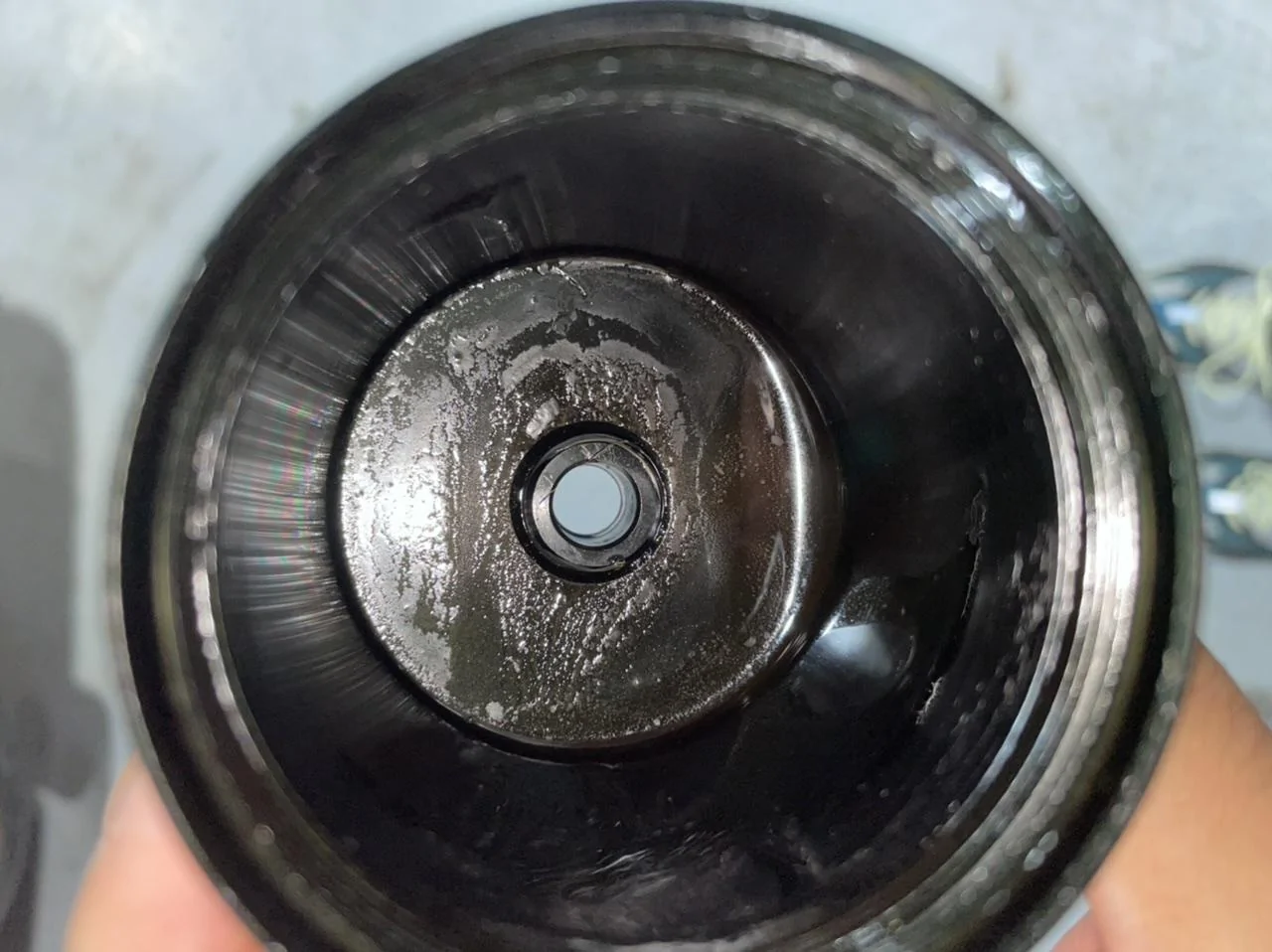

Update
After removing Mishimoto
Around 1000km
Was not enough to reach drain bolt. It caught a little oil.
Is it worth it? That is subjective
In my case most oil was from PCV side..
I deleted the PCV tube and added a breather on top. Bottom turbo inlet where PCV connects was blocked.. Just like top mount turbo kits
Also..
Modified Forge chargepipe so it is the same diameter where the two pipes connect and added a vibrant brace
This should fix the issues I am currently facing (oil accumulation in intake tract and chargepipe popping off)
