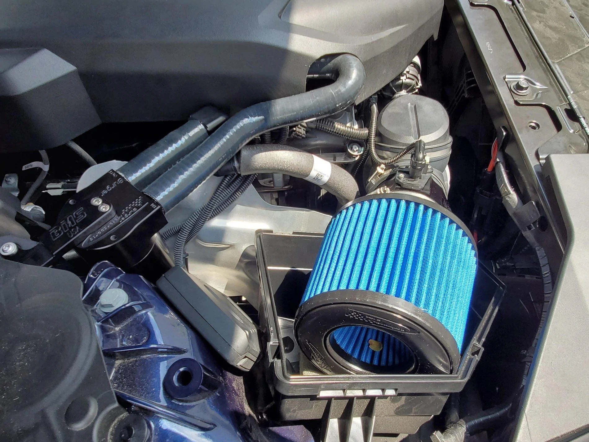

Is that a cone filter inside the factory airbox? If not does it have a cover?
That is the factory air box. I've yet to find an aftermarket intake that takes up as little room as this and is the only solution I found to allow room for the catch can.
Calderon93
Carlos
Apr 23, 2020
119
2020 supra
That intake cone is not recommended for supras. I had the same one and my tuner told me to take it off ASAP a soon as he tuned me. It is not a proper intake and stock air box is not a proper heat sheild for it. I was sucking in way to much heat and actually loosing power. He told me I was better off with stock air box. So I did that until my afe intake came in. I do miss the noises it provided though. But I rather have power over noise

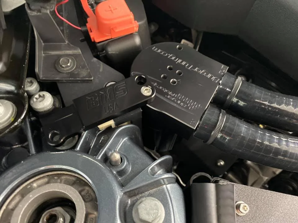

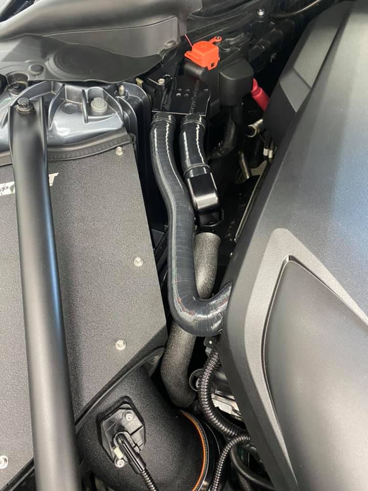

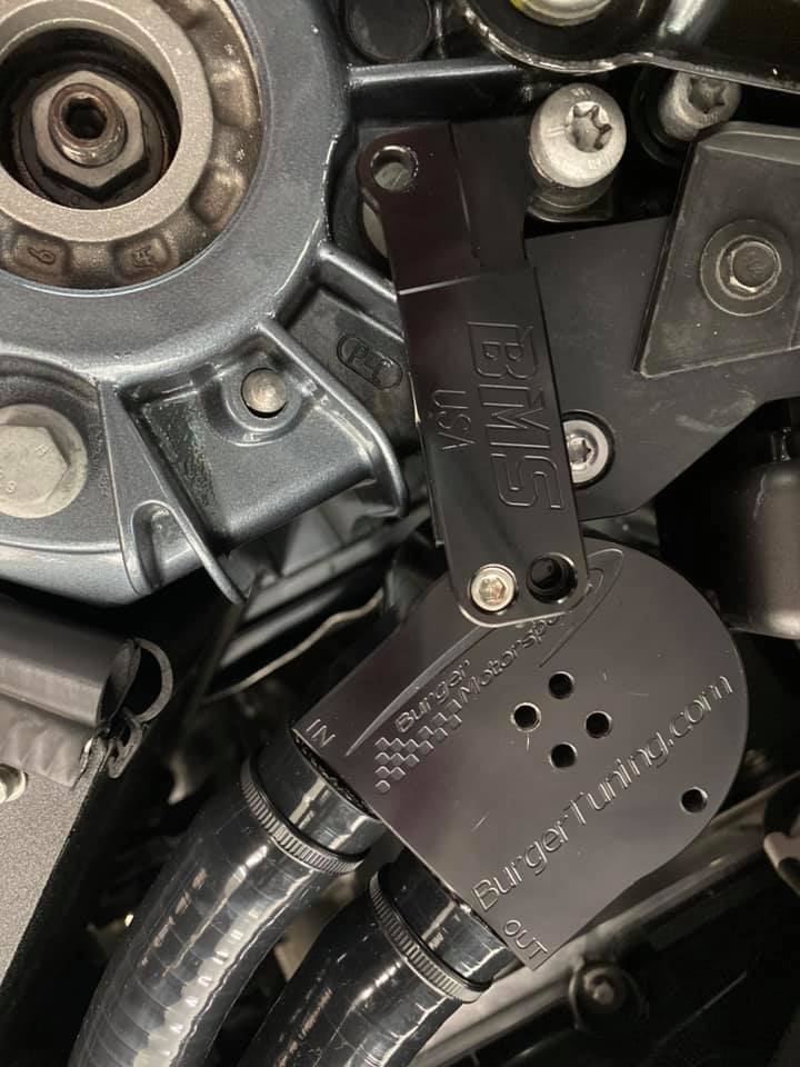

I installed this part a few days ago... I didn't like how it mounted to only a plastic panel with no support, so I changed the mounting orientation around.... Here is the final result for me...
Bflood
Bflood
Jun 20, 2020
390
335
Columbus OH
3.0 Premium
I landed under a plastic shroud and bolted to the frame. However, this has me wanting to relocate the catch can so I can fit a sealed intake like yours. Thanks for sharing!
